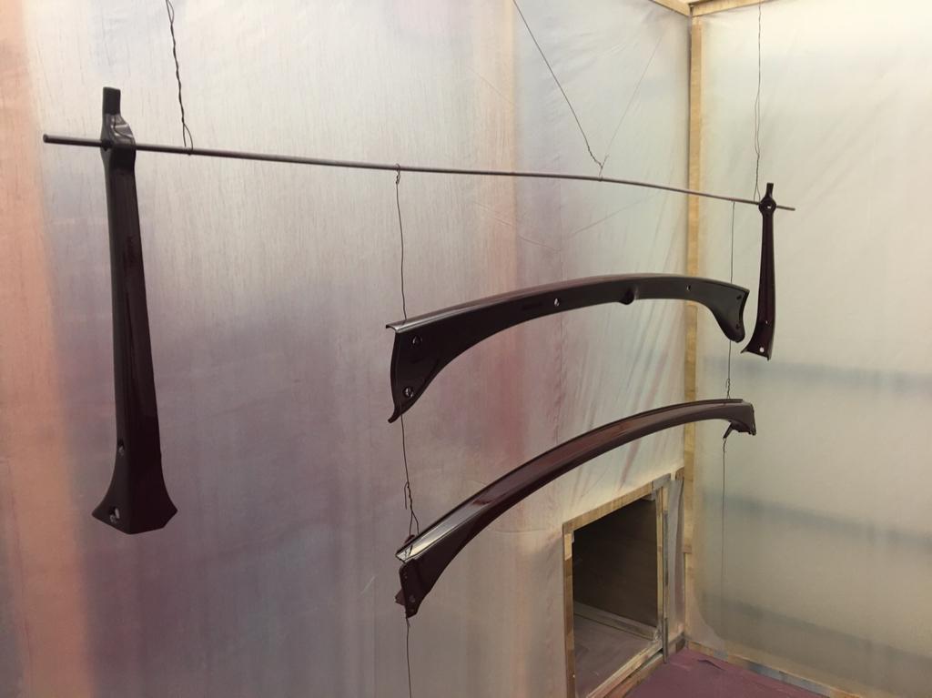

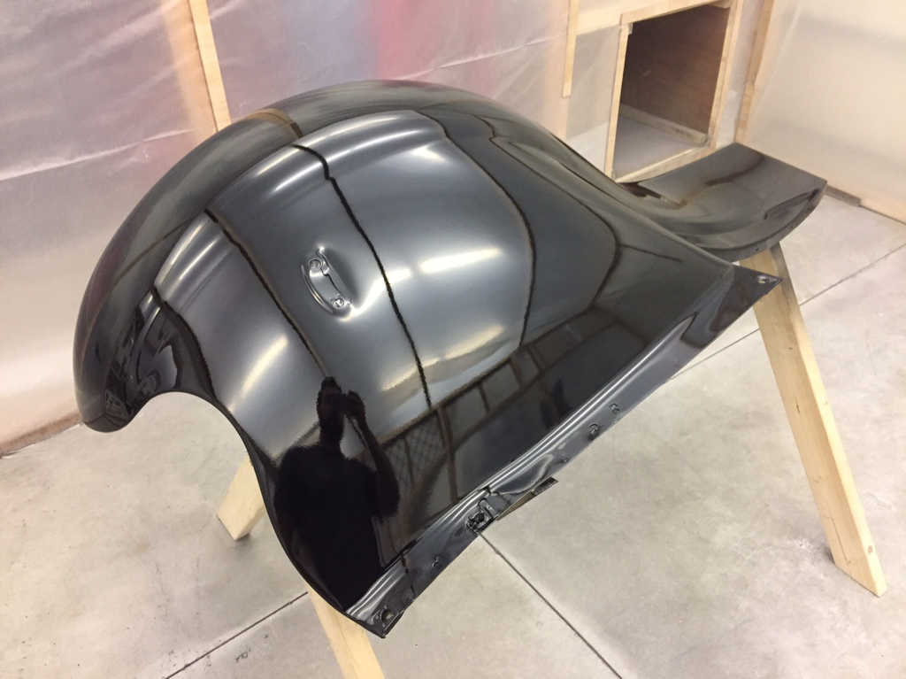

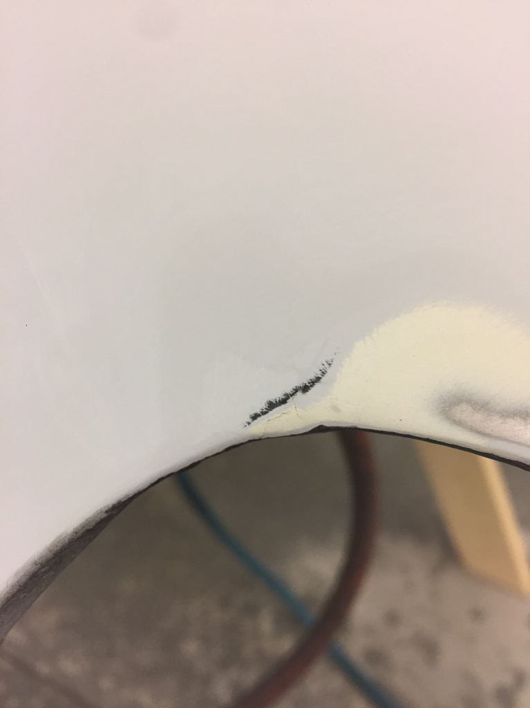

    Few more progress pics

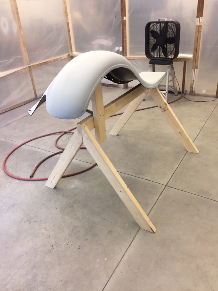

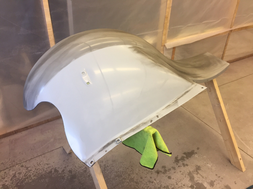

    Made two stands to hold the front fenders while I did a final sand and paint
    Like everything else little issue showed up where the fender flexes in the corner.. appears as if the super high build I put on them when I originally put the truck together had cracked some.. not the black line you have to look close and there is some small cracks coming from the bottom edge
    Ground it back to bare metal in that area and up about 2" then feathered it out.. guide coat and sand sand sand
    Let them dry off real well then hosed some black and 3 coats of clear..
    They will need a wet sand and a buff.. thought I could get away without it until I set them outside with nature light on them.. little bit of dirt and some orange peel..
    Couldn't help but set them on..
    Sanded the rears last night.. still have to get the edges and re tape the underside of them buy hopefully get them sprayed this weekend.. then onto the splash aprons..
    Might wait till just before I assemble the fenders to buff them..

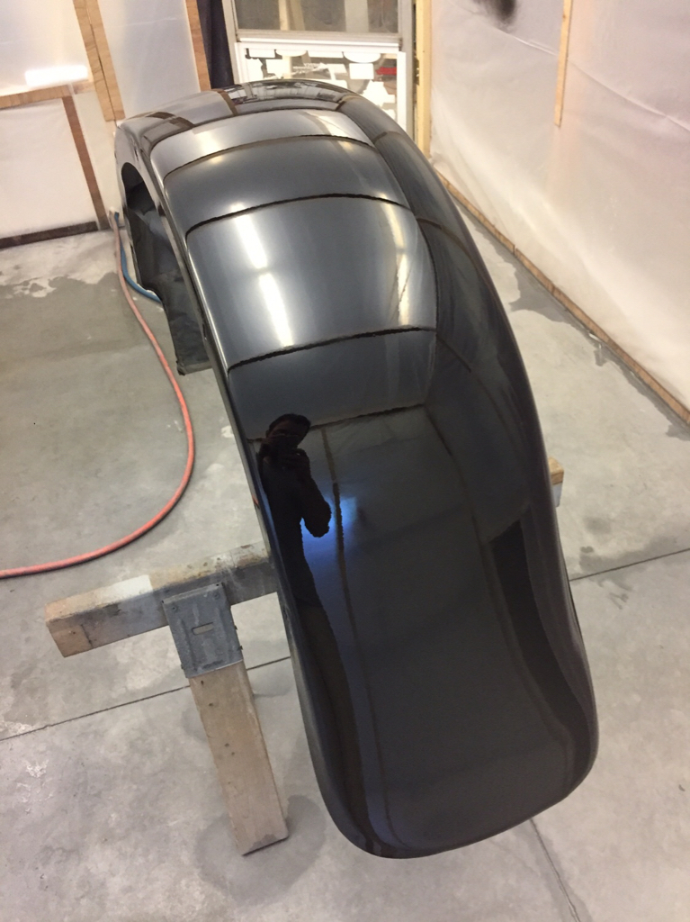

    The rears put up a little fight.
    Put the base down and ended up with some dirt in it.. had to wait overnight and scuff the dirt out of it today.. one coat of base to even it out then 3 coats of clear..
    Switched to medium activator since it warmed up.. flowed out a little better..
    Might stick them and the fronts in natures oven tomorrow.. looks like it's going to be a nice sunny day..

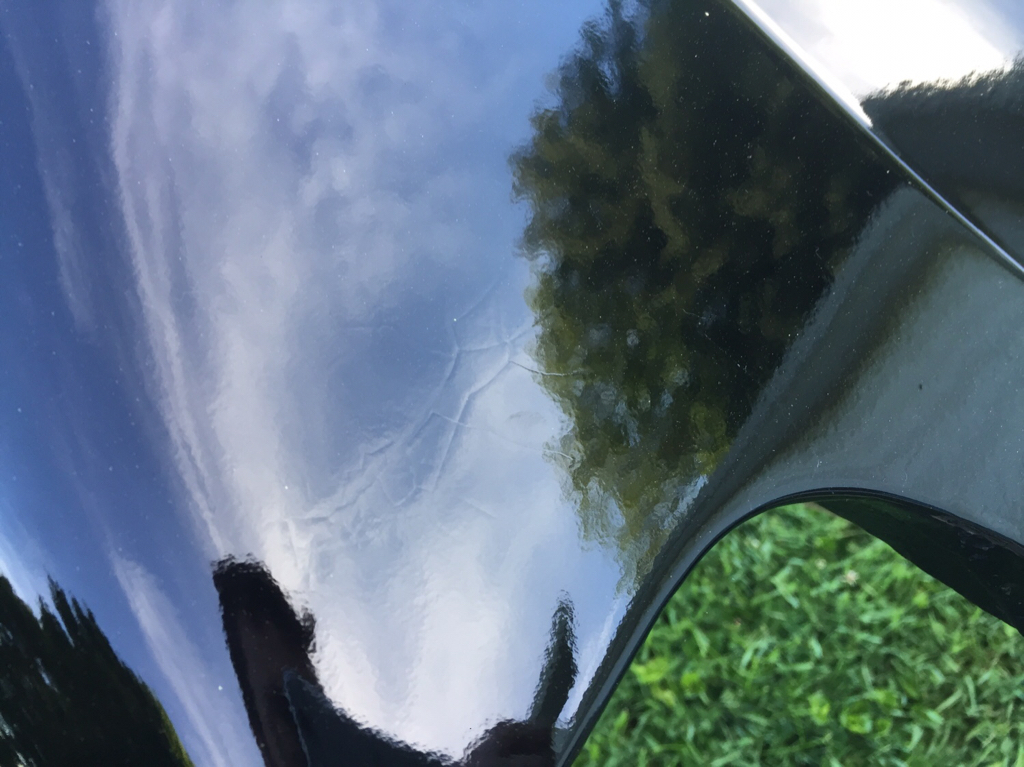

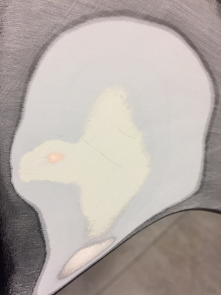

    Well the sun wasn't to kind to me.. better to find it now though..

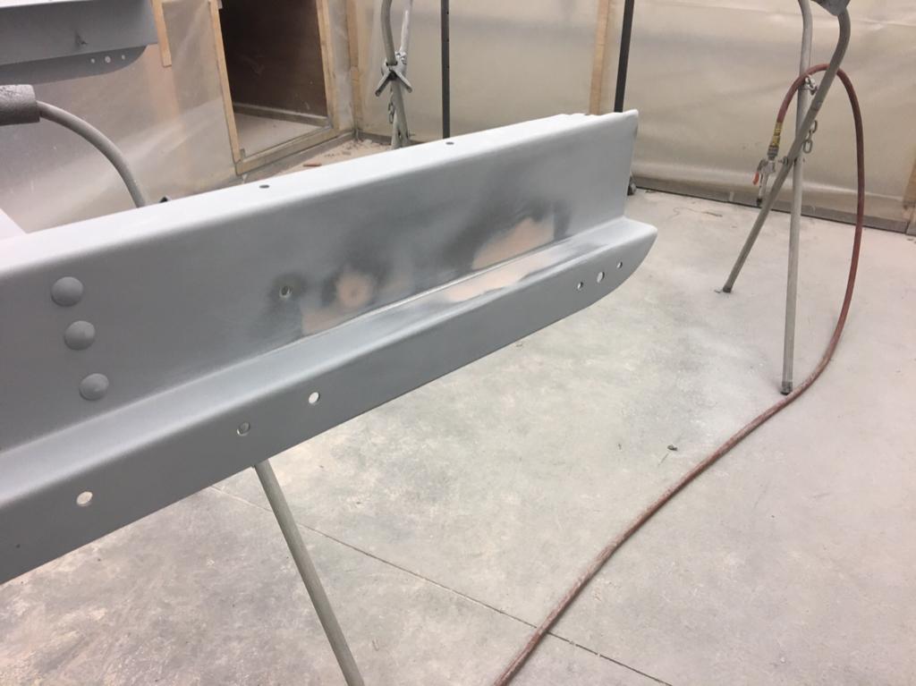

    One spot appears to have been in the last coat of high build..
    Other one 75% appears to have been in the last coat of high build and two larger cracks in the first coat of high build..
    Also found one other small spot up on the front that did it also..
    Get to try my hand at spot repairs.. which I did find out I shouldn't have to worry about buffing through the clear.. there is plenty on there.

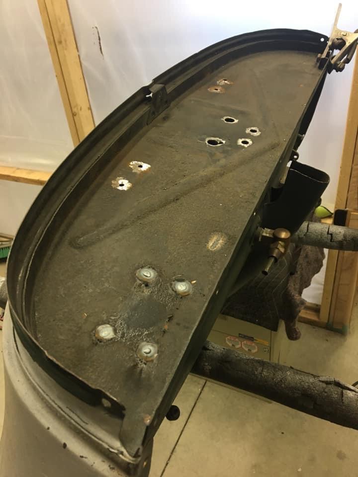

    Come to find I think I was spraying the primer to thick.. it cracked in the curve of the running board also.. so I blocked it way way down.. then sprayed two light coats and blocked one more time..
    Welded up a few of the holes in the tank so I could take it and the cab down to get blasted.

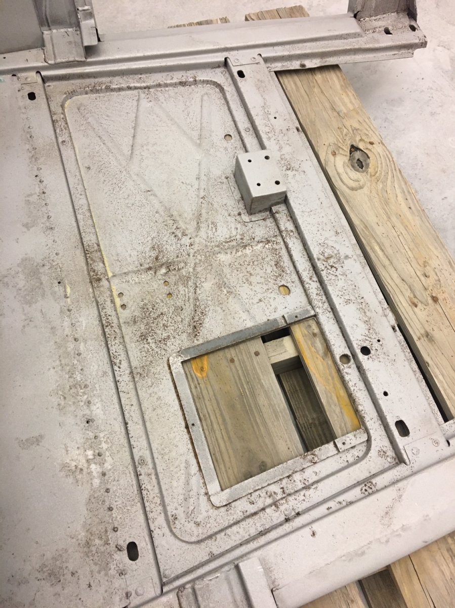

    Picked the parts up early this morning.. it was still dark.. they were on a pallet so they just loaded the pallet up in the trailer and I closed the door... came home after work to unload it out of the trailer and get a closer look at them.. :(
    I can’t win with this thing... always something...

  6. Sorry to see this...
    Nothing else to do but send it back and possibly stay there during next blast, in order to ensure sufficient quality.

    I’ll probably just end up touching up the smaller parts myself...
    Did send text guy pics of it and he claimed it to be flash rust.. I can go with that on some things but there are spots that were not even blasted..
    I’ve said I could bring the stuff back if I needed so I’ll probably take the cab back down

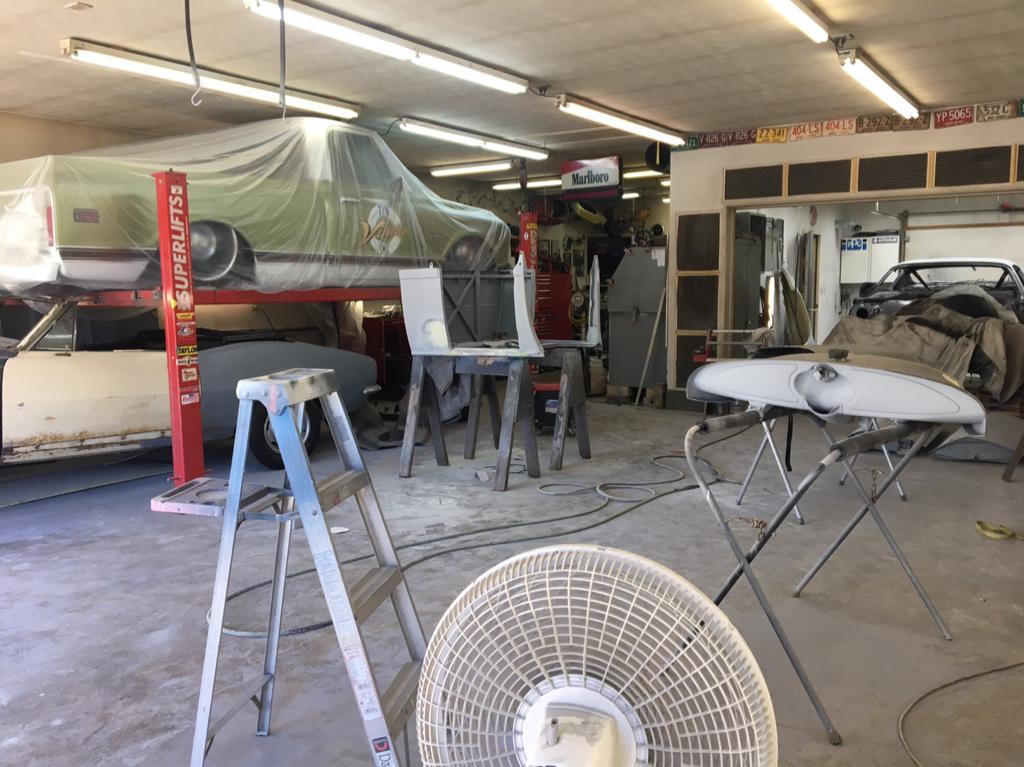

    Made a little head way.. blasted the hood myself long with a few other things..
    Ended up contacting a buddy that started working on his own from his home shop to see if he would give me a hand get this thing moving faster..
    He was nice enough to let me bring it up and work along with him..
    Come to find they warped both doors while blasting the inside.. there were low spots where the 4 holes in the inner structure are at..
    Got it ruffed in before taking it up..

    Going to try and make it up to my buddies to get a plan together for the outside.. he has a bigger paint area then I do.

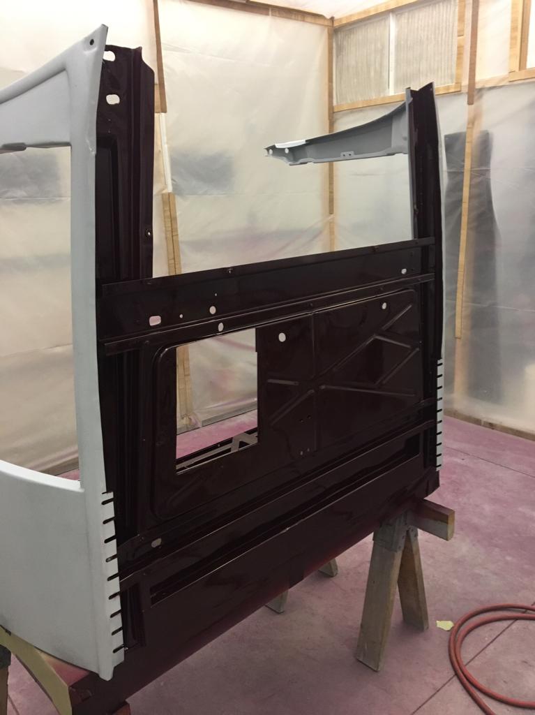

    Brought the cab back home so I could cut the inside and bottom of the cab in.
    Also brought back the hood.. still had the hood sides here.. decided to go with satin on the inside just due to the shape the hood is in.
    So mixed some flatter in the clear.
    Be a lot easier if I was painting this thing inside and out all at one time

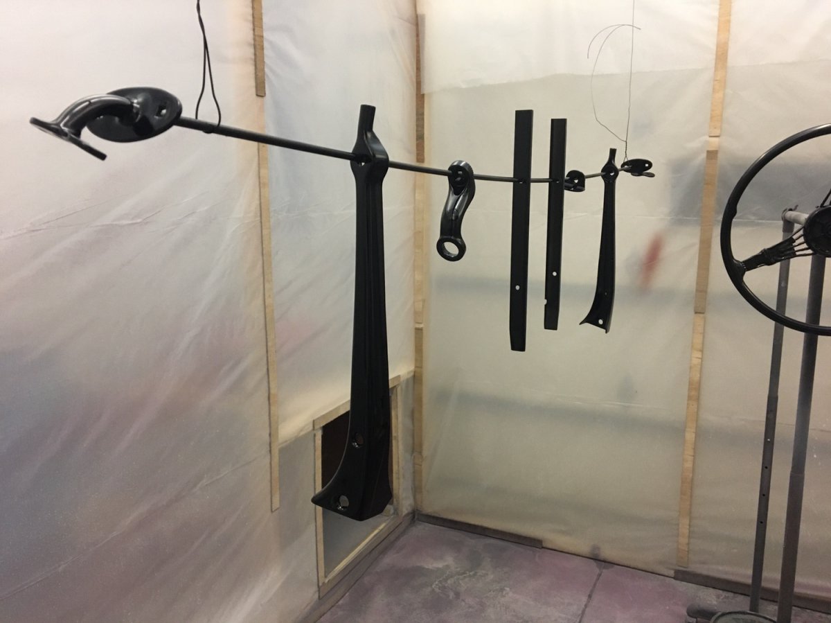

    Thanks! Hope to get painting few small things again soon.. steering wheel and some brackets..

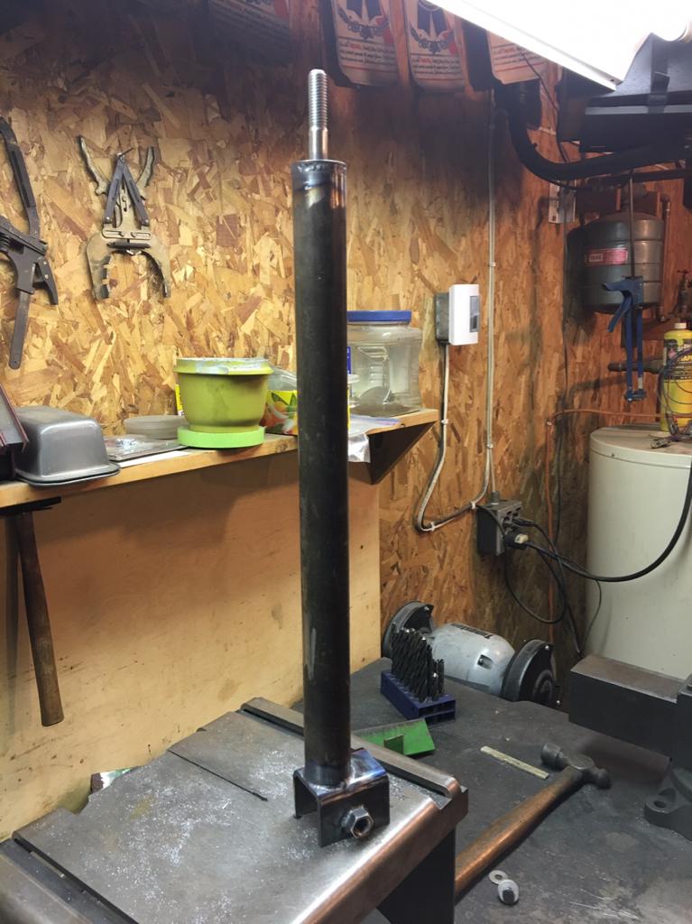

    Did have to do some machining to finally have a horn button/ cover on the wheel..
    Since it’s all I had at the time the model A steering shaft caused issues with the cover not being able to go all the way down onto the wheel..
    The supports on the cover were hitting the nut on the shaft.. so easy fix machine the supports off..
    Then turned down an old pin laying in the box of round junk so it would tightly fit into the center of the steering shaft... threaded the other end so I could thread it into a piece I made to set inside the wheel..
    Counter sunk the existing holes on the opposite side to use two 1/4x20 machine screws to hold the plate to the wheel.
    Actually just dumb luck but the extra I had left on the threads of the center pin was just right to hold the horn button up where it needs to be.. never had a spring so it would fall in if pushed..

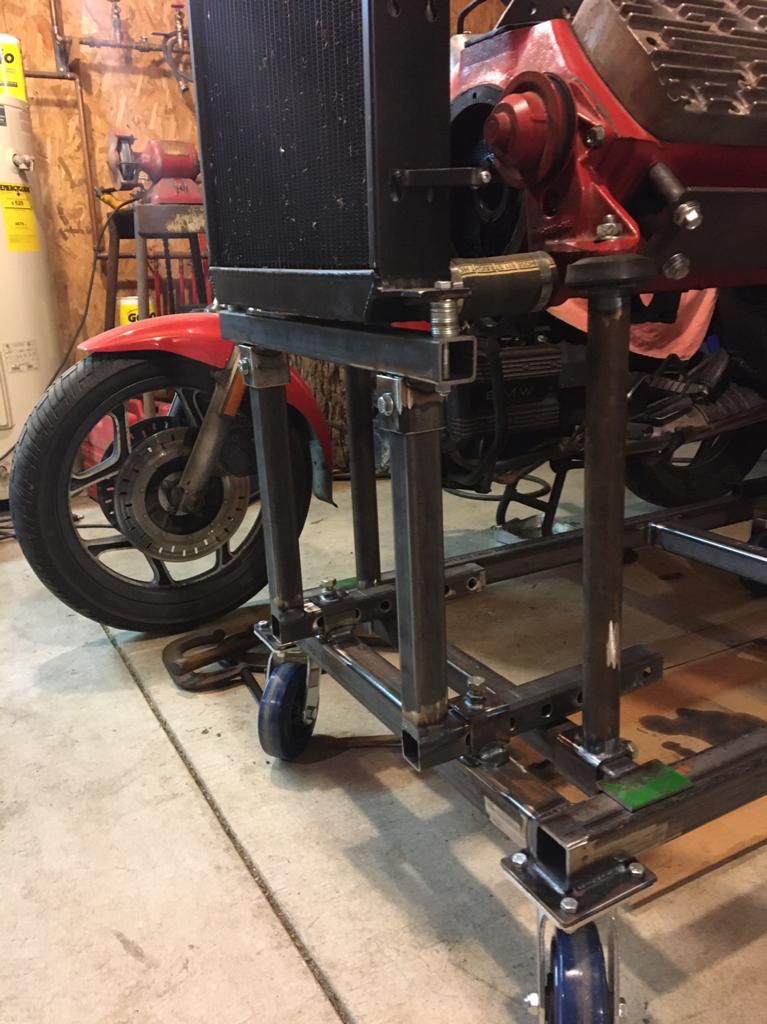

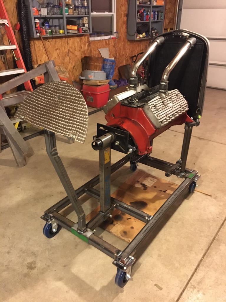

    While waiting for the paint to cure some before moving it around I pulled the motor on the other roadster that needs an overhaul.. which lead to making a run in stand..
    Few pics from that.
    Broke 5 studs and three of them put up a good fight..

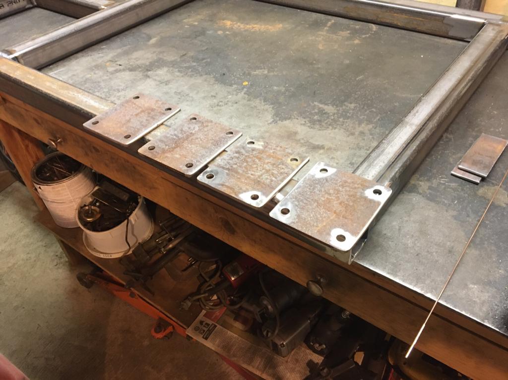

    Perimeter frame.
    Front mount adjustable
    Front risers/ engine mounts
    Adjustable radiator mount
    Control panel. Used an old door off the inside of an old safe that I had since it was already polished and turned.. the stand is pinched on like everything else so it can be moved anywhere on the frame..
    Picked up a 32 truck grill few years back and threw it on since it was just hanging on the wall.. maybe keep me from hitting the radiator..

  18. Run stand is really well thought out!

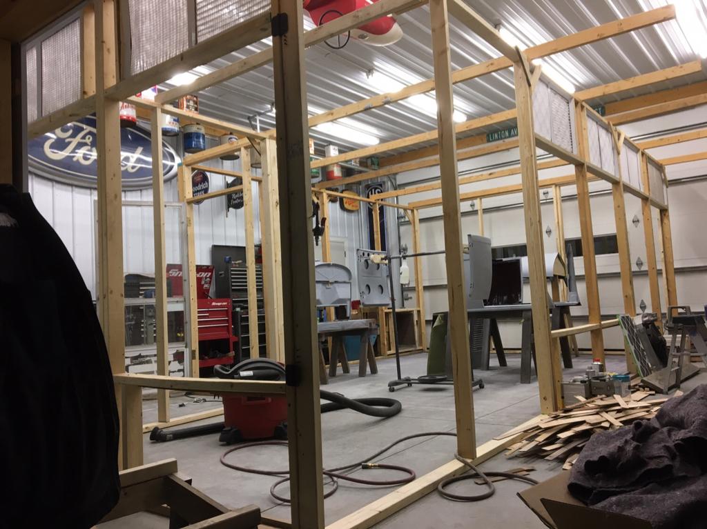

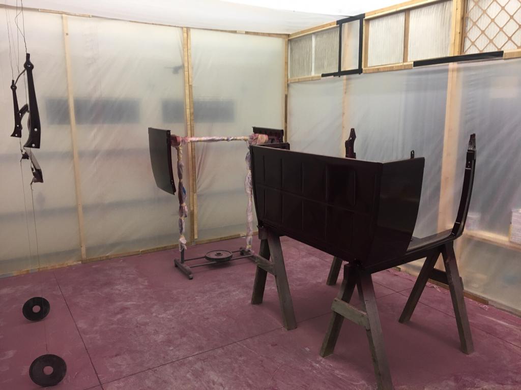

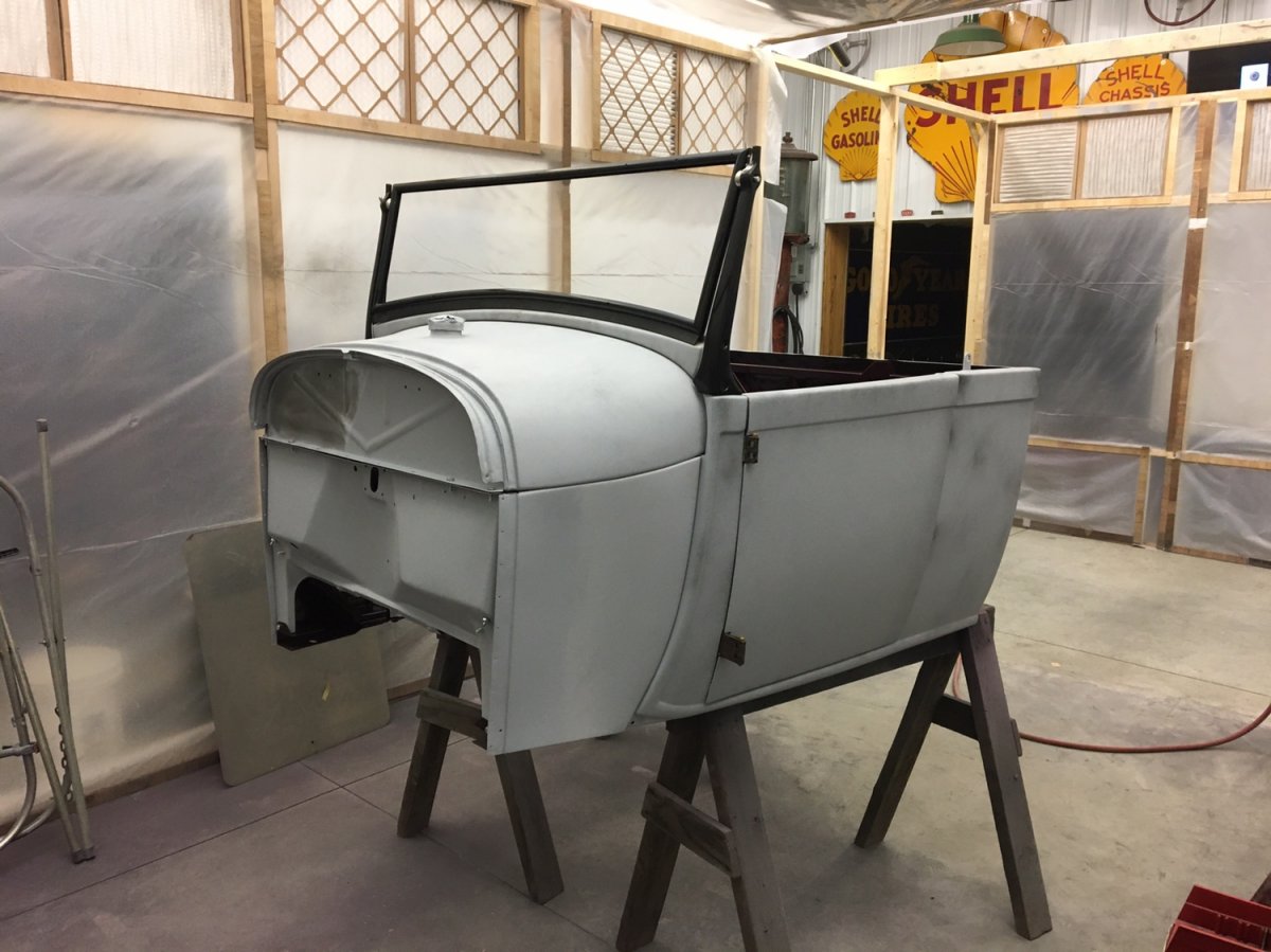

    Out of room so extended the booth a little to hopefully make enough room to paint everything at one time..
    Wanted to make sure the doors lined up after moving and welding a few things before I had it blasted..

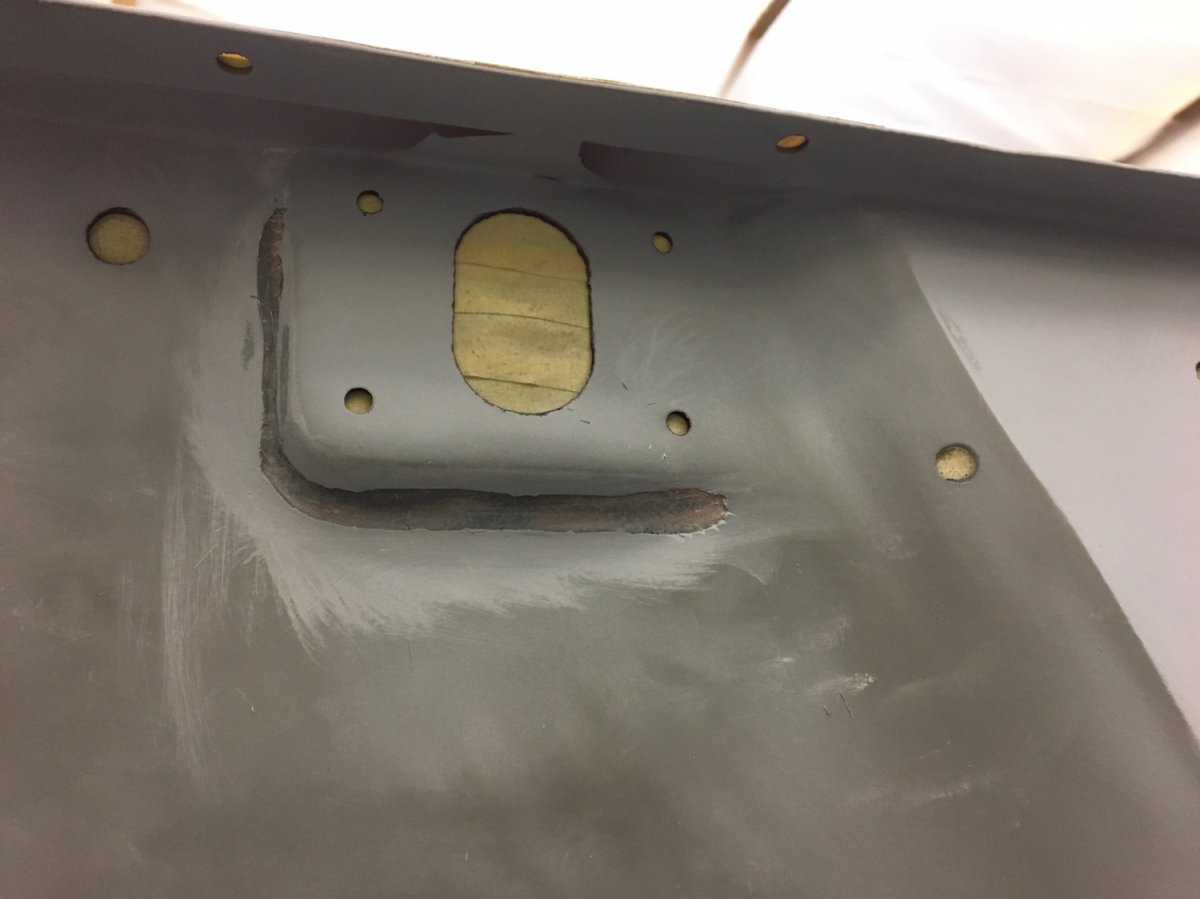

    Started blocking the firewall and found a little surprise
    For some reason all around the edge of the ignition box cover the primer lifted.. must have been something on the little filler I used. The epoxy is what lifted.. also found a small crack in the primer where it must have got heavy in a corner..
    All straightened back out... hopefully

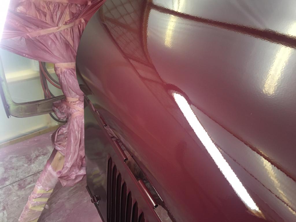

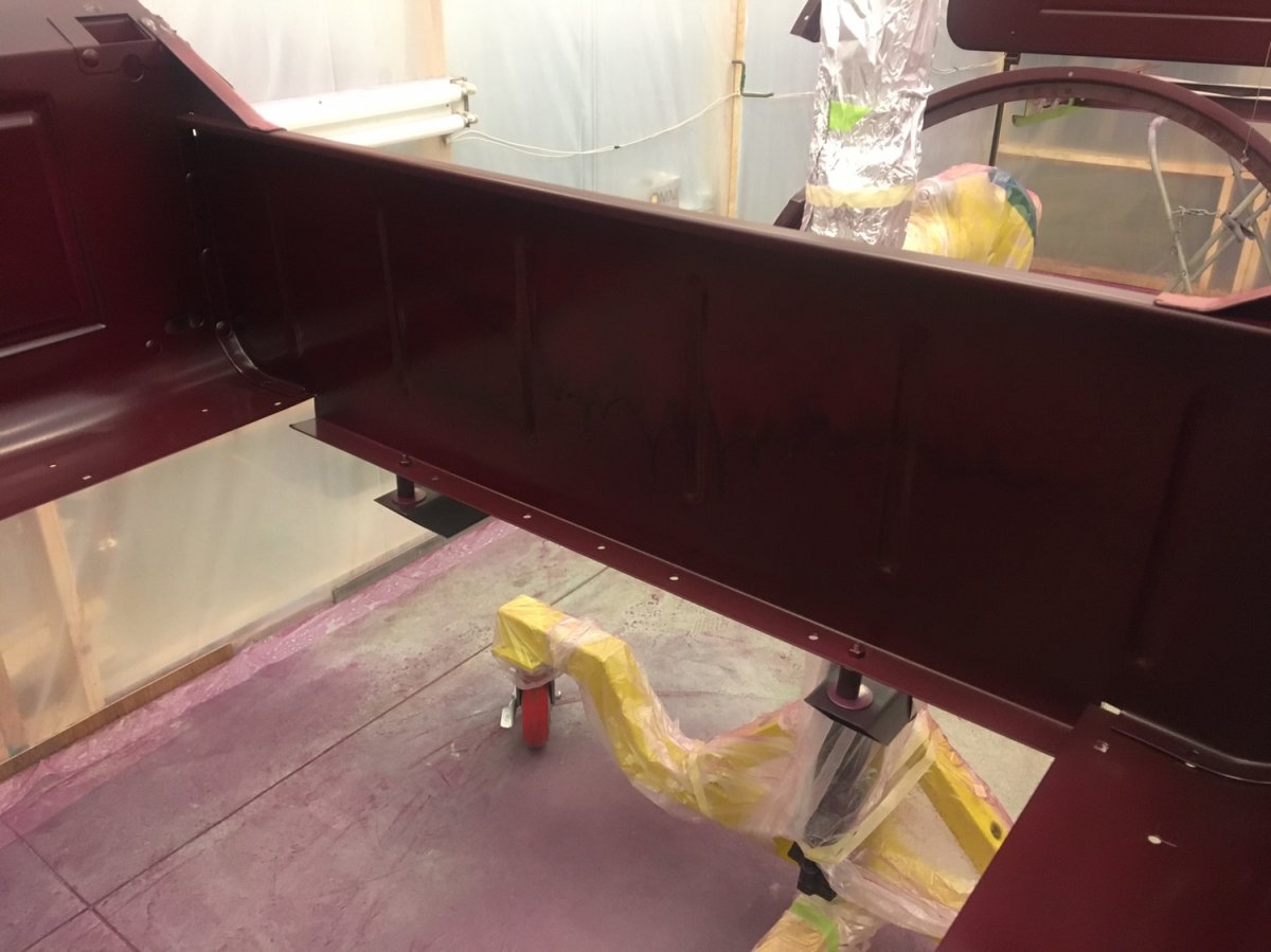

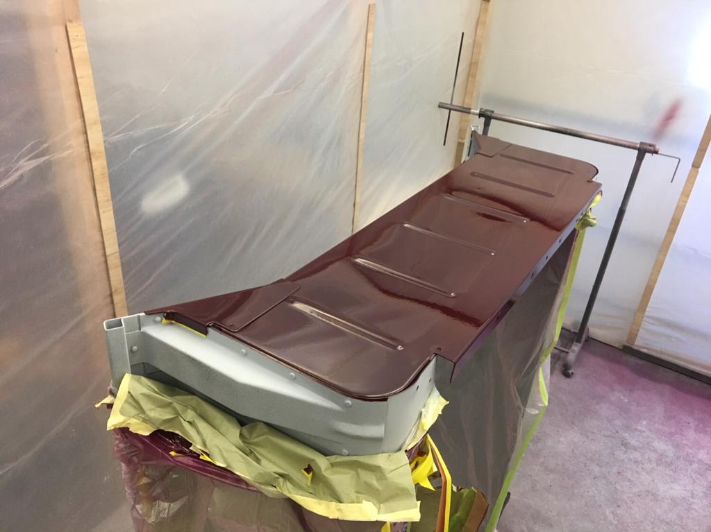

    Got all the plastic replaced and cleaned the booth all out. Had a buddy come down and give me a hand.. brought his spray gun since I just have a cheap one from local hardware store.. not sure if that was a good idea since I wasn’t used to spraying with it..
    tossed some color on it yesterday... which I think is only going to cause more work..
    Color is so dark until you put some light on it.. which is one problem I had was not near enough light in the booth. Hope to move it out in the sun outside Sunday to have a look at it.. afraid it’s going to be tiger striped or spoty..
    Even with a maroon sealer it took 5 coats of base to get it to look solid. Even sprayed each coat a different direction..
    Clear is really orange peaked but I figured that’s way better then sanding out a bunch or runs..

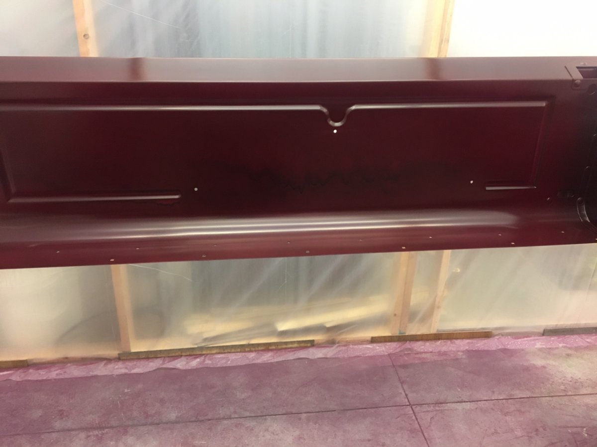

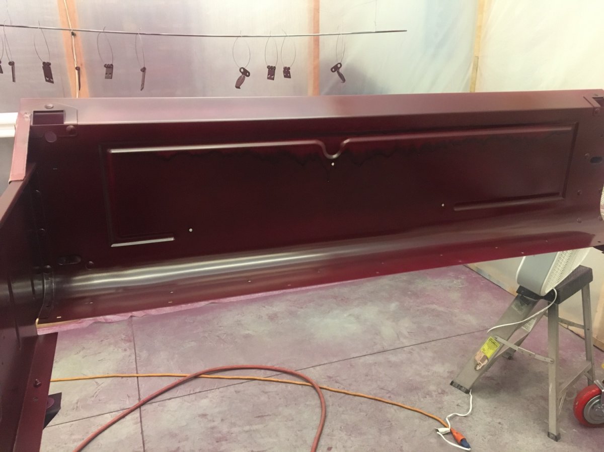

    Well painting the bed decided to become a big problem..
    I know I spray kinda heavy but... when I got more paint they gave me a different brand of reducer.. still a urethane reducer... never had this bad it runs in my life...
    So this was a week or so ago so I got extremely aggravated and just left it set.. just happened on the inside of the bed and tailgate..
    Was hoping to get this back together by spring but who knows.. I’ll get back to it sometime.
