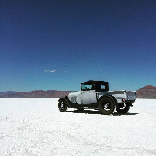

    It there is a next time, leave the salt on the Flats and have it washed by the guys at the end of the road. We had our diesel tow, trailer and race car done, we had only like two pounds when I did the final clean, and before I washed it, I knock the salt loose and put it in a bucket to take back next year. Glad you made it to the salt! Many a Rodder hesitate to 'save' their vehicles.
    twenty8tudor likes this.

    Looking back on it I should have had them spray just under the fenders I brought two cans of Gibbs with me and I could have just sprayed it after they were done.. That probably would have saved me a lot of headache and left the salt there.. I do have it all in a bucket :)
    bengeltiger and typo41 like this.

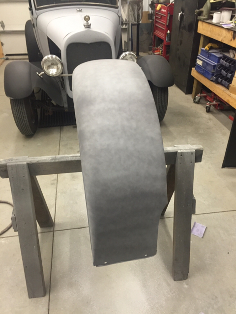

    Been putting some miles on the truck when I can.. Trying to work out some other issues..

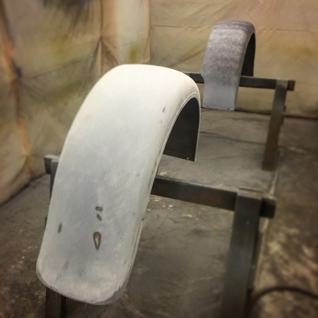

    I have a different set of rear fenders that were in better shape.. They seem to be a lot less flexible. The rear flange is a lot stronger and the bead on the outside is In way better shape..
    But one major issue was one of the rears was out of shape..
    Spent some time swinging the hammer and working it out slowly..
    Few thin coats of mud and few coats of high build primer and time for some block sanding.
    Which showed up some low and high spots
    Which a second coat of high build straightened those spots out. Another blocking and should be really close..
    The back curve is also a lot closer after all this also.

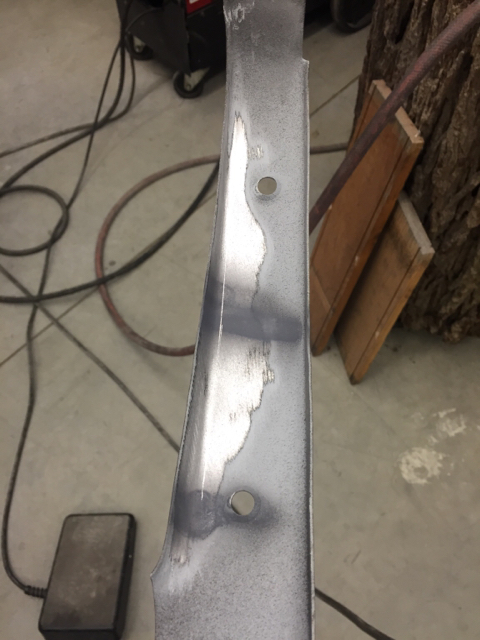

    I have the adjustment cranked all the way in on these.. I seen a few threads about doing it.. Doesn't look to bad after ya get them apart...
    Made a little progress on something that's been driving me nuts..
    The front hood shelves were only bolted down where the latches were.. The fronts stuck up and I tried twice and when I drilled and tapped for the front screw it was at the wrong angle and didn't seat right in the hood shelf..
    So had to do something different..
    Made a scribe out of scrap piece
    Ran it down the frame to mark where it needed to be
    Cut a flat piece and ground it to fit the shelf
    Welded it on and drilled the holes for the gravel pan which will hold them on now IMG_1475800910.093065.jpg
    Hammered the holes flat and welded them shut
    Skim coat of mud and primer and they are held on now.. Also had to shorten and fix the curve of the passenger side one

    Had one that was bent so I was going to use pieces out of it to fix the ones where they were cut out for the plate in the center
    Cut and welded.. Had to heat and shrink it a couple times to get it back to straight after the welding pulled it.
    Funny part is... I have a lot on my mind with trying to buy another roadster and getting the truck to the spring shop among everything else around here I ended up cutting the one good one I had left to get the pieces instead of cutting the bent one... :(
    So after all that I have to order new bed strips..
    Oh well anxious to see how the spring turns out.
