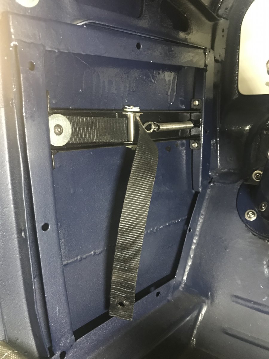

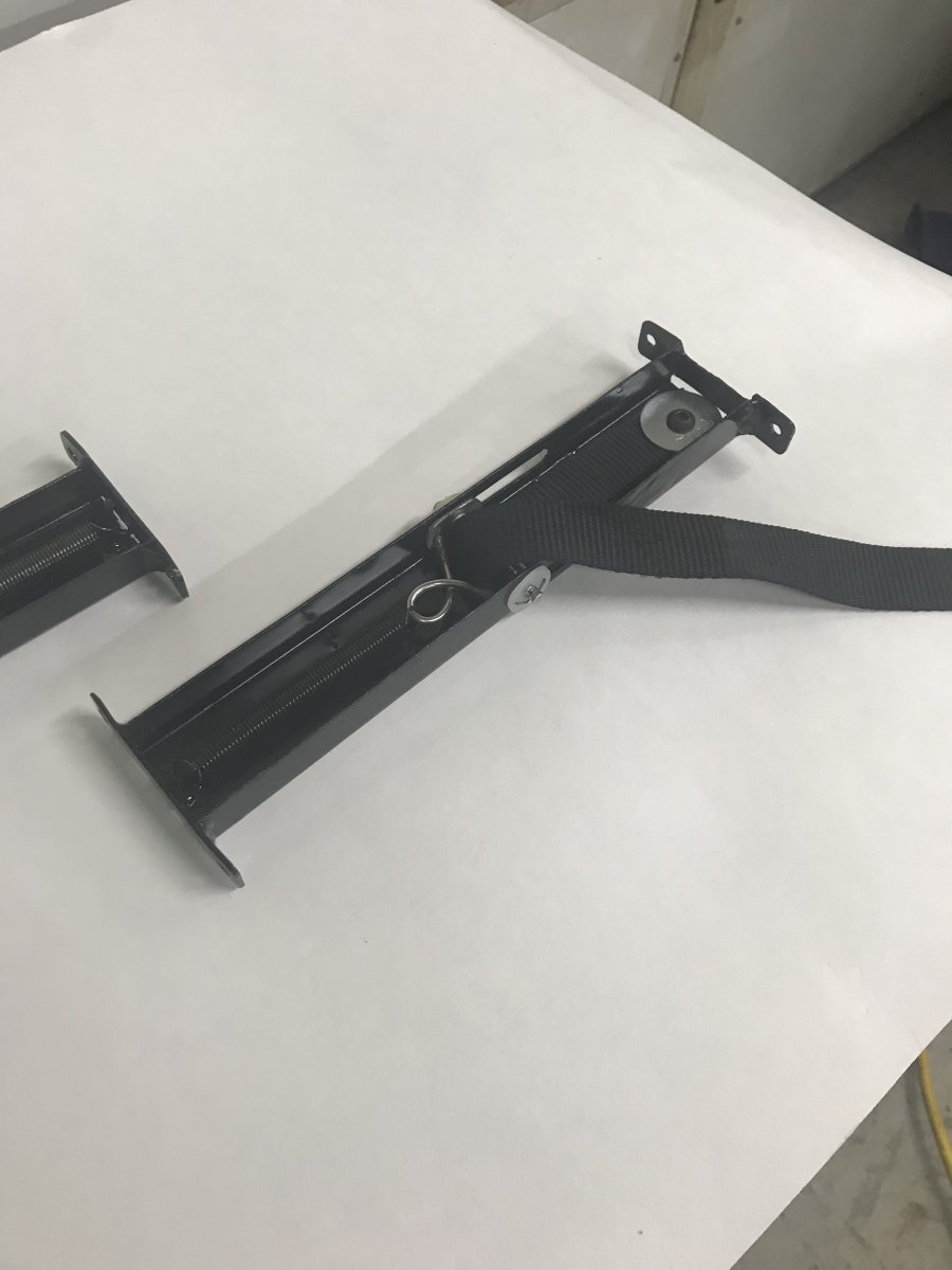

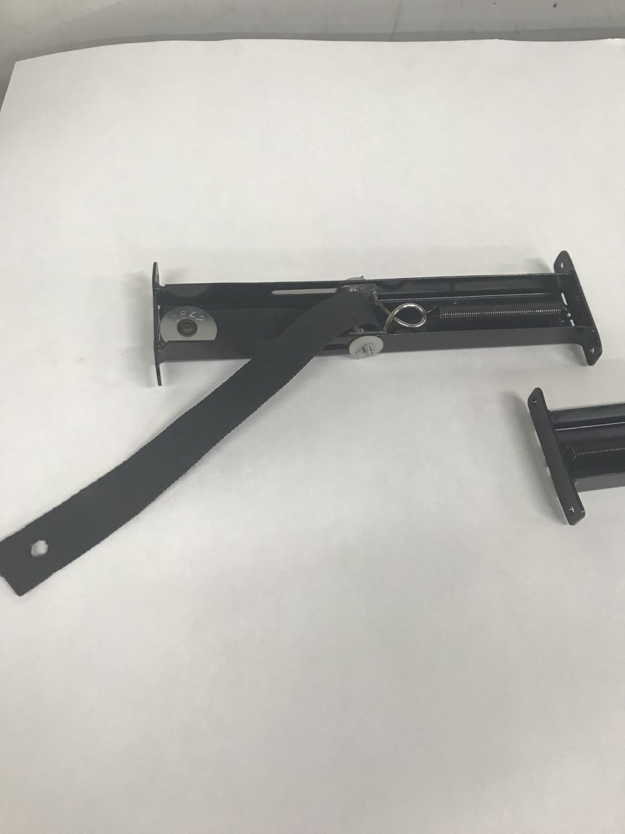

    In preparation to mount the doors I had to finish and paint my spring loaded self retractable door check straps.
    Took them apart and painted them and then because when I first installed them they were temporarily mounted with sheet metal screws, I installed 10-32 rivnuts so I could mount them with 10-32 SS machine screws.
    I also made some Teflon washers for smooth rattle free operation.
    Details ! And they’ll be hidden behind the kick panels :D
    But, I’ll be sure that my doors won’t be hitting the headers :cool:

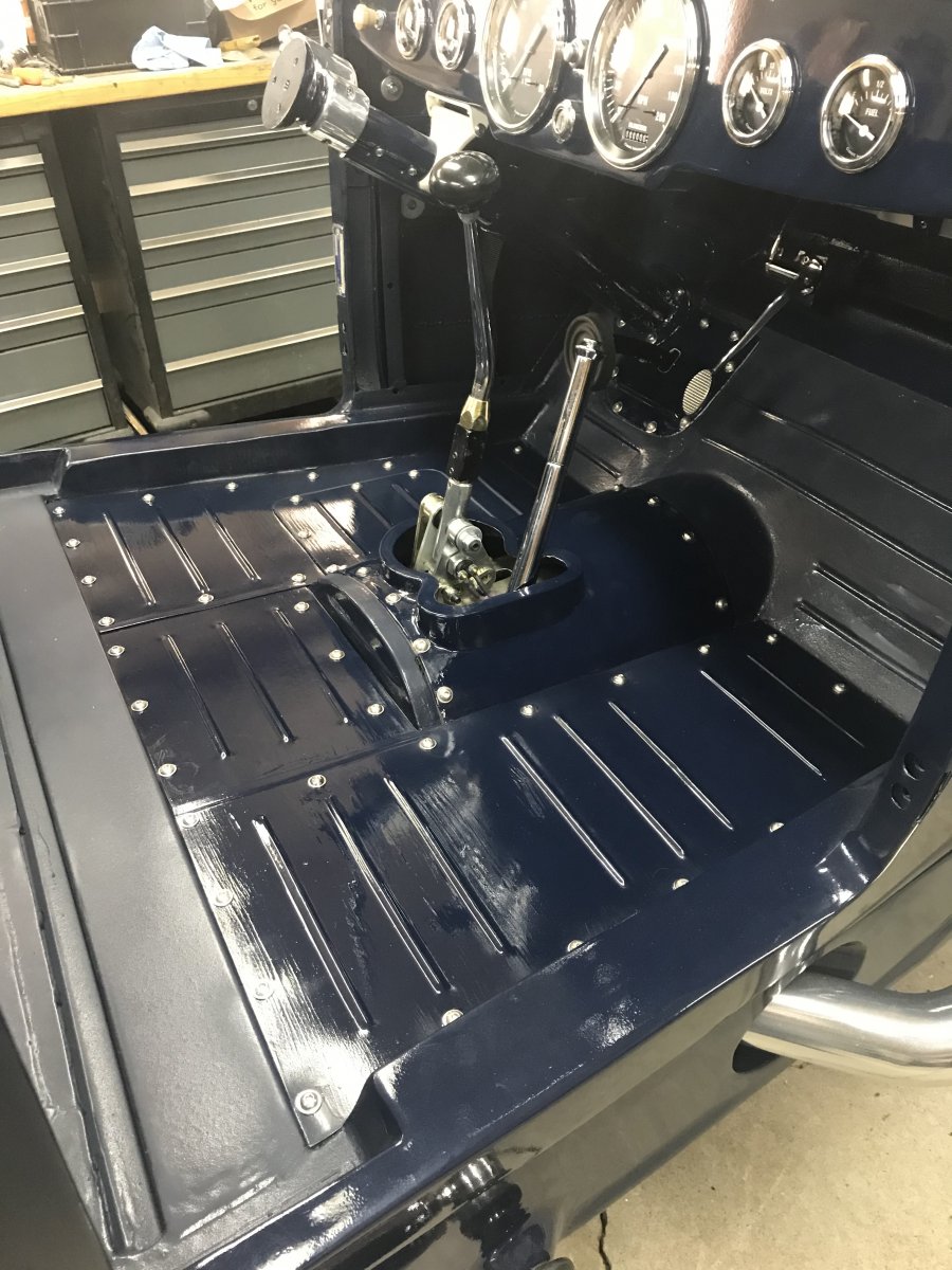

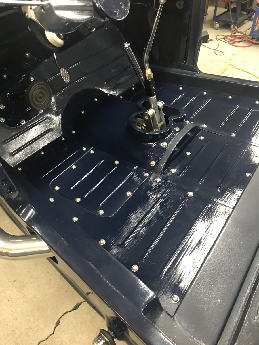

    I went ahead with installing all the removable floor panels transmission tunnel as well.
    Spent some time running a tap through all of the rivnuts to clean out the paint and make sure the threads were all clean because before I did the paint I tacked all the rivnuts on the bottom so there will never be any that spin.
    I used some 1/8”x 3/4” closed cell foam tape to seal it all up.
    3AEFAF2B-EDB4-4921-8212-559D41601C66.jpeg A6651EDF-B759-4B6D-9368-4A583B8B34CE.jpeg 330303AD-A787-4713-8DBB-9155EDE2F05B.jpeg

    I like how a section can come off by itself. Did you do anything special to put the foam on?
    I put some similar product on for weather stripping but the adhesive that was in it was garbage after a year or two. Thinking some rubber cement should do the trick
    loudbang and 26 T Ford RPU like this.

    The foam strip is a good industrial quality product with adhesive on one side that is really aggressive.
    You just peel the backing off and stick it on.
    Once it’s on there’s no peeling it off.
    For insulation I’m not sure what I’ll do yet, I do have some ideas.
    Whatever it is will have to be easy to remove in order to remove the floor panels for service needs.

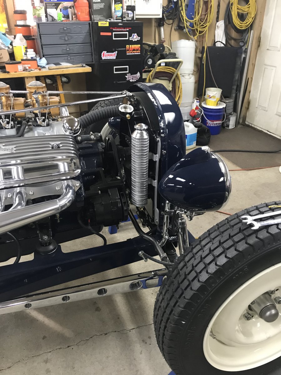

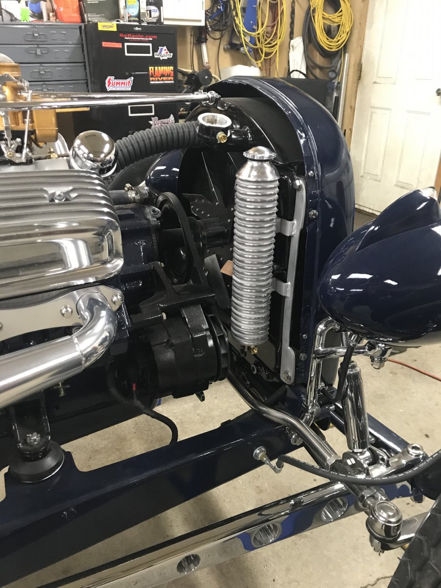

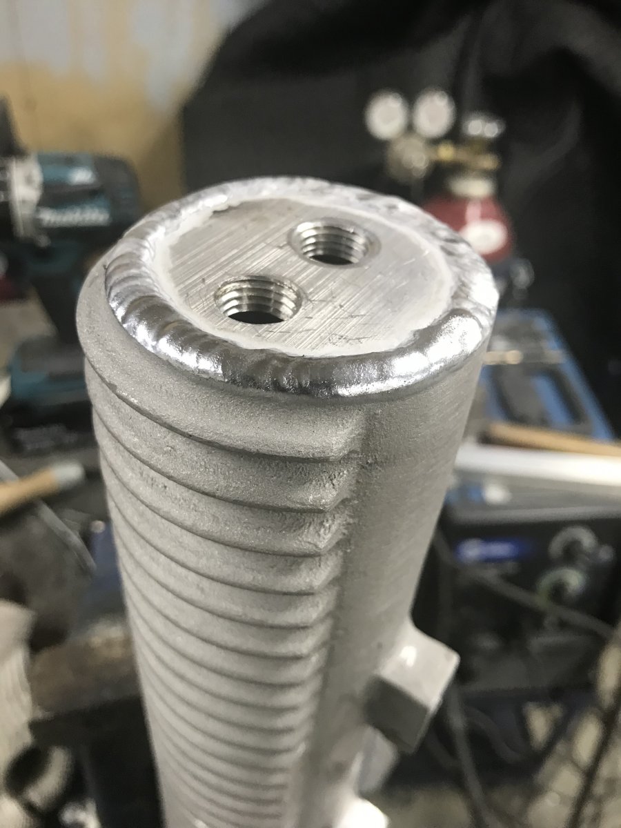

    So thinking on what to do for a radiator overflow-recovery tank I started looking around.
    I found that OTB makes a very nice one, cast aluminum with ribs like my valve covers and other parts including the air filters I’ll be using.
    The problem was that it would be too long to fit in the space I have.
    So I contacted them and they offered to sell me one in the raw not welded or finished at all.
    Once I got it I ended up shortening it by about 1 1/2”.
    A little off the top and the bottom.
    Then I broke out my TIG and welded it up.
    I fabricated a little bracket that mounts it using the bolts that hold the rad shroud.
    I also spun it on my little belt sander to flatten the tops of the ribs and then polished them up similar to the valve covers.
    I’m just waiting for an Amazon delivery of an Imperial 1/4”tube bender so that I can hard line plumb it using 1/4” NICopp
    tubing with inverted flare ends.
    Stogy, kidcampbell71, brEad and 8 others like this.
  26. Well doesn't that look the cats whiskers, very nice, BUT would be even better if the mounting bracket was black? JW
    Blues4U, loudbang, AndersF and 2 others like this.

  28. Tim
    Joined: Mar 2, 2001
    Posts: 19,626
    Tim
    from KCMO
    Did you weld in the valley or on the fin? I’m always curious when people section stuff with ribs how they went about it
    loudbang and Blue One like this.
  29. Blue One
    Joined: Feb 6, 2010
    Posts: 11,502
    Blue One
    from Alberta
    The bracket will be black, just waiting until I get it plumbed as I anticipate welding another couple of little tabs onto it for a pair of made for you clamps to hold the hard line just like I’ve done on the rest of the car. :cool:
    Thanks Dick
    See above ;)
    I ended up not having to weld between the ribs at all.
    If you cut carefully you ended up with a perfect end to work with.
    Cutting the top with the cap just above the final rib then cutting two ribs off worked perfectly.
    I cut 2 ribs off the top and one off the bottom.
    So I guess in answer to your question you end up welding in the valley which becomes the new end.
    Keep in mind I just worked with the ends and never actually sectioned anything out of the middle which would be difficult.

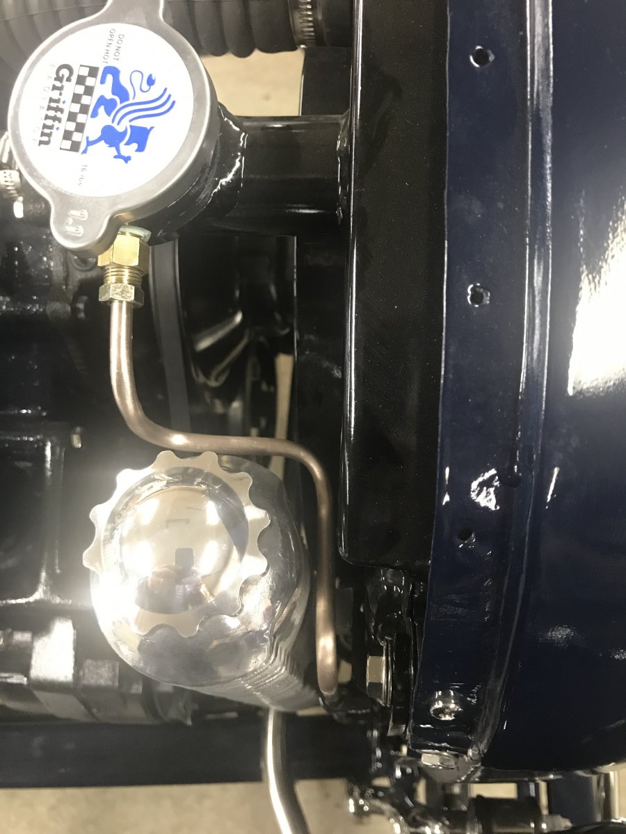

  30. Blue One
    Joined: Feb 6, 2010
    Posts: 11,502
    Blue One
    from Alberta
    For you guys who wanted the bracket to be black. :D
    The finished overflow/recovery tank installed and plumbed with 1/4” ni cop. :cool:
