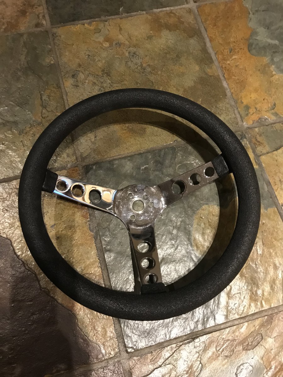

  9. Blue One
    Joined: Feb 6, 2010
    Posts: 11,502
    Blue One
    from Alberta

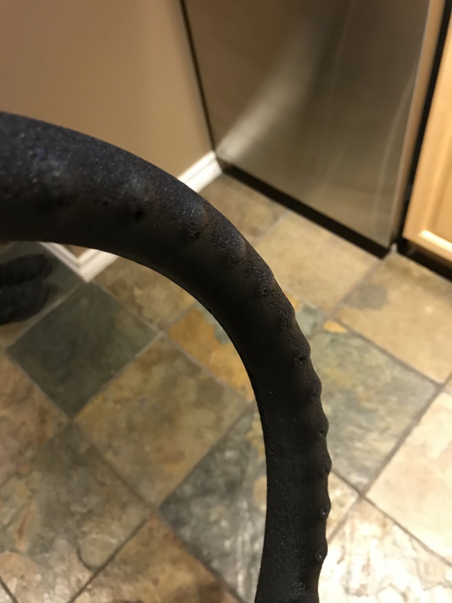

    Okay let’s try this again. I attempted to post this earlier.
    The problem with the Mooneyes wheel was the black vinyl rim that was far too thin to grip comfortably.
    While it was a nice looking wheel I wasn’t going to like holding on to it.
    I don’t have huge hands but even so the wheel was thinner than I prefer.
    So plan B.
    My original 13” Grant foam grip wheel that I’ve had on multiple vehicles since I was 18.
    There are a lot of miles, smiles and memories in that wheel.
    What makes it so rare is that Grant no longer makes a foam grip wheel in this size with the finger detents.
    I managed to polish the chrome to a point where I think it looks good.
    Then I looked at the worn foam and found a way to rejuvenate it.
    The old foam was worn and sort of gray, I taped off the chrome and gave it a liberal spray with black Plasti dip rubber.
    Because the old foam was a porous surface it has bonded really well and it looks and feels good.
    I’m happy to be able to keep it as it holds a lot of memories and it’s always been a comfortable wheel to drive with. :cool:

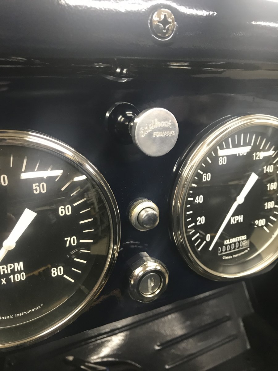

  19. Blue One
    Joined: Feb 6, 2010
    Posts: 11,502
    Blue One
    from Alberta

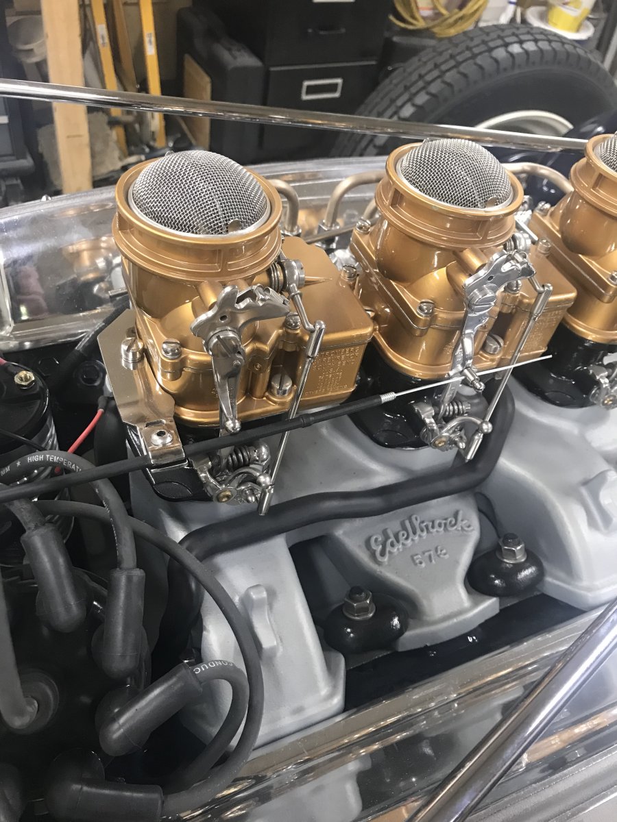

    Choke cable shrink tubed and installed.
    5D6862EA-03E2-4DD0-A7B4-4392916F5A65.jpeg 1199DBA8-161F-4878-BB6C-87D4953B3914.jpeg
    brEad, Dino 64, 32Dan and 13 others like this.
  20. Tim
    Joined: Mar 2, 2001
    Posts: 19,623
    Tim
    from KCMO
    Really like that! I assume it’s the standard spring/wound wire cover under the heart shrink? Great idea.
    The knob is cool as well, is that a currently available piece? Havnt ever noticed one before... not that I probably bother to look at choke knobs most the time haha.
    Current one in my 46 binds and catches horribly so im in the market for a better one.
  21. loudbang and bobbytnm like this.
  22. Tim_with_a_T
    Joined: Apr 30, 2011
    Posts: 1,656
    Tim_with_a_T
    I like the shrink wrap on the choke cable. I also like the Edelbrock knob- I bought a few of them just so I could steal the knobs off them lol.
    loudbang, brad2v and Tim like this.
  23. Blue One
    Joined: Feb 6, 2010
    Posts: 11,502
    Blue One
    from Alberta
    The choke cable is a standard Edelbrock manual choke cable I ordered from Speedway.
    It’s the usual spring wound cable and I just covered it with the shrink tube.
    I think it’s cleaner that way.
    loudbang, Tim, bobbytnm and 1 other person like this.

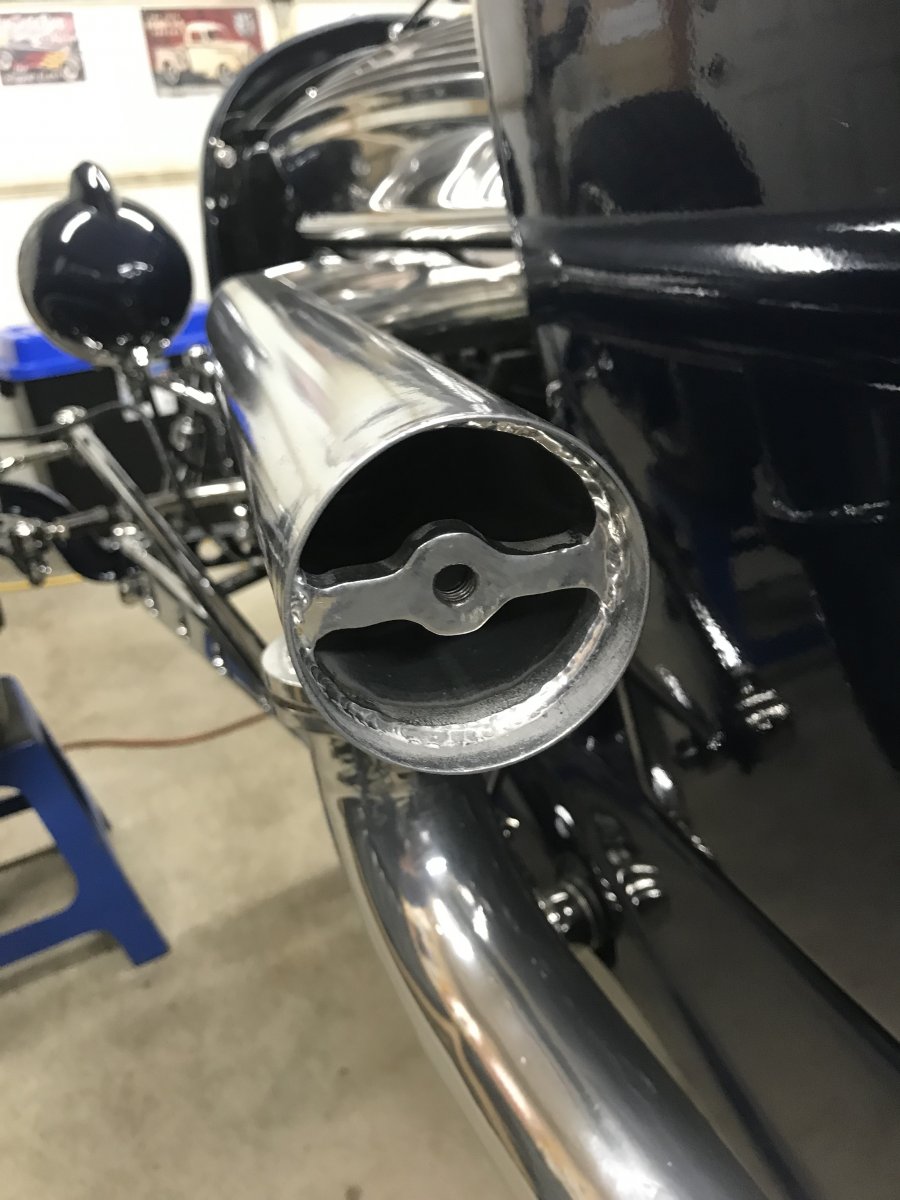

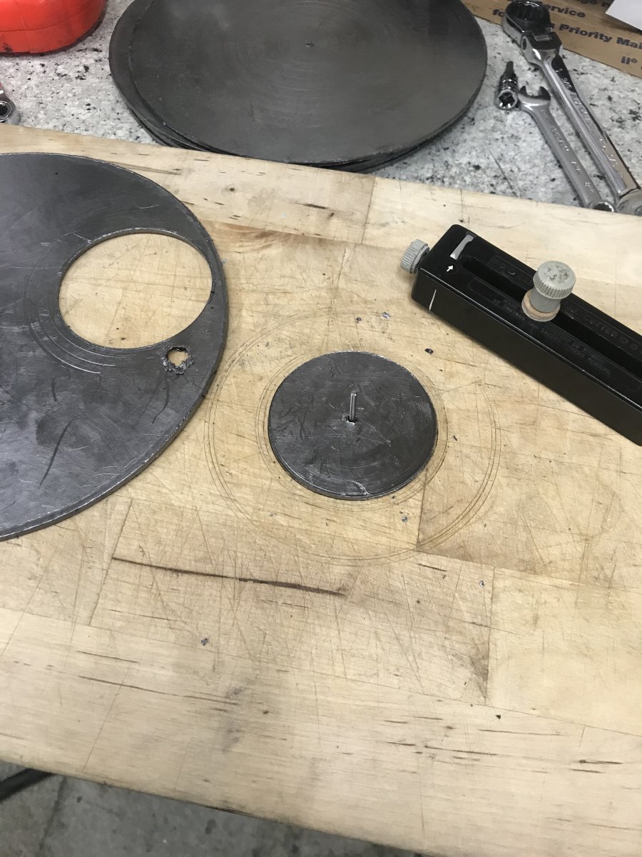

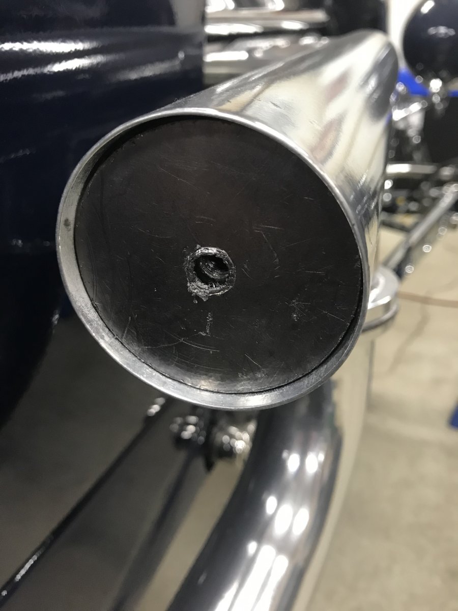

  28. Blue One
    Joined: Feb 6, 2010
    Posts: 11,502
    Blue One
    from Alberta

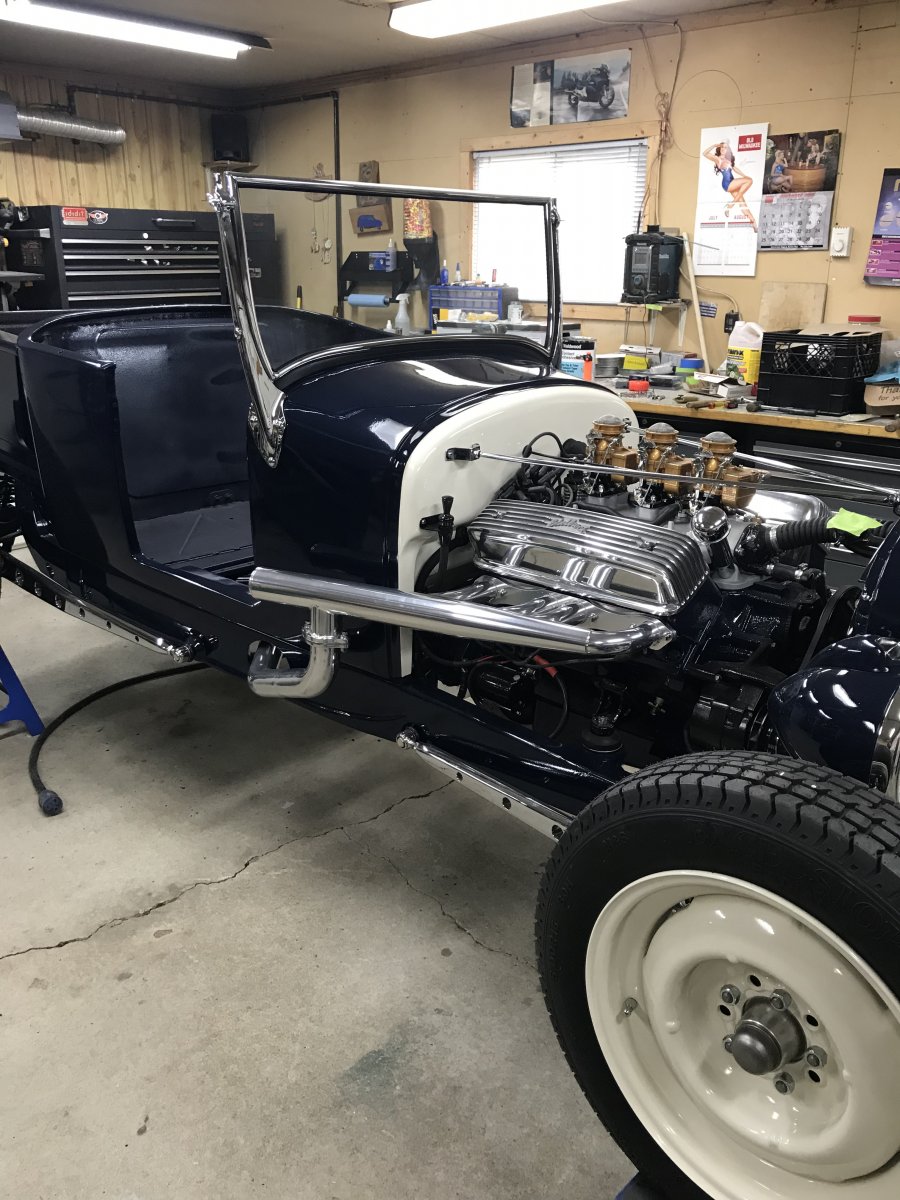

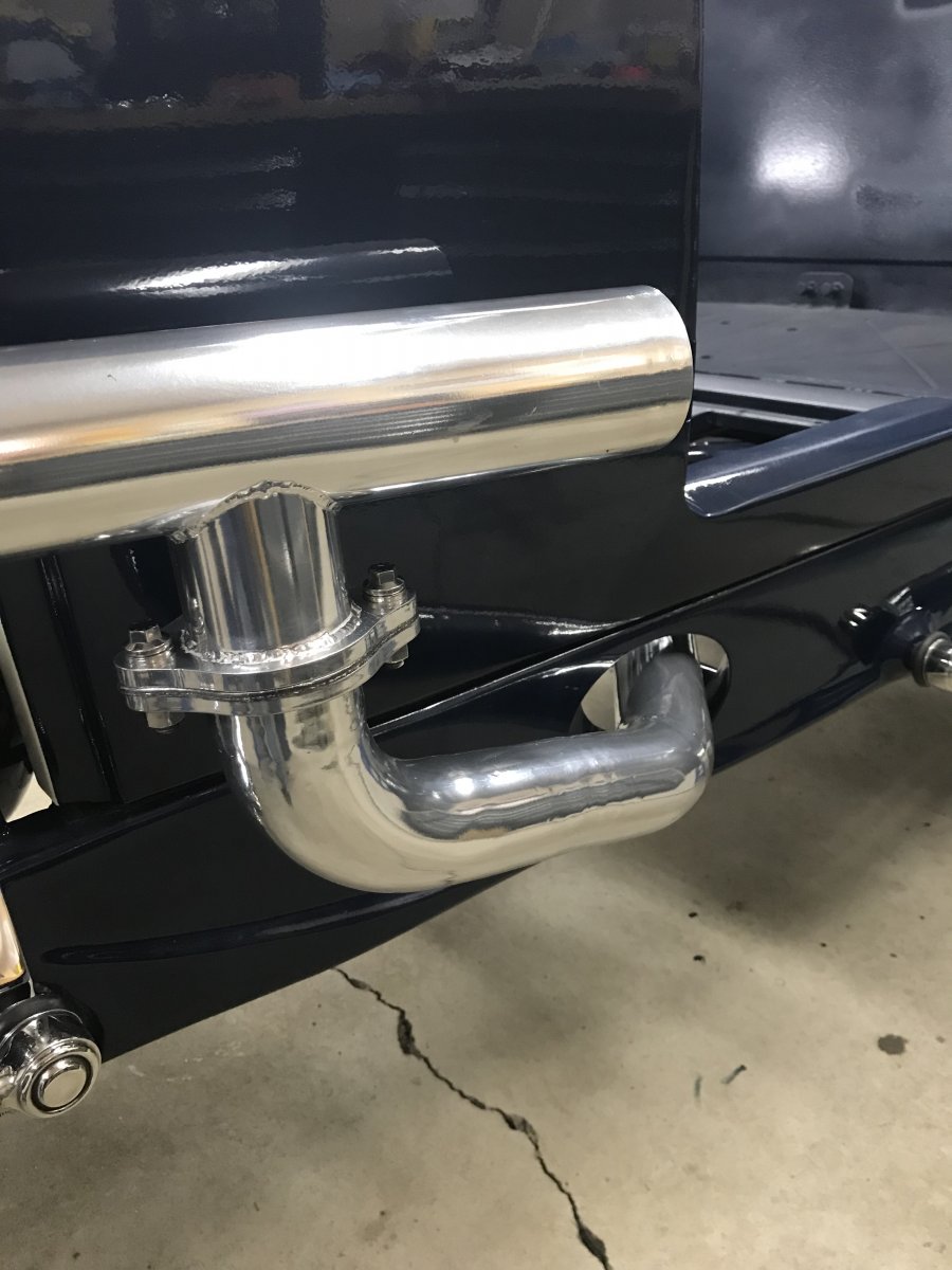

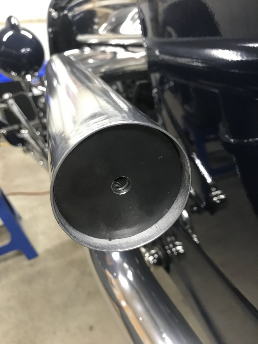

    I installed the Gear drive driveshaft tube style lake headers today.
    I’m sure glad I got Matt to build my pair before he quit building them.
    I installed them using the Remflex high temperature graphite-foil header gaskets and the custom gaskets they also made for my exhaust system flange connections.
    After that I made a couple of steel discs to go behind my aluminum header end caps and also cut some discs of graphite-foil gasket material for them.
    Mission accomplished, exhaust system wrapped up. :cool:
    One less thing to do. :cool:
    703A90C0-0FA2-4AED-A9C3-93B78A7058F9.jpeg 2091A6C5-8180-4DF2-AE19-0F0D7D64B9D1.jpeg 02543437-CA1D-44A2-BE55-14D626F377A5.jpeg 26B3DF62-A17C-4283-8BEE-282DCA5C7C5A.jpeg 8C570F12-00D2-423A-95CB-101E6D12ED04.jpeg DD0309D5-452E-435B-BE1B-5C5BF25336AF.jpeg 679A64AB-3E25-4803-ADC5-15C33CEFBA89.jpeg 8B5B1F02-1428-492B-B5BF-CB4D549EA049.jpeg E4B34F36-F770-427B-901B-04AD26B0A492.jpeg

    Love the exhaust system.
    loudbang and Blue One like this.
