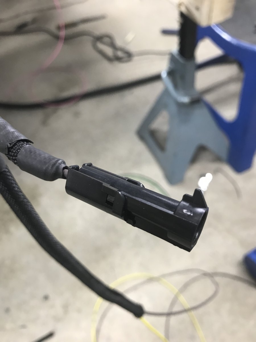

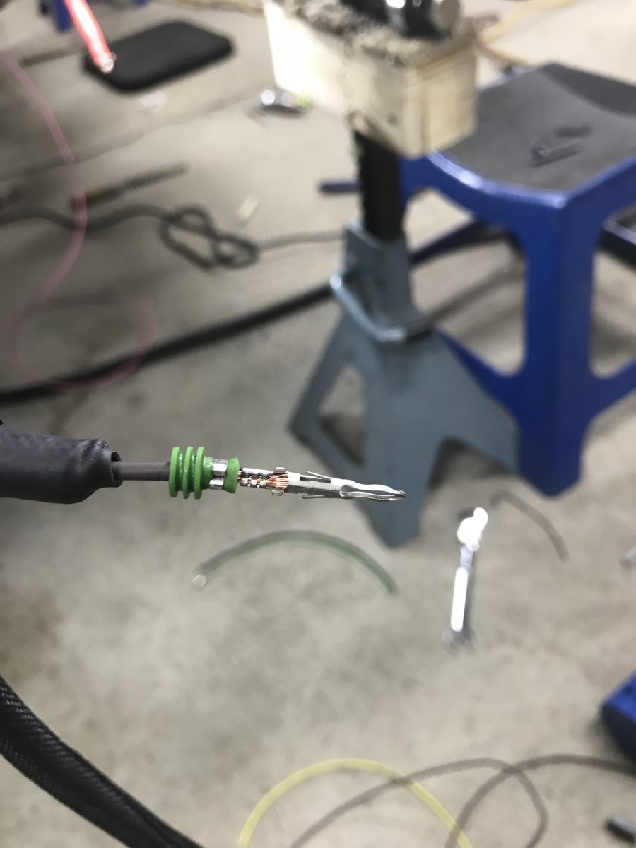

    Proof of life :D I’m using weatherpack connectors for my tail lights and license plate lights and hooked up some power for a little test. :cool:

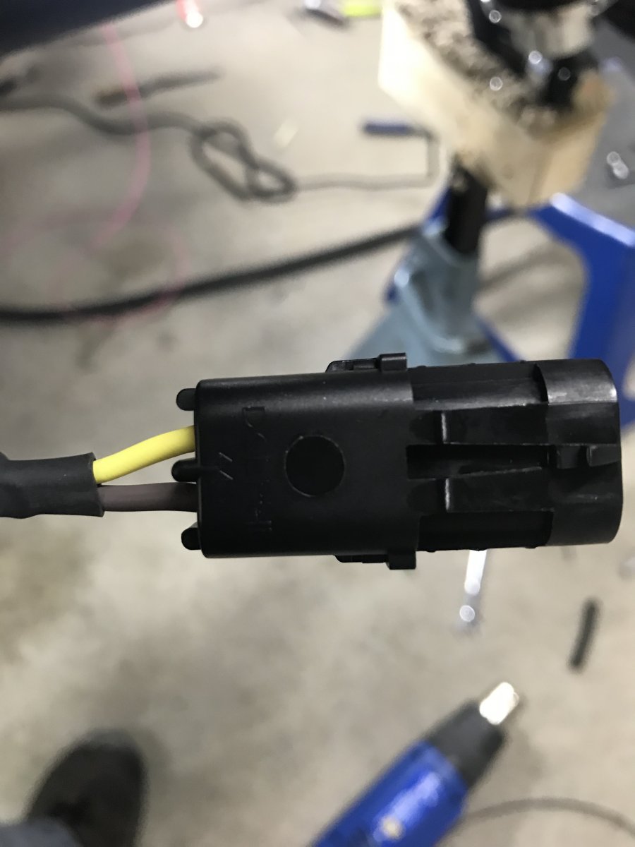

    Single weatherpack for the licence plate lights and double for the tail lights. :cool:

    Woohooo! and it looks like all the smoke stayed inside the wires...awesome!
    Those weatherpack connector systems are very nice. They make for a clean and worry free connection. I used several of them for my front end wiring on my 49 Ford truck. When I need to pull the front clip I just open the connectors and I'm all set.

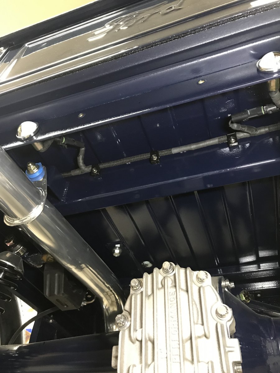

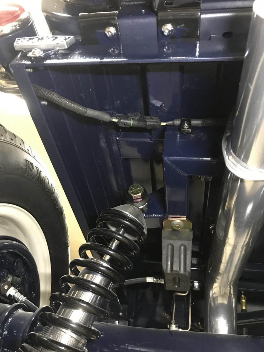

    Rear lighting done. Secured in place working as it should :cool:

    from So Cal
    Very clean job, nice!

  23. Sparked
    Joined: Oct 23, 2016
    Posts: 63
    Sparked
    It's getting closer and closer to being done. Excellent craftsman ship as usual Larry.

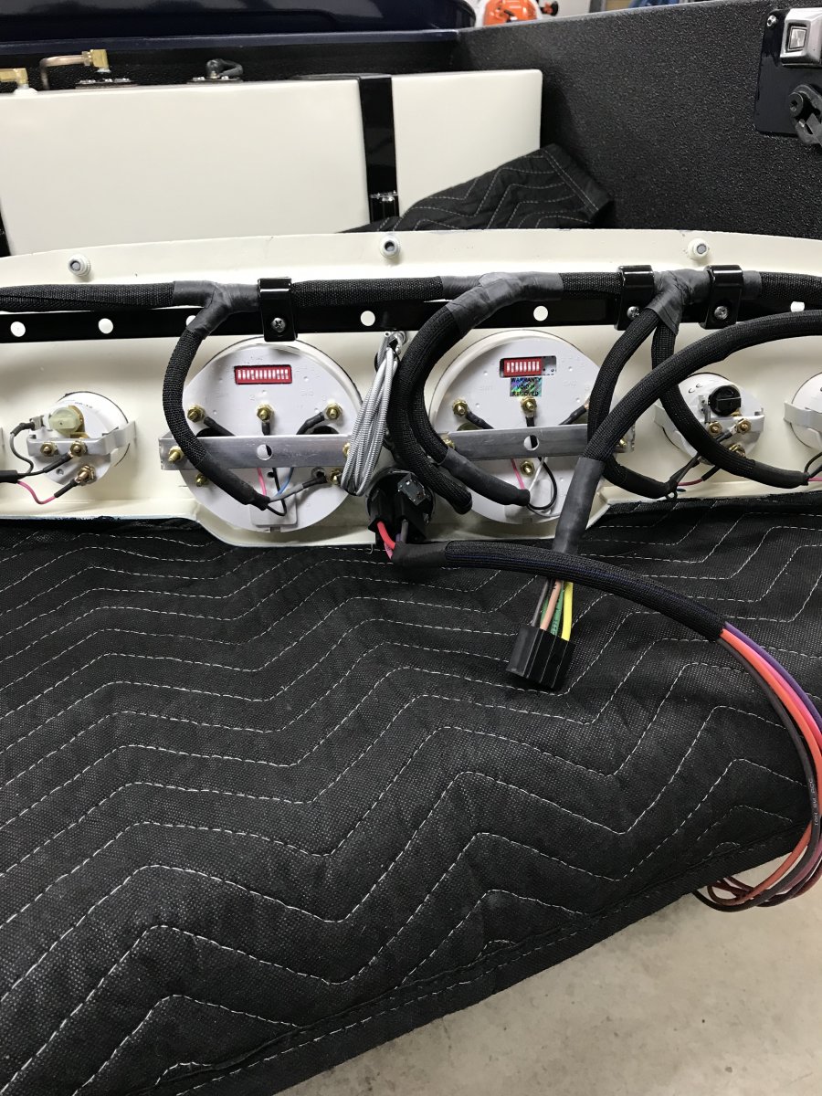

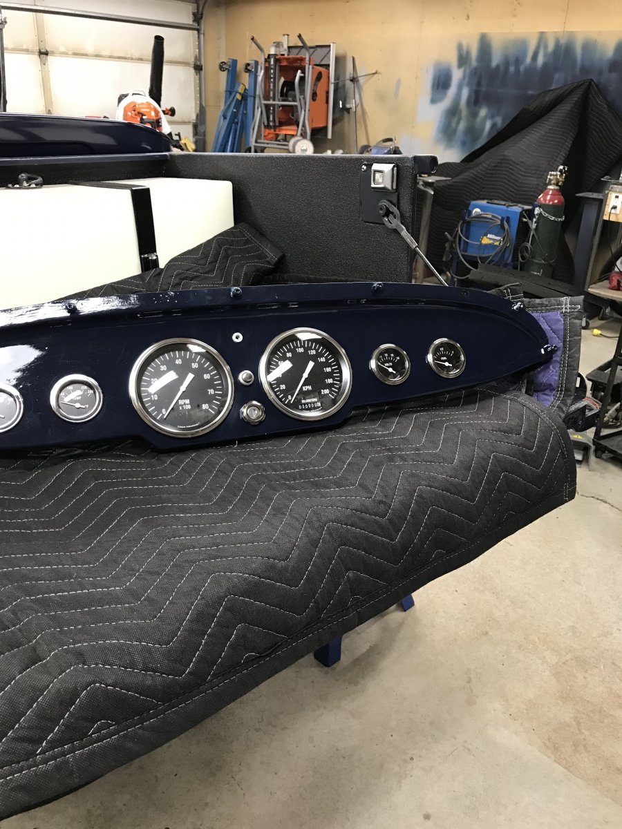

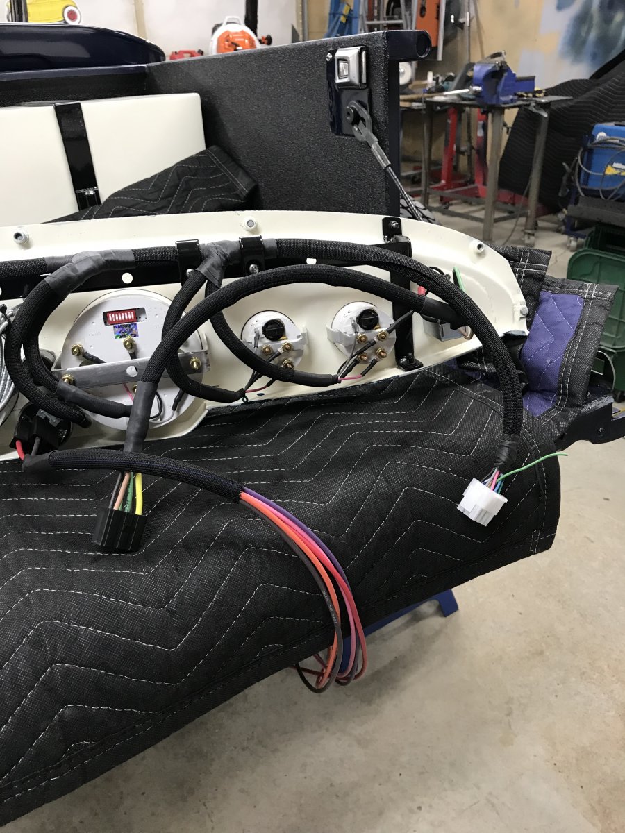

    A little more progress today.
    I decided that I wanted to support the gauge wire harness on the back of my dash.
    So, I fabricated a little bracket that mounts to the back of the dash and is held in place by 4
    10x32 countersunk machine screws.
    That way I could loom and mount the harness using more Made for you T clamps.
    After that I had my wife provide an extra set of hands and we installed it and kept all the paint intact. :cool:
    Moving along closer to the road :D

  25. Very nice, Larry :cool:. JW
    Blue One and loudbang like this.

  27. The 39 guy
    Joined: Nov 5, 2010
    Posts: 3,728
    The 39 guy
    That is one super clean wiring job on that dash Blue One. It's a shame no one will be able to see it when looking at your car.
    loudbang, Blue One and brad2v like this.

    Thanks guys, this is one reason why I have taken so long to get to this stage in the build.
    I’ve done this sort of thing on every inch of this project even though you won’t see the majority of it.
    But driving down the road I’ll know how I built it :cool:
