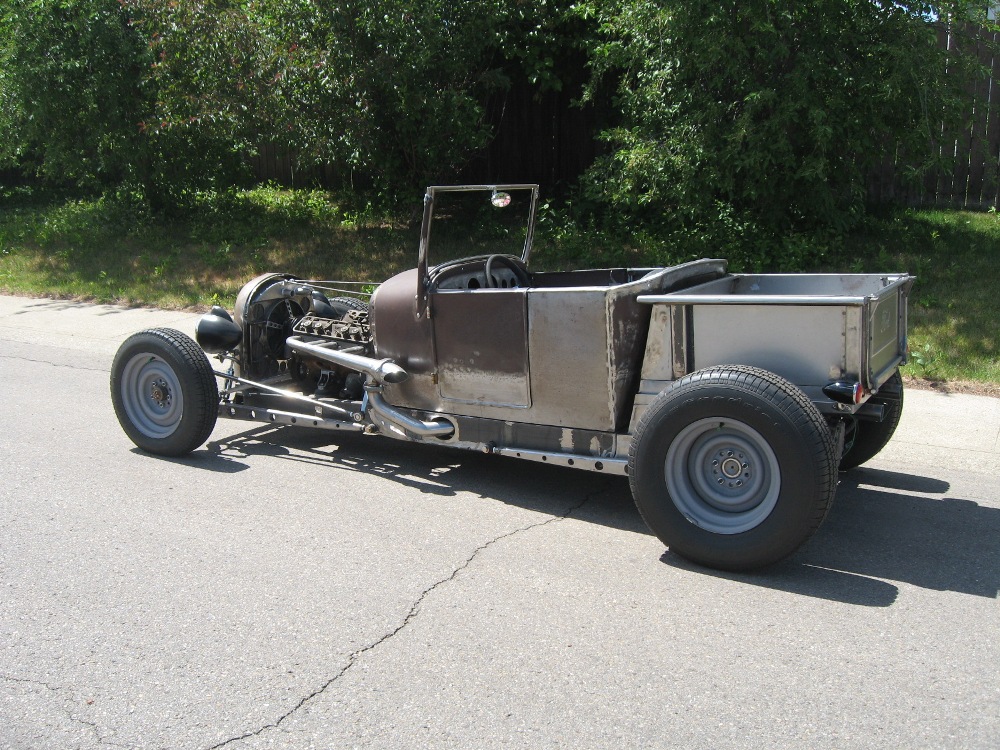

    I do have shots with the old wheels and tires (Excelciors on now) before I tore it down for paint and chrome.
    Also before the drum brakes.
    The headers are slightly different now too.
    I threw in a few shots of it in Rod Tops shop in Michigan when I had the top built.
    It’s come a long way from the start of the build back in 2010.

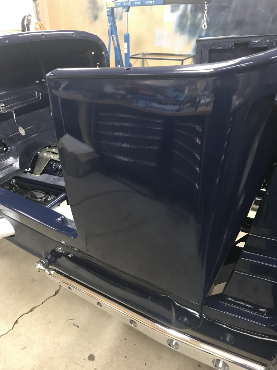

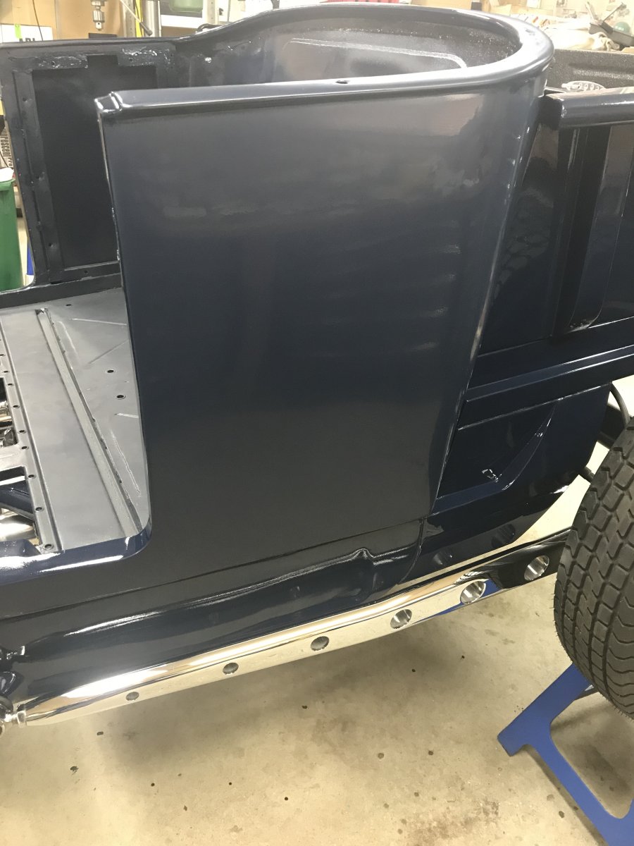

    So in anticipation of getting my windshield back with glass in it and wanting to install it I broke out my pile of 3M stuff I got last winter in Texas and started cutting and polishing the cowl.
    Trizact foam backed discs wet, first 3000 and then 5000.
    After that 3 steps of 3M perfect it polishing compound.
    370E1AC9-C25E-47E8-94F7-6C07179B631F.jpeg A6FA6C9D-4057-4B8B-920C-E1FB0906307B.jpeg

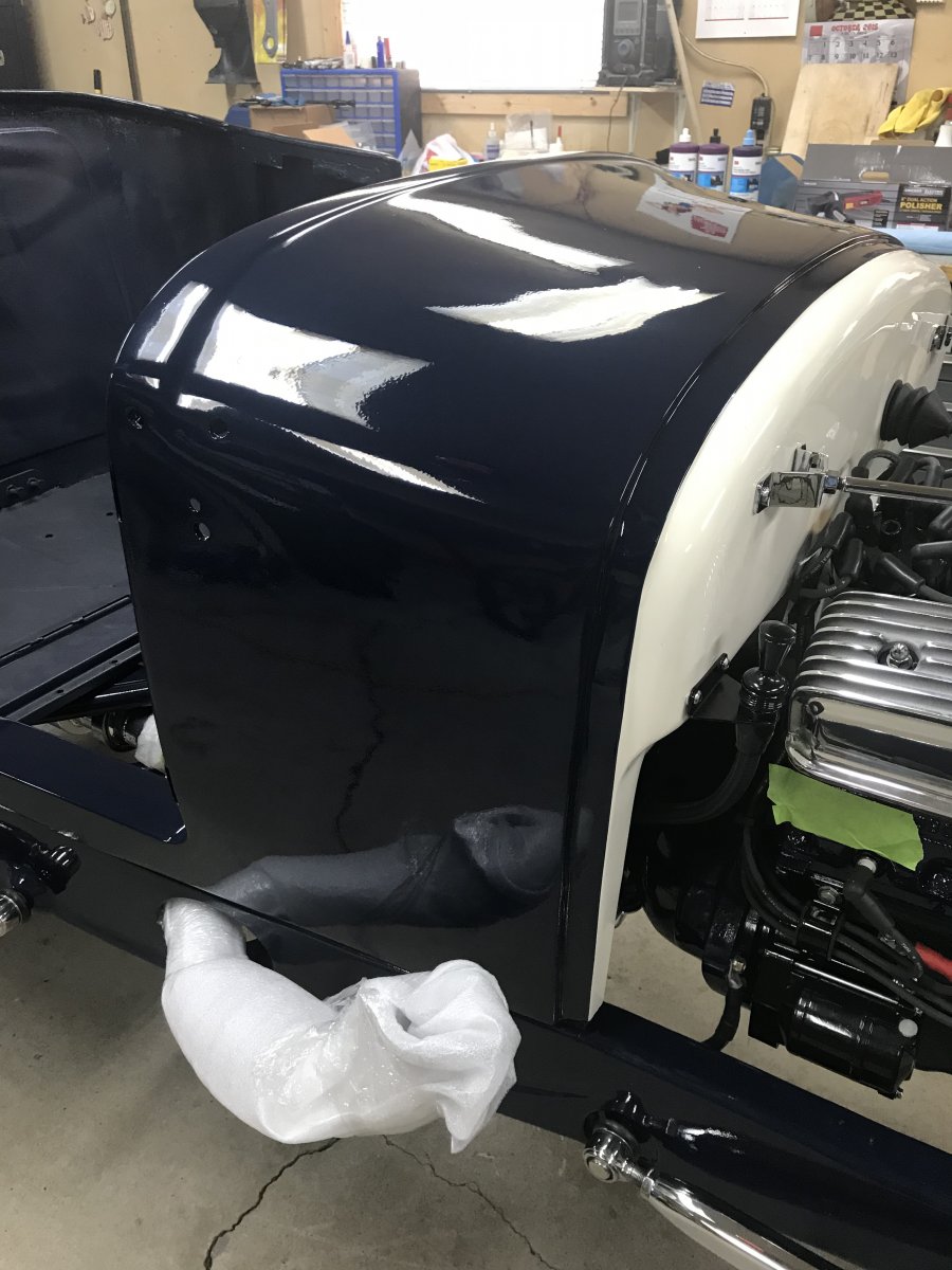

    And then all shiny :cool:
    E5258568-6EB0-428E-A470-7ECB86A85C6E.jpeg 134593EA-90A2-4B49-9C45-9214184D4C66.jpeg

    And the other side.

    I don’t know man, not feeling the foam heat sheild on the exhaust. I’m more of a pool noodle kinda guy but to each his own.
