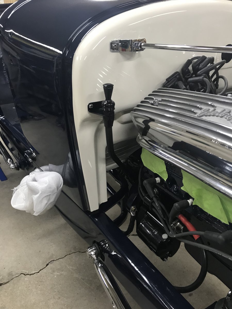

    Some careful measuring allowed me to shorten my midnight black lockar locking transmission dipstick.
    Then I mounted it to the firewall and also installed my radiator support rods. :cool:

    Hey @Blue One is your Tranny Dipstick and tube flexible?...Mine is attached to the Bellhousing to block (GM) and rocks with the motor. I'm gathering your motor and tranny mounts are fairly rigid...or it would bend or stress that filler tube...Hotrods really coming together nicely...
  5. Blue One
    Joined: Feb 6, 2010
    Posts: 9,297
    Blue One
    from Alberta
    Thanks
    yes it’s flexible, braided stainless tube covered with braided black nylon cover.
    There is a little room for movement although yes my mounts are pretty rigid.
    Stogy likes this.

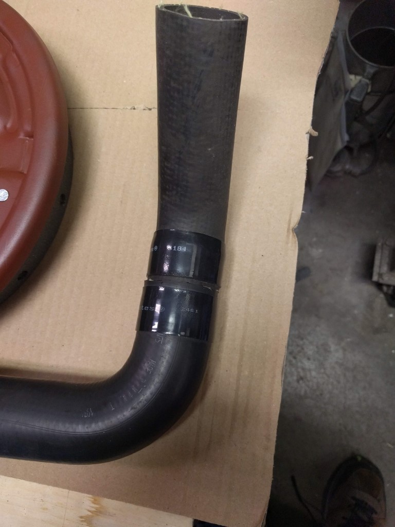

    I had to combine two hoses to make the upper hose on my '47. To be less obvious, I used a couple of the shrink clamps at the splice; hope they work as advertised.
    brEad, AndersF and Blue One like this.

    Interesting, not sure I’ve ever seen them before.
    I wonder how well they work.

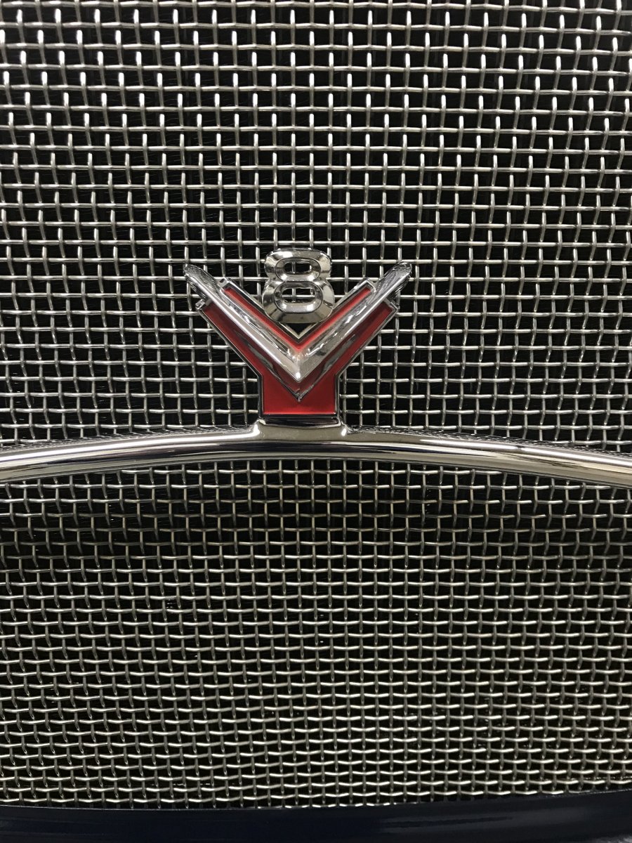

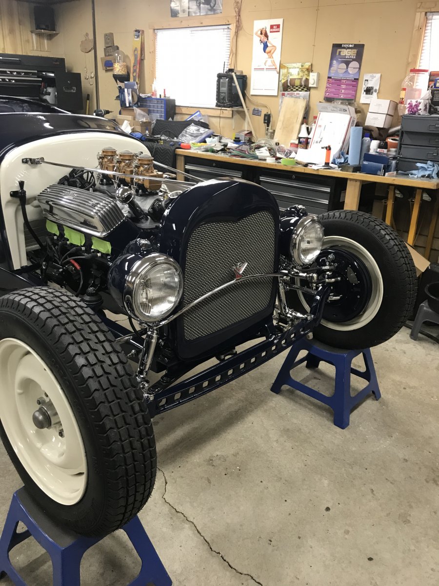

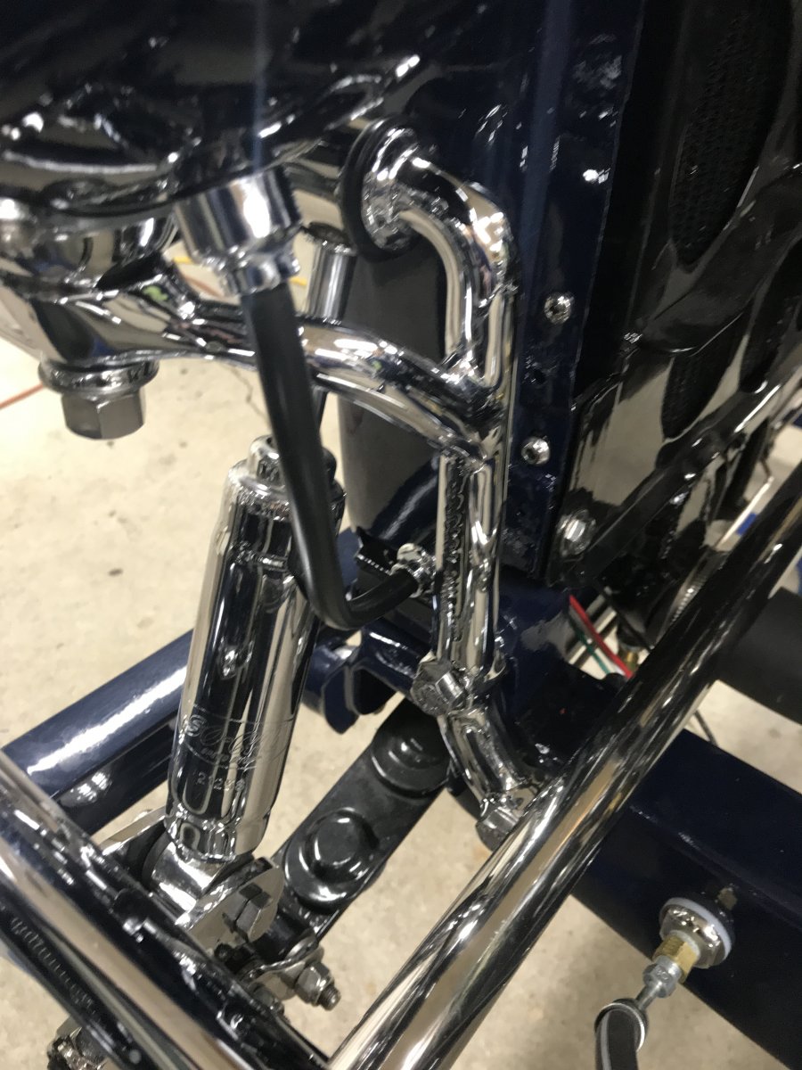

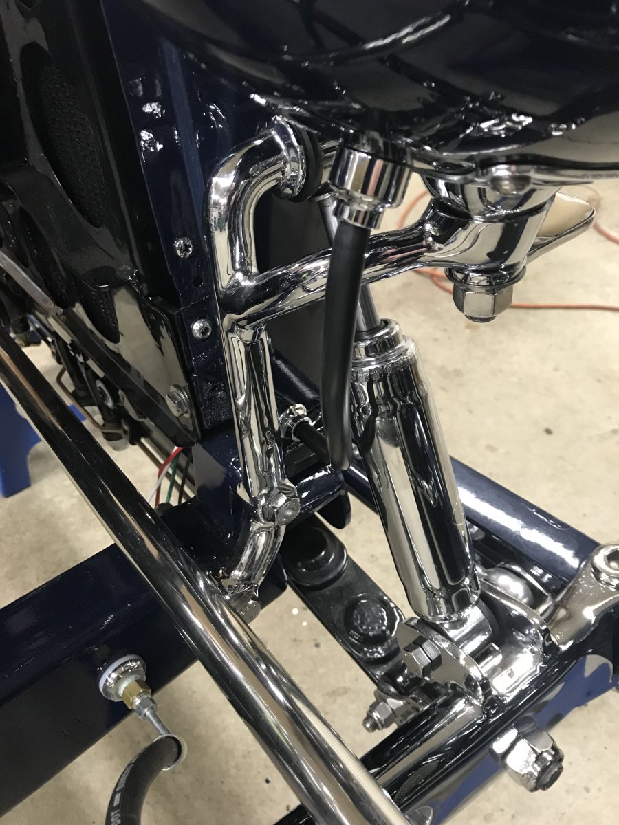

    So, today I installed my grille shell along with the stainless mesh insert I had made for it.
    That along with the OTB guide headlights and the crossover bar I built and had chromed, also bolted on my YBlock emblem.
    I wired in the headlights and the park lights and turn signals and installed the wires through black OTB looms to the bottom corners of the grille shell.
    The headlights are Silverstar halogen.
    Looks even more like a hot rod now. :cool:
    Happy thanksgiving to all our Canadian members :cool:
    Larry

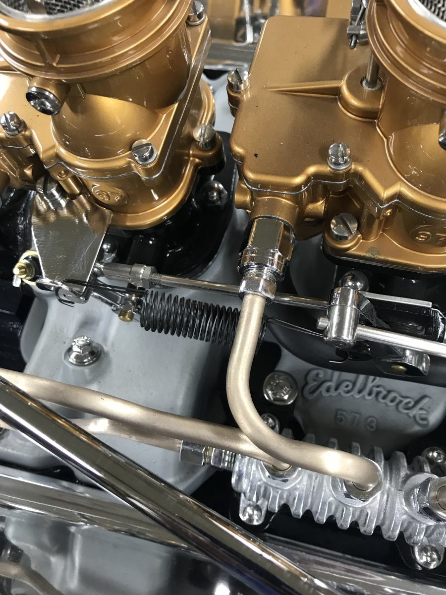

    Just plugging away before turkey dinner.
    Installed the throttle linkage and the pedal.
    An important part of that is the double return springs. :cool:
