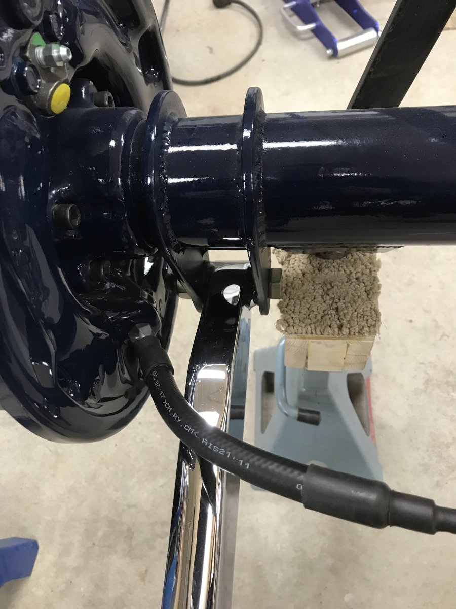

    I had to route my e brake cables such that they would be clear of the exhaust and driveshaft.
    I started with a pair of rubber block type exhaust hangers and removed the steel rods so that I could use them to hold and guide the cables.
    I also slipped some rubber hose over the cables and used a little shrink wrap on them to protect the cables and also the chrome where they pass over the lower wishbones.
    I then fabricated a nice little bracket to mount them.
    From the support bracket it’s a straight shot to the trans mount hand brake.
    After that everything was bolted in place and I moved the suspension up to the bump stops and as far down as it would go to see if there was any pull on the cables or any contact points.
    It all worked perfectly. :cool:

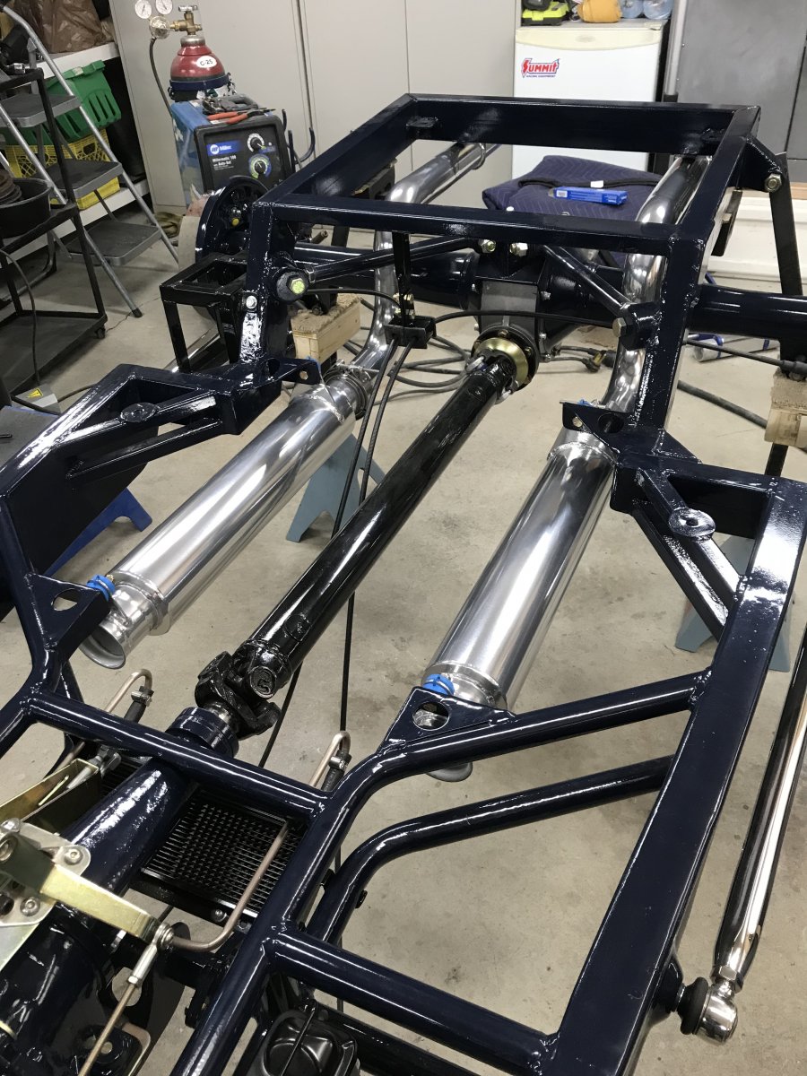

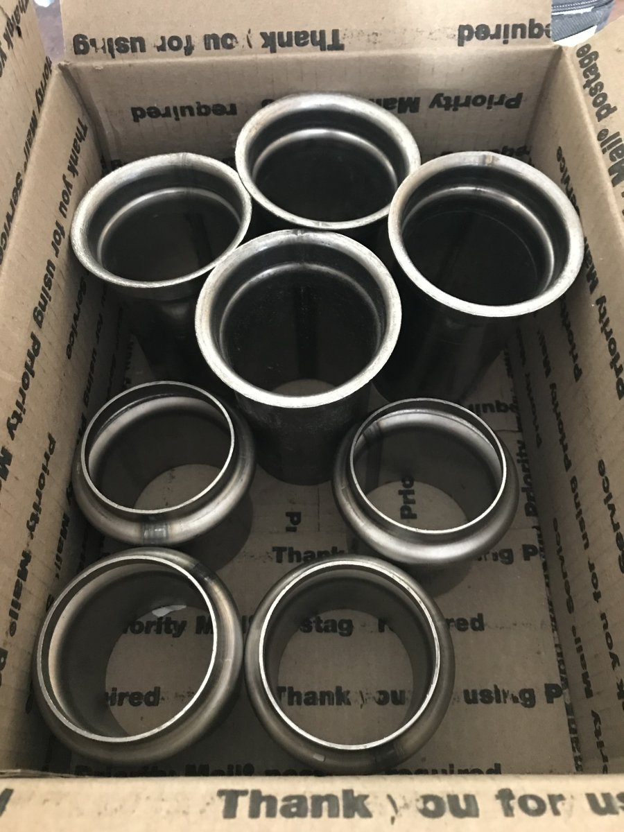

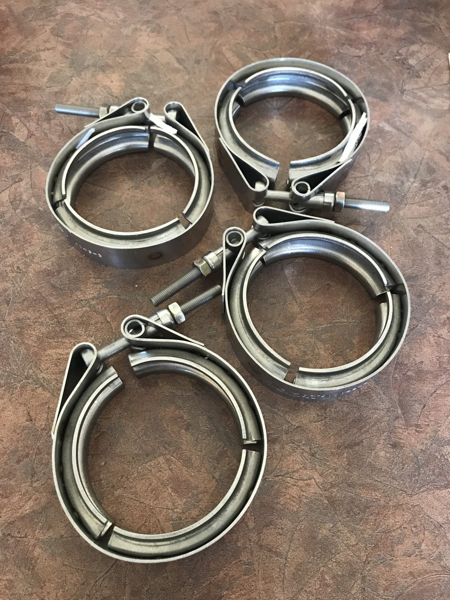

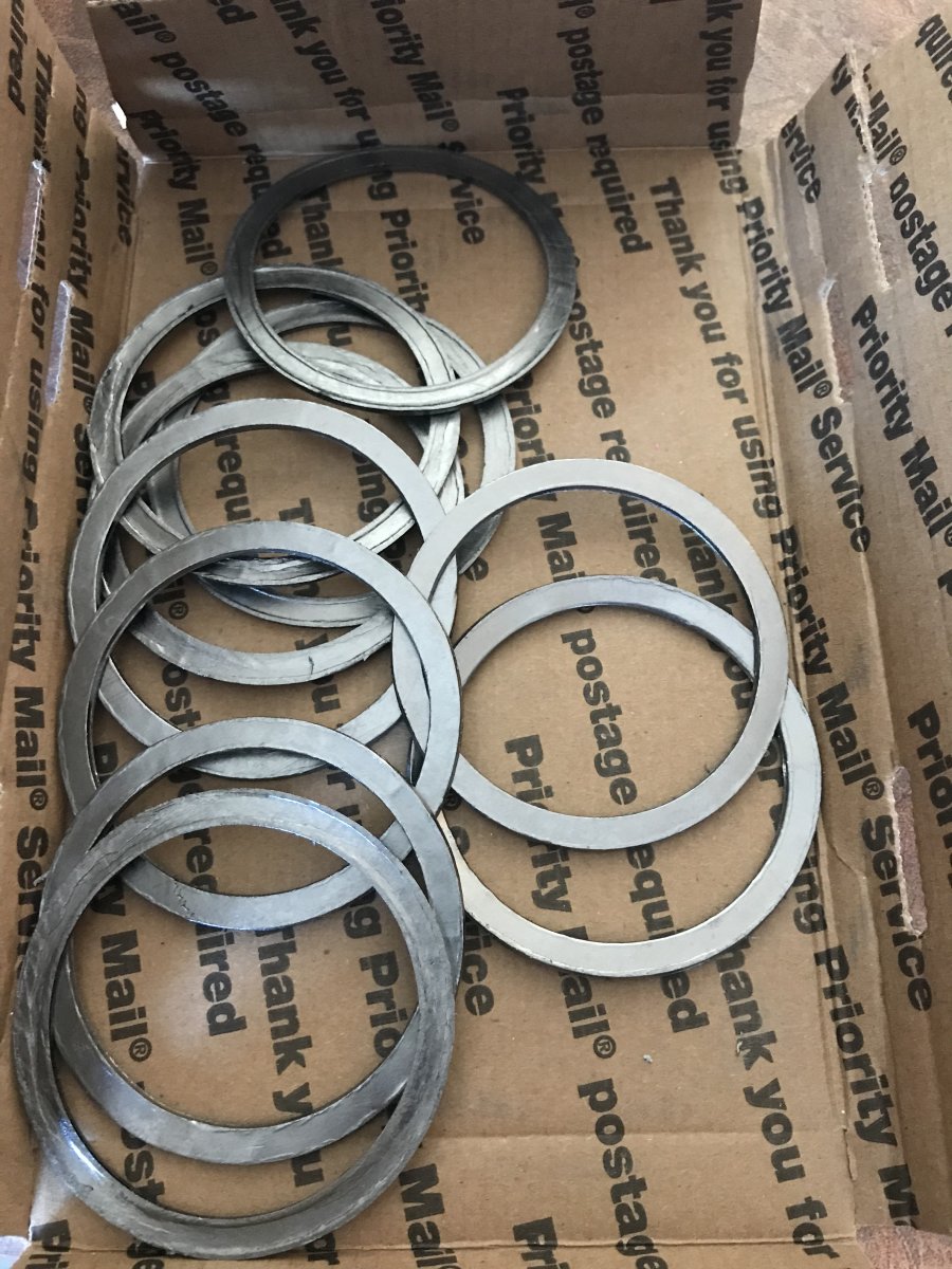

    Got a package in the mail today and I’m impressed with the quality of these Marman exhaust joints.
    They came with Remflex type sealing rings for insuring a truely leak free joint.
    Perfect.
    My weekend is set :cool:

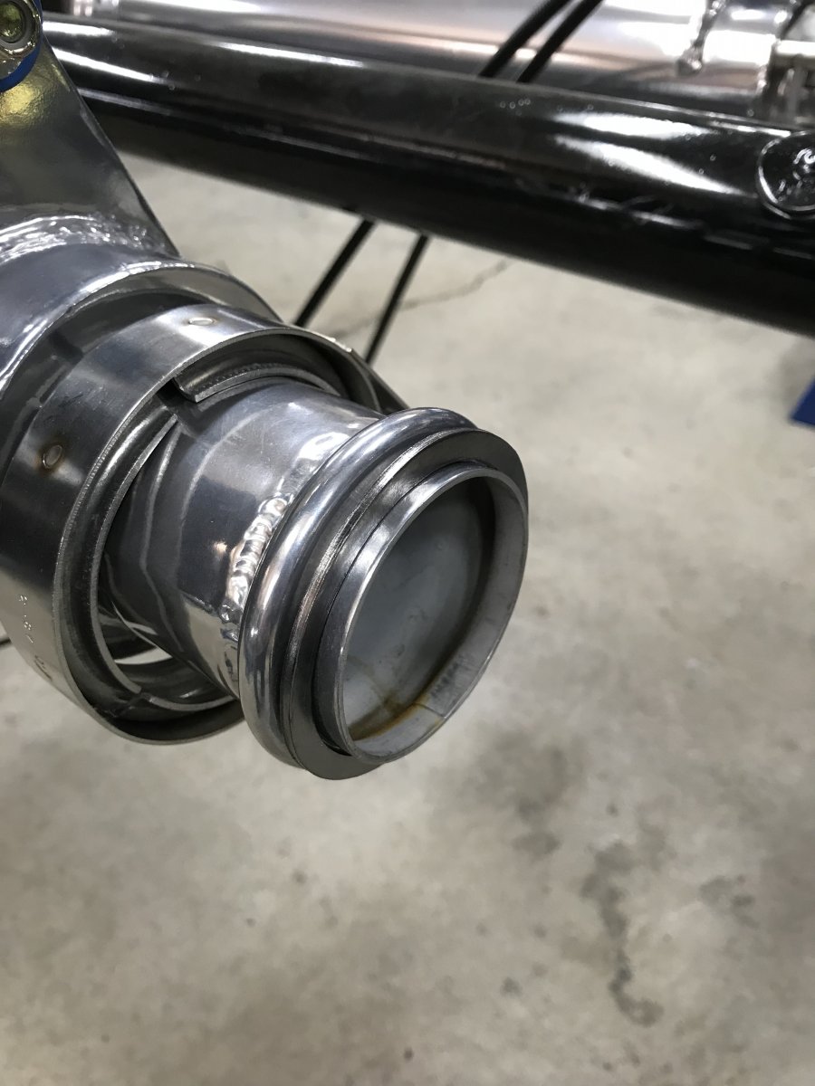

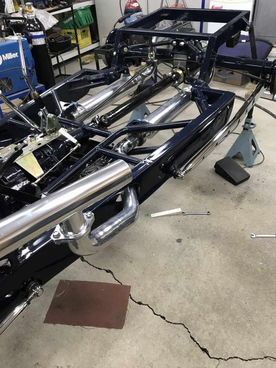

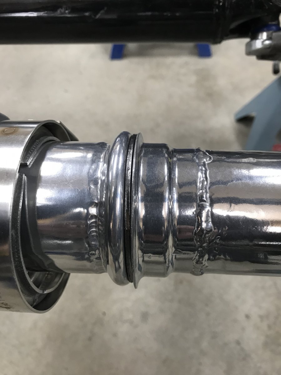

    Marman joints installed on one side.
    I’m so happy with the way they fit and line up.
    So easy to assemble and I will know for sure they will seal and not leak. :cool:
    Big improvement.

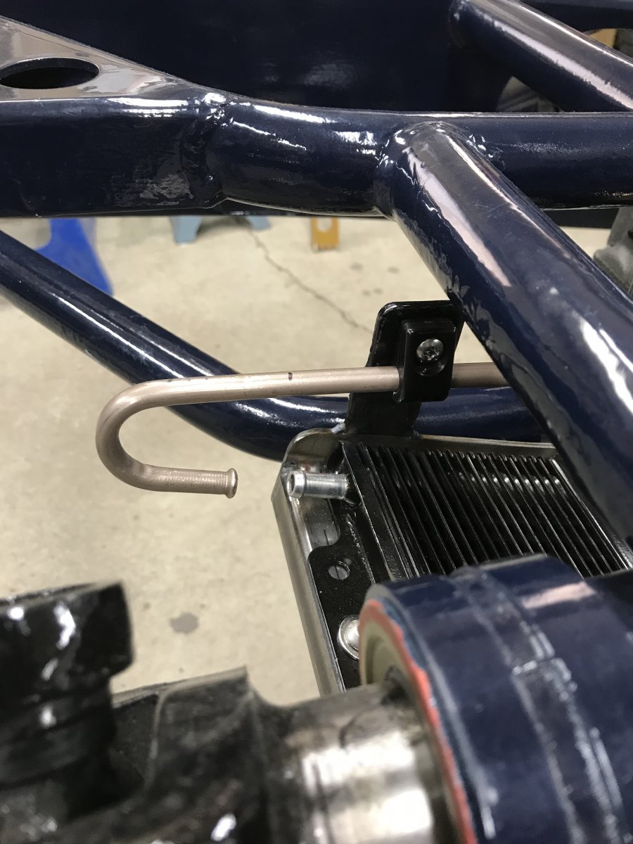

    After some creative bending I’ve got the ni-cop transmission cooler lines bent up and in place.
    Don’t let anyone tell you that you don’t need a bender for this stuff you certainly do in 5/16” size and I believe that if you want to do a nice job on smaller lines (like brake lines) you’d be better off using a bender especially if you want tight bends.
    All the line clamps are in place and the lines terminate so that a 3” piece of rubber hose will make the final connection.
    Each side has a mount for the line off the transmission cooler mount also.
    Almost time to powder coat the mount.

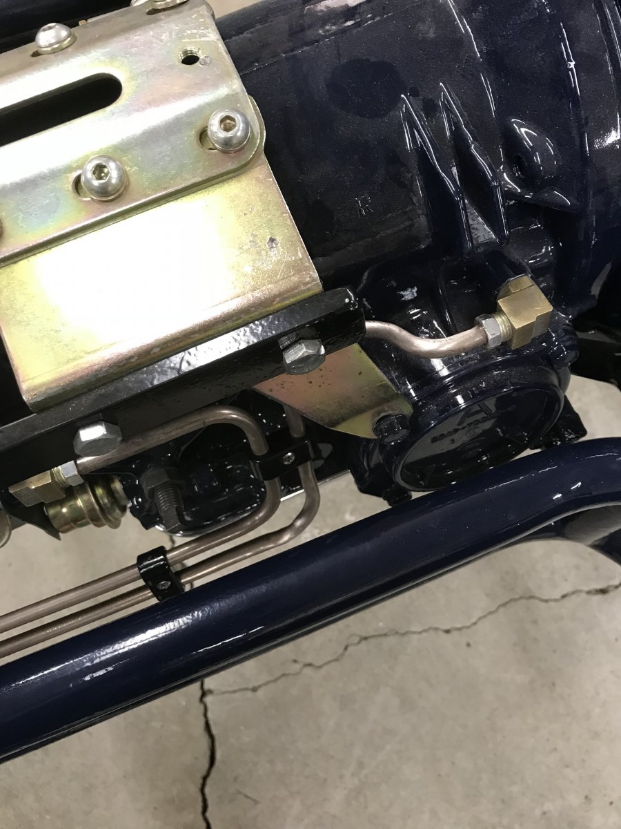

    One thing checked off the list :cool:
    Transmission cooler installed and connected.

    Newly re-ceramic coated exhaust, Porter mufflers and the Marman joints showing the Remflex sealing ring.
    Those exhaust joints are a thing of beauty.:cool:
    And of course I’ll include the rear end glamour shot :D
