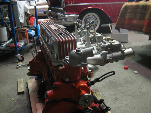

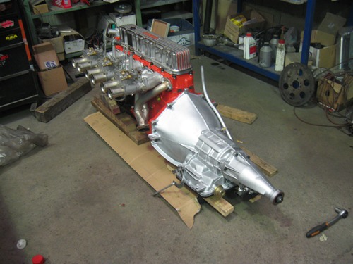

    Hi guys
    this is my 250
    Weber DCOE 45

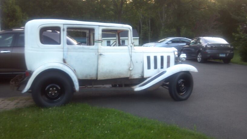

    Heres a shot of my project. Don't pay any attention to the fuel line, it temporary.
    It'd be nice to see how others plumbed their clifford intake

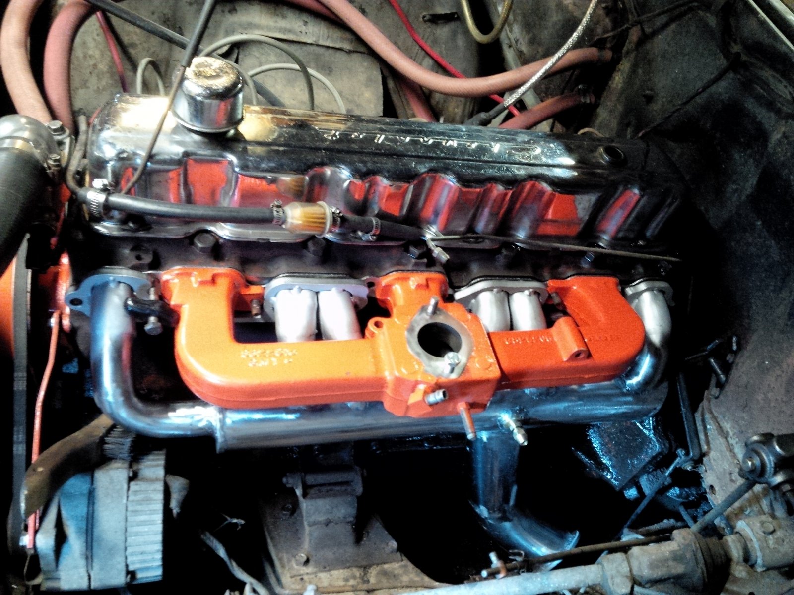

    Heres my stock 230 with my homemade header. Gettin dual carbs an lump ports soon!

    Great looking header Nice Job on it.

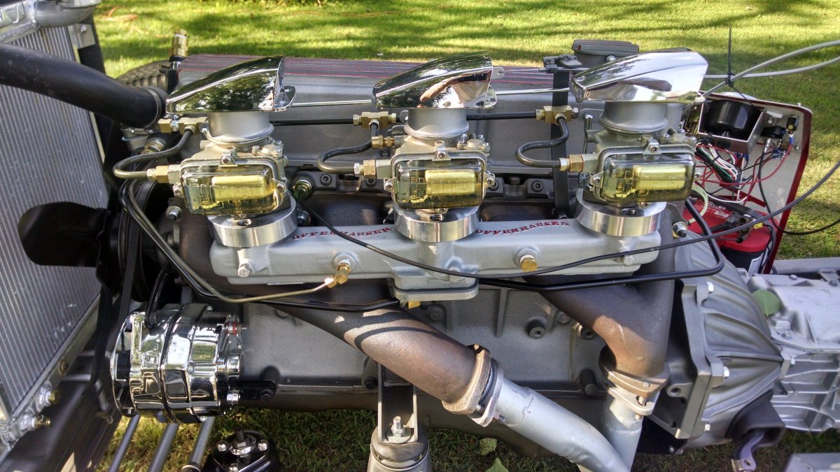

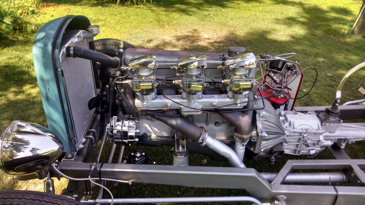

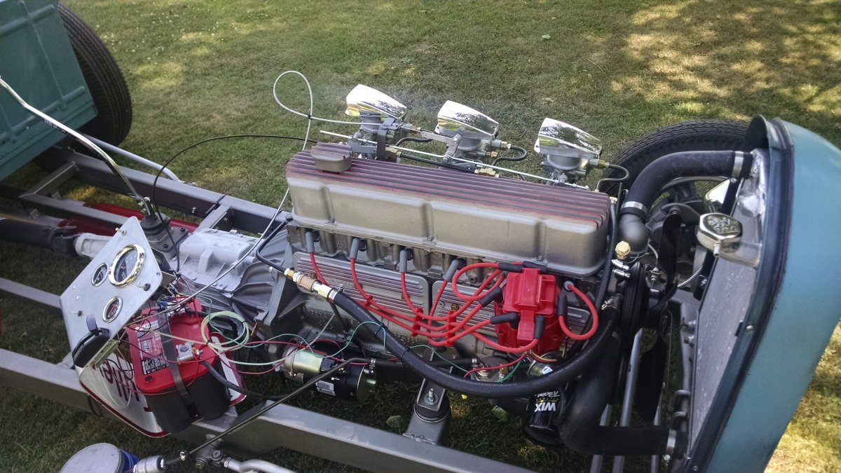

    Finally got it together and fired it yesterday, .040 over 250, decked, flat tops, lump ported, 1.94 valves, shaved the head .030, street ported, triple angle valve job, headers and carbs. Love the sound can't wait to drop the cab on it. IMG_20160727_171811188_HDR.jpg IMG_20160727_144610006.jpg IMG_20160727_144554805_HDR.jpg

  19. Looks sweet! What trans is that? S10?
  20. That is one bad lookin' motor. What model truck cab are you using?

    Dependibility is the name of the game for me, I just added a little kick to it, the transmission is a Borg T5 form an 86 V8 Camaro IROC with the S10 tail housing, the cab is a 34 Ford, it's gonna drop 4" and chop 4" I needed to run the motor and get the bugs worked out of it, make adjustments and take care of any leaks. The carb covers are boat bilge vent covers with a little home built touch to make them fit. I have the carbs set up so the center is the primary, front and rear are secondaries. It's my first build and it's been a blast so far, homemade frame, the big items are store bought, like the front end, it's a Lucky 7 I beam, 4" drop, disc, hub to hub deal, rear is a junk yard Ford 9" with factory discs. Box is a 32 that I shortened, I took 3 inches out of the front. Hand built bed floor, thanks for the comments.

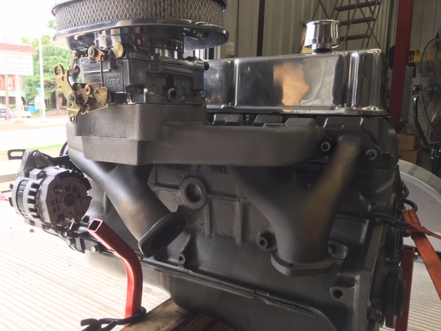

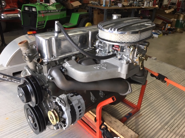

    62E4BB07-B60B-434C-A4FA-5B965BD3711D.jpeg D078DE66-FABA-4D24-AB7E-0456649DFA79.jpeg 0A9AC4E1-6FA1-40D1-A21B-2D50F8F84A24.jpeg

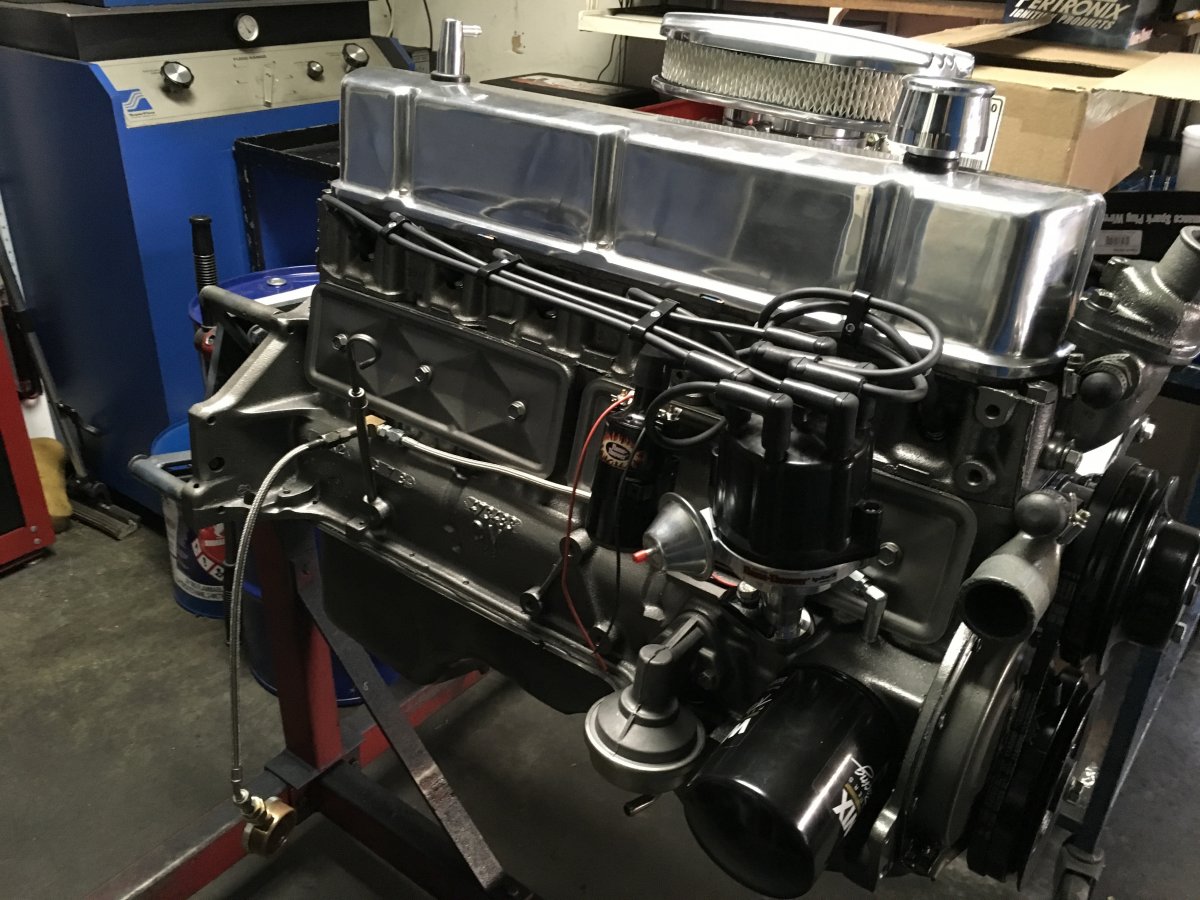

    250 Chevy, mild bore, flat tops, slightly bigger valves, intake bowl cleanup, lump port mod, roller rockers on pivots and tips, RV torquer cam, Aussiespeed manifold, Edelbrock AVS2 500 cfm, Pertonix ready to run, 12Bolt/Langdon headers, dyno’d 258 lb ft, 226 hp......going into my ‘37 Chevy Coupe.

    That looks Sweet. I like the extra oil feed line.
