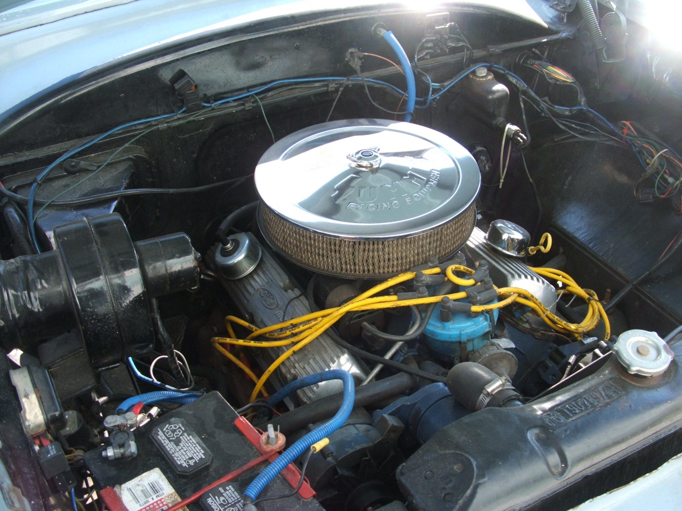

  17. teddyp
    Joined: May 28, 2006
    Posts: 3,197
    teddyp
    get a 292 y-block
    here,s a picture of a 302 we had in a 54 ford and a 54 ford with a y-block if we had it to do again i would put a sbc in it then the 302 not that its not a good motor but the y-block as much more cool factor remenber ford did make motors after the y-block but who really grive a shit y-blocks for ever:D
