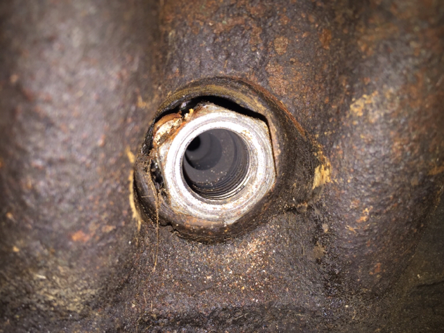

    So in doing a quick inventory of what I'm going to replace , clean , fix on the 235 I found something the seems odd . The 4th spark plug ( if counting from the firewall forward ) has what appears to be an adaptor on the plug hole . Per the PO the engine was pulled from a running car.
    Do all have the adaptor thing ?
    Left is what I would expect and the right is the odd little adaptor

    Looks like a antifouler.

    Meaning there's an issue with the cylinder and it kept fouling plugs. Then this was put in to "fix" the issue ?
    Or
    Is this a common item that was used as a gimmicky type thing ?

    That thing in the spark plug hole, can I be a cheap fix (temporary fix of a permanent natur), for a strip/mangled spark plug hole?
    Bu if it was mine, I would pull the head, get a 261 head gasket, drill stem holes, fill bores with diesel, to check ring seal and lube the bores before start up.
    And go and check the Stovebolt thread, loads of good info
  18. It looks as if that hole was stripped at one time, then this helicoil type of "fix" was done.
    6inarow likes this.

    Anti fouler installed could be as simple as bad valve stem seals. But it could be much worse. I'd pull the head.
