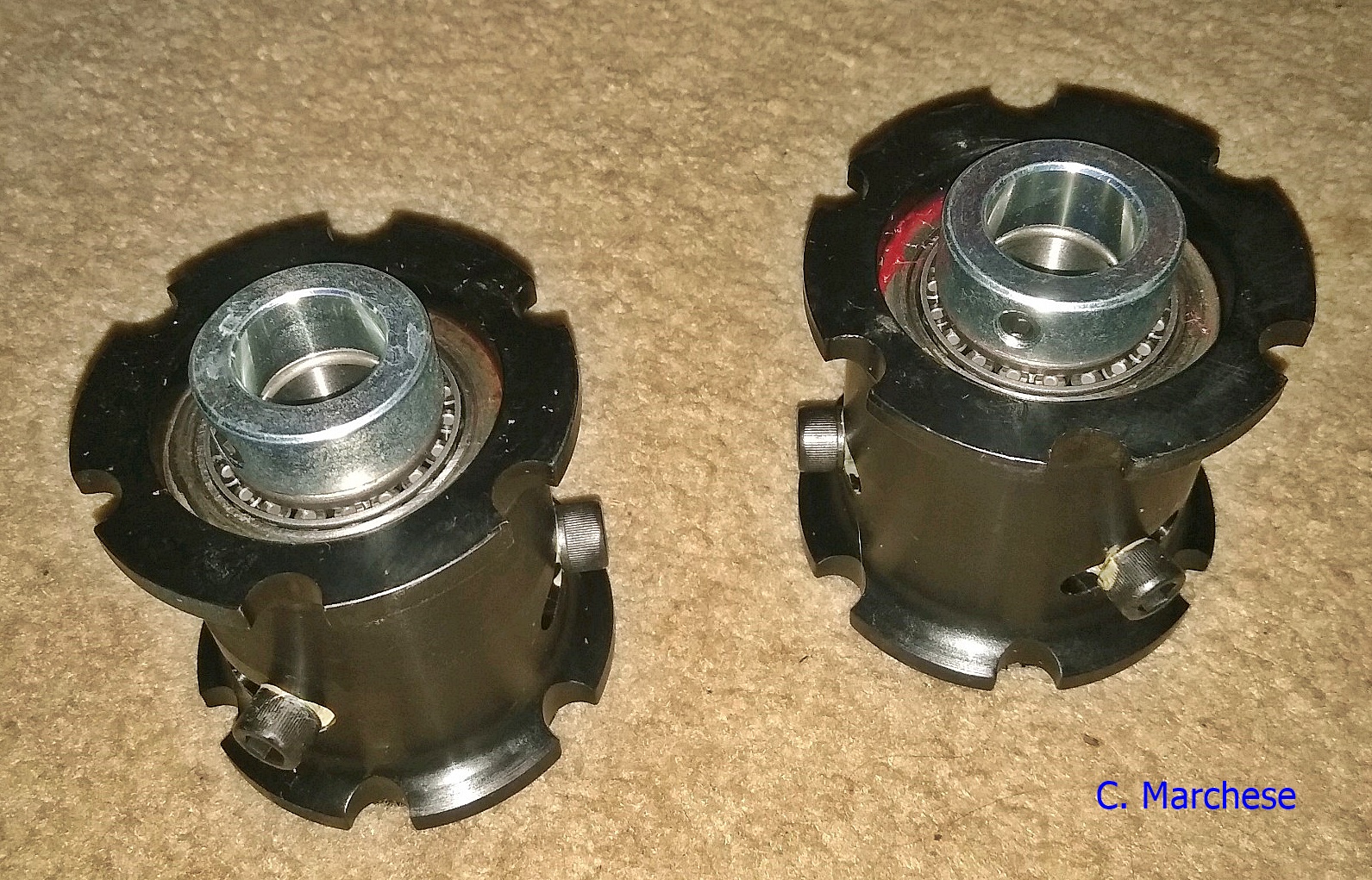

    These are a pair of rear driveshaft spool bearing from John Stoltz - Model T Ranch. I have two of them as I will have two driveshafts and tubes set up. One to go from the A trans to the T driveshaft, and another one just for a stock style T engine / trans. A friend of mine bought one and told me these work great to set up the backlash in the T ring and pinion.

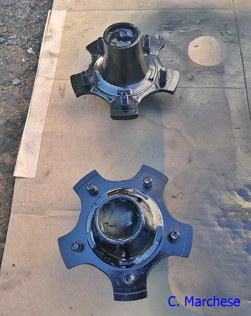

    Finally got my front hubs deburred and primed and painted....again small victories.
