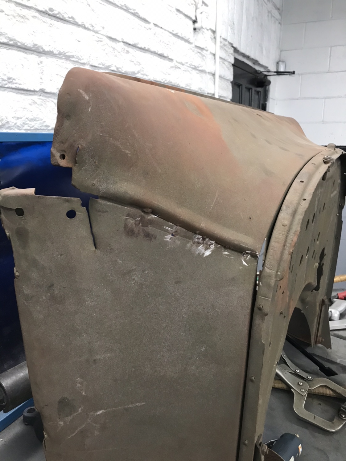

    Hey, I actually worked on this thing a little bit.
    I’ve been pretty busy at the shop, and getting the garage and house all in order. Trying to afford getting the garage and house in order hasn’t sped up the process. I just got a shed to put my compressor in, and once I figure out how to sound insulate it, and can afford it, then the garage will have air and be functional, and I can get more done.
    Anyway, I got tired of not getting any car stuff done and stayed after work for a while on Friday to work on it.
    I’ve always liked how the Isky T quarters and rear panel tops were lowered. I think it made the car much sleeker and sportier.
    I wanted to do that, but not quite as much as Isky. I also wanted to retain more of the T DNA, and keep more of the sweep up in the top of the quarter panel, just a bit sleeker than stock.
    If I remember correctly the Isky T lowered those panels by 3”, I settled on 2”.
    Here is what I ended up with.
    And here’s a sort of comparison to the other side which is still stock.

    Nice! I don't see any welds was this all Pullmax or bead roller work? Bob
  7. cretin
    Joined: Oct 10, 2006
    Posts: 3,066
    cretin
    Thanks Ian. It’s nice to be back at it and get something done. I’m going to stay late more often.
    I originally planned to make a new bead and weld it in, but decided that using the metal that was already there would work fine.
    I used the Pullmax. We already had a die for that body line from when we started the recreation of the Grasshopper how ever many years back. So, that saved me some time which was nice.

    I think I did about 2” lower on my old T. Looking good!

    I got the other quarter, and the back panel trimmed and beaded.
    So next after some more repair to these panels, and some repair to the cowl, I’ll start making prices to connect the cowl to the quarters.
    Also, a newer kid working at the shop wants to learn more sheet metal shaping, so I’m guiding him a bit while he remakes the door.
    Although, probably after tomorrow, my after hours T party’s will probably be on hold for a couple weeks as we have to meet a deadline for the Street Rodder road tour car.
    I’ll get back on it as soon as possible though.

    Hey look, I actually worked on this thing a little bit. I’m trying to work in a little bit of work on it here and there.
    I got the cowl beads replaced. They still need a little bit of tune up, but I’ll do that when I have a helper to give me a third hand.
    I’m going to finish the front of them once I remove the firewall. And I’m going to finish the back of them when I start attaching the cowl to the rest of the body.
    I have a little bit more repair to do to the quarters, then I’ll start making the pieces to connect the quarters to the cowl.
