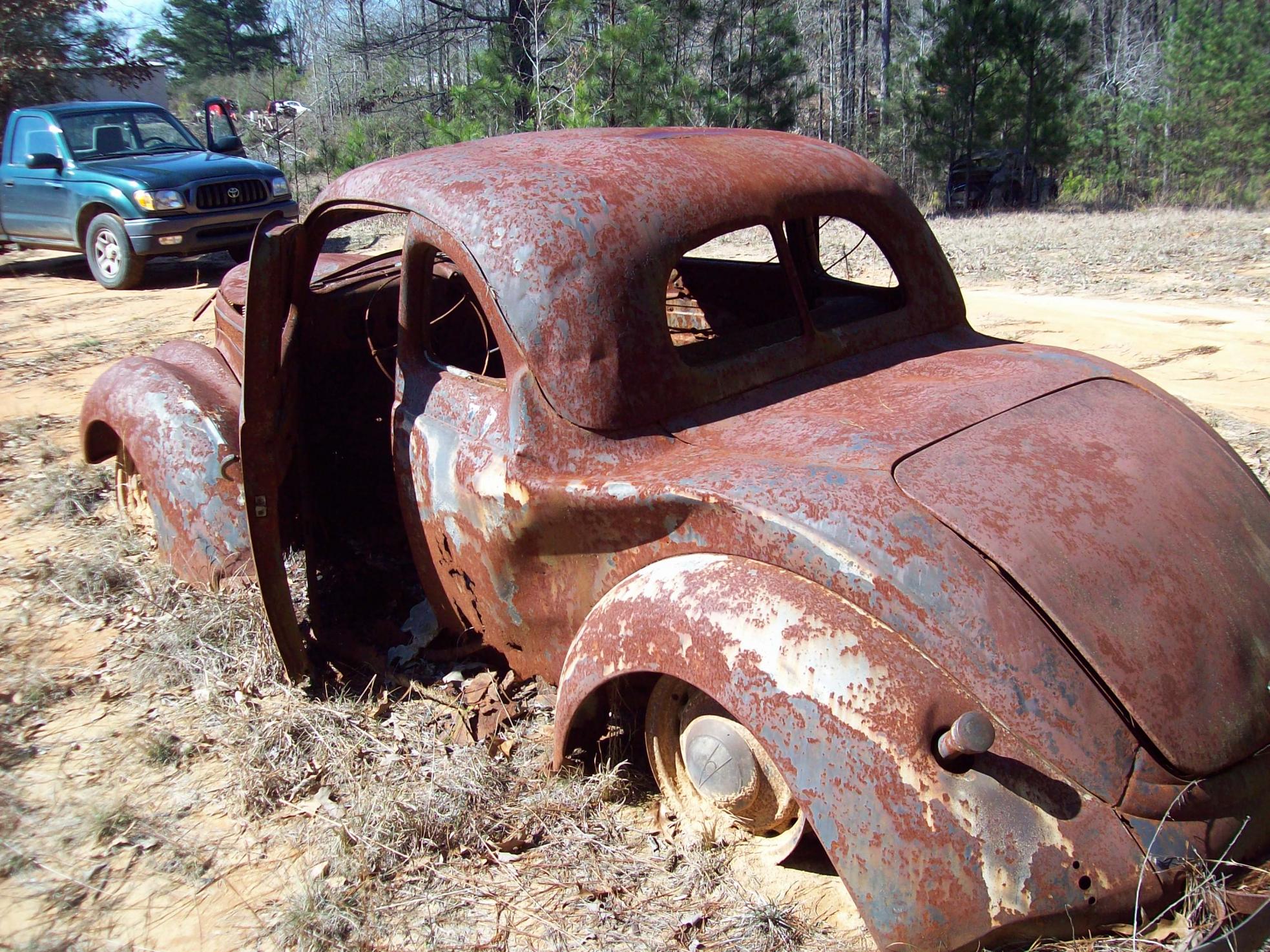

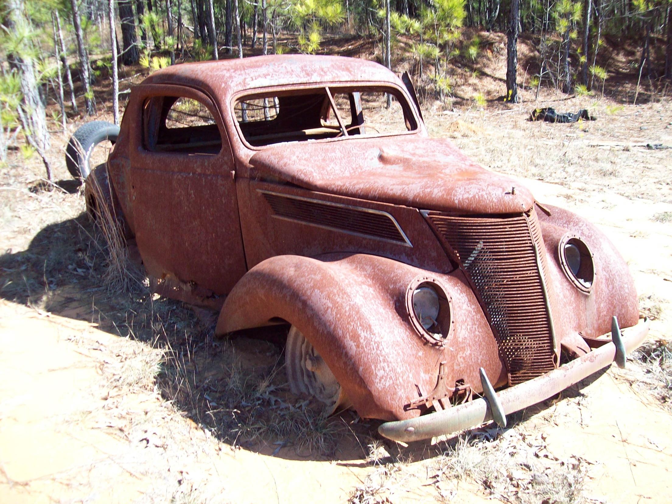

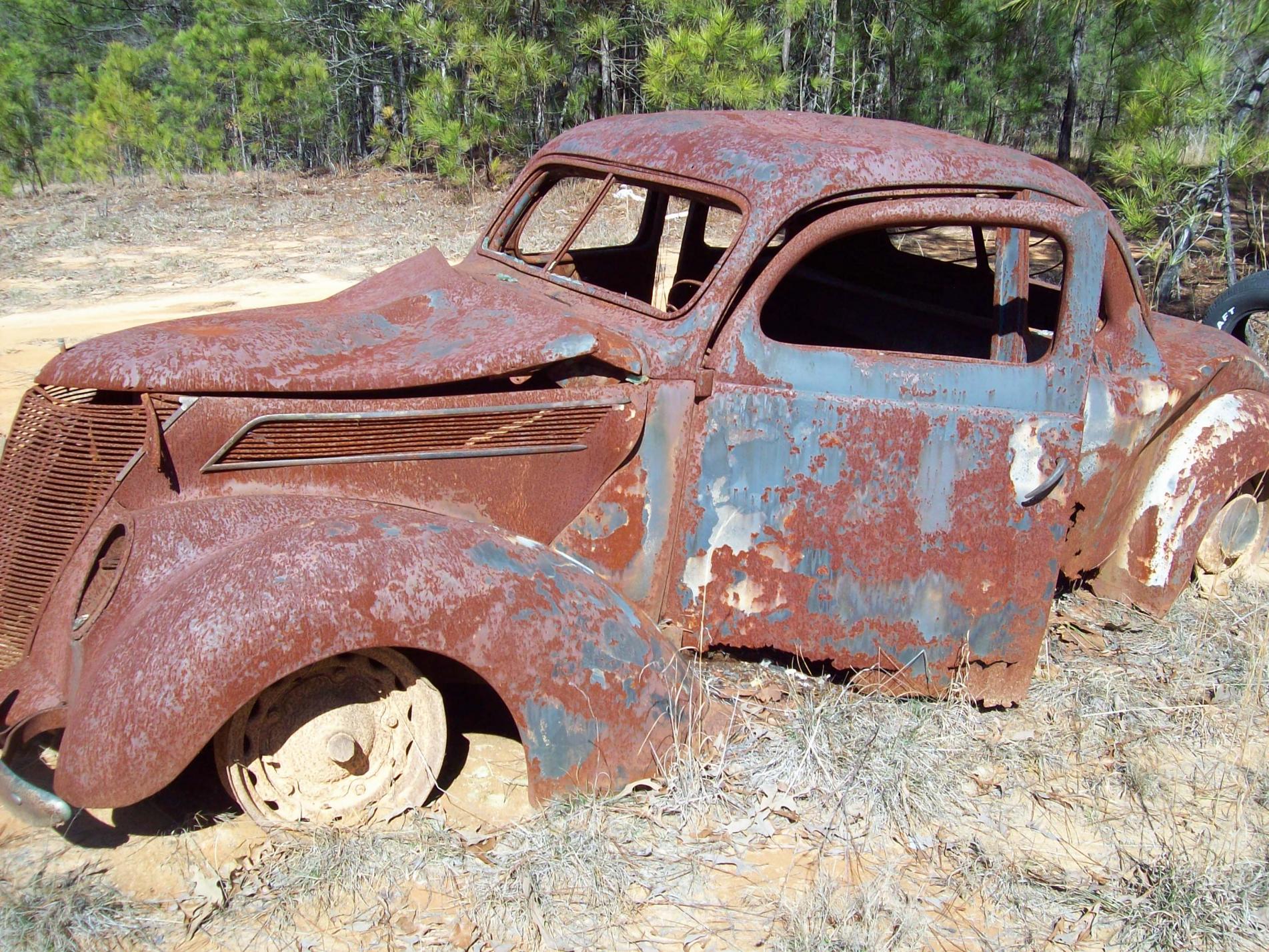

    Here is a car that had a tank full of gas when it was parked out side ...:eek:
  27. How do you know???^^^
