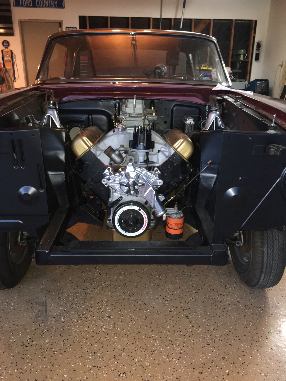

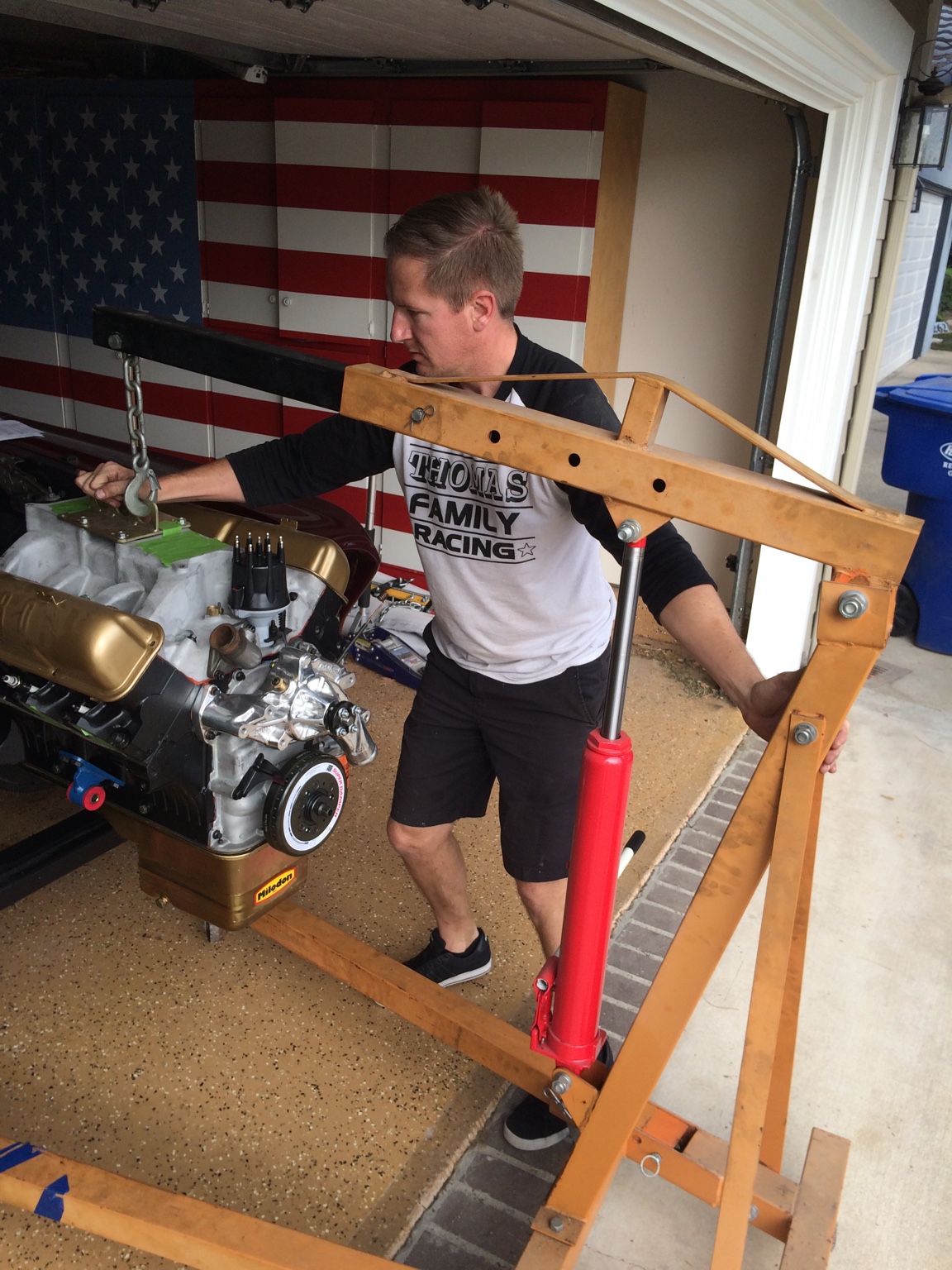

  10. My Dad and I got the motor and transmission in today. Still a lot to do, but a step in the right direction[​IMG][​IMG][​IMG][​IMG]

    why are the carbs on backwards
  12. The earlier ones were backwards. These are correct for High Riser..Take a look at some Thunderbolts. ;)
  13. There's a couple different reasons.. 1) if you mount them backwards, the primary throttle bores are over the center holes on a dual quad. 2) for figment, forwards they hit the distributor more than they do backwards. I need a small carb spacer or crab cap to clear it.

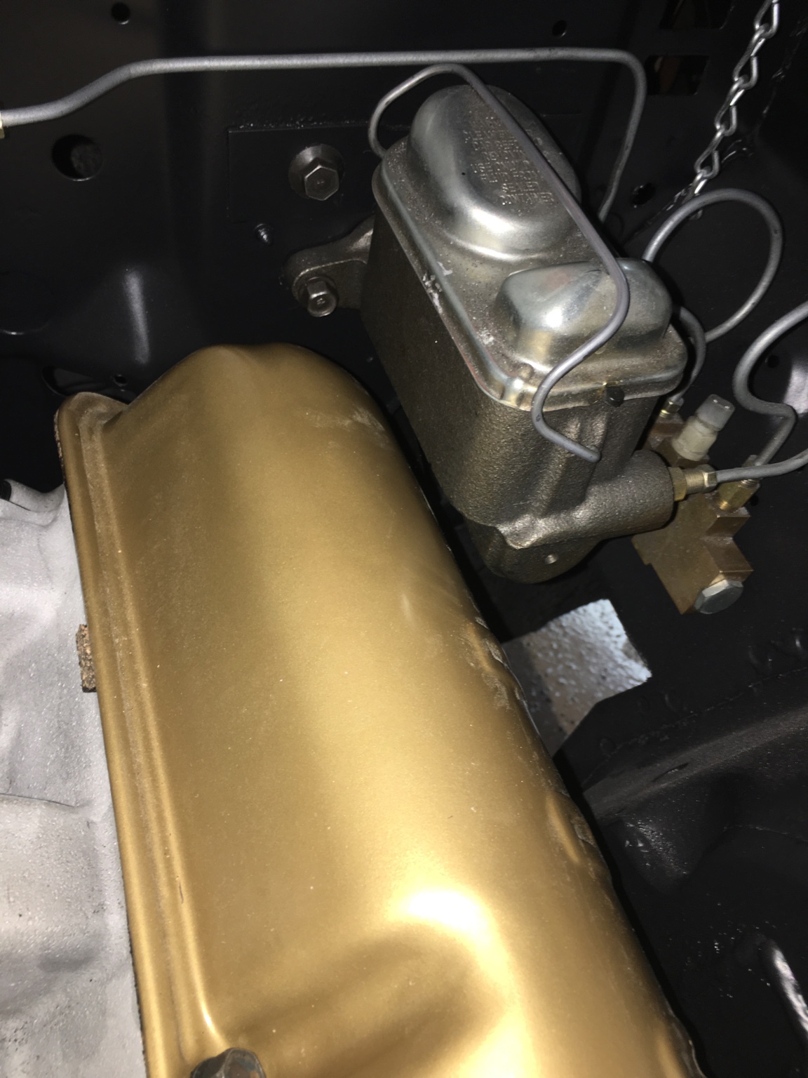

    Got a question. It looks like there are vacuum ports on top of the secondary vacuum housing. What are these ports for? I thought they got vacuum from the carb body?
  17. Removable bolt in core support support makes it easy! I highly recommend this modification. (Thank you Dale Snoke)[​IMG][​IMG]

  18. A single piece of vacuum hose will connect the two ports, it's just to hopefully balance the vacuum signal between both carbs.

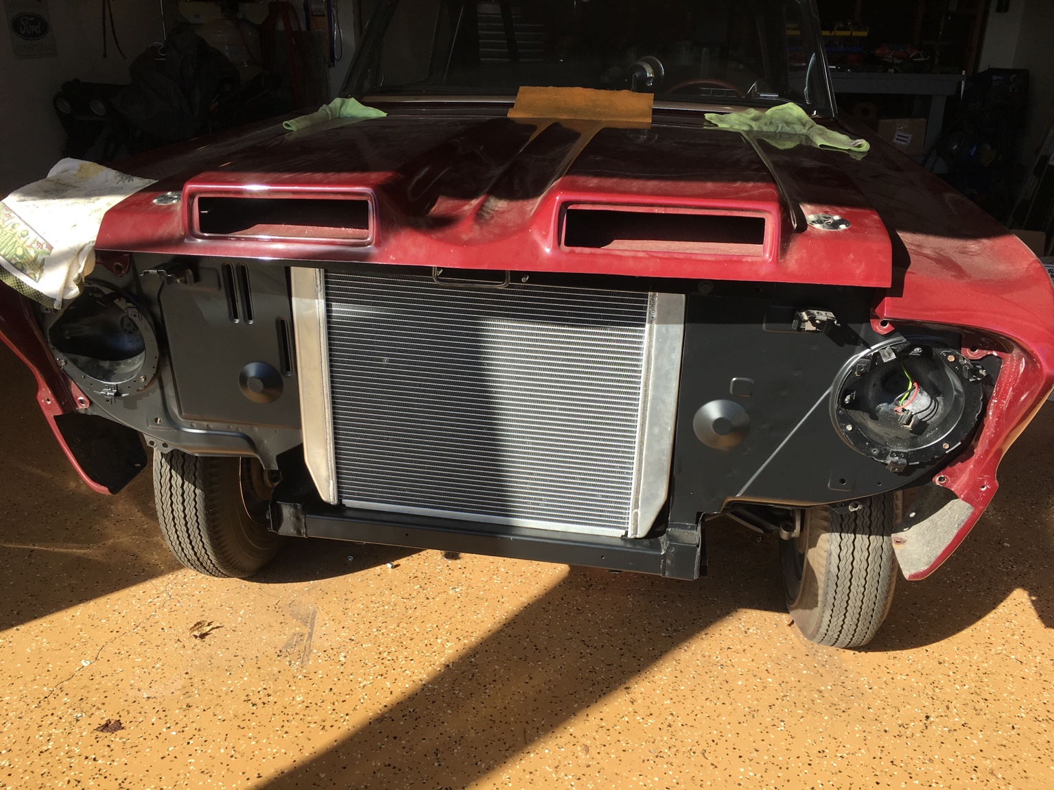

  28. Been working on getting the right amount of end play between the torque converter and flywheel. It was about an 1/8" out of spec so I had to get some washers to take up some space. Also working on the starter engagement spec to make sure it will mesh with the flywheel correctly. A P.A bellhousing, ATI flywheel, Ford block and RobbMc starter, what could go wrong lol
    Went back and forth, but decided to paint the radiator black, looks cleaner[​IMG]

  29. loudbang
    Posts: 40,294
    Black does look better. :)
