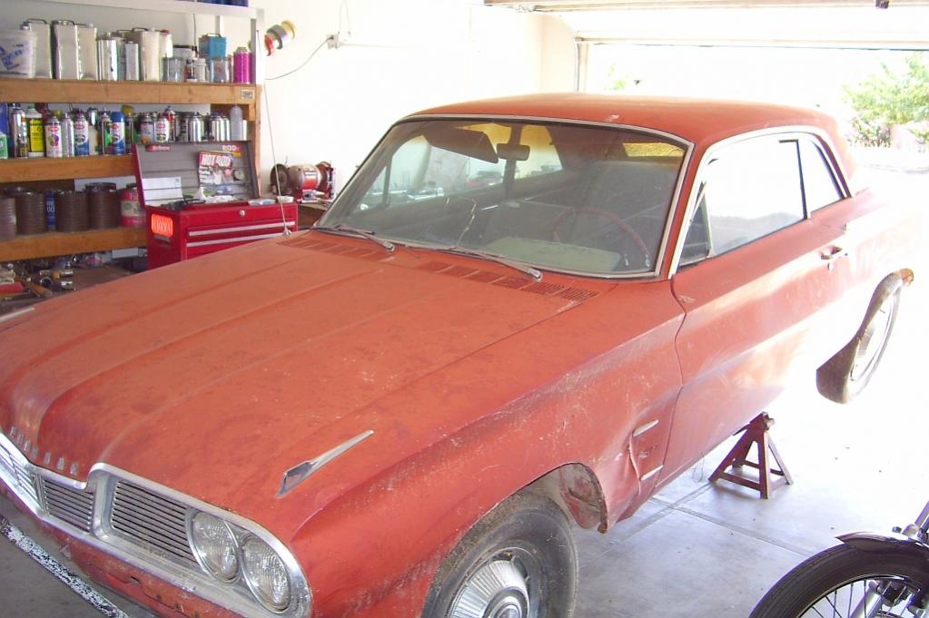

    Im new to the forums and im in camp pendleton, ca
    Thought id get on here to see how many people are around the area

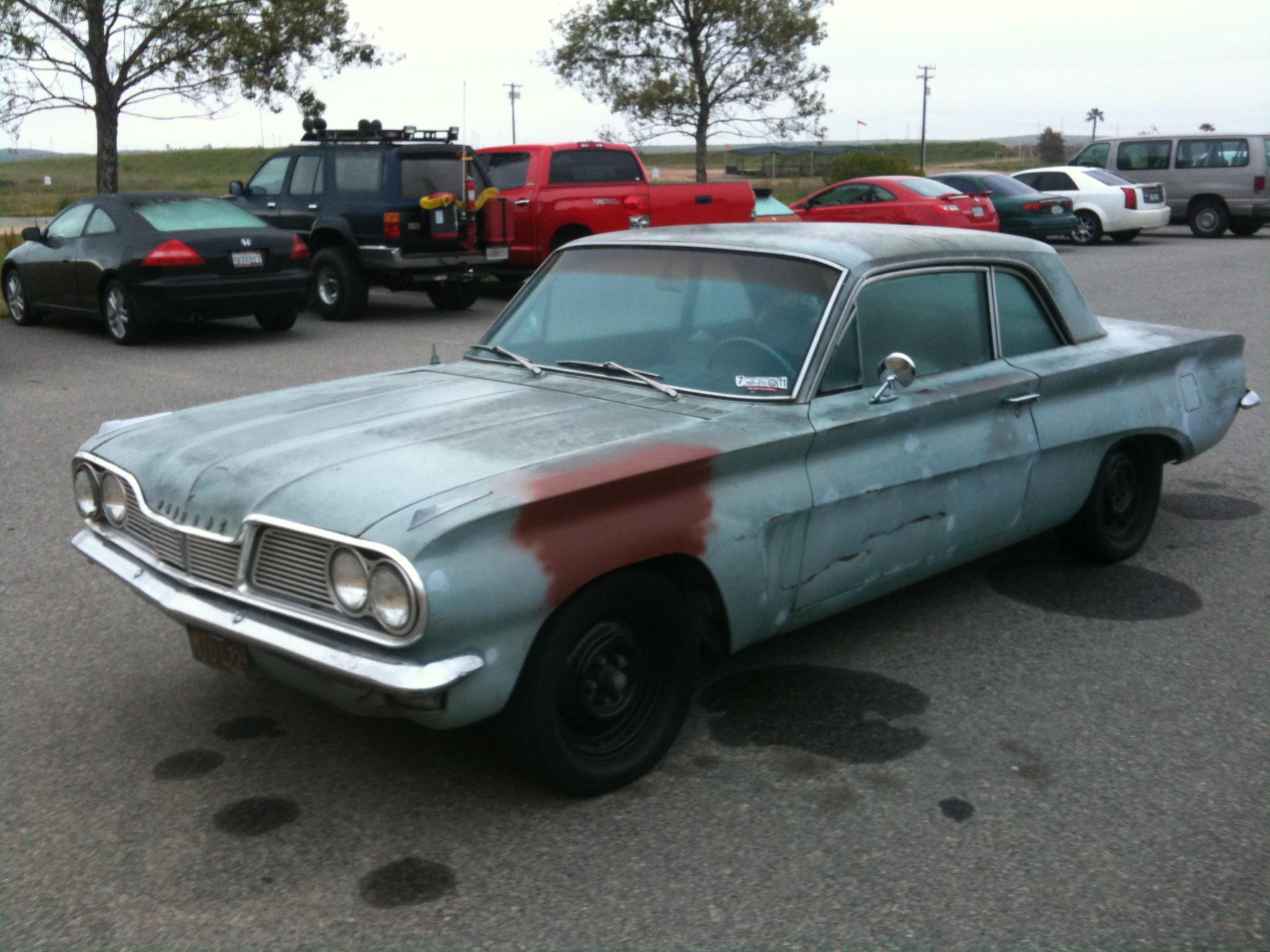

    I have a 1962 pontiac tempest. i personally have not seen one ever
    here are some pics and some thoughts would be apriciated!

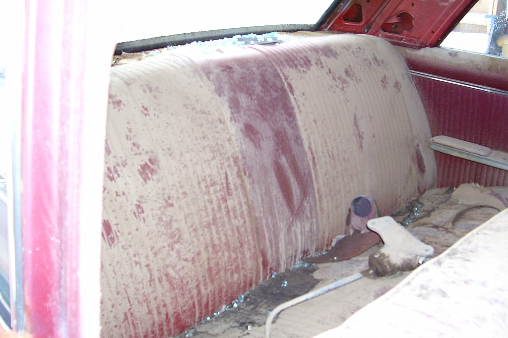

    Thanks guys! And I spent that much because I couldn't find any shoes avalible for this car the 61-63 are the only ones with this brake system, I found the last one on the west coast and it was a couple hundred, my shoes were no good to get remaned same with the drums and my cylinders leaked alot so they had to be redone, I'm having a hard time dealing with the interior too!

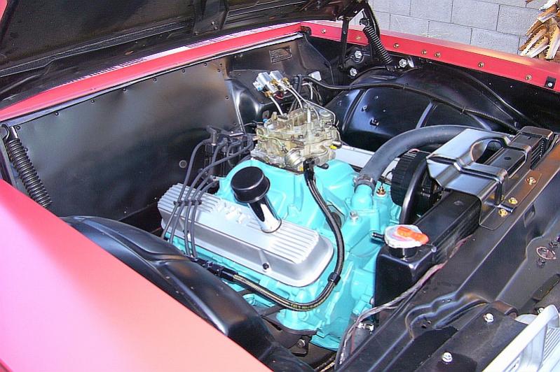

    Here's a couple of pictures of my buddy Nick's 62. The first 2 pics are what it looked like when he first started racing it and the engine set up. He was running mid 11's. The last 2 pics are what it looks like now. Currently running high 9's and we're getting ready to build a 500cu in Pontiac looking to run consistant low 9's.

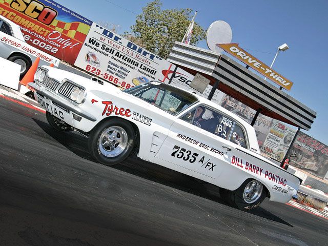

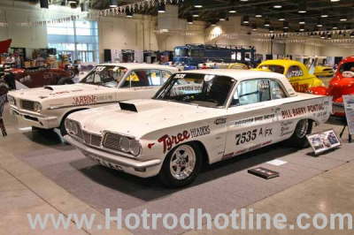

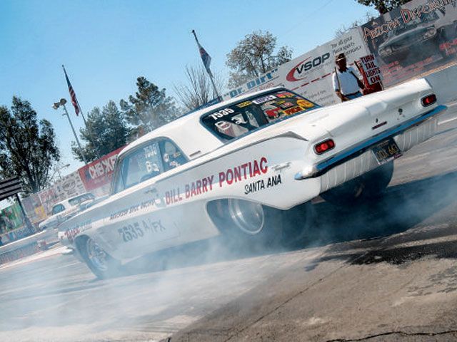

    This '62 belongs to a long time friend of the Anderson Bros. Racing team. My brother and i did a lot of work to the car. Powered by an iron block 428 - car is running high 9's at 135 mph.
