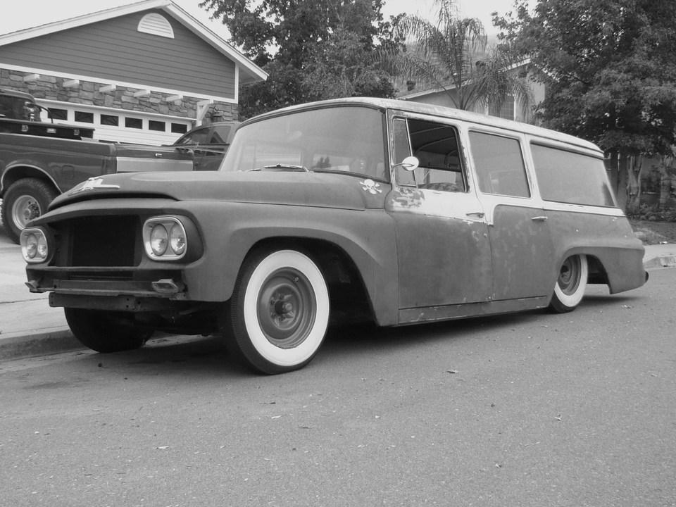

    A four year old thread but here is mine .[​IMG]
