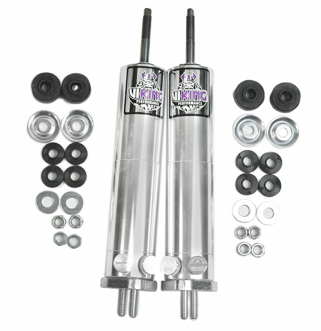

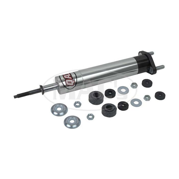

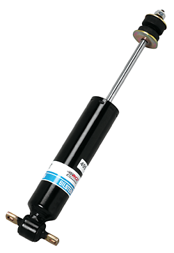

Here's Globalwest front shocks. They're a bit spendy, but I'm sure they are worth it. Viking Double Front Adjustable Shocks #VB211
Since you're installing all new components, you should look into the Shelby drop. You lower the upper arms an inch. This drops the front about a half inch and improves the suspension geometry. I did it on my 65 Mustang and then on my 62 Falcon wagon.

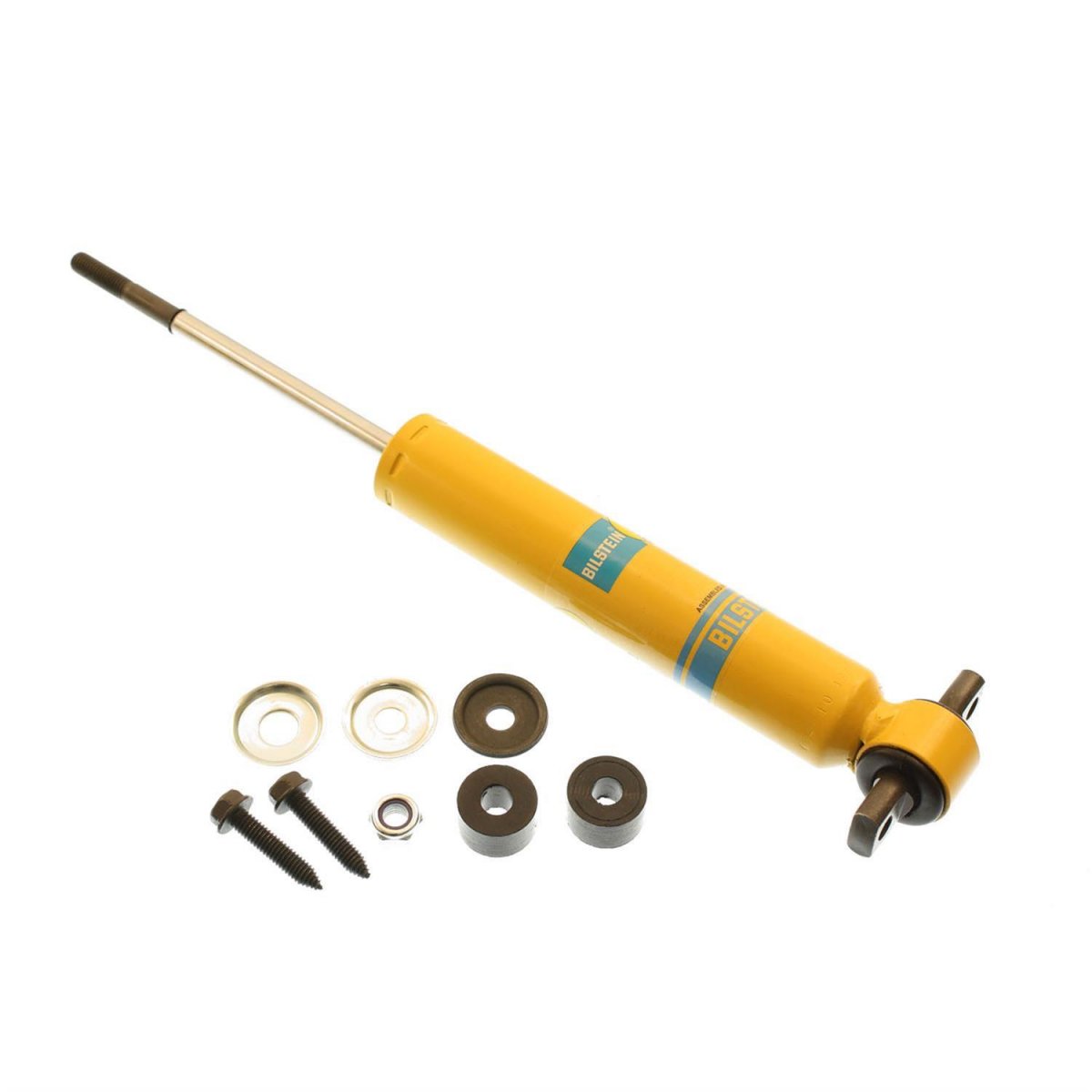

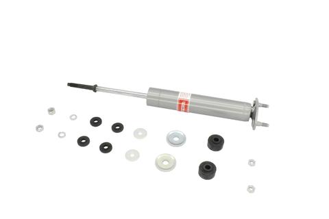

Second the suggestion on the Shelby drop (unless your Global West setup already has altered suspension geometry). I did it to my "Shelbyized" '62 Ranchero a long time ago and really liked the result. I've found KYBs to be harsh and short lived and would steer clear of them. Bilstein and Koni both make great products that would serve you well.

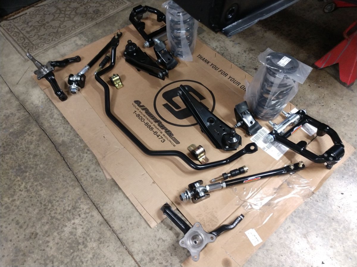

The Globalwest suspension drops the upper control arms and changes the geometry. Has a 3 degree offset I believe. Cool video on what they did;

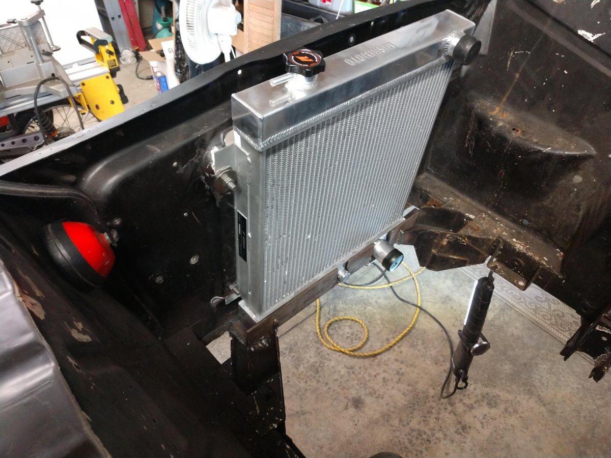

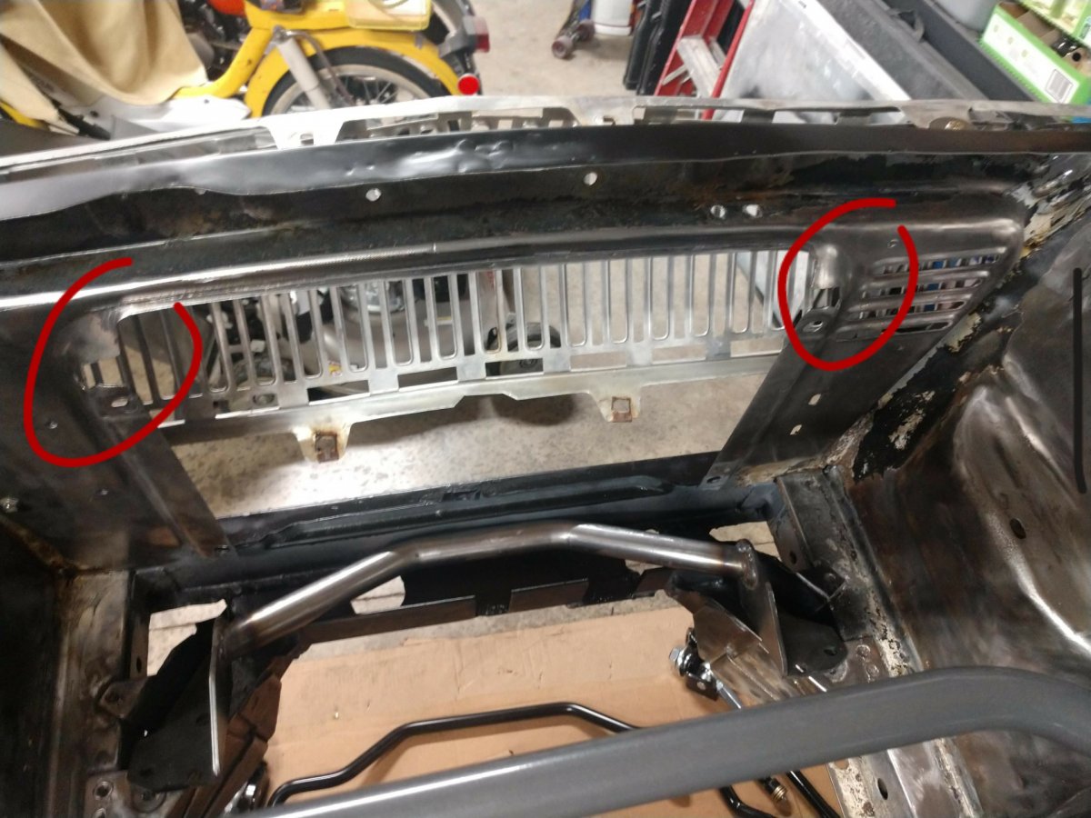

Now is a great time to make the radiator support removable! cut the top out and replace with 2 X 3 angle with a couple of quick release pins. With it open like that you can swap engines EZ. (my buddy claims with the header ON!) Real time saver and can be made to look stock. Wish I had done it to my Mustang. Roller spring perches are a great addition to handling and a Monte Carlo bar too. Watching this one!! 6sally6
6sally6, Already done that buddy! I cut out the tops of the radiator support. The radiator slips in and out easy. Plus it make a little more room for the fan. Merry Christmas everyone!
55blacktie, Interesting reviews. After doing some research I'm considering the Koni's or Bilstein's. Thanks for the input!

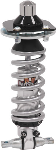

I've decided on these front shocks for the Falcon. They are coilovers using Varishocks. Mustang 64-66, Ford/Mercury 60-77 - Front Bolt-On QS2 Coil-Over, Double Adjustable. Bought them from Chris Alston's Chassisworks. http://www.cachassisworks.com/p-108...-bolt-on-qs2-coil-over-double-adjustable.aspx

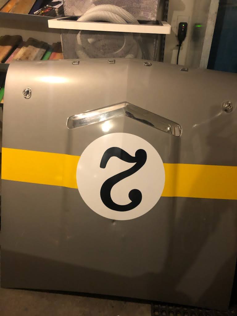

I really like hearing about the old Falcon's people used too own. Sorry there hasn't been any updates lately. I've been working alot. I just need a day off to get some things done! I'm still waiting on some backordered parts to arrive. In the meantime I found a really neat '63 hood on Craigslist. The owner was using it as wall art. I also attached a picture of his awesome '63 Sprint!

The front Varishock Coilovers arrived today! I now have everything to put the front suspension together.

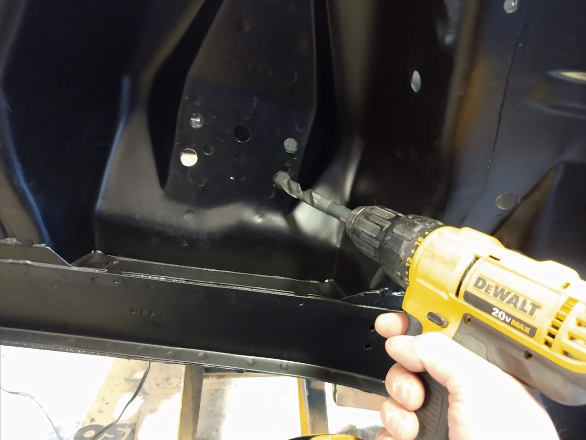

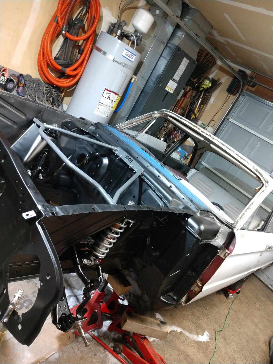

Hello all! Sorry it has been awhile, but life happens. Here's what I've gotten done today. Using the template from Global West I drilled out 9/16" holes for the "Shelby drop." I then installed the Global West upper control arms. Then installed the lower control arms. (The lower control arms are temporary, I'm going to be putting Global West tubular lower control arms on soon.) Then I assembled the Chris Alston's Chassiworks Varishock coilovers. Installed them with the support brace. Enjoy the pictures!

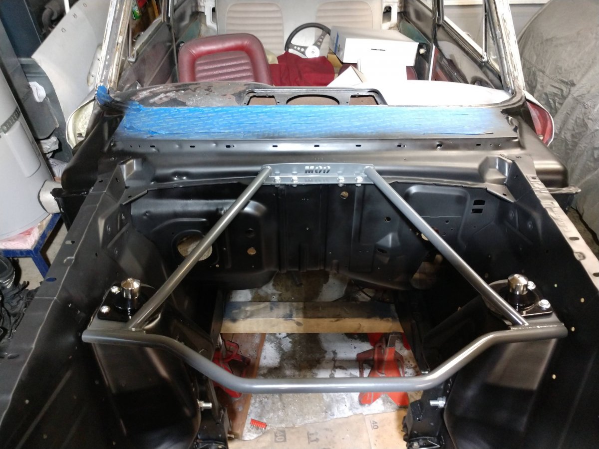

Okay, today I finished installing the Global West adjustable strut bars and sway bar. I also had to flip the coilover towers with the support brace. This allows me to easily remove the support brace for engine install / removal. Next, I'm installing 5 lug disc brakes up front. Enjoy the pictures.
