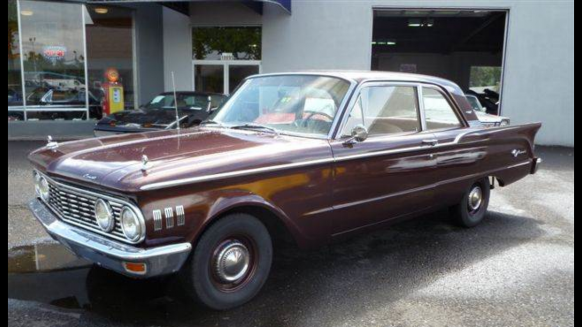

    I grabbed these pictures from ebay. I thought this car was pretty cool, I am planning on two toning mine, but in a slightly different way. My plans call for the roof being one color and the rest of the body the other color. I'm not sure how much I like the roof color above the molding line, but it was a thought in my mind when I first got the paint. It kind of reminds me of a 57 ford.
    I'm hoping that a darker color on the roof will maintain the formal lines of the greenhouse, while creating the illusion that it is smaller. The bottom of the car will be a burgundy, yet it will still be lighter than the roof. Here's hoping my thoughts are correct!

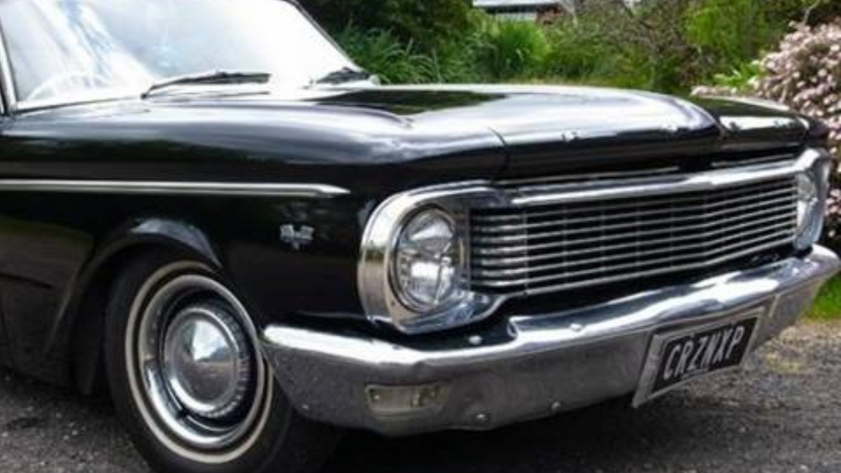

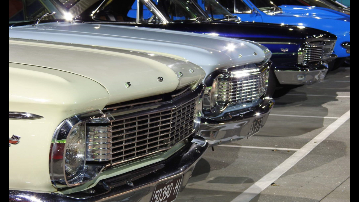

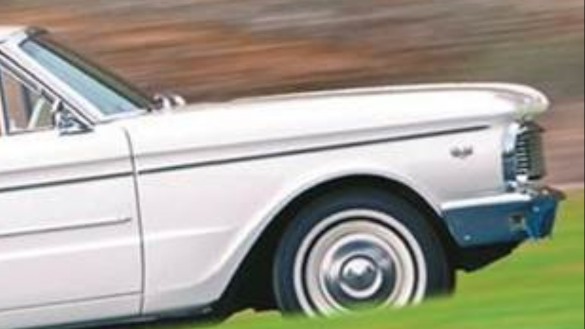

    Here are a few photos of Falcon XP front ends. What do you think? To me, the whole grille set up seems more aggressive and interesting than the original 61 Comet unit. I've included a photo of a nice S-22.

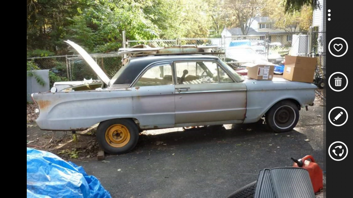

  28. rg171352
    Joined: Oct 24, 2007
    Posts: 508
    rg171352
    from New York
    Here is a photo of the car that donated its quarters for mine. I remember seeing it listed on Craigslist locally for a while last year. This year, it was listed as a bunch of cut up sheet metal. My quarters don't look to bad in the photos, but in real life, they haven't held up very well. Hopefully I can get these new ones hung in the near future.
