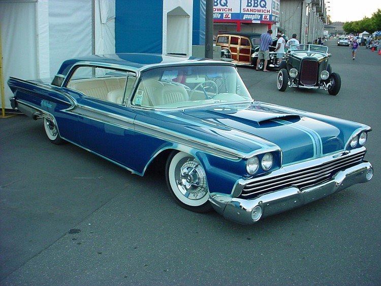

    These Fords make great mild customs, with just the simplest changes.
    One of the easiest and most effective (IMO) is to simply paint the headlight doors.
    Here are a couple of examples:
