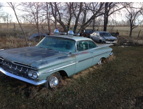

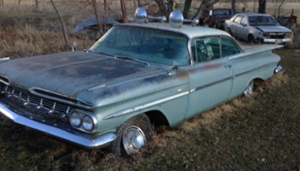

    "car developed a knock" and smoked a bit" I was told as it was winched onto my trailer. "So dad parked it on the yard to fix later". WAY later as it turns out as it sat there for the next 42 years. 59 og.png

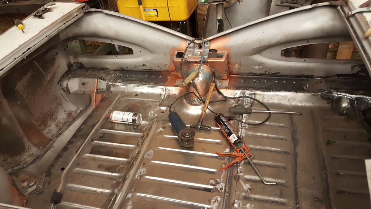

    Originally planed on a "patina" ride BUT although it's OE paint and never hit, Mother Nature bitch whipped it over the 42 years on the yard. Inner and outer rockers gone. New full floor pans from tow board to tail lights. Rear valance and licence plate bucket had pin holes {not terrible but bucket had to come out}. Lower quarter patches. Worst of all the rear window channel.
    Doors were mint! front clip was mint! Count my blessings I guess.
    Most painful of all this was that there was a farm implement shed {one car deep but 10 cars wide} a mere 100-150 feet away from where that car was parked. I would have pushed it there for no other reason than to make mowing easier.
    Alas, it is what it is. That is what welders are for!
    Body was braced, floor removed. I had an industrial blaster come to my yard to clean up the exposed rust.
    Floors and truck are straight forward, fabricated inner and outer rockers. Found a 1960 Caddy coupe de vill in the salvage yard {WTF right!} and cut out the rear window channel parts I needed. All 59-60 GM "bubble tops" are the same chevy, Cadillac and BOP.

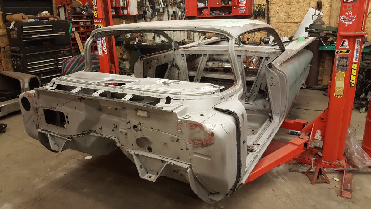

    Once the body was structurally sound it was popped on my rotisserie. I made the rotisserie some years ago
