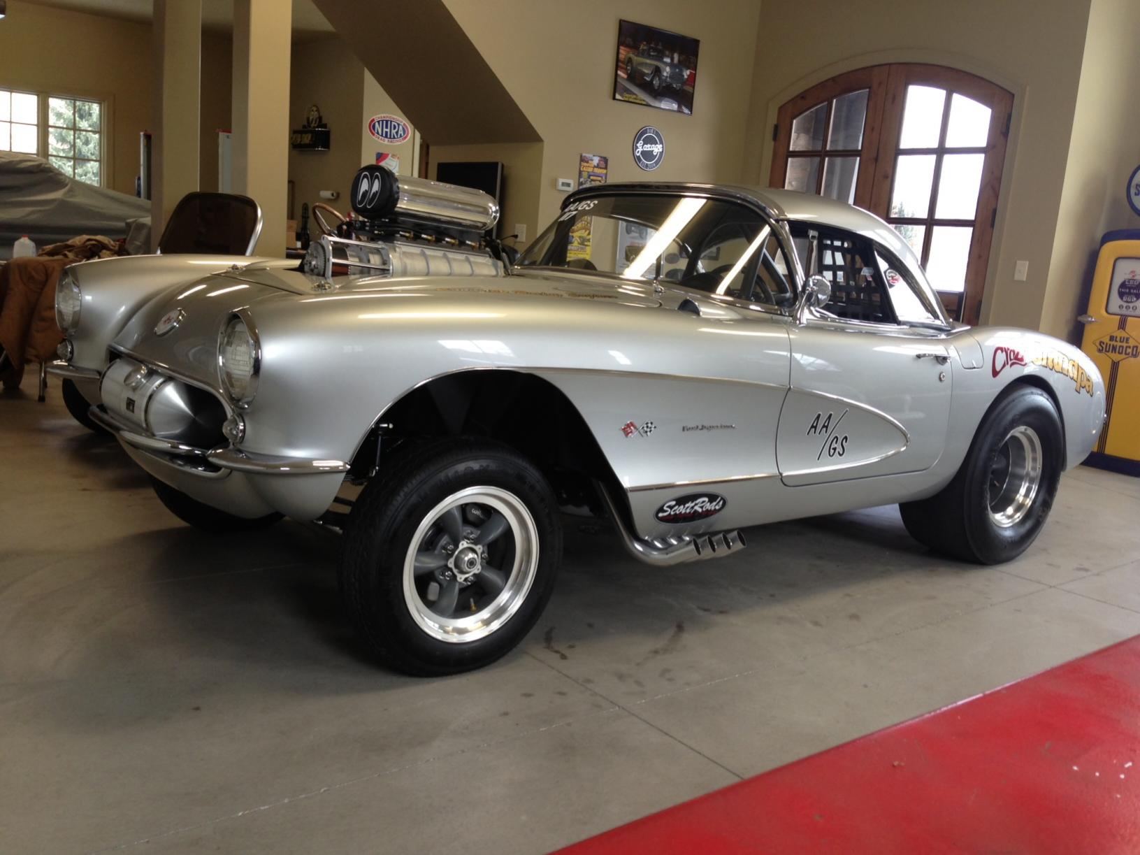

    Hi Baron,
    I haven't been on HAMB for a while so I was checking out Vettes and saw yours. It looks like its coming along very nice. I attached a picture of mine, we worked all winter converting it to run AA/GS this year. I'm going to keep an eye on your progress now that I see you have started it.
    Good luck

    Hi Bob. Your Corvette is my absolute favorite. And now with the blown-injected BB , it's even more over the top. Thanks for the new desktop picture for my computer . If that doesn't inspire me, nothing will. :D

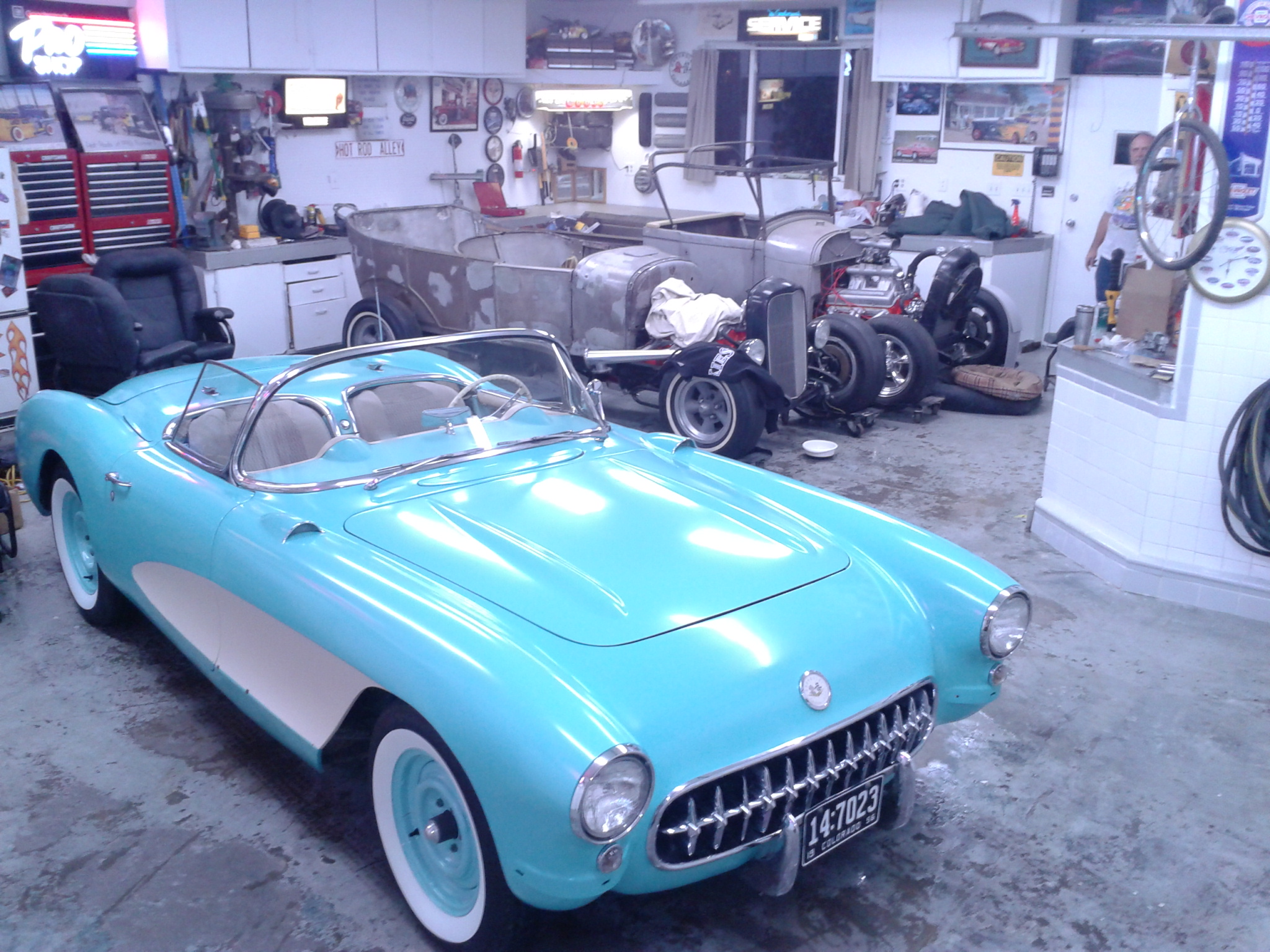

    CameraZOOM-20131130171121744.jpg 20130518_191810 (1).jpg 20130518_191810 (1).jpg 20130518_191810 (1).jpg 20130518_191810 (1).jpg Looking great! I posted a pic of my 56 early in your thread here is the progress on it.

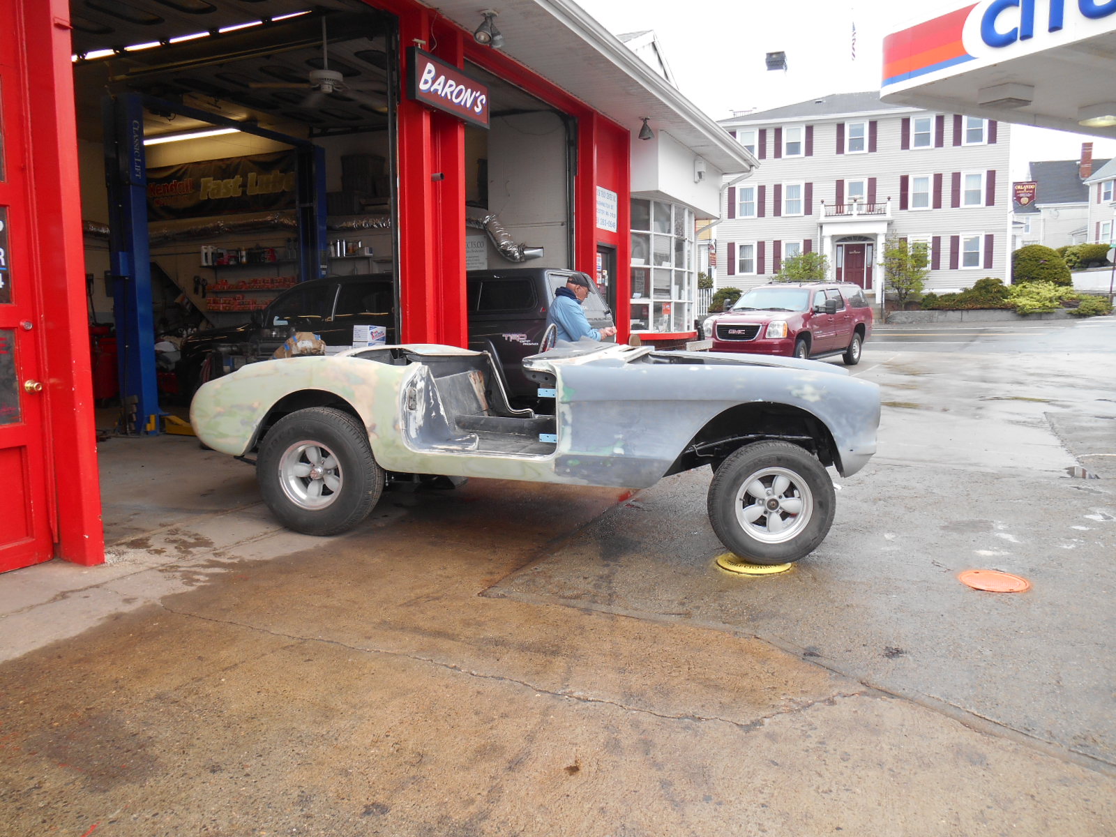

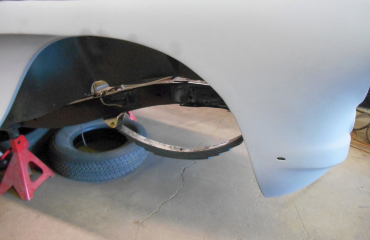

    Now that summer is over, time to get back to work on the Corvette. After seeing Bob's Corvette (Crazy Grampa) at the Hot Rod Reunion, I decided to go back to my first plan and put a straight axle in my car. I figured this will probably be the last 57 Corvette I'll build, so I better do it exactly as I want it.

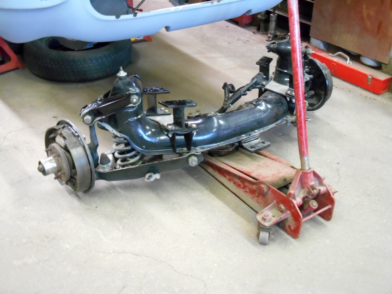

    Bill at WAC Customs/ BCCHOPIT , is making my axle for me. My springs and shackles/ mounts arrived this week, along with my steering arms, steering box, etc. So today I removed the front end ,fabricated the front shackle mounts and have them bolted in place . Once I get the axle, I'll decide how I want to mount my rear spring hangers. I may have to raise them into the frame to get the ride height where want it, but once I get all the rest of my parts, I'll have a better idea.

    Joined: Mar 6, 2010
    Posts: 8,766
    1971BB427
    from Oregon
    Going under the springs or over the springs with the axle? If the height is an issue, you might go one way or the other to get it. Or set the mounts on the outside of the rails if you want it lower yet.
