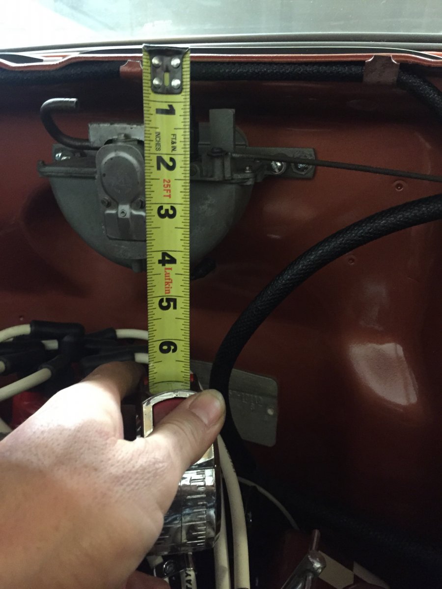

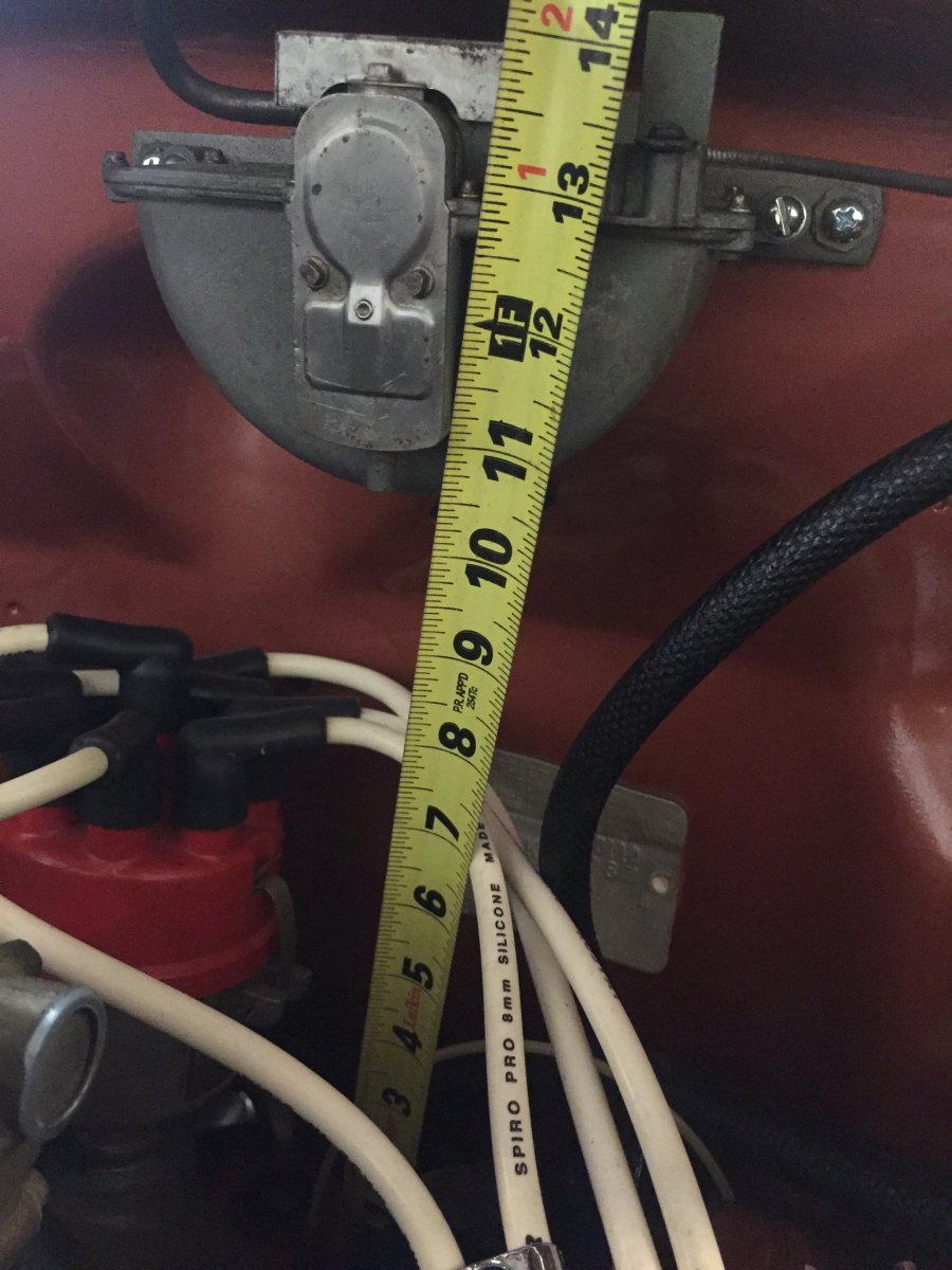

  12. How a Tri 5 thread got past me for 3 days, I can't understand. Let alone one with 1957 Chevy in the title.. JPEG_20161003_094745_662640623.jpg JPEG_20161003_095637_-1677081289.jpg Engine out of mine at the moment, here's a comparison. Nice wagon BTW!

    what is the dimension comparison say from the centerline of the motor to the bottom of each when mounted?
    Hope it helps ..... That's from top down . 1" difference give or take
