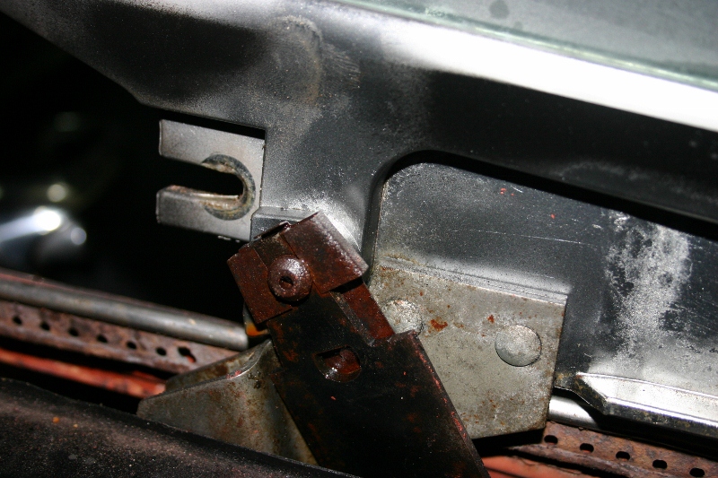

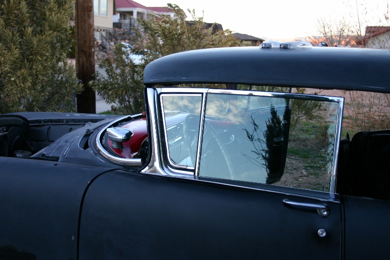

  15. been working on my front 2 windows and the vent windows and alllll the door latches and pulls and mechs...ive installed new glass in the frames and velcro in the channels...i still have to fine tune the windows so they go up smoother..but im guessing the pops and groans and grind sounds are something i will have to except..till one day i get new mechs..that tension spring is all pitted and makes alot of noise when tension is released....heres some pics and one what they both looked like before...now alllll clean and nice

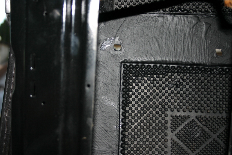

  16. i also came up with a cheap sound deadning for my front doors...i went to walmart and bought a 3 dollar thick rubber mat and contact cemented on the inside doors...i probibly gonna get one more too...the first one made night and day difference...took alot of the echo out

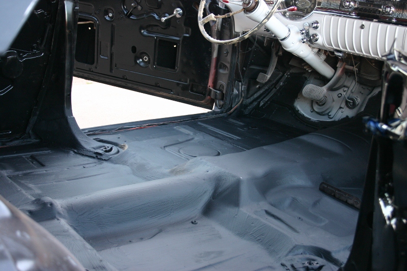

  17. then i went and got another gallon of henrys asphalt emulsion from home depot for 13 bucks and coated my whole interior floors with it...i was able to build it up...it feels like a rubber liner in there now...wont rust out ever again...water cant even get to paint or metal now i even threw some in my doors

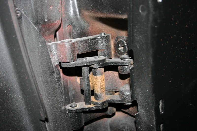

  18. now im ripping apart alll the back door mechs and gonna replace the glass.....its gonna be intresting...lots of photos and leaving one door intact for reference...ps that last pic of the clip retainer was intresting to try to release....but i did it...
  19. annnd after i get the back door windows and mechs done im gonna work on the hinges...another new territory:eek:
      291 KB
      123
      297.3 KB
      117

    I decided that i'm going to go get some of that coating like you used. I was not impressed with my POR15. After about 2 weeks of letting it cure, i put those seats with the seat brackets in and managed to scratch the POR15 off. weak.

  21. the windows were fixxed in place with that chrome strip you see wedged in on the inside of the window thats all i could see that did it with the rubber seal that was in the chrome window track...i busted my window out and then being i was cheap or in other words dont have the money...i just took some of the vinyl im doing my door pannels with and cut strips to go in the channel then put the glass and chrome strip in..and too be extra good i took black silcon caulk and went around it..i figure it helps hold it in and stops the water getting in the chrome track...i noticed that water got in over the years and rusted it good in places
  22. and as far as the seam sealer..i took all mine out when i did the tub area...then i just coated that stuff from home depot on there thick..you can build that stuff up in layers...im sure its not exactly like the original stuff ...but it will do for me...and i like you had my paint scratch off in areas...(i know its poor prep being i didnt get all the wax and grease removed) but when i painted this stuff over it ..it was solid..and waterproof...and as far as the sound deadner that was already there..i havent pulled my headliner off yet...and my front doors were missing it...and the backdoors i just plan to go over it with the home depot stuff..they are in fairly good shape as my trunk one is

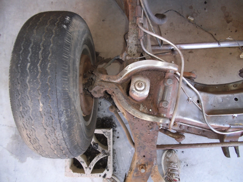

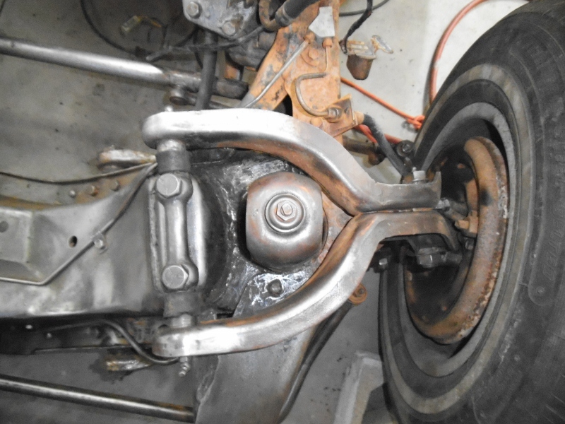

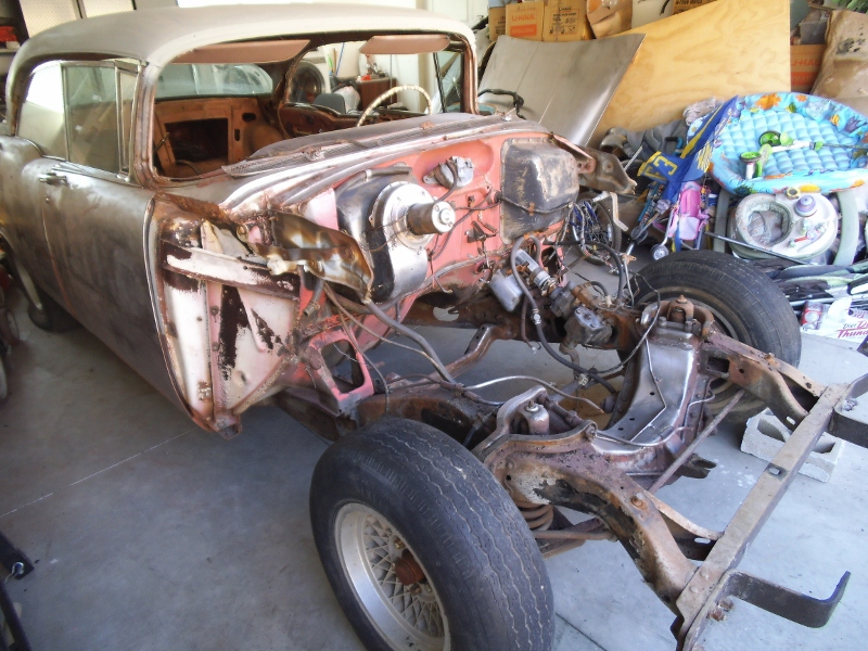

    Late to the party - how was your front crossmember? Many '56 Olds had problems with it cracking inside of where the upper control arms attach.

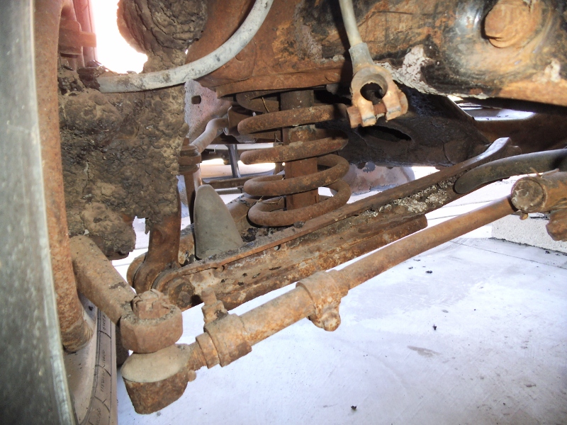

  24. are you talking about where the upper control arm comes to a v like in a wish bone?..because i did have a crack there i welded shut...

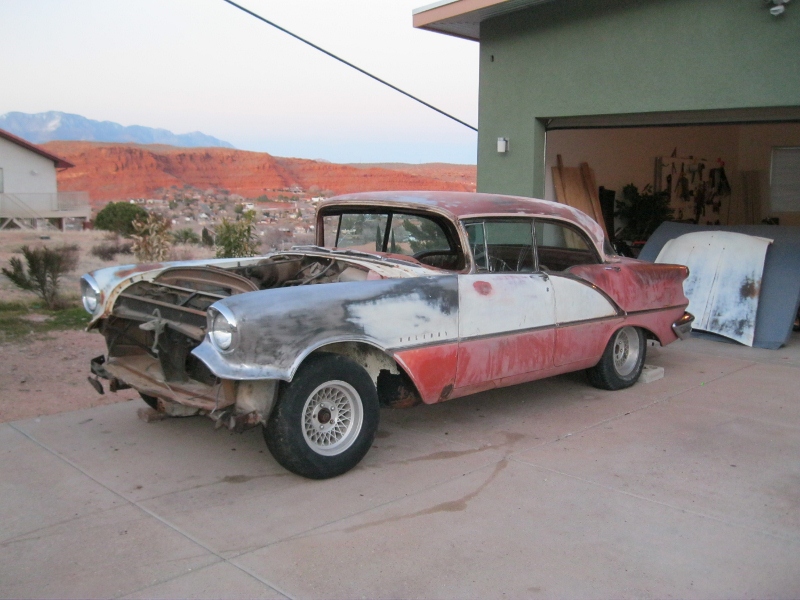

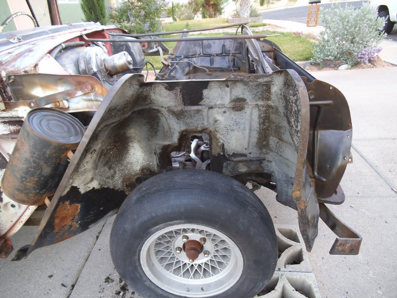

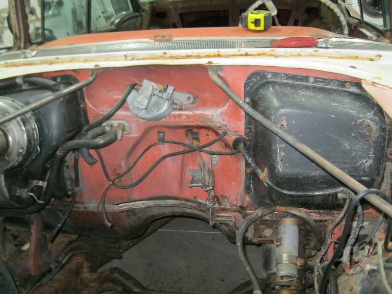

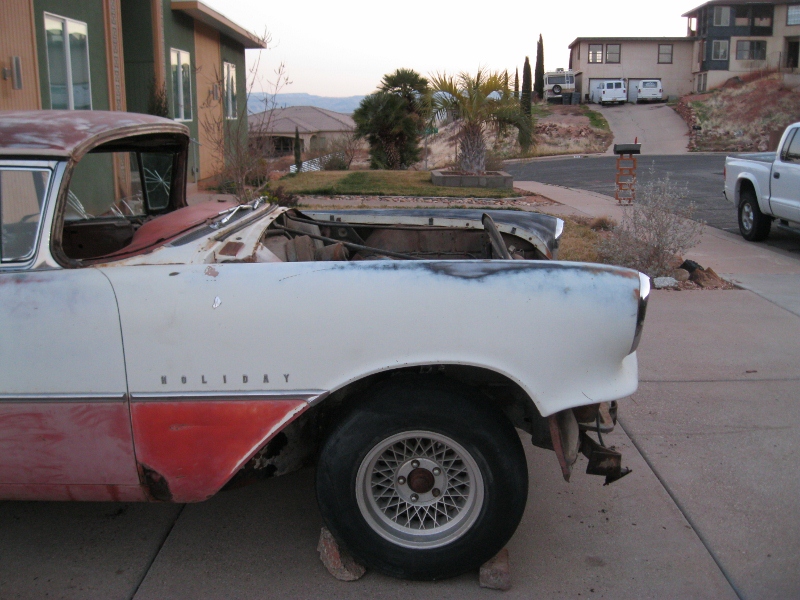

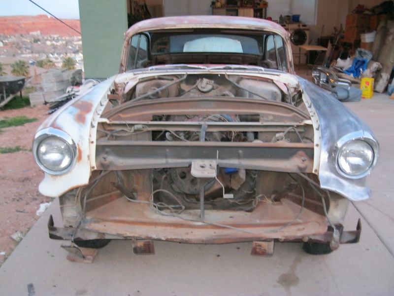

  25. being i never was on this site much from the beginning..im gonna post where i have been...heres my front end fun about 2 years ago
  26. more
  27. moooore
  28. and yet more
  29. yep
  30. more pic down memory lane...2 years ago
