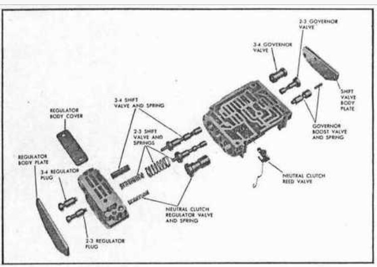

    If it were me, I'd drain, remove pan and clean screen(s) and change filter, follow Dog walking's suggestion of removing the governor, cleaning it thoroughly and replace. Fill with name brand fresh fluid, then try it out. Might just work. Good luck and keep us informed.
    vtx1800, 1934coupe and clunker like this.
  23. X3^^^^^^^^^^^^
    Also, drop the entire valve body (easy), disassemble it, clean it and make sure everything is moving freely. (Make sure you put it back EXACTLY like it was). This is another possible fix without removing tranny.[​IMG]

    Many thanks for your feedback. Will try cleaning the valvebody first - if there are any hints in doing so by checking the oil for signs of excessing wear or in case gaskets and seals don't look good anymore I will consider a complete overhaul ...

    Dogwalkins advice is sound. If it was a catastrophic failure of a seal or spring, it would effect only the gear it is associated with. And it would shift out of first and into the effected gear which would not be there so it would spin out (basically neutral). (Unless it resulted in severe leakage like the pressure regulator valve. In which case it would probably slip in first) Stuck in first has to be a valve not moving. The governor is the most likely and easy to check. My dad always told me the valves have to move thru the bores under their own weight. (Would apply to the governor too). Even the slightest burr, spec of foreign material will prevent that motion. He used to wet sand with solvent and 600 grit paper on the valves to eliminate the burrs. Sand lightly around the circumference not axially. You don't want the sand scratches to create a leakage groove directly across the valve.
    Only sand if the valve won't move under its own weight. Wash and blow dry with compressed air. 600 wet is pretty fine so it won't remove much metal. But go lightly.
