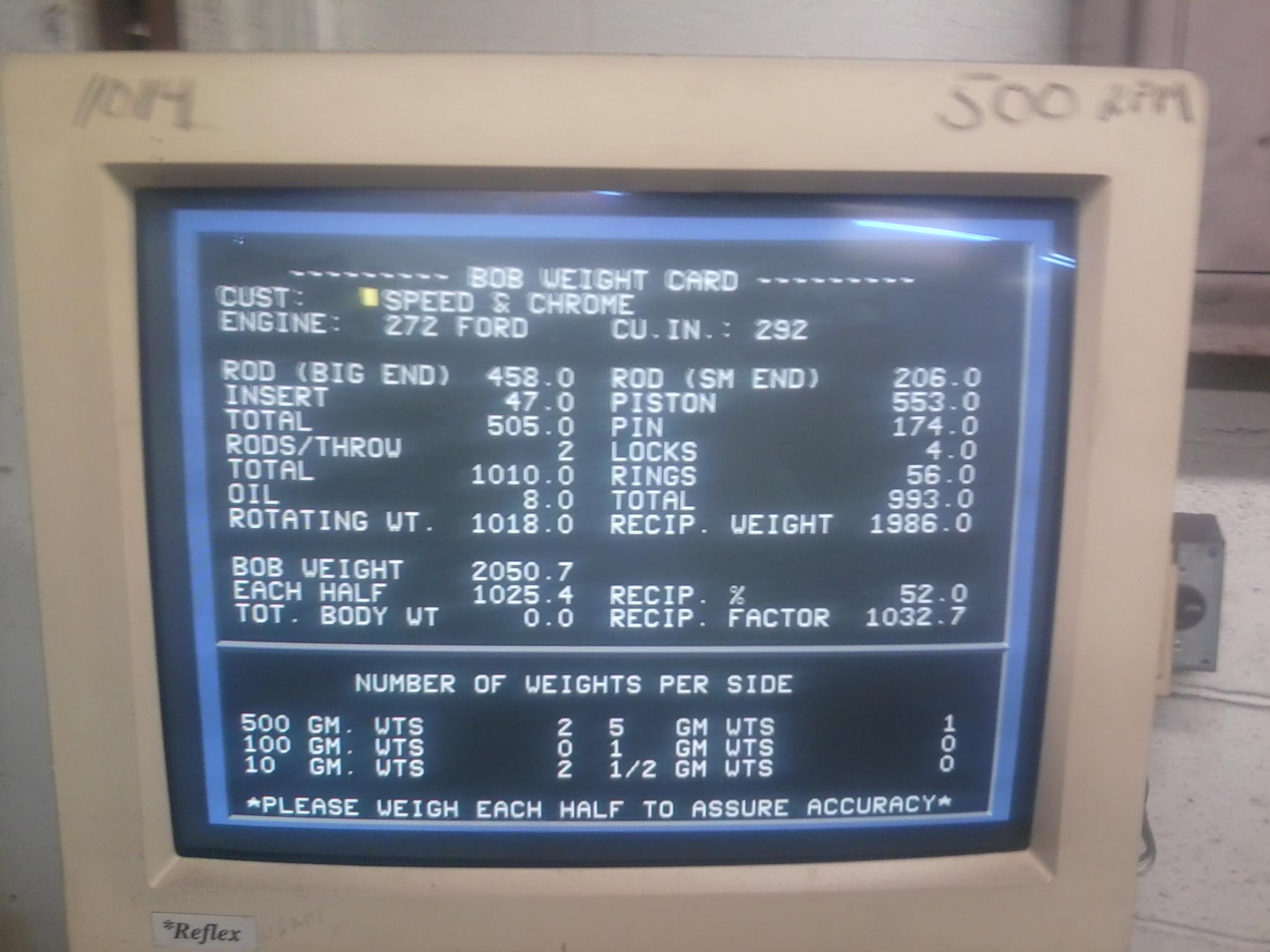

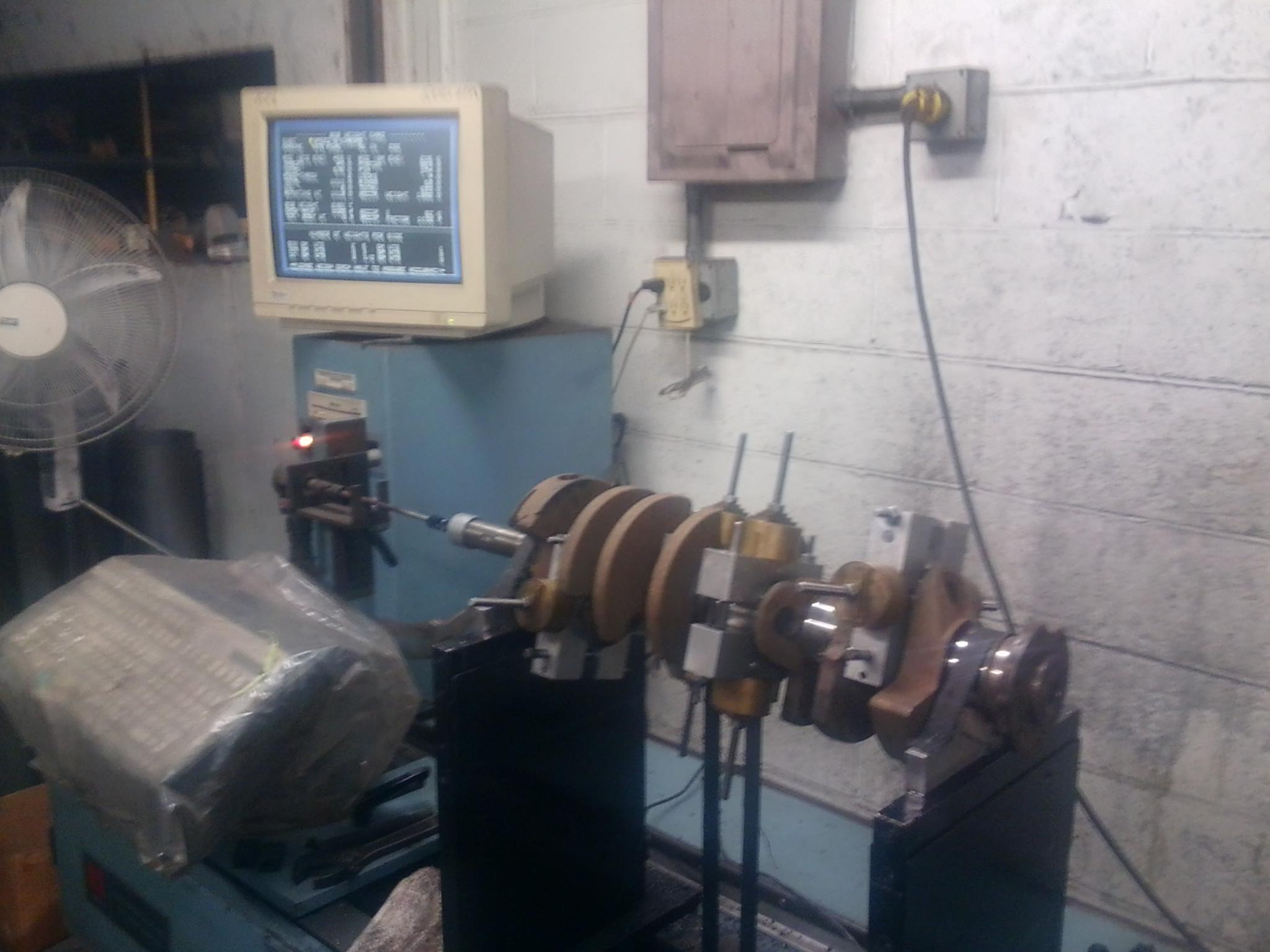

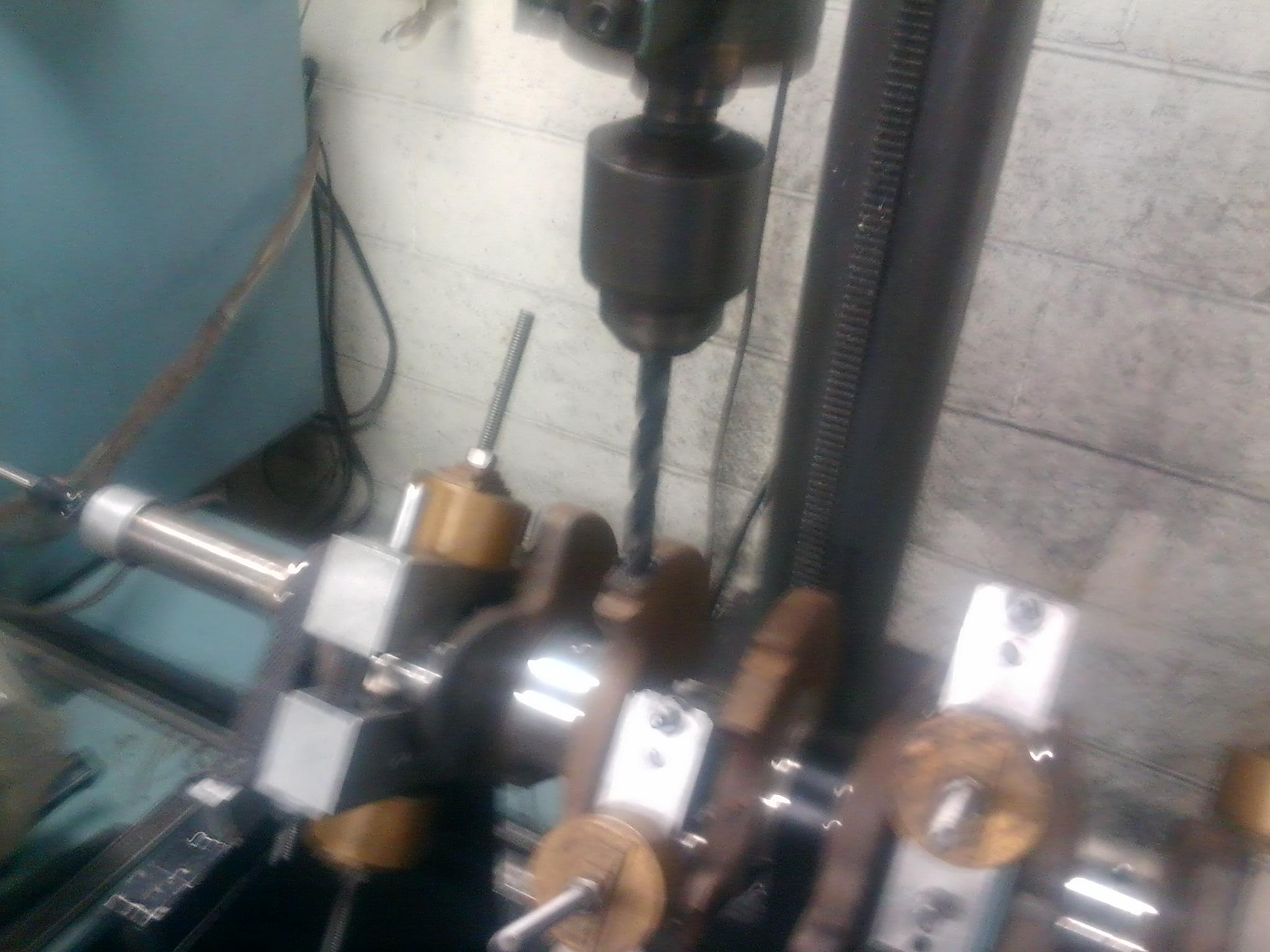

    Few pics of the balancing going on today with the crank. Dialing it in. Tim can explain more in detail.

  8. Not much to explain, or too much to explain if you really want to know. I will say this though, most engines I balance that are from the '50s or '60s
    are pretty close to begin with (of course there is some adjustment for aftermarket pistons) but all in all the big three did a fairly good job back then. '70s, not so much. :rolleyes:

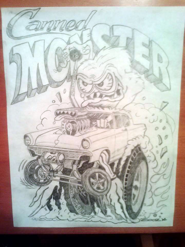

    Here is some concept art for the build.
