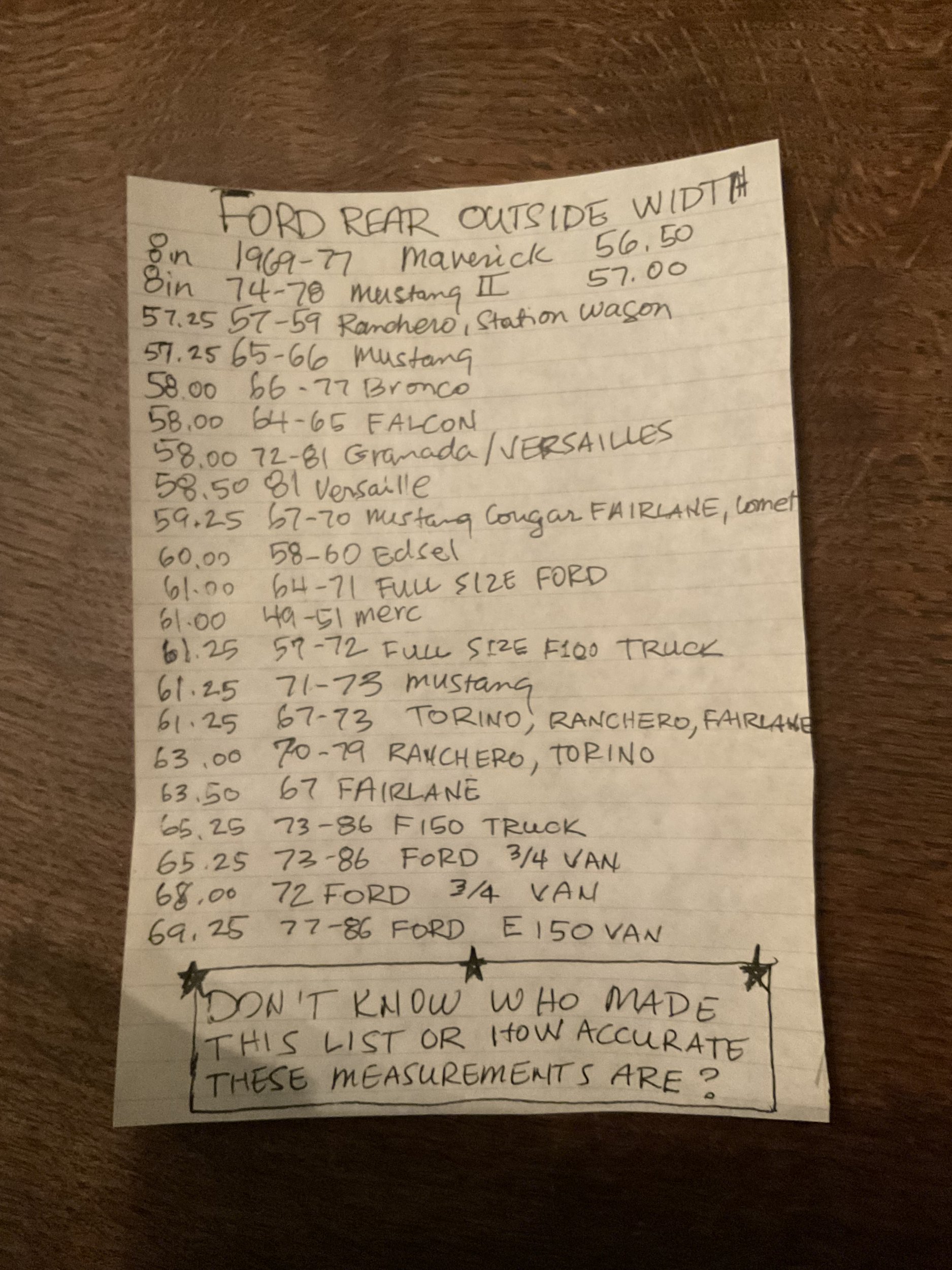

    The 55 rear is the same width as the 57-59 9 inch (57 1/4 inches, drum to drum wheel surface). Depending on how wide you want to go, the 75-80 Granadas used an 8 inch rear, a mini version of the 9 inch. Its a good strong rear and only slightly longer that the 57-59 9 inch.

  8. two-doors aren't parts cars anyways. There are a number of later-model rearends of compatible width that would work rather than using a weak early rear that parts barely exist to repair it, especially if you want a more highway-friendly gear ratio.

    If my memory serves you should be able to use just about any ford car rear up to about 67 or so when the started getting wider. mustang,falcon, fairlaine etc.
    i'd stick with the 57 and up though.

    Used a 351w powered Granada, car had power everything plus rear disc brakes and narrow enough to fit into my 51, also removed the Granada disc's and used 91 lincoln town car rear disc, had to do some mods but they are cheaper$$$ than the original Granada, and is a 9 inch.

    I put a nine inch rear end out of a approximately 59 big Mercury, into my 55 Ford when I was 16. Didn’t measure the width or the bolt pattern. The nine inch I used was a little wider than the stock 55 Ford rear end and I had to use narrow wheels and even then they rubbed sometimes I t bolted right in on the spring pads. There are nine inch rear ends of various widths. It would be a good idea to use one of the narrower nine inch rear ends, like the 1957 and the station wagons to 1959. Also check the bolt patterns as there are at least three different patterns in nine inch family.
