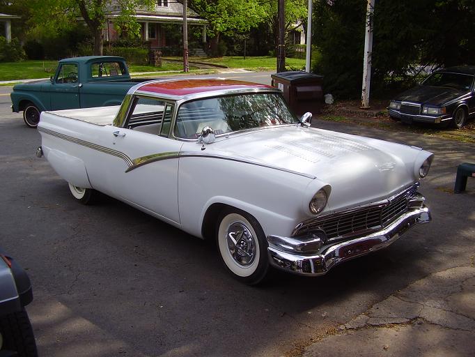

    I'm starting with a 2 door wagon and using the wrap around sedan rear glass. I told my friend John about my plan and he found this pic and e-mailed it to me.

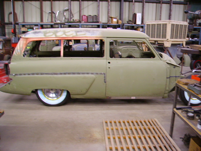

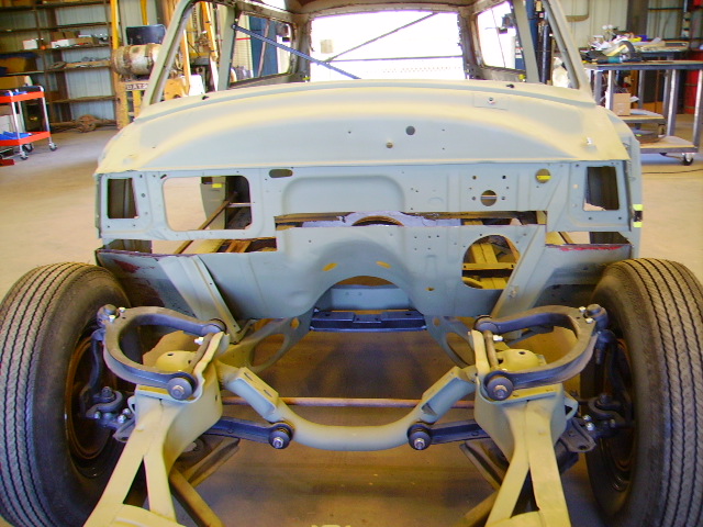

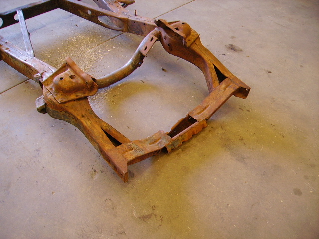

    I pulled the body and hammered out the big dents and sent it and the frame to the blasters. Here's some before shots.

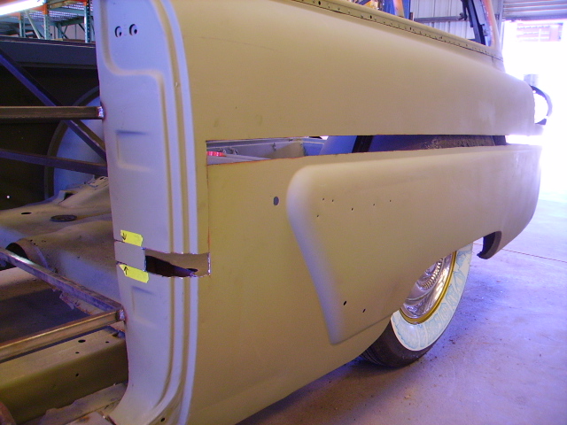

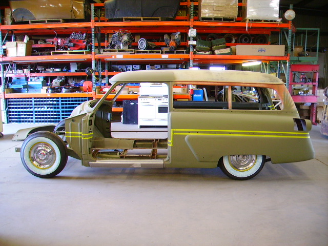

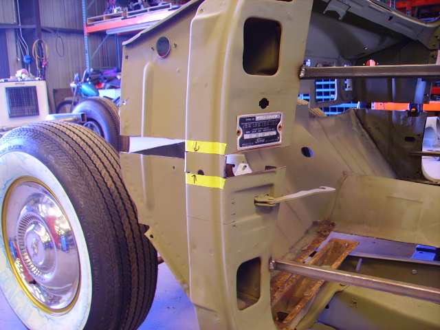

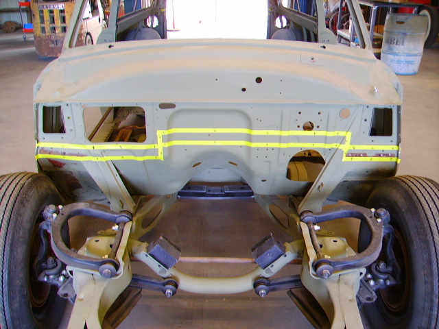

    Now it would be fun enough to just convert it to a Ranchero, so after some rocker panel work, a mild 1-1/2" section was next. And after remarking it about a dozen times, here's what I came up with

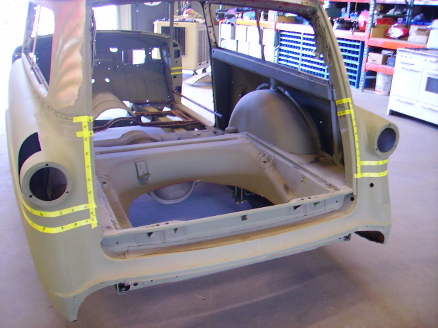

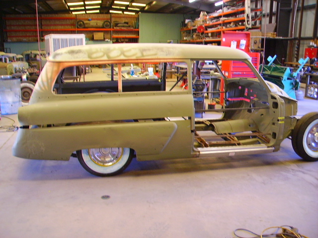

    And this is what happened after my buddy Jerrad and I went after it with some cut off wheels

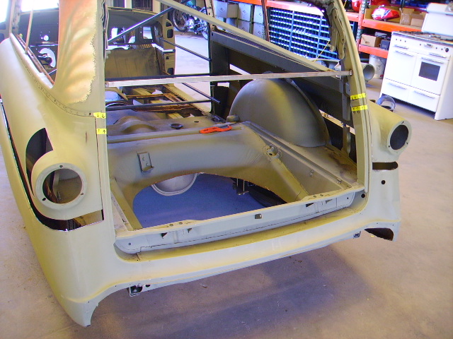

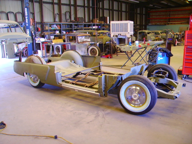

    Back on with the top half of the body and mocked up with the door. That's where it's at so far. Drivers door, fenders and wheel wells are next. After that, it's time for the top. And that's when I'll know if I ruined a wagon or not :D

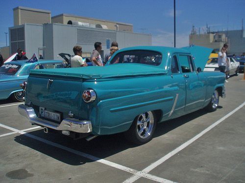

    Lot's of cool pictures on Google Images under "1955 Ford Ute" I thought this pic was a winner. Also since you will have some leftovers from the parts cars,maybe pic#2 might be next?? :D

    I like the concept and I think you did a fantastic job with the sectioning so I'm sure the metalwork execution will be top notch.

    I love the mild section job, too often guys take way too much out, but I think you nailed it! As for the back window I am not a big fan of using the sedan backlight...why not post some pics in the massive photoshop thread, and ask if some of the guys could do some different renderings for you..I am looking forward to following your progress!!

    I know that using the sedan back glass is a gamble and may seem odd, but I forgot to mention that the top is getting a fairly heavy chop. The chop will help flatten out, or de-bubble, the top. The only problem with a heavy chop is that the lower half of the body will start to look tall, but the 1-1/2" section just too care of that ;)
