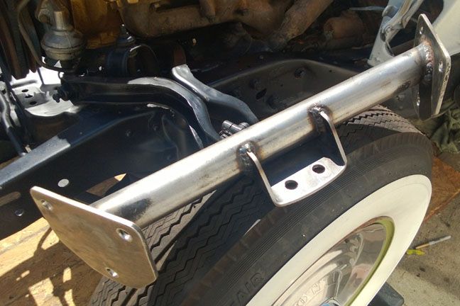

    Here we are last night, figuring out a new trans crossmember...
    This morning, while I was at work, my bro pulled the motor so we could have the mounts welded to the frame.. and by the way here are both right and left mounts :)

  19. Looking great so far mate, just a tip though. The weld right under the bit of tube that the bolt runs though almost looks like its been done in a series of tacks. If thats the case it needs to be ground out and rewelded. The rest of the welds look pretty reasonable though!

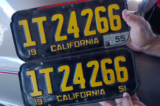

    Thanks SoCal, here's another thing I forgot to mention. I was looking for a set of Tags and I happened to mention that to an Old Timer I know. He said I got some... so I bought them. Unfortunately the number is currently in use so no YOM for me, but I'm slapping them on anyway ;)

    Alright cool cats here's the official update.. The engine is IN!!!! :D
    Got up early this morning and had someone come and weld the mounts for me..
    While the guy was at it, my buddy came over with the Trans crossmember
    So fellas.. here it is, with no help from a hoist..
