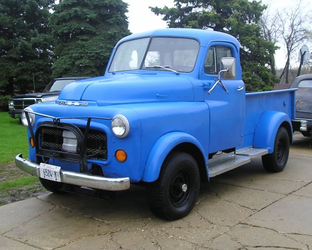

    So this is going to be our build/re-build thread on the new pickup truck that we bought. I went down to Pittsburg, KS to pick it up from a guy down there with some gorgeous old cars. Current plan is to get it road worthy, legal, and drive the tires off it while fixing it up.
    Got to show it to our daughter for the first time, she wisely went to the front to listen.
    Current specs:
    1953 Dodge - Actually was a 5 window that someone welded extra windows (ARGH!)
    Plymouth Volare front end
    3.8L FWD Buick Regal V6 (!?)
    700R Automatic
    9" Ford Rear End ??? ratio

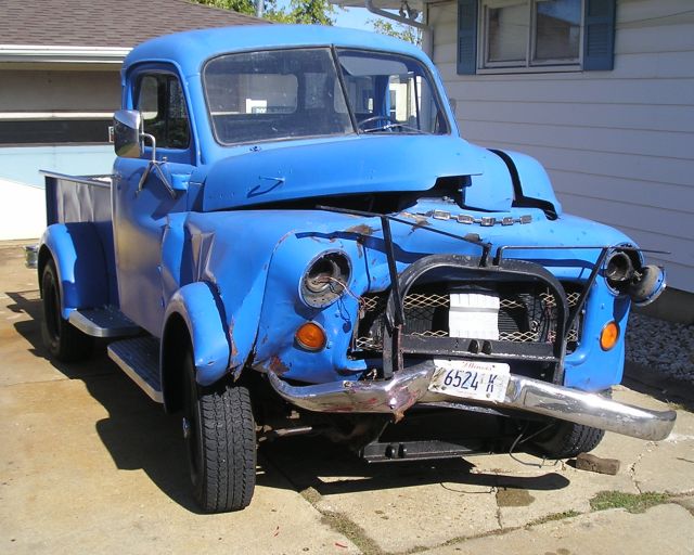

  11. gene-koning
    Joined: Oct 28, 2016
    Posts: 4,096
    gene-koning
    Head on at 30 mph. Actually, the cab survived quite well. It was on a newer Dodge 4x4 frame, and it did not do so well. The passenger side was about 18" shorter then the driver side. The frame buckled enough to punch a hole in the oil filter on a 360 Dodge motor. The impact broke a 3" x 4" chunk out of the cast iron transfercase. The brackets on the front are for a 70s version of a Meyers snow plow, and the 3/8" angle iron bent and cracked before the 4 welds failed. The lady that turned in front of me said she didn't see my truck. All I saw was the fender of her red car crossing the double yellow lines before we hit. The truck stopped instantly upon impact, the car bounced back a couple car lengths. The truck weighed 4688 lbs. I got 11 stitches on the top of my head where it made contact with the header above the windshield, and a sprained thumb on my right hand. The ladies car had air bags the likely saved her life. She was uninjured.
    I could have rebuilt it, I sat on it for 6 months debating, but concluded it was time to move on. I was able to keep the truck and I still come out pretty good with her insurance. The truck went into northern WI to supply needed parts for another Dodge truck build. Gene
