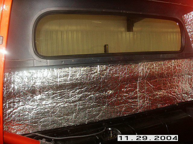

  2. RAY With
    Joined: Mar 15, 2009
    Posts: 3,132
    RAY With
    It sits behind the seat-Filler neck is on the passenger side of the cab--This is the factory location and I used a Factory tank and sender--In the picture you can see the top of the tank and sending unit

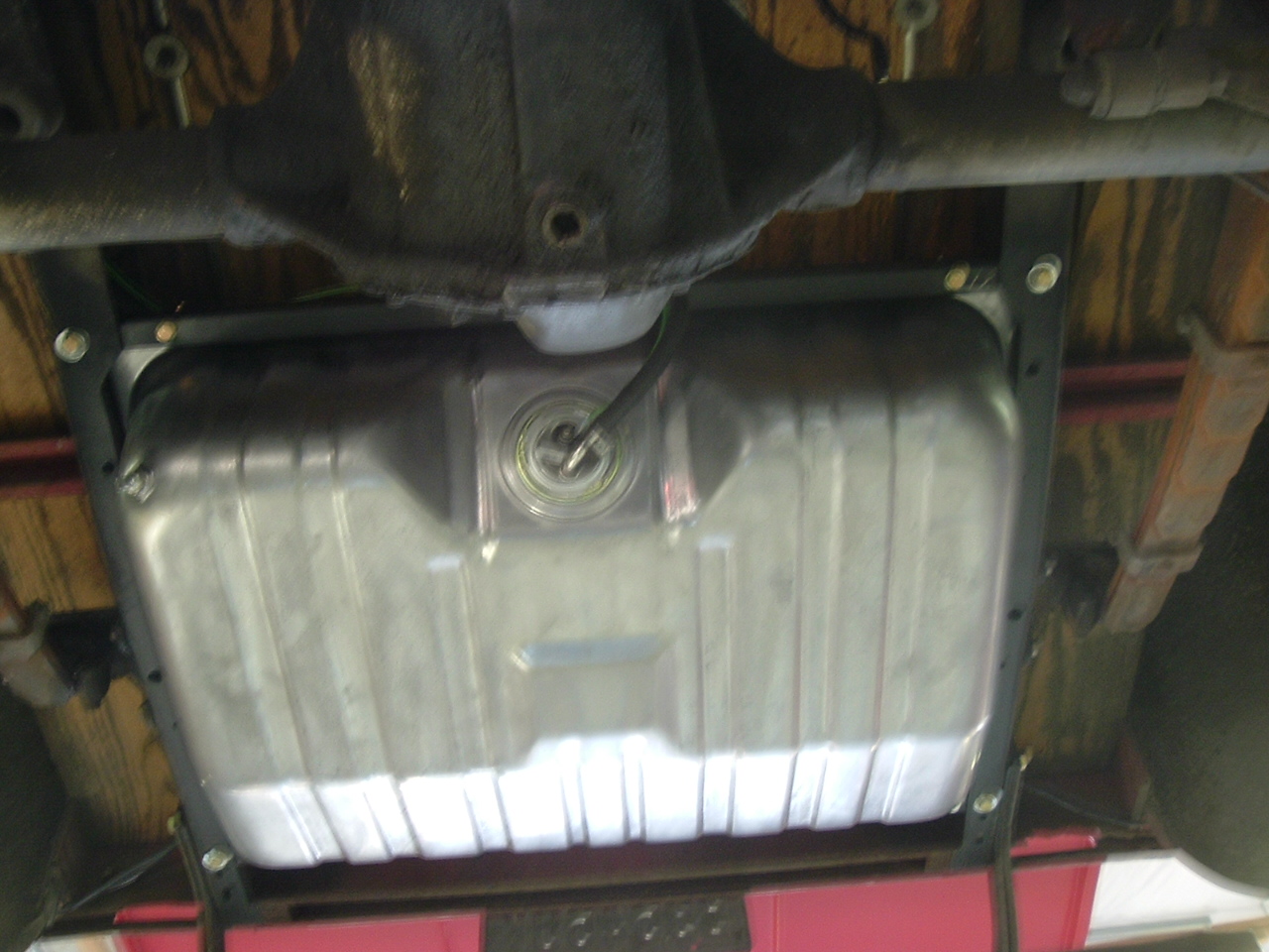

  15. orcas tow
    Joined: Nov 23, 2004
    Posts: 282
    orcas tow
    65 Mustang 16 gallon tank behind the rear end or a 69 Mustang/Cougar 20 gallon tank, both fit nicely between the rails & are a flange style tank, no straps. As far as I understand the Mustang sender is compatible with the stock F-1 gauge.

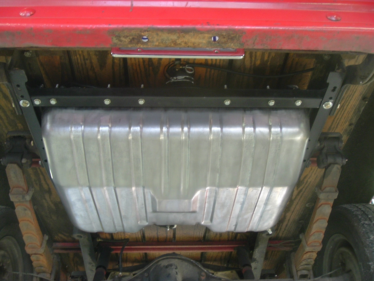

  16. brewsir
    Joined: Mar 4, 2001
    Posts: 3,278
    brewsir
    That's the tank I like....only about $120 on ebay including everything you need. I had to trim a small amount off the inside edges of the framerails (maybe a quarter inch each side) and remove one crossmember and add another....I also pie cut the side rails a little so the tank could sit flush on the rails....if you have any ability to do fab work you can put the mustang tank in the back....yea you probably need to put the filler in the bed...but are you really hauling that much that you can't plan ahead?

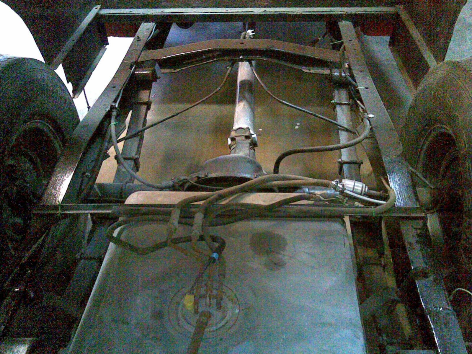

  17. Ole don
    Joined: Dec 16, 2005
    Posts: 2,915
    Ole don
    You may want to look in to a Ranger tank that is bolted to the frame and some hangers on the left side behind the cab. There are steel skid plates available from the 4X4 model.
  18. orcas tow
    Posts: 282
    orcas tow
    I installed the 69 Mustang tank today, filler is in the bed floor, a little trimming of the frame rails is required, moved the 2 rear cromembers forward & back, pretty simple install, it all comes out the bottom if repair is needed.
    Lots of clearance & the stock F-1 gauge reads accurate with the 69 Mustang sender too.

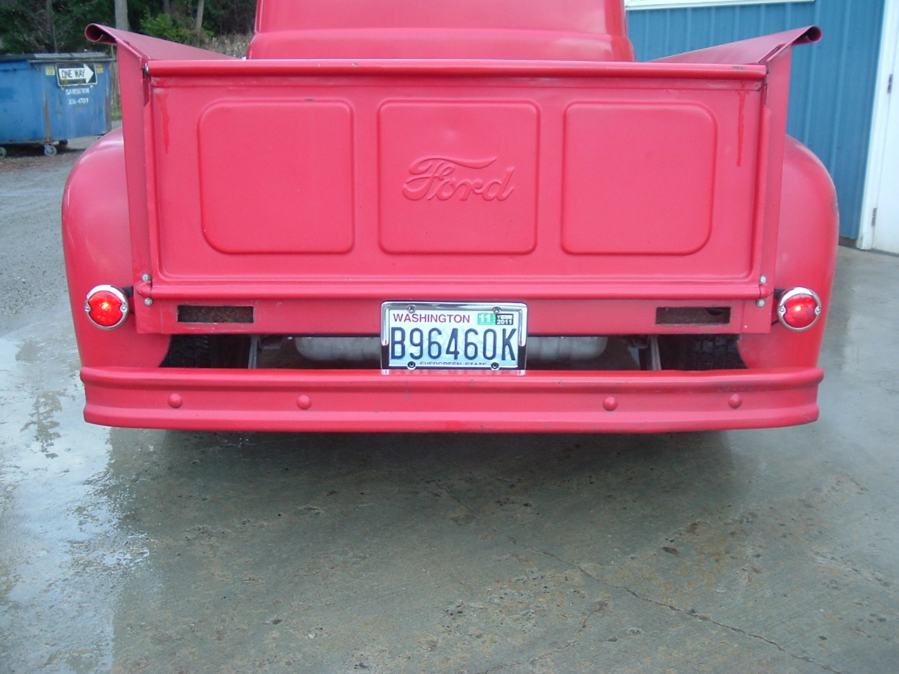

  29. Here's mine, universal from Tanks.
