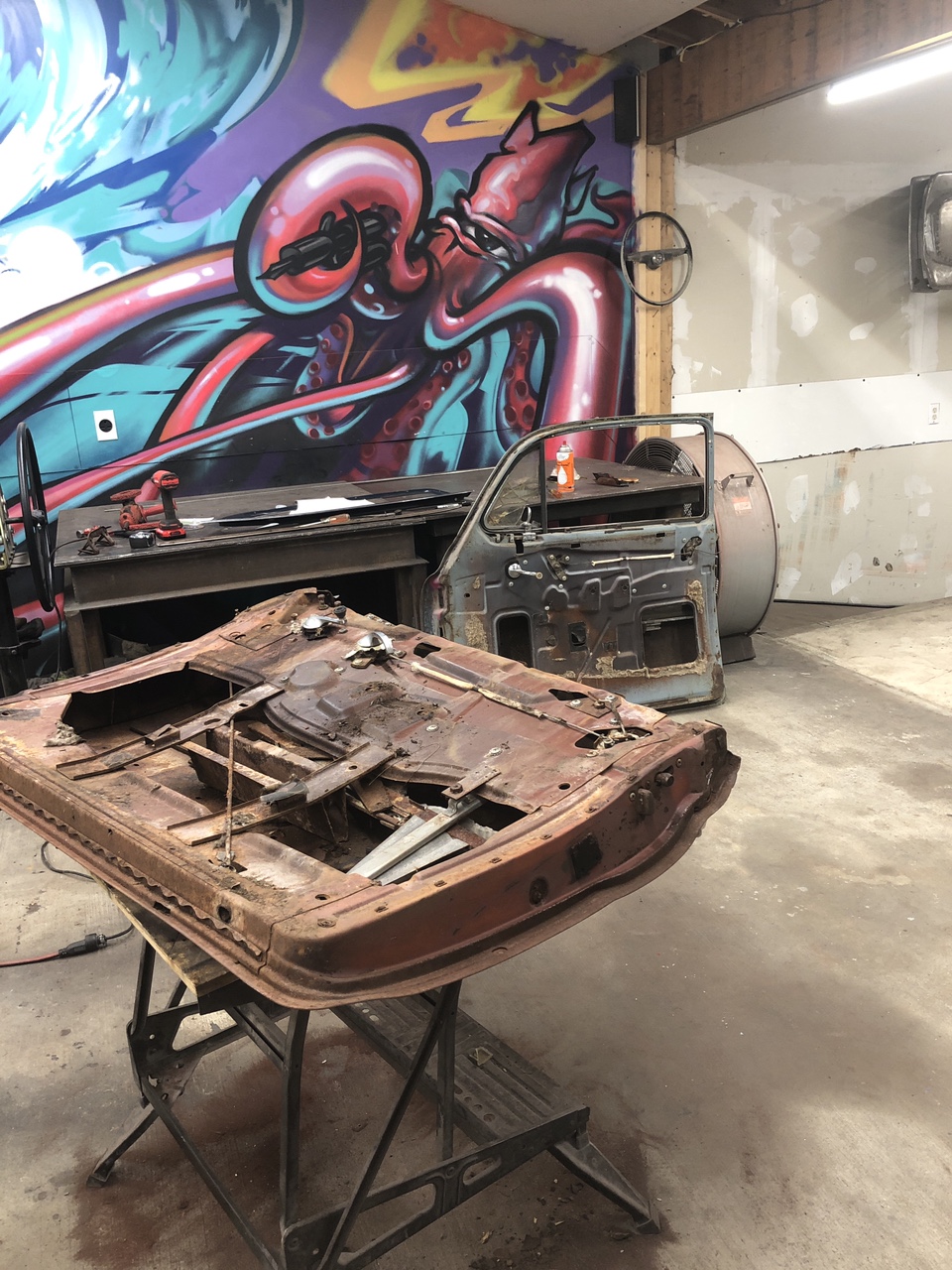

    Been a minute wanted to update the build thread been going back and fourth about the chop on the roof. Before moving forward with that I wanted to get the doors back on the car. I knew I wanted to get rid of the b pillar. And always loved how they hardtops looked and functioned. So I found a 50 Pontiac hardtop donor car. It was a nice car but passenger side took a pretty hard beating.
    [​IMG]So here’s the progress
    [​IMG]. [​IMG][​IMG]
    So I spliced the back of the hardtop door to the cars original door.[​IMG]
    Then once I got it to fit probably I cut the 2” s off the bottom. Since the car is sectioned 2”s.
    So after working that out on the passenger side I’ll get to work on the driver side and start wrapping my head around the quarter glass. Think it’s going to be a similar process.

    Been a hot minute. I’ve had a few other projects I had to work on. Back on the 52. Here’s some progress on the roof chop. Oh and sorry yeah the front wheel openings are from a 56 olds. 9A96D81C-C332-4265-8194-2F1D70A25DD6.jpg 9CEC155A-F7CB-4AC1-9F45-42EF2B8AEAA2.jpg IMG_2720.JPG IMG_2721.JPG
