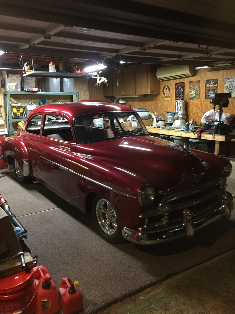

    I have a 50 sedan I'm working on right now not far from done but I'm not going to chop it tho . ImageUploadedByH.A.M.B.1430755022.479575.jpg

    Nice!
