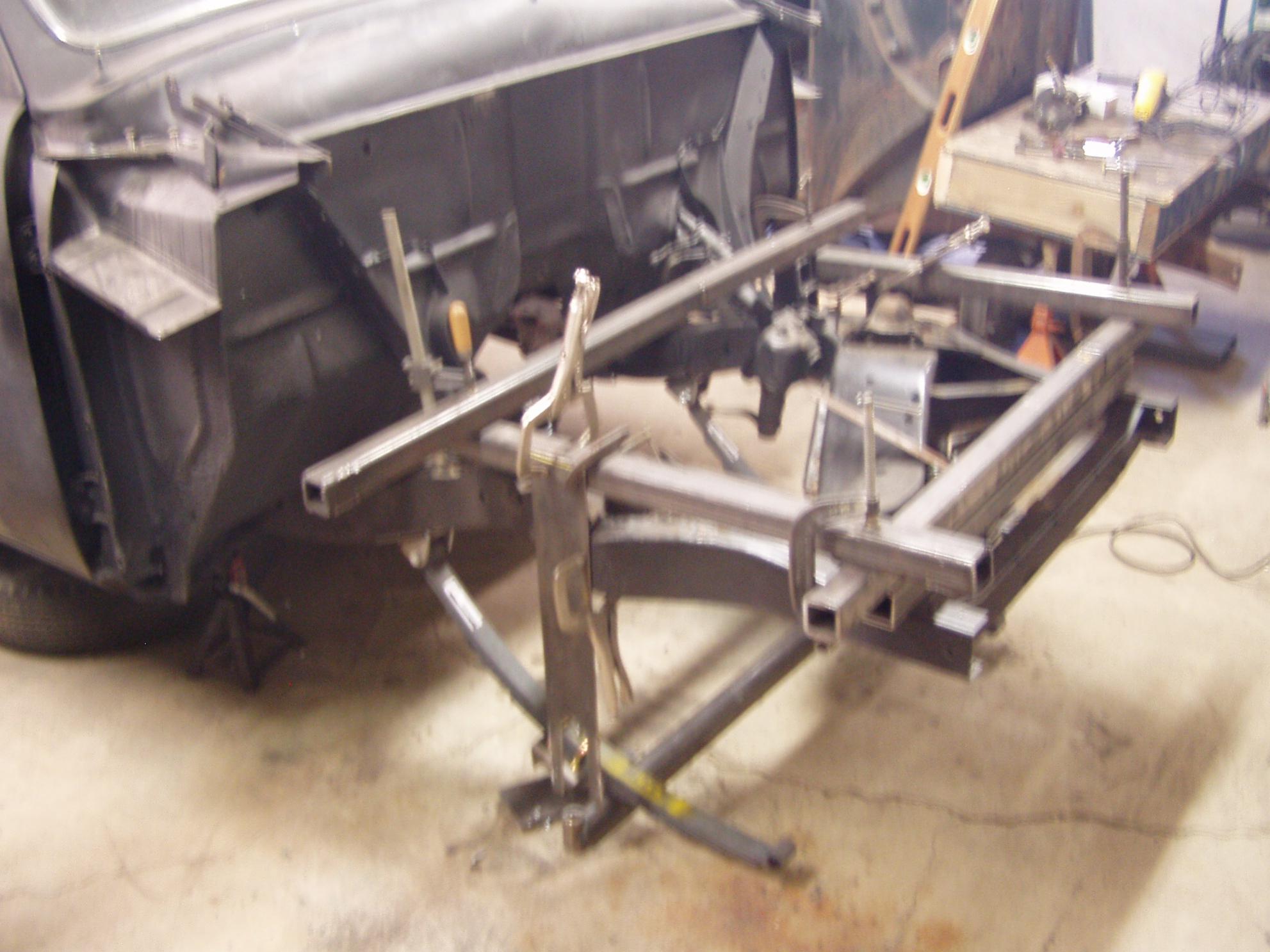

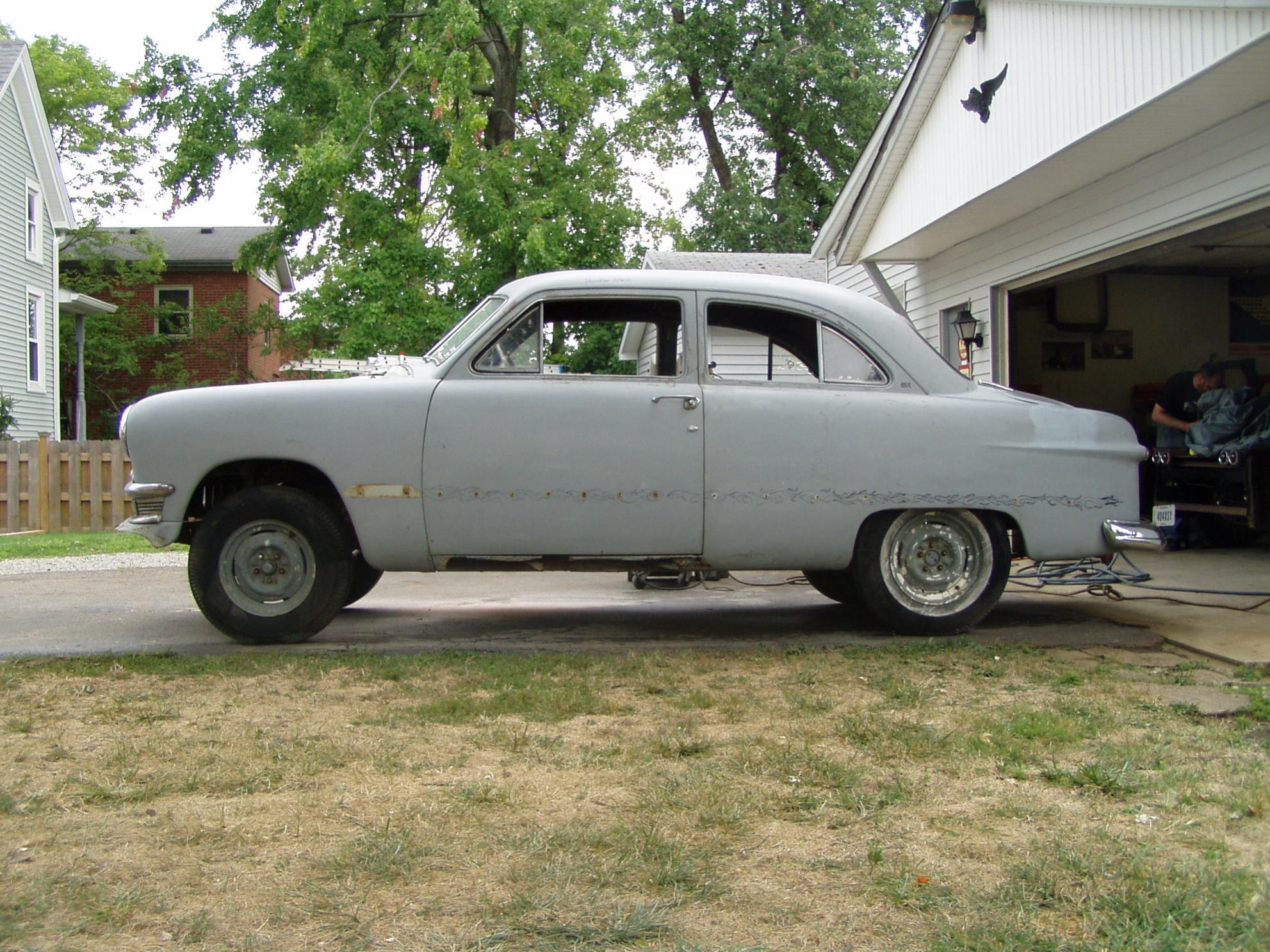

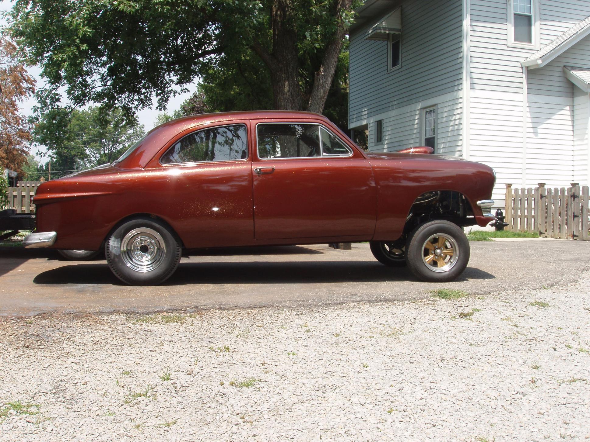

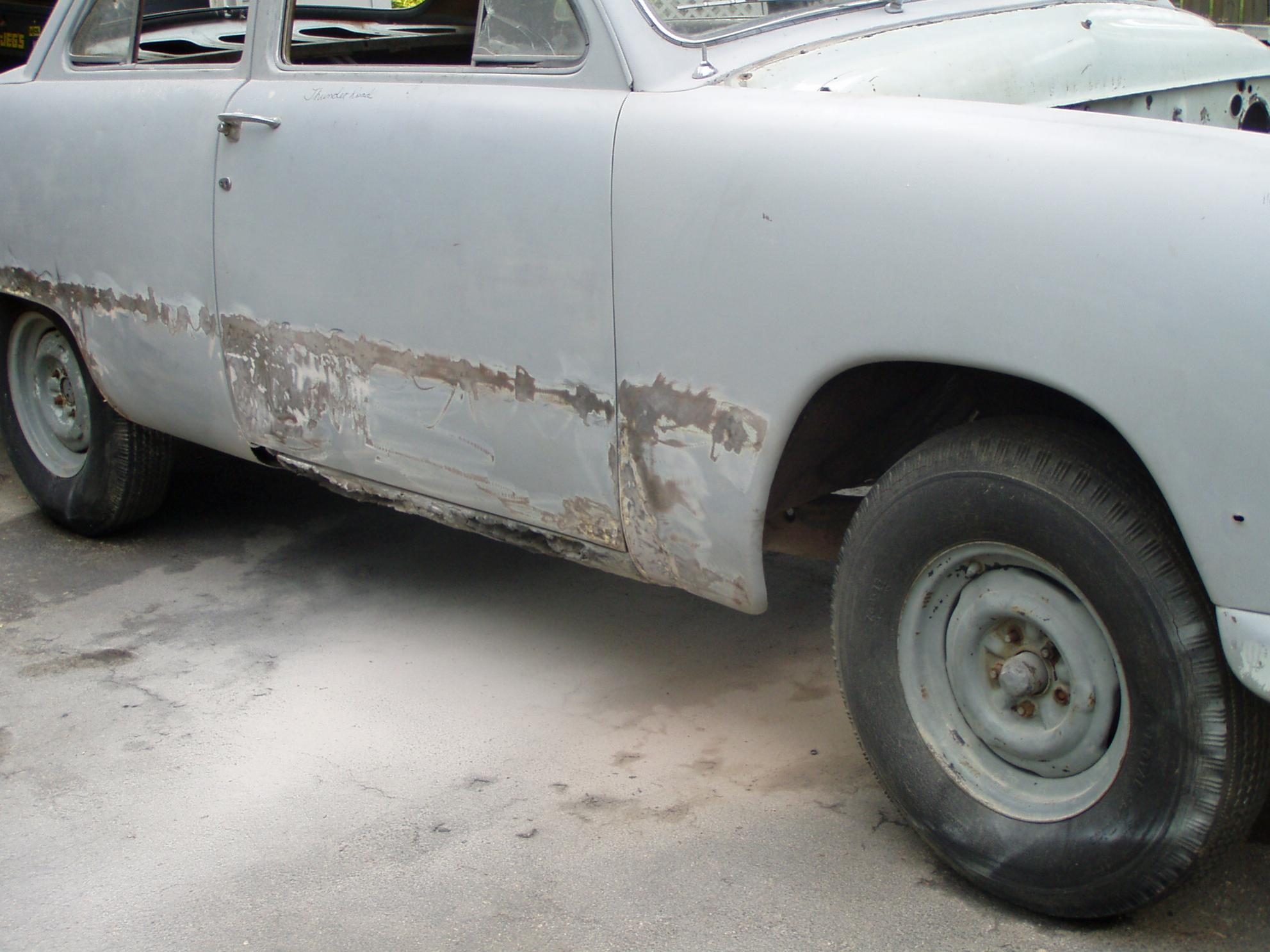

I picked this car up in August of 2008 and spent last winter/spring getting it ready for the HRR in Bowling Green, Ky, and painted in July for our local hot rod drag event. The car was pretty solid to start with since it came out of NM in 2005. I had to put new rockers in both sides, front floor pans, lower front fender patch panels, and the rust in the rear was cut out when I radiused the rear wheel openings. I also had to add a taller driveshaft tunnel since the transmission sits up hirer in the car with the straight axle set up in order to level the intake to 0 degrees. I have mustang bench seats for the interior and will be adding a roll bar this year. I ran a 450hp 355ci SBC and muncie 4spd with a 9" ford 4:56 gears last year and turned average times of 13.6 at 101 mph. In September I put rod #7 out the pan and will be running another 355ci at about 570hp this time and upgraded to an Autogear 4spd. The front wheels are MT with painted gold centers and the rear are OE style chrome wheels with Hurst recap street slicks. Kevin

I really like your car. I had thought about building a Ford gasser and this helps me feel even better about the idea. I really dig the brown on this car! Nice job.

I am getting started on a '51. Only difference in stance will be mine has a 4" dropped axle so the car will set down more in front. Mine will have a 350 with a B&M street Charger (because I have it already). Otherwise we tend to think alike. Any more pics of the front stub modifications?
