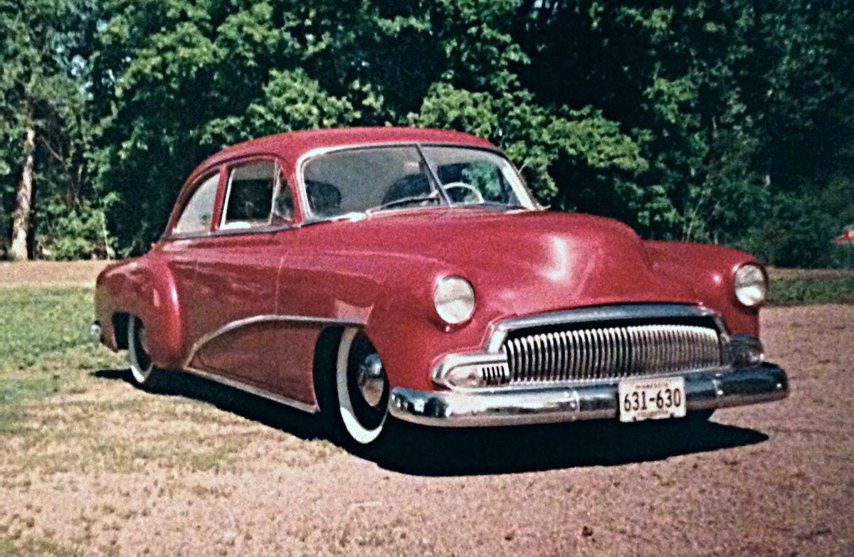

    Here is a pic of a Chevy I built back in the eighties. 3 piece bumpers are all we had back then. California and Canada has the 1 piece. I saw pontiacs of the early fifties vintage in the junkyard and they had one piece bumpers and are the same as the chevies.
