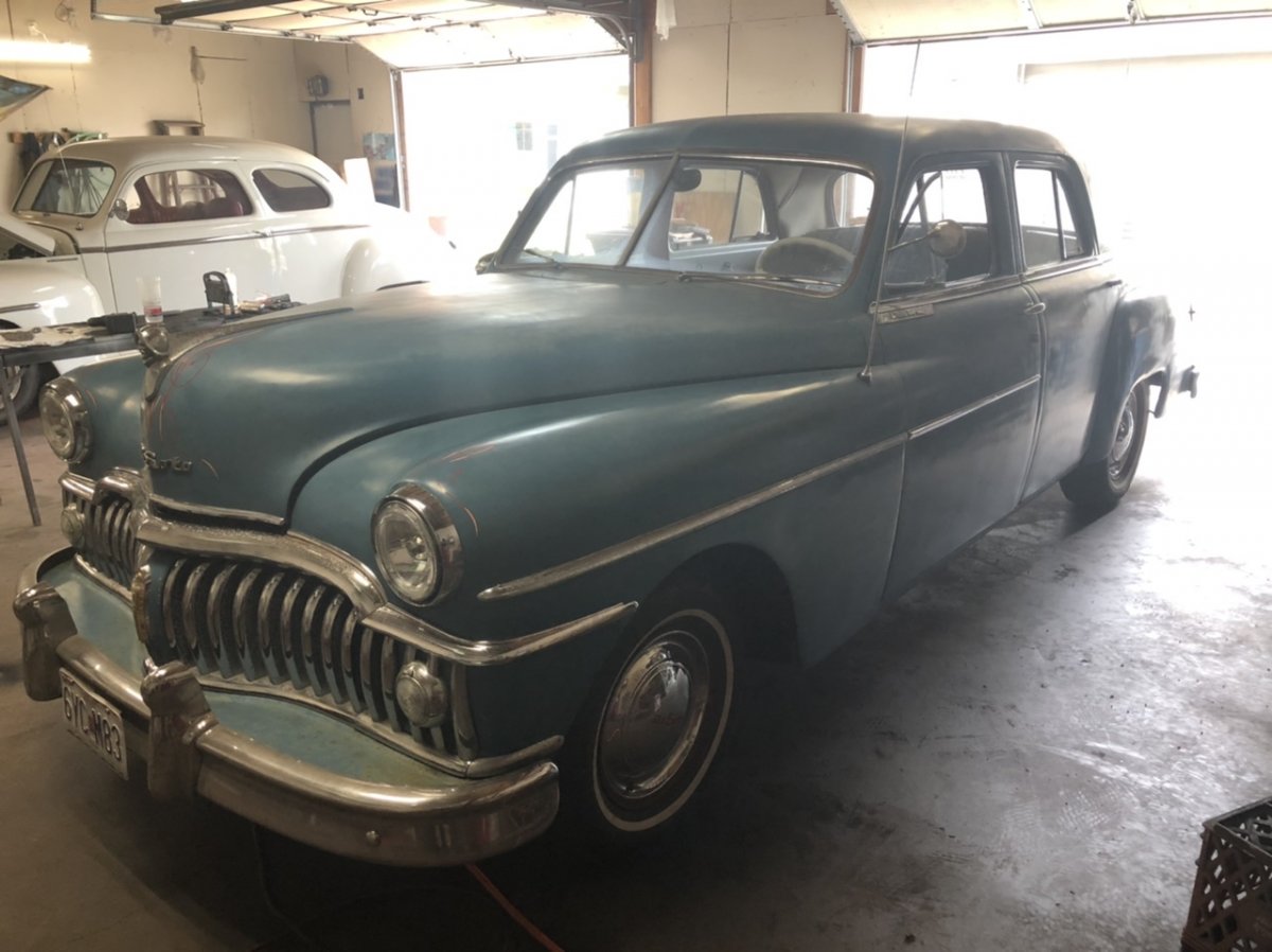

Projects 1950 Desoto Custom

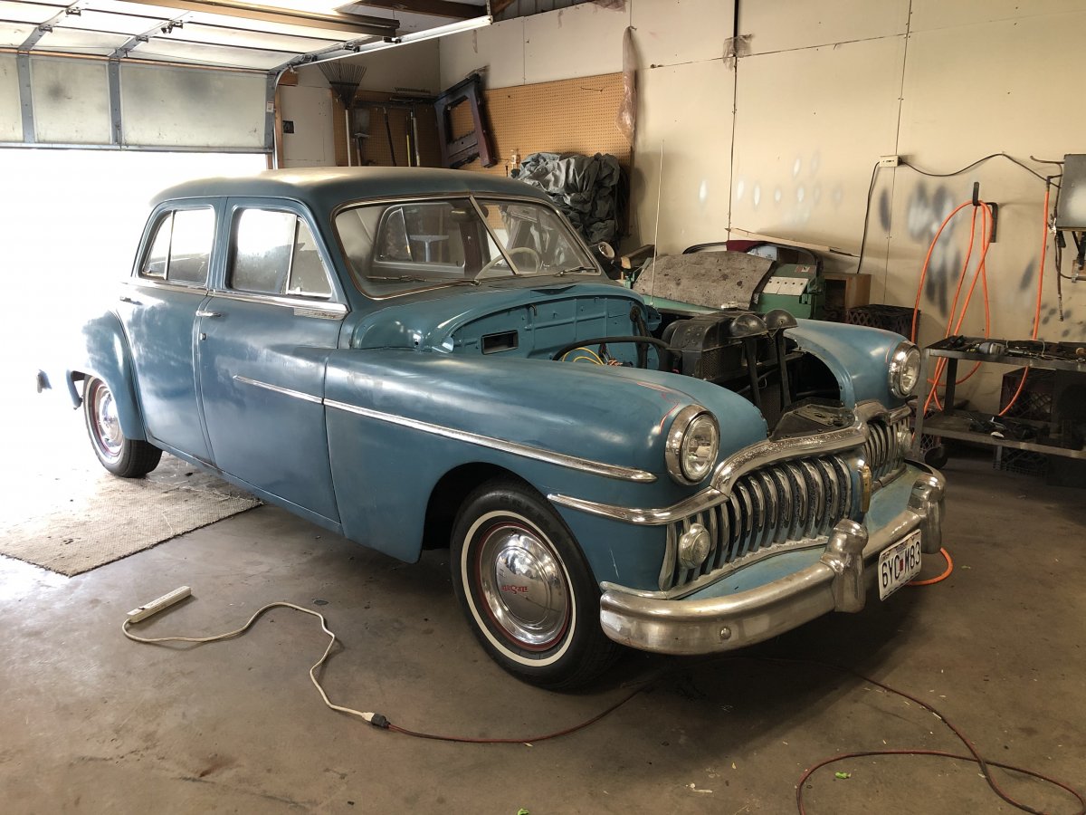

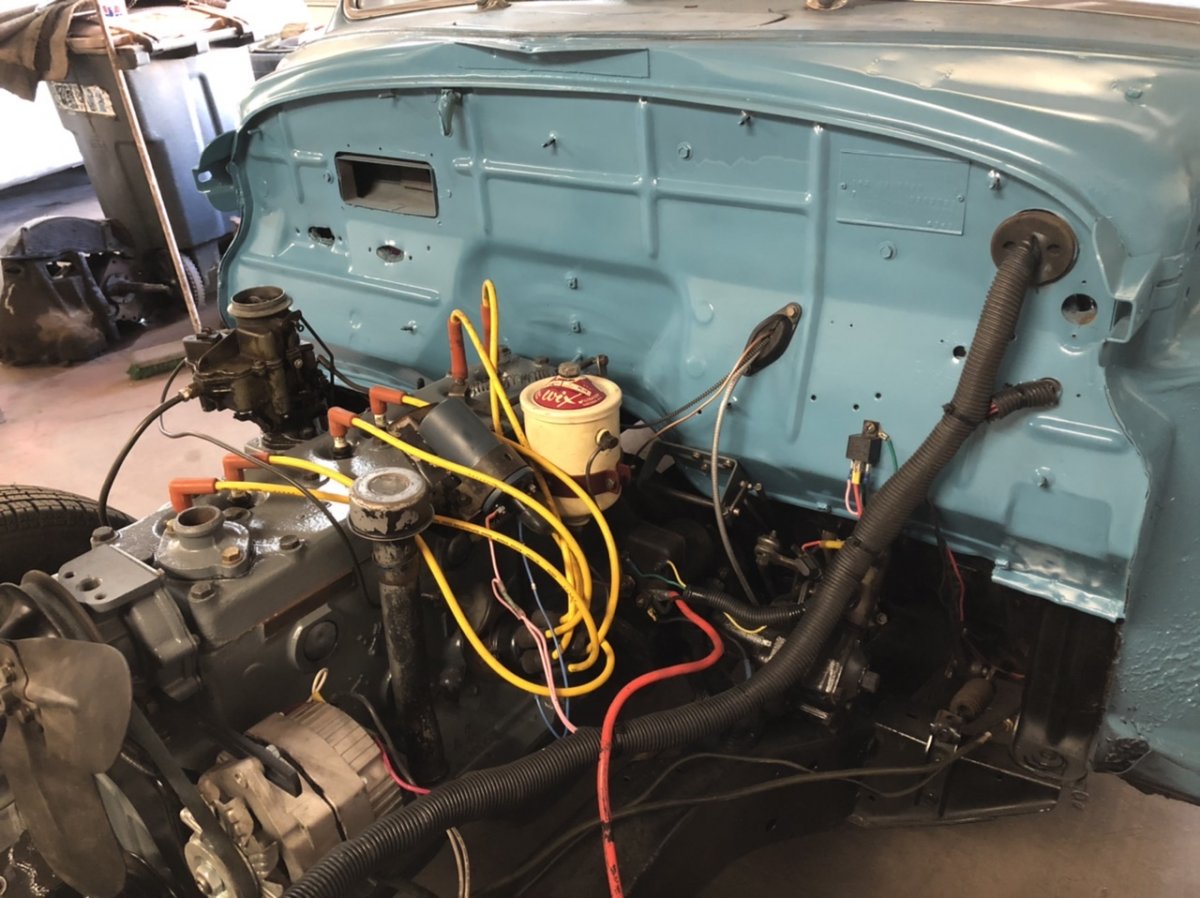

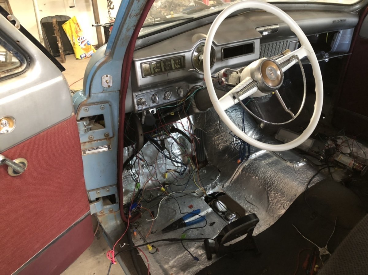

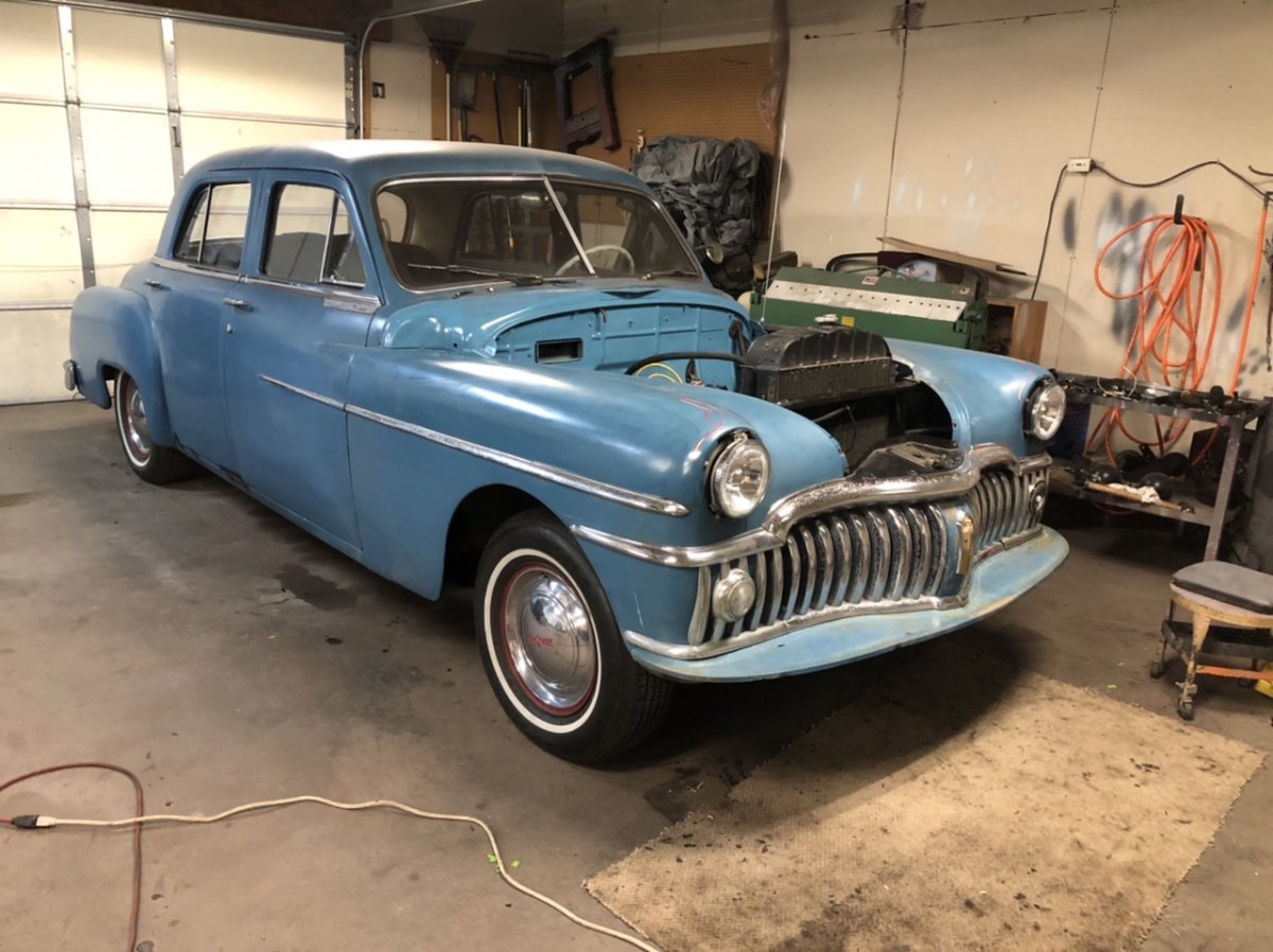

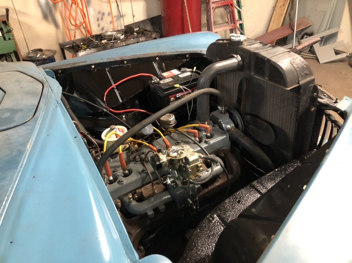

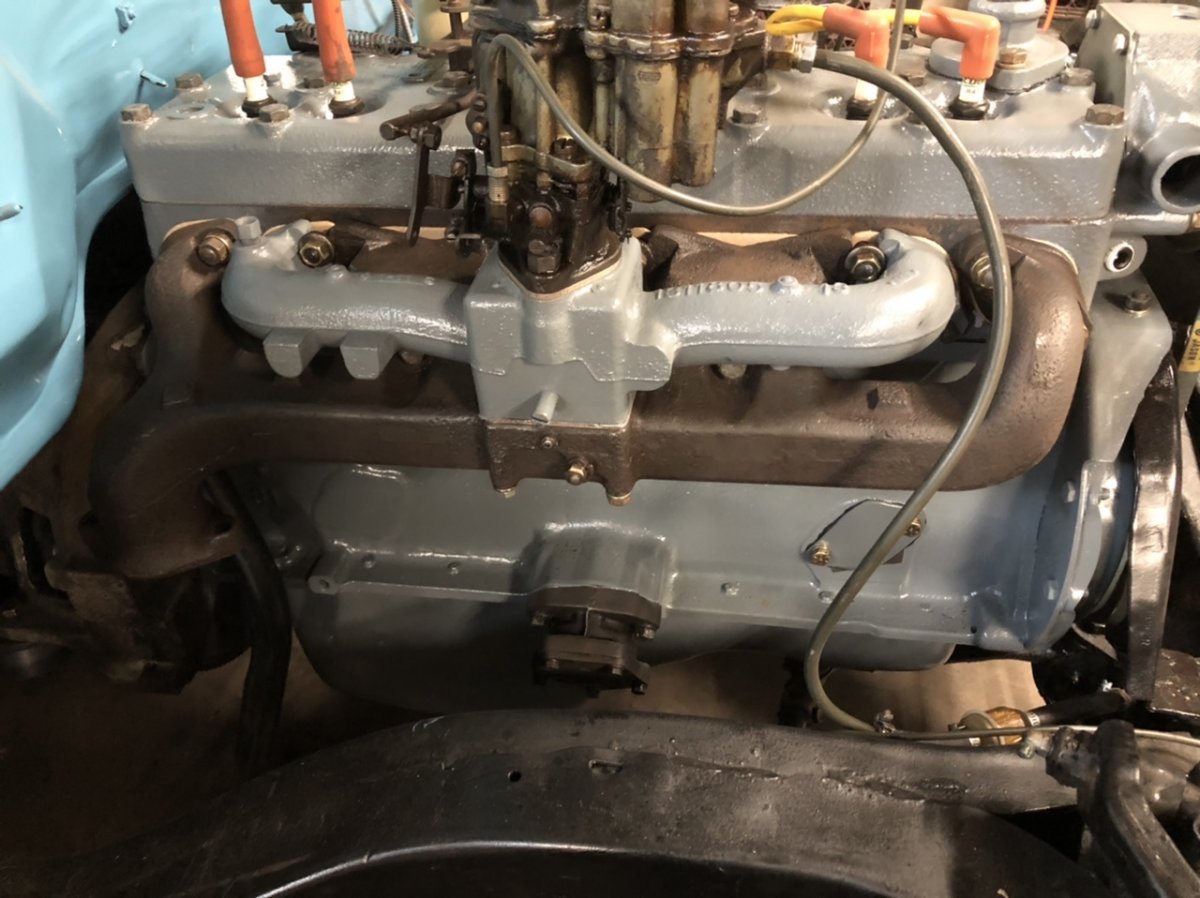

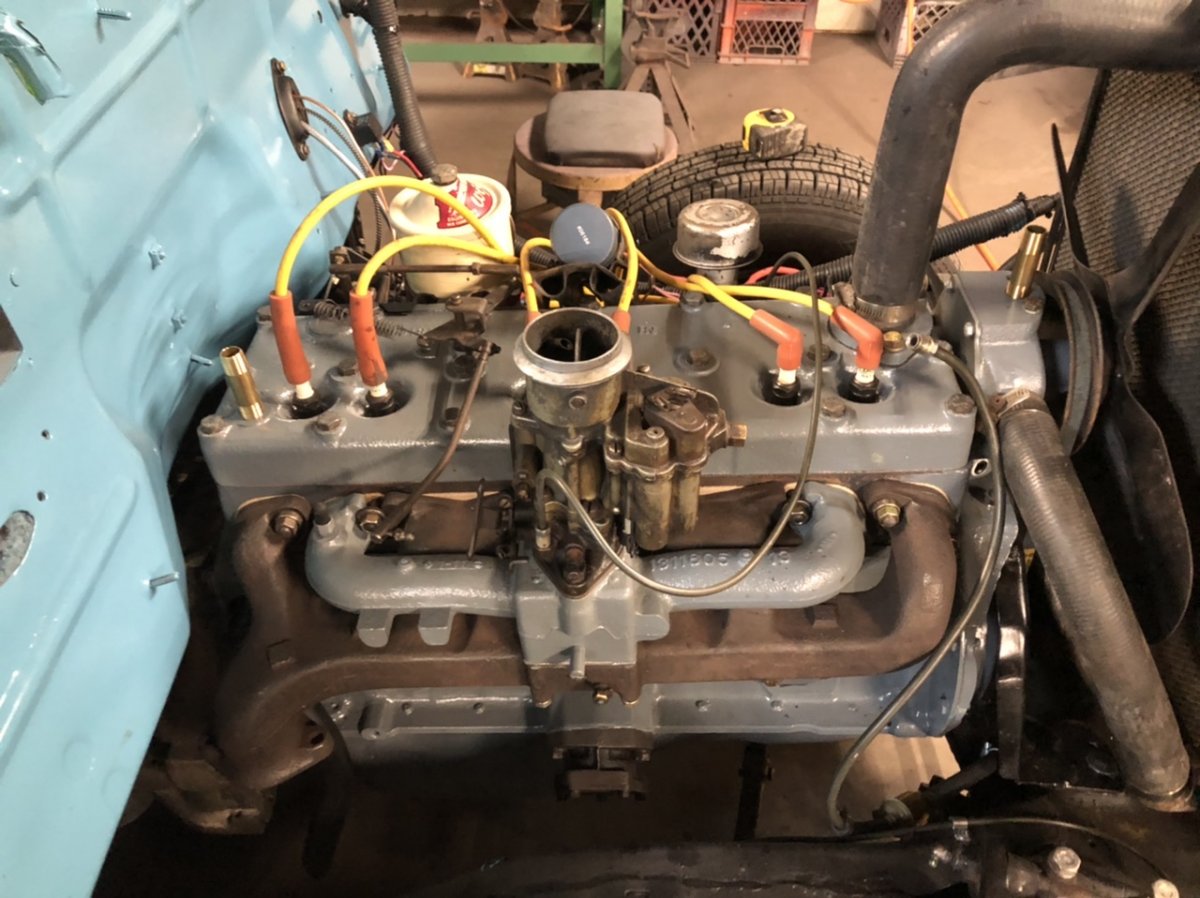

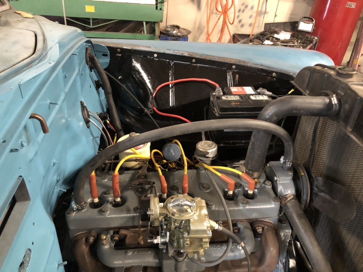

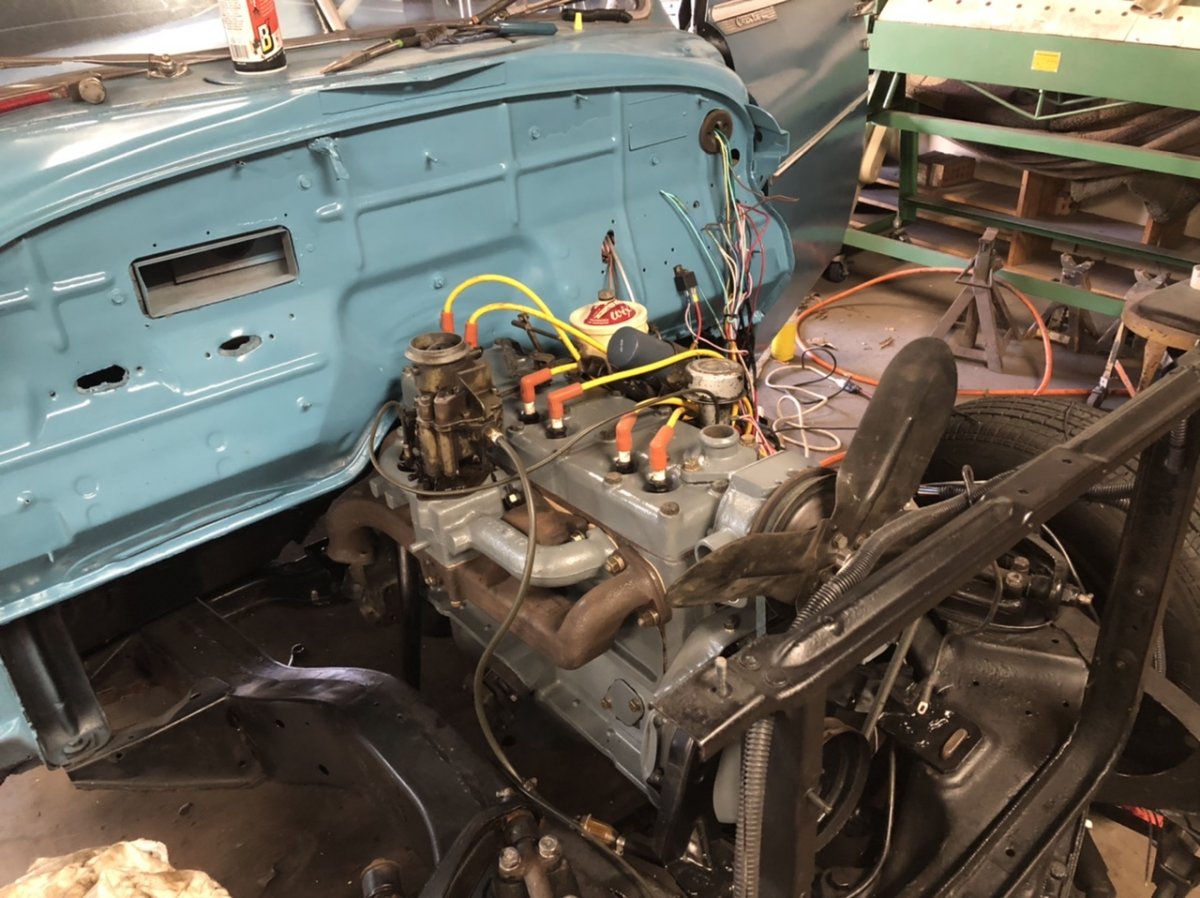

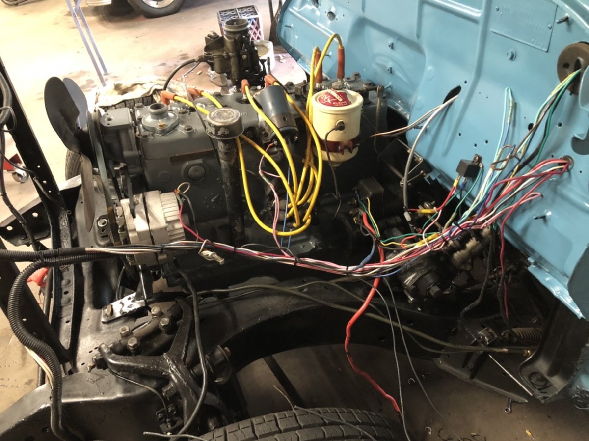

    96DA9321-9C46-4463-88DA-D686A00A321E.jpeg 5C79EC66-0344-4ECA-9259-98CA93A0227E.jpeg CC7DE117-8098-492E-A92B-6C44B96612F5.jpeg 470E5E91-B1D4-4482-9B14-ADC6A3CE2B01.jpeg Success! Got the motor fired up today and it sounds great other than the carb being pretty iffy. I might try one of those EBay YF knockoff carbs; this one needs rebuilt and the choke needs replaced. But it sounded smooth and had 40psi oil pressure so I’m happy.
    When I got this the previous guy said the whole car was rewired. Technically it was; it had a new universal street rod harness but it was really a mess with a bunch of wire nuts and THHN house wiring added to it. I decided to redo it; solder and heat shrink the connections and just tidy it up.

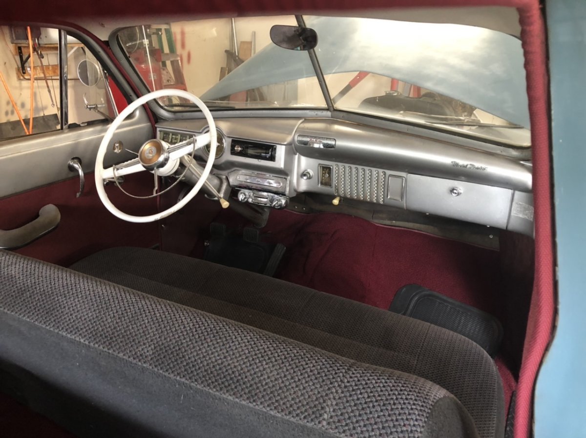

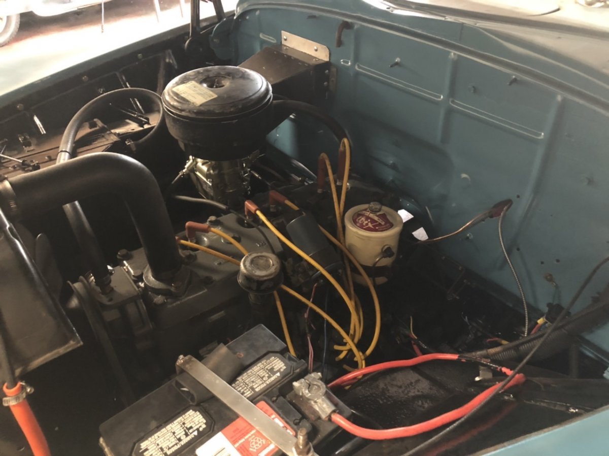

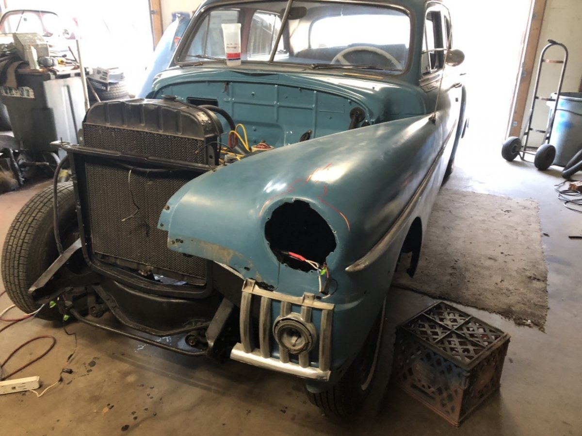

    Finished up the wiring today; much neater looking. Starting on building a mount for the seat tomorrow. CBC5CD4C-9EB6-4159-A19E-6C3B6A4F9AFC.jpeg 373377BB-5665-4489-892B-794A932186ED.jpeg

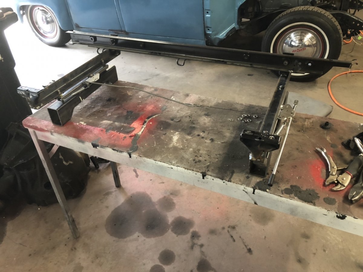

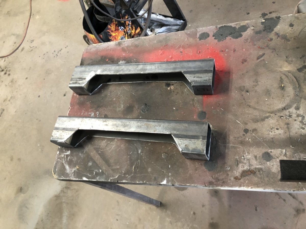

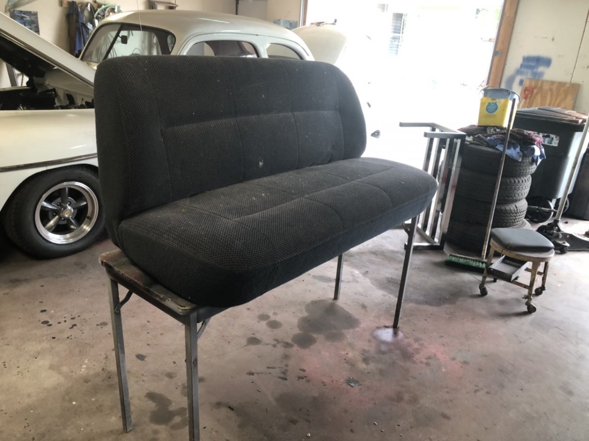

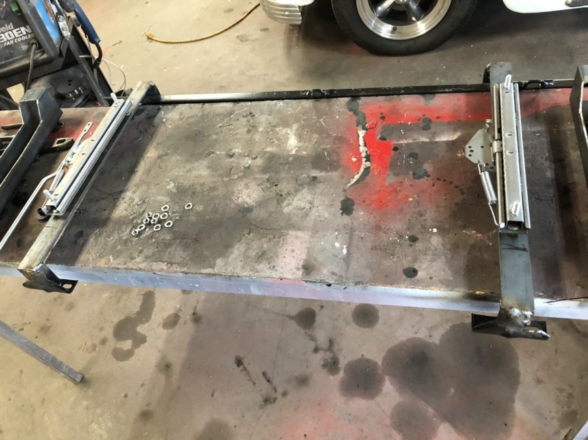

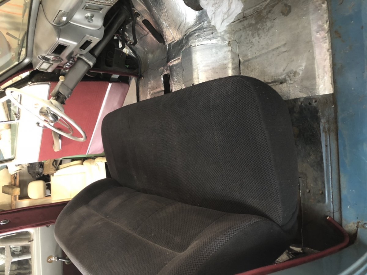

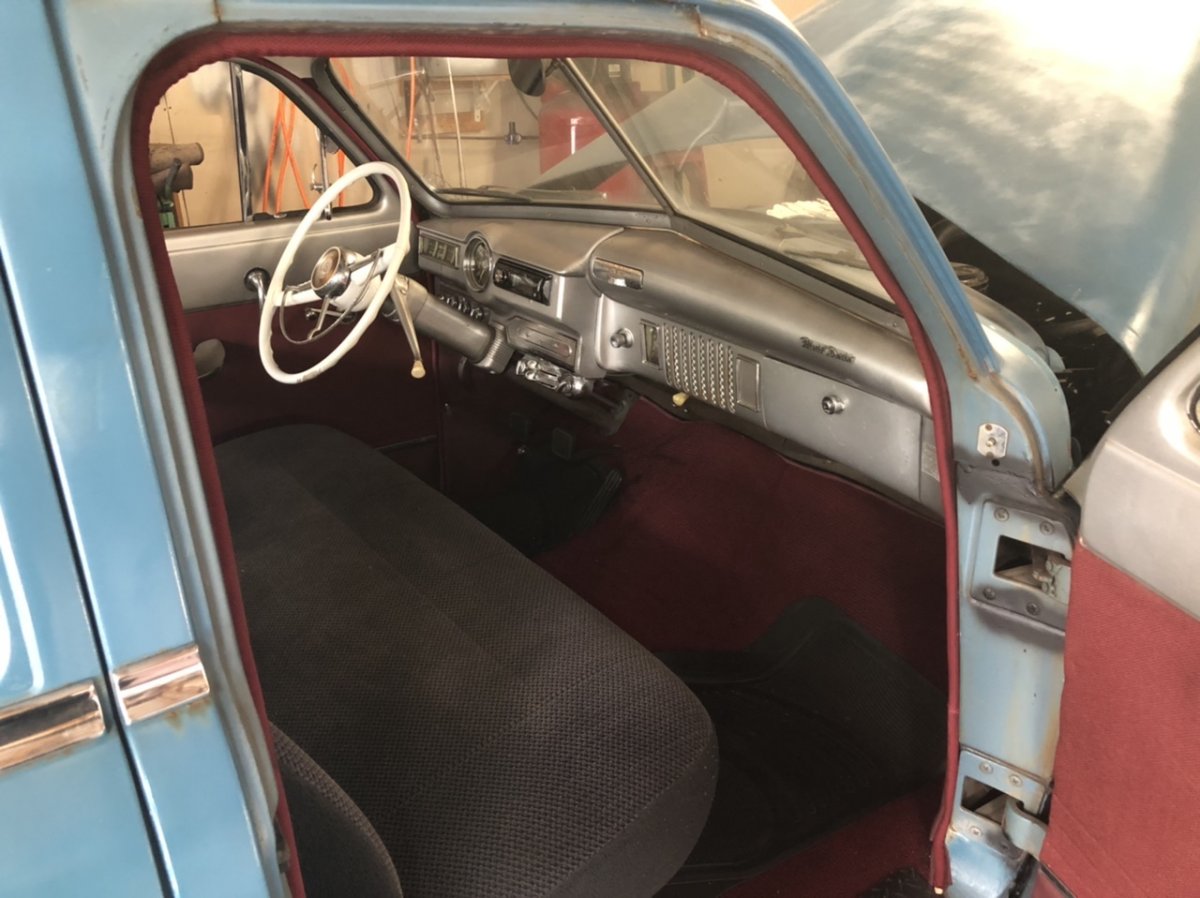

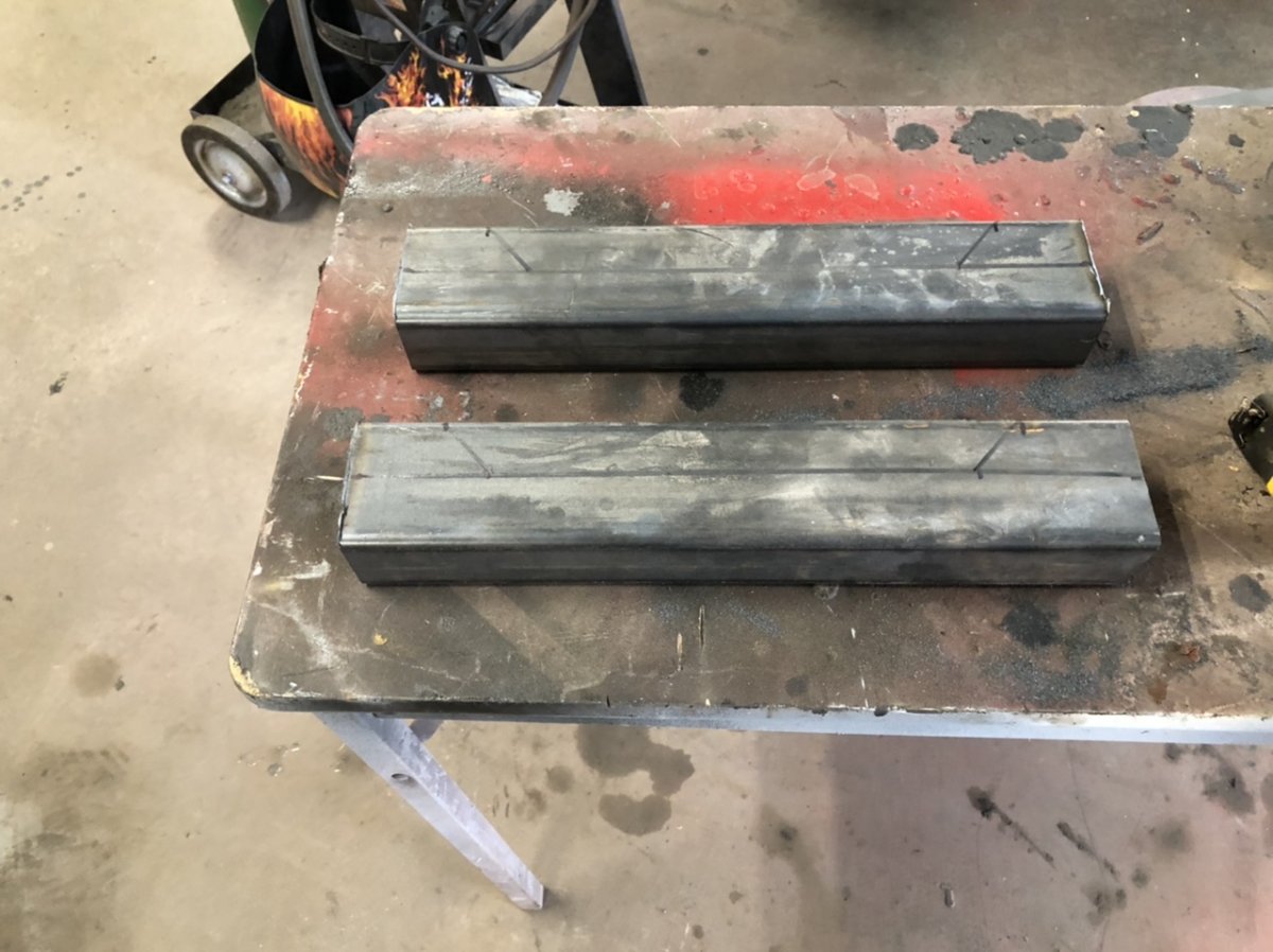

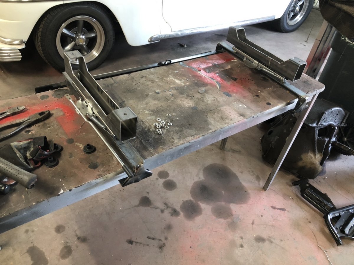

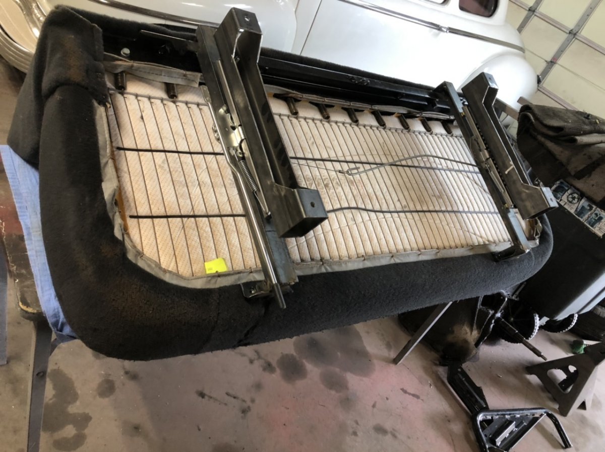

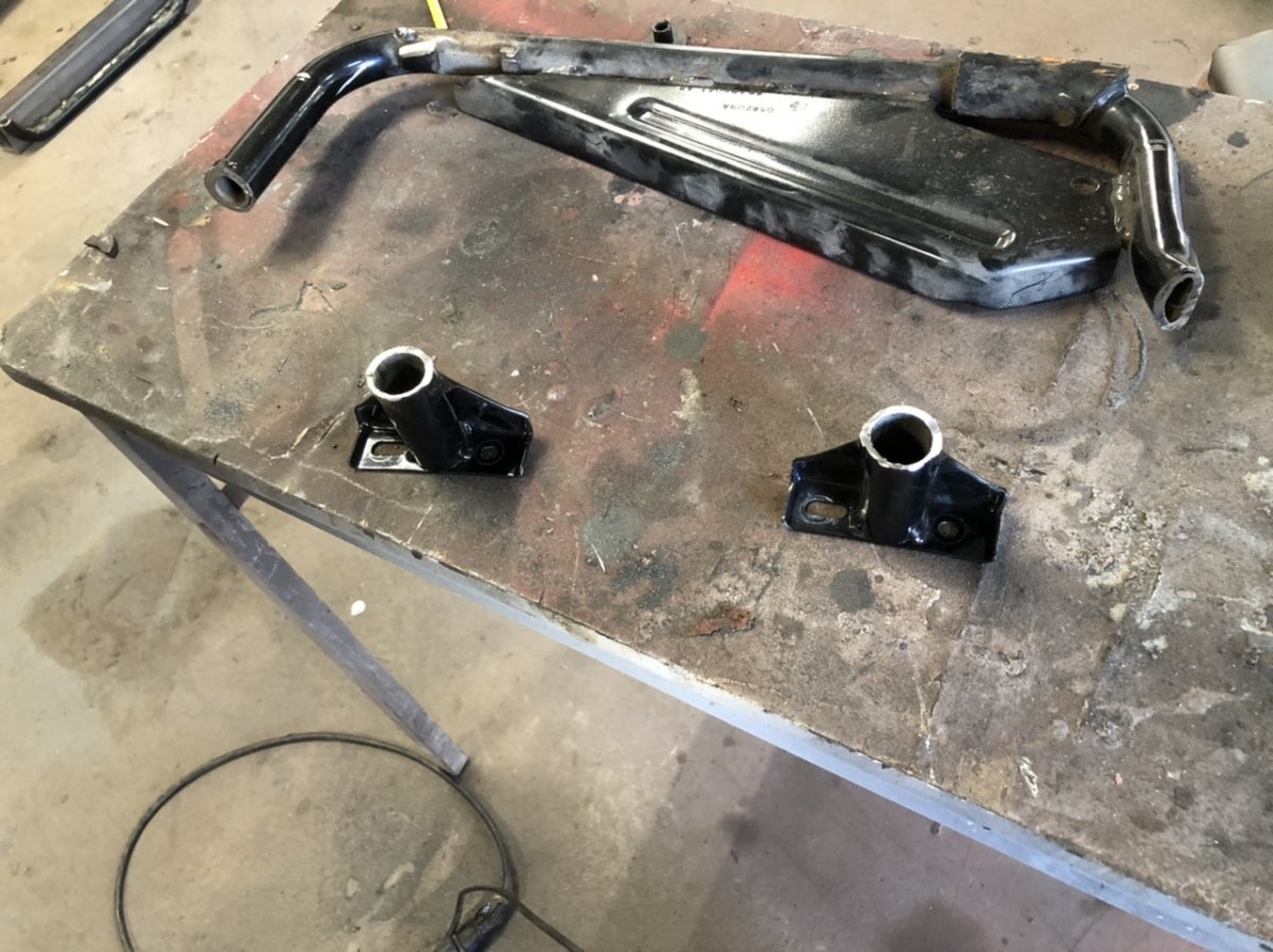

    The seat came from a late model Dodge extended van. The shape and length were right on but it had to be lowered 4” and needed sliders so you can adjust it. So I got some universal sliders from Amazon and built a mount with some angle iron and rectangle tubing . I think it came out really good. 869499DF-4934-44C8-9C8D-9B3CD590D827.jpeg 81185D40-FA51-4CAB-91DC-407C375A9494.jpeg 907DDDE8-2363-456A-907C-784600348764.jpeg C733D111-6CFC-47C6-98BF-4C338CD3A45A.jpeg B8C45F46-33BF-413B-89C5-7FA3D9507317.jpeg 37C3C05F-CA1B-47B6-BCA7-743680F9ADE8.jpeg BCF89CD3-33BF-438D-AC00-1D84263BB286.jpeg 3460D542-3DFF-43AC-AF17-59A5CDC717E1.jpeg A2E564F0-972D-4C79-89C0-F6B386353AE7.jpeg 0C48AEE6-E556-4064-B1C7-BF2399772147.jpeg

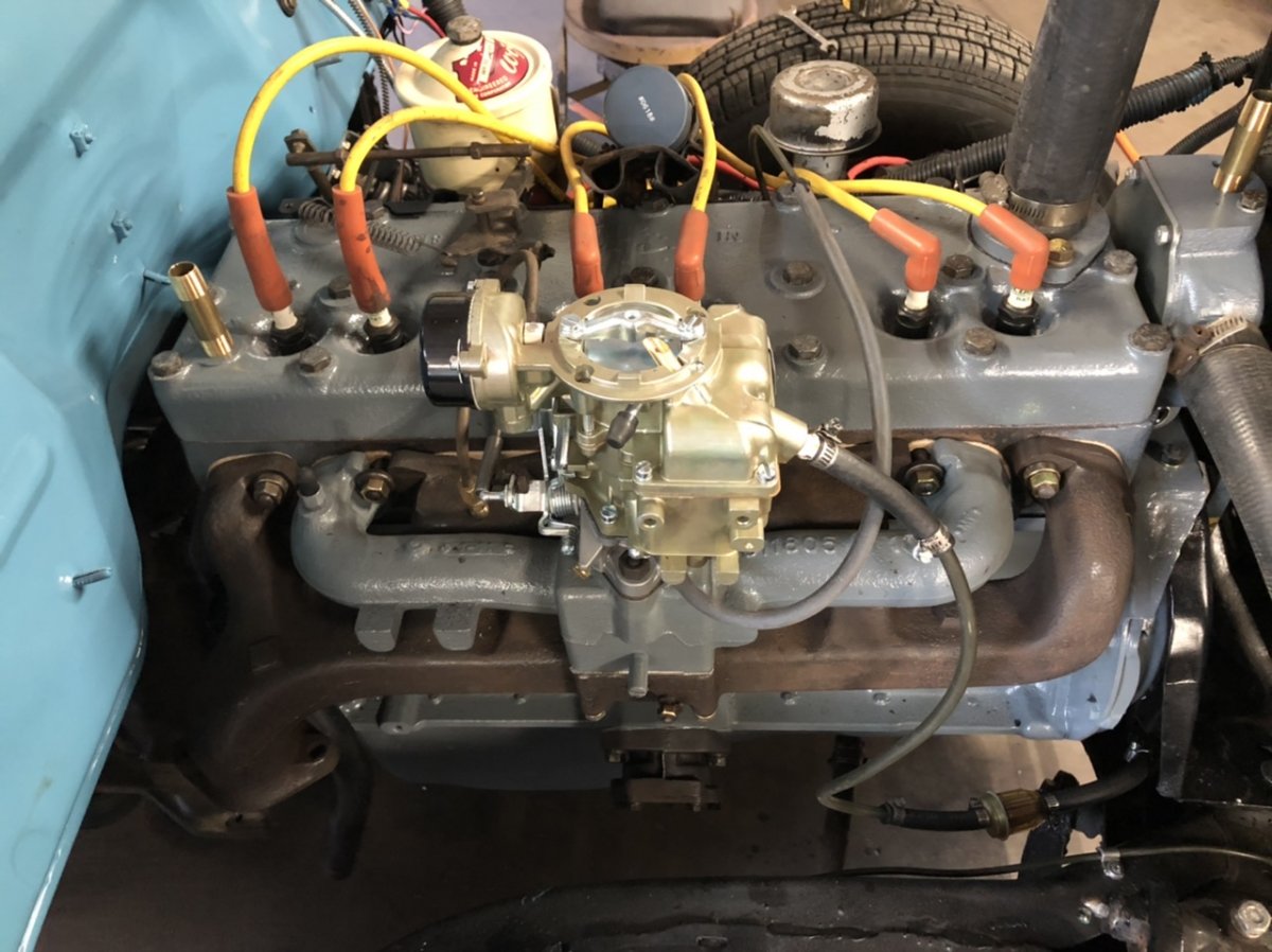

    Got my carb switched out today and it really runs great. Swap was super easy; very little modifications. C4FF1273-F98B-4586-9453-222C062573C0.jpeg 97AE3C29-1205-4367-B0A1-D98B2B66E24D.jpeg

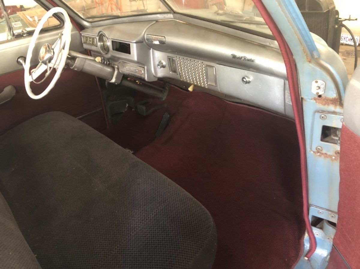

    Got a ton of stuff done the last few days. Finished some wiring bits, got the exhaust put on, got the parking brake working, got the carpet glued down and the seat in, and started cleaning up the front clip pieces to start putting the front end back together. Hopefully I’ll be wrapping it up in May. 5AB4600C-F733-4343-B408-EDDE9E201967.jpeg 86FEE9FC-6E26-4D9F-A7E0-B50EA6DEDD82.jpeg

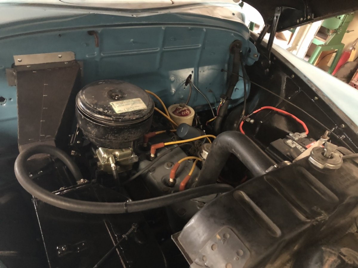

    Coming back together... A58549B3-A8CB-44A1-9204-3B31A3FBD474.jpeg CA5C975D-BCC3-40D0-88E5-608DF4532588.jpeg

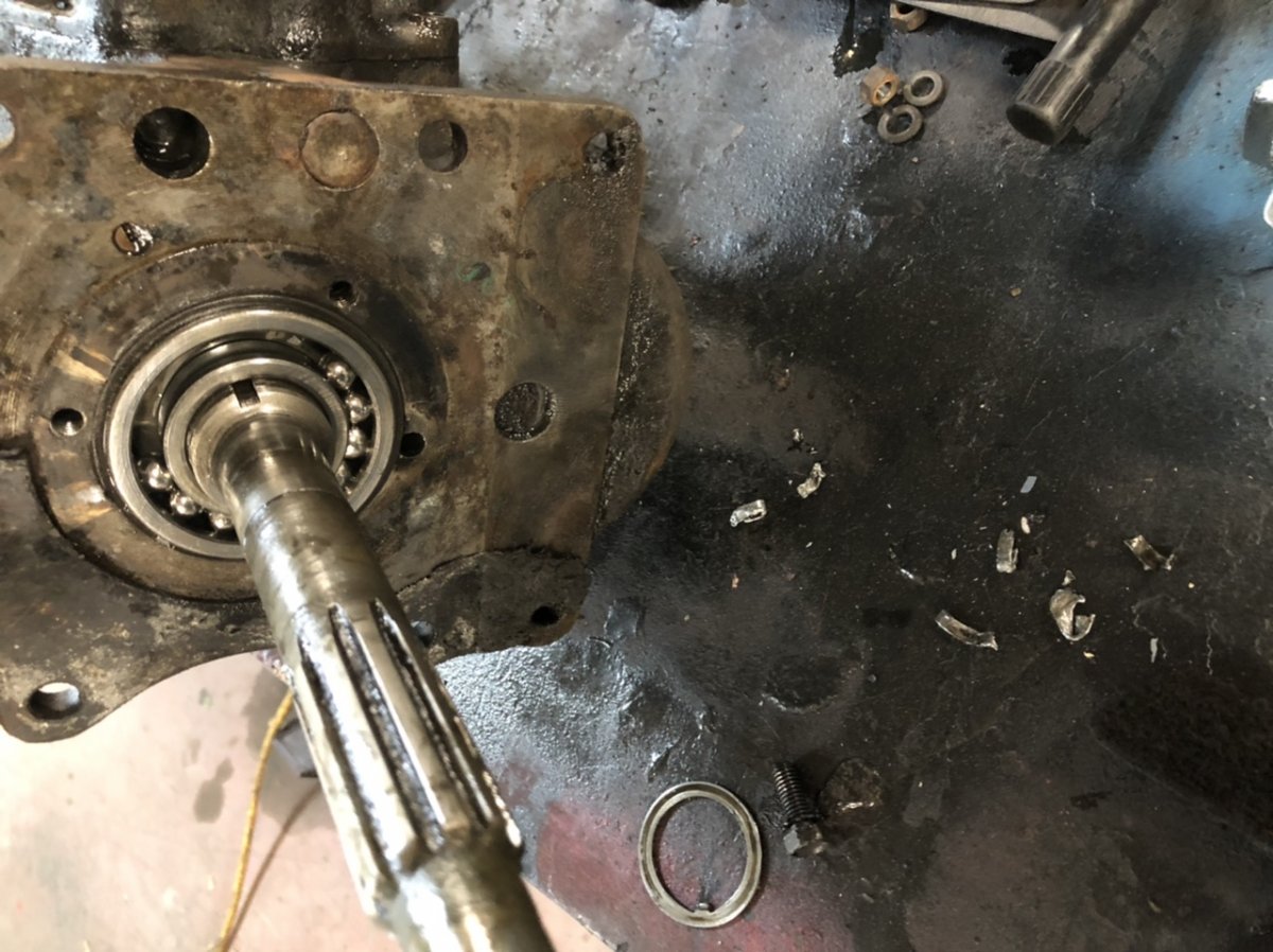

    Well, first test drive had an issue; ended up pulling the trans back out and ordering an input shaft bearing. It was howling pretty good.

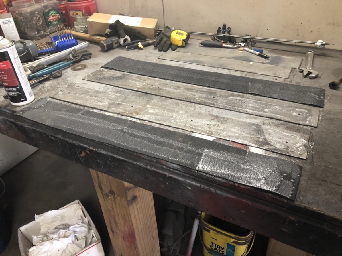

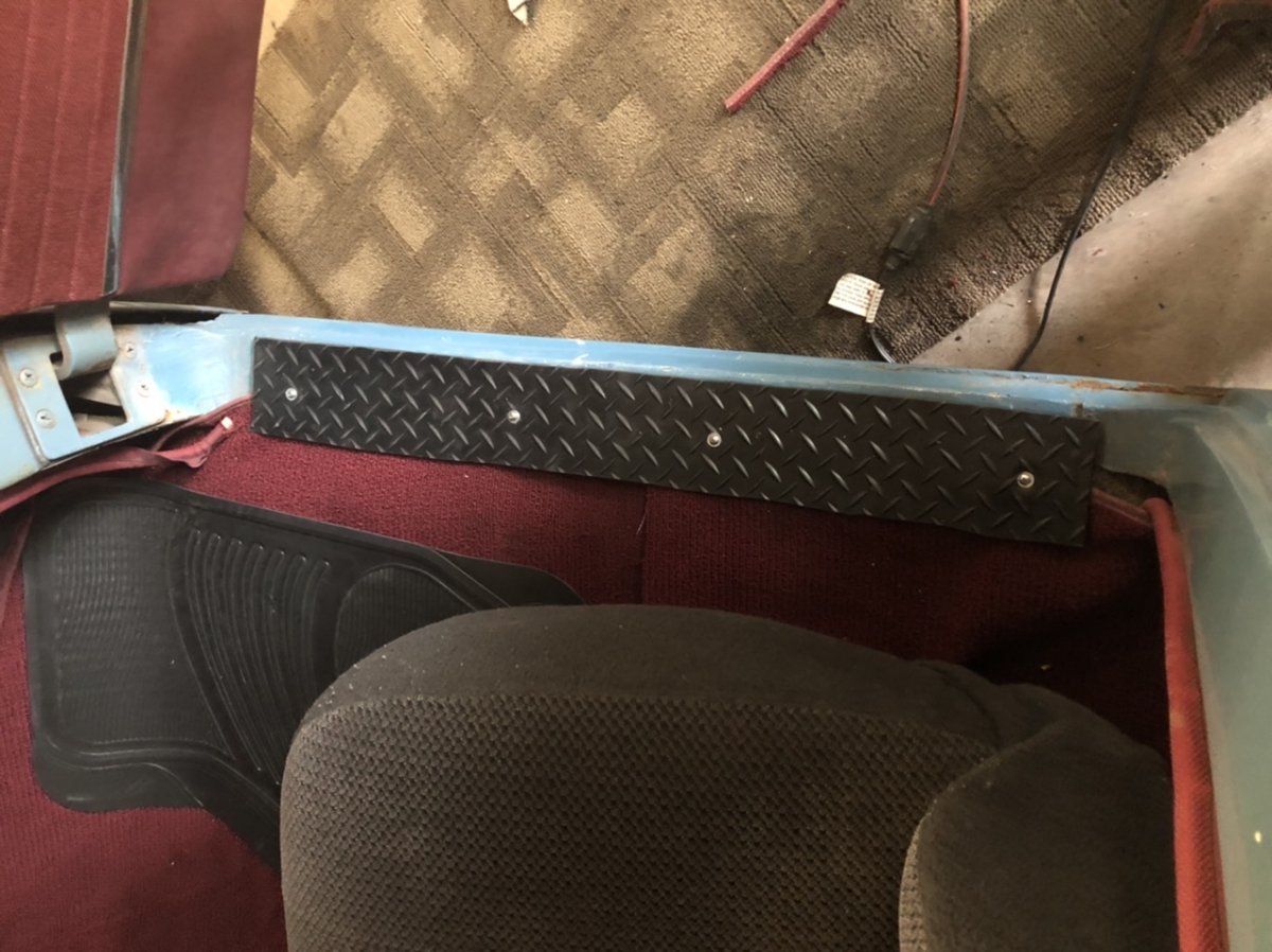

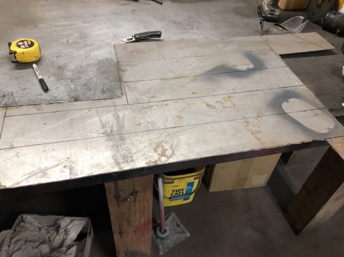

    While I’m waiting on a couple of transmission parts I decided to make some sill plates since I didn’t have any. Just used some 1/8” steel plate and some leftover rubber mat. Just cut the plate, drilled a few holes and glued the mat on with some headliner adhesive. BAE65837-B0F7-45D5-9106-8B1D6E542ABA.jpeg E4349BAF-B868-4DE3-BCCA-BFDD59D8F0CF.jpeg E9801EA4-7EC0-4F36-BF76-C1586685AD3C.jpeg F5D48663-341C-4E0C-8739-EA411A3DC707.jpeg

    I had to go by the boneyard to pick up a part for my brother’s car today and I noticed that the van I got the seat from that I used for the front was still there. I went ahead and got another one to use for the back. I’ll have to build a mount for it but it’s the perfect width and it’ll be nice to have matching seats. FE4D1819-F727-4985-8C91-157ADC4E9D1C.jpeg
