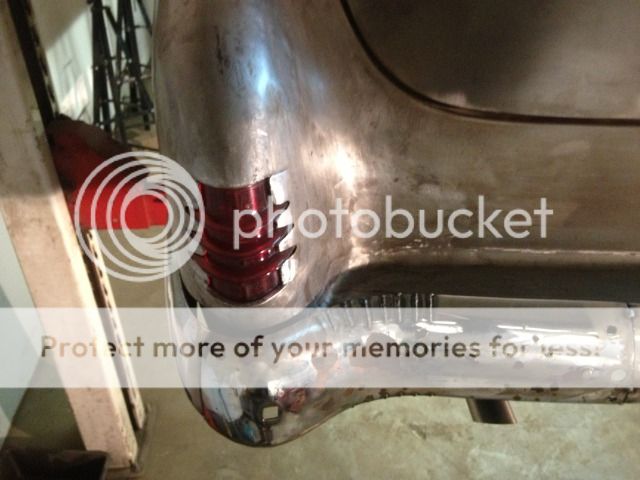

    Love the taillight treatment.Super Rad

    @ 'MO: bit late, but here some short from the trunk-side of the fender extension
    @ 1950heavymetal: Headlights
  7. Mobart
    Joined: May 25, 2008
    Posts: 81
    Mobart
    Added some detail in the taillights..

    Very nice,everything you guys did looks awesome. The Merc tail lights art deco flows with everything.
