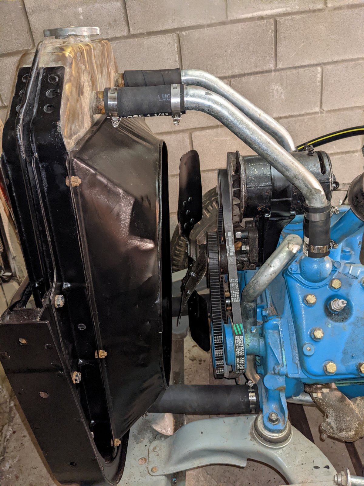

  8. AmishMike

    Starting a build and question for the HAMB: is that fan close enough to the rad shroud?

  10. MTL Tony
    Joined: Dec 15, 2021
    Posts: 169
    MTL Tony
    It's filthy.
    I just mounted it but didn't clean it at all.
    I'd be interested in hearing what others have to say. I don't think I can adjust it out because then the belt won't line up, and the actual fan looks backwards to me too....
    I've tried looking for other pics and everyone's fans are tucked in so I'm not sure what I'm doing wrong, if anything. Unless those two bolts let the fan slide out without messing with the pulley spot.
    I haven't fine tuned anything. Literally throwing it all together right now! So any comments are helpful for sure.

  11. 55 Ford Gasser
    Joined: Jul 7, 2011
    Posts: 698
    55 Ford Gasser
    I haven't fine tuned anything. Literally throwing it all together right now! So any comments are helpful for sure.[/QUOTE]
    There are 2 positions that the radiator can be mounted. One for 6 cyl engines and one for V8.
    Check on the fenders and you will see the mounting holes. Yours is probably in the 6 cyl position at the moment. When you put body and fenders on, it should sort itself out. You might have to shorten the hoses a bit, but for now it should be fine. Also check frame for the bottom mount holes.
    When putting the 302 in my '50 F1, I was told the motor was too long and wouldn't fit unless I used a serpentine system. I got to looking and saw the other mounting location for the radiator and moved it forward. Now, using the same fan shroud as you have my fan sits half in/half out of the opening. Ron
  12. MTL Tony
    Posts: 169
    MTL Tony
    Damn you're right!!!
    Thank you!!
    I was gonna pour coolant in tomorrow so I'm glad y'all pointed this out.
    I just looked through the video I made while mounting it and you can see the closer mounting holes!
    Here's a still from the video(which also shows me the bolts are too tight, so I can correct that as well and throw in some cotter pins.
