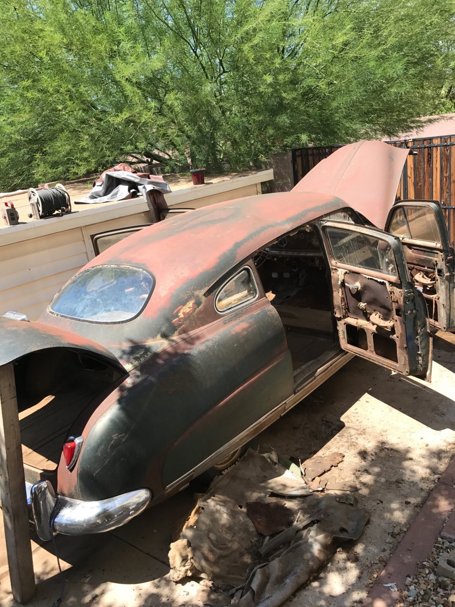

    So here we go. Got the interior gutted and semi cleaned up last weekend with the help of my youngest son. I think I'm ready to start laying out and get going on the 2 door conversion. I have been thinking about how to go about this for quite a while now, and I think I've got a pretty good plan of attack. I will post more pictures this weekend as things progress (hopefully). My over all plan for the car is to end up with a 2 door that has slightly longer doors than a factory 2 door, shaved handles, shaved exterior trim, 2" ish chop, rake the windshield back a touch, shave some of the trim items on the front, section the rear bumper (or find something a little cleaner) I am undecided on the front bumper/grill area, guess that will come in time. Like some guy on some car show I watched one time said, "I don't want to change much, but I want to change everything"

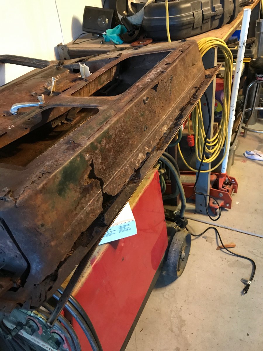

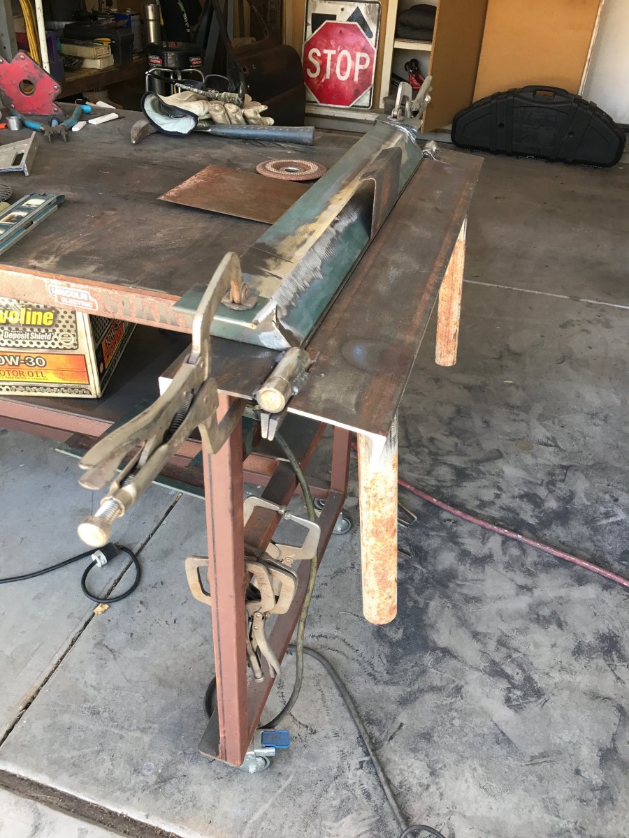

    pass side door.jpg brake.jpg I appreciate all the feed back. Work got kind of busy for a while so I didn't get as much as I would've liked done on the car. I did get the passenger front door off and on the bench to start on bottom sill rust repair. It was a little worse off than I thought, so I spent last sunday making myself a sheetmetal brake out of scrap so I can start replicating some of the parts. I truly wish I could skip the rust repair, but I'm afraid if I start on the 2 door conversion without fixing it first, its going to be next to impossible to get everything to line up correctly. I did kick the suicide door thing around for a while, but my brain sees the modified 2 door every time I look at the car, so that's what I'm going with. JeffB2, yes its the one from craigslist. And that build is definitely part of what sparked some of my ideas. Ian Roussel is an amazing artist. KustomKreeps, I don't know how much I want to get into the drive train on here, as its not really going to be the traditional route... Got a 3 day weekend coming up, I'm hoping to get the rust repair on the doors out of the way and get the door handle, lock holes, and trim holes closed up. I guess we'll see how good that first beer is...

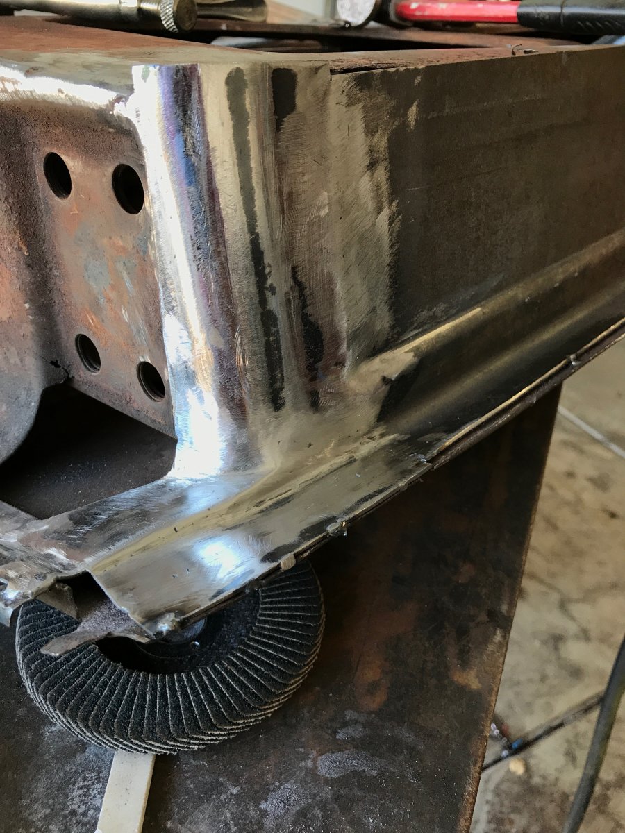

    Re-creating these parts with nothing but hand tools has proven more challenging than I anticipated. All the new structure is 16 ga instead of 20 ga. That translates to a shit load of hammering. The first door came out good, but it took all weekend to make all the pieces, get it welded in and cleaned up and fix a few stress cracks in various parts of the door . Time to buy more/better tools... Need to get some 20 ga sheet this week so I can replace the bottom section of the door skin. I was really surprised to see how thin this steel is. I was definitely expecting heavier stuff to work with. I think now that I've got the first one out of the way, and the most of the parts made already, the dr side should go a little quicker. Before anyone beats me too it, the section left out of the bottom at the back of the door is intentional. The whole back end of the inner door structure is going to get cut and moved back when I stretch the door. One less cut to make later.

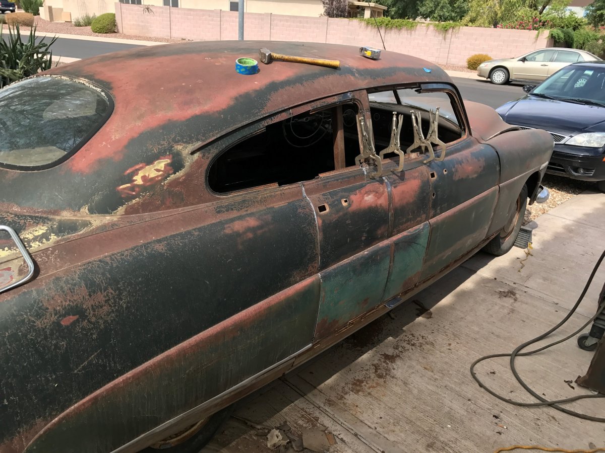

    Free time has not been very abundant here lately. These are from a few weeks ago when I actually got a sunday to get down on the car. Two door conversion is coming along, slowly. Making the fill in pieces for the stretched window frames has been quite a tedious process. I've been thinking about building a power hammer to make them right. What is done looks ok, and I'm sure with a little filler it will be fine, but looking at it and knowing its not quite right is driving me nuts. Had some house issues come up, and with the holidays and an upcoming hunting trip I don't see much more getting done before the end of the year.

  22. KustomKreeps
    Joined: Jan 7, 2016
    Posts: 324
    KustomKreeps
    dude thats starting to look cool.
    And for me personally I like the lines you are getting better than a stock coup. the larger rear window you have made by compining the the rear doors window to the rear vent window looks better than stock coup whilst making the whole roof line look lower more chopped and meaner.
    few more pics man.
    if you could draw the rear of the vent window out a bit more - elongating the opening two or three inches and making it more pointed than the rounded it currently is would be cool. kinda going with the flow of the drip rail. Make it look even more stream lined, chopped.
