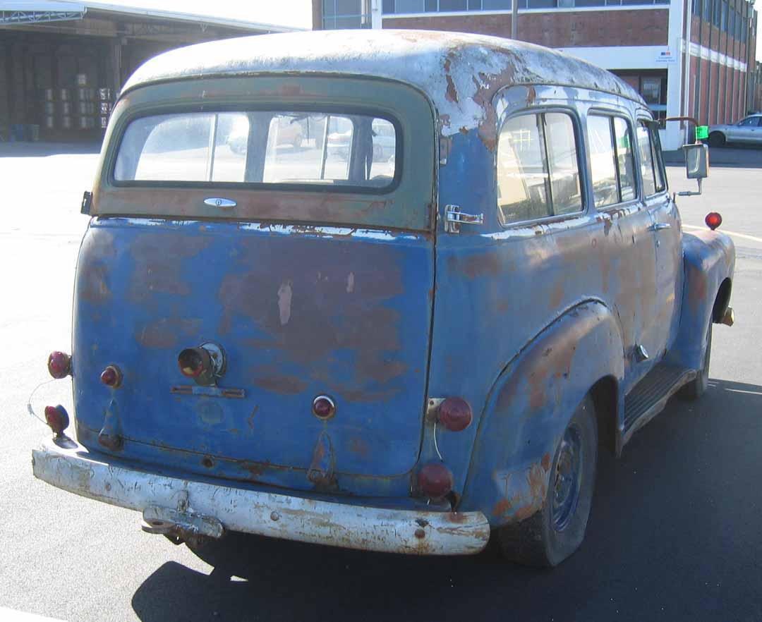

    anybody install windows of some sort into a AD panel delivery(or any panel for that matter)? I am considering buying a 51' chevy panel but would like to have some side windows for the kiddies!finding a burb up here is like finding a three dollar bill(or coin:D) so thats out of the question. i know anything is possible but i would like something that looks like it belongs there.pics or how to's would be fantastic!

    To make it look more original, you're going to need to recess the windows, not just put them on the side flush with the panel. I don't know of any easy way to do it, aside from finding a donor burb to get some pieces from. Maybe if you could find several bad truck doors, and cut pieces from them to form the window frames?
  3. I've done a lot of vans but they don't look factory
