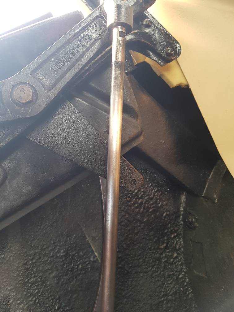

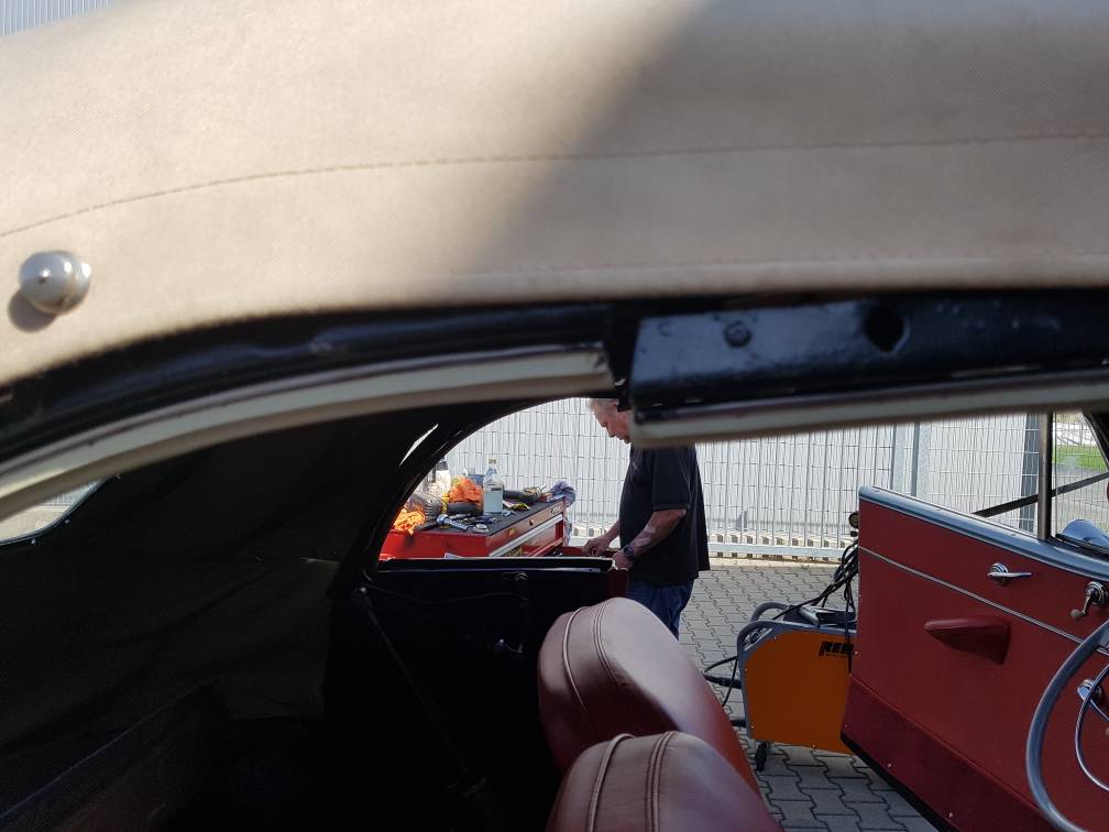

    We're trying to cure this sag problem on our Biff convertible.
    We've noticed this lever in the second photo with a hole in it. Should there be a spring somewhere here? 20180808_155840.jpeg 20180808_155856.jpeg

  5. My 41 convertible had springs that attached to the top mechanism and went strait back into the trunk area and attached to (if I remember) the brace from the quarter down to the inner wheel well. It would help the top go back up, being spring loaded. Just like a hood hinge or trunk lid hinge spring. 41's are a little different then 42-48...mainly being 41 had an electric motor top and 42-48 are hydraulic. So your mileage may vary

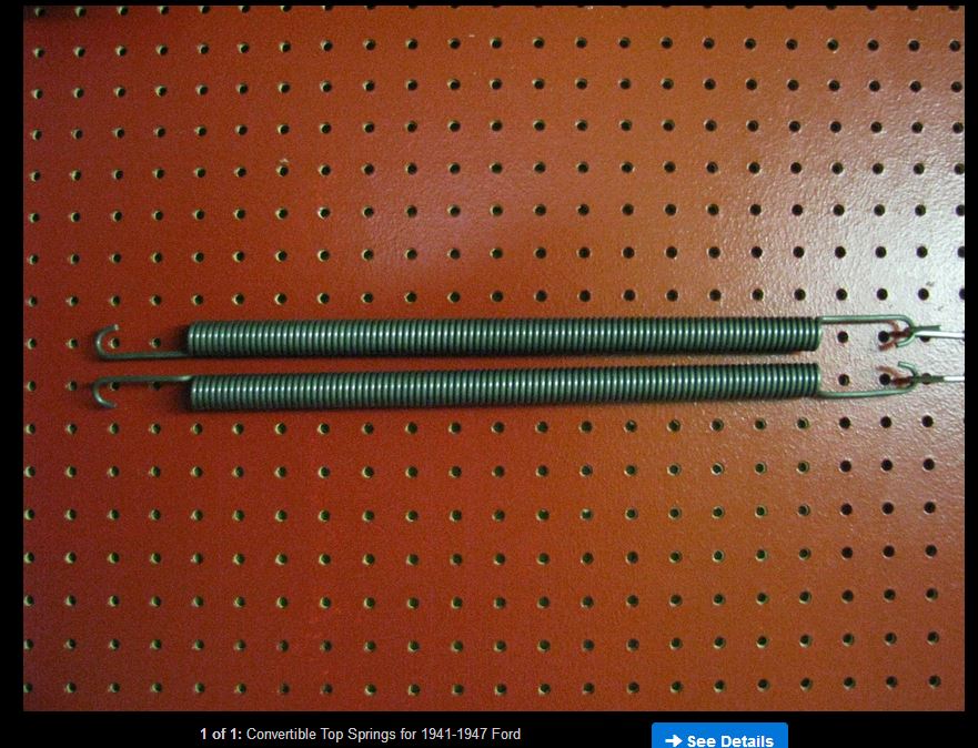

    Anybody got a picture of the spring on a 42-48 convertible?
