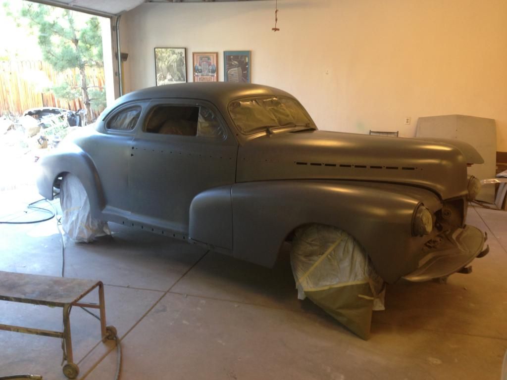

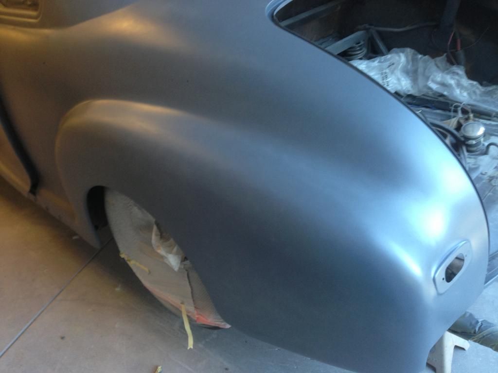

    Welding the fenders to the body and fixing rust…
    Then I took the car apart for bodywork and paint………. :D

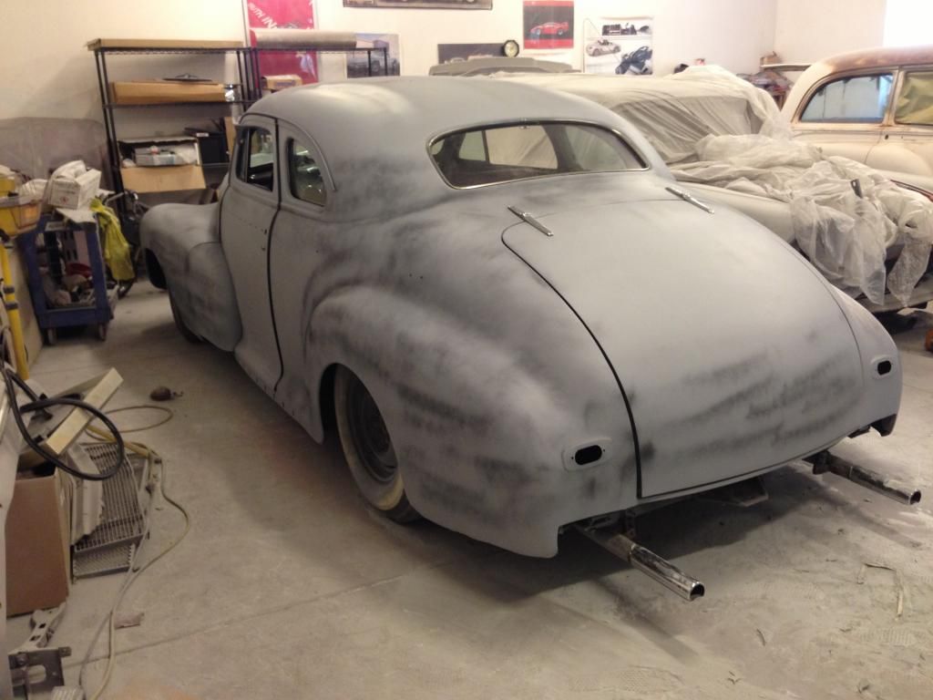

    More pictures of bodywork....

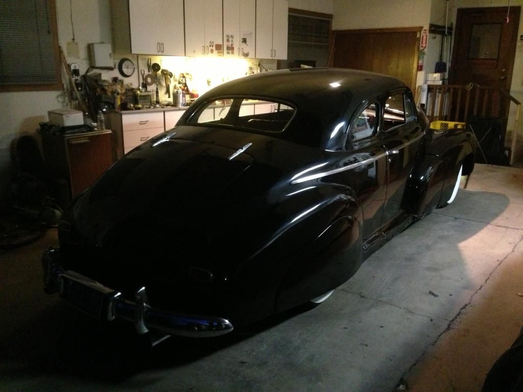

    And this brings us up to where I stand right now.
    Next I will try to do the upholstery myself, it will be an oxblood with large pleats and ivory piping.
    Then I will continue driving this thing daily, rain or shine, any distance.
    We'll call this one the "Acquafondata Chevrolet" ;)

    It is DuPont single stage black. 6 coats. The first two coats were sprayed on normally and the last 4 were mixed half and half with clearcoat for a really deep shine.
