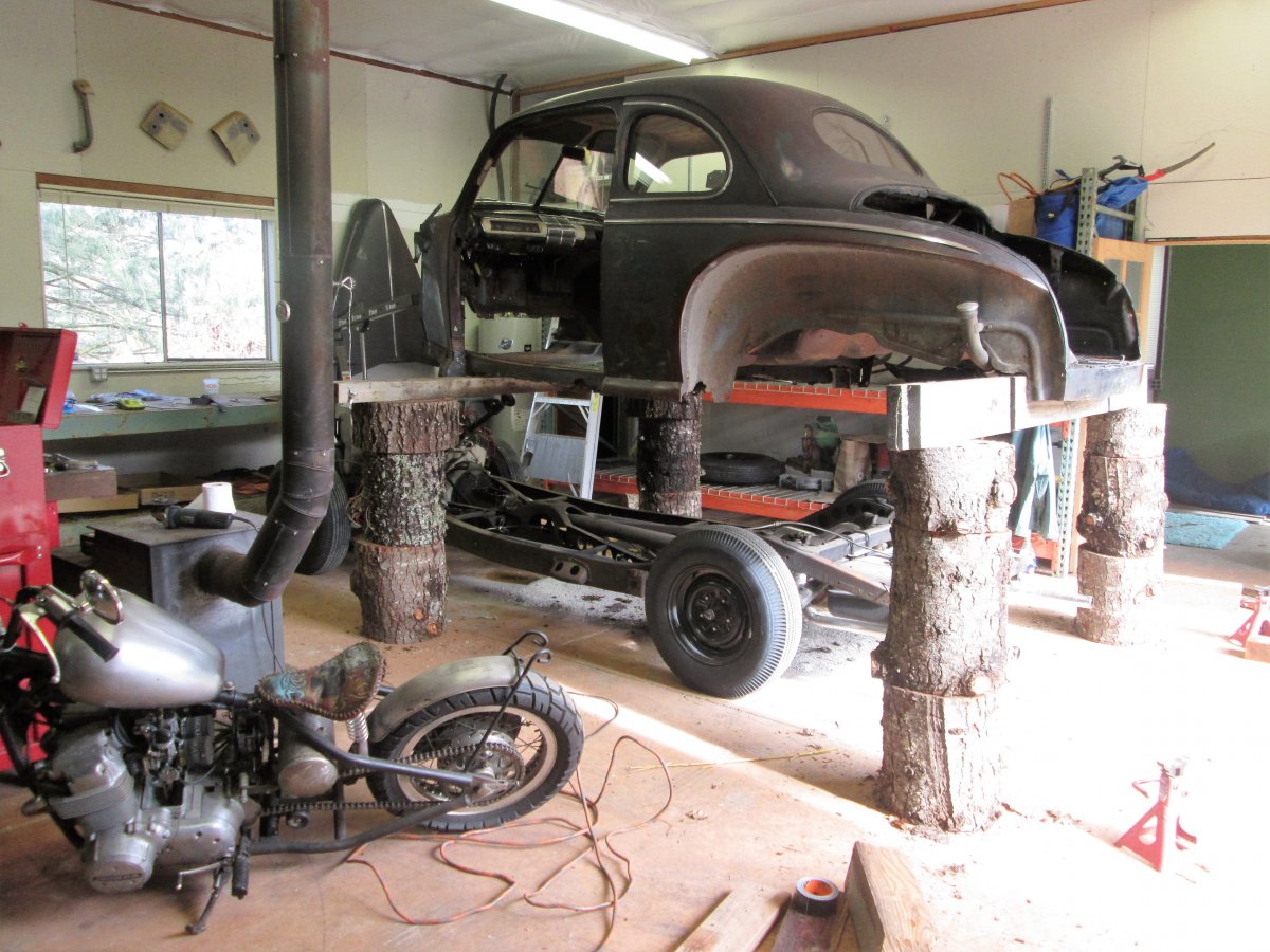

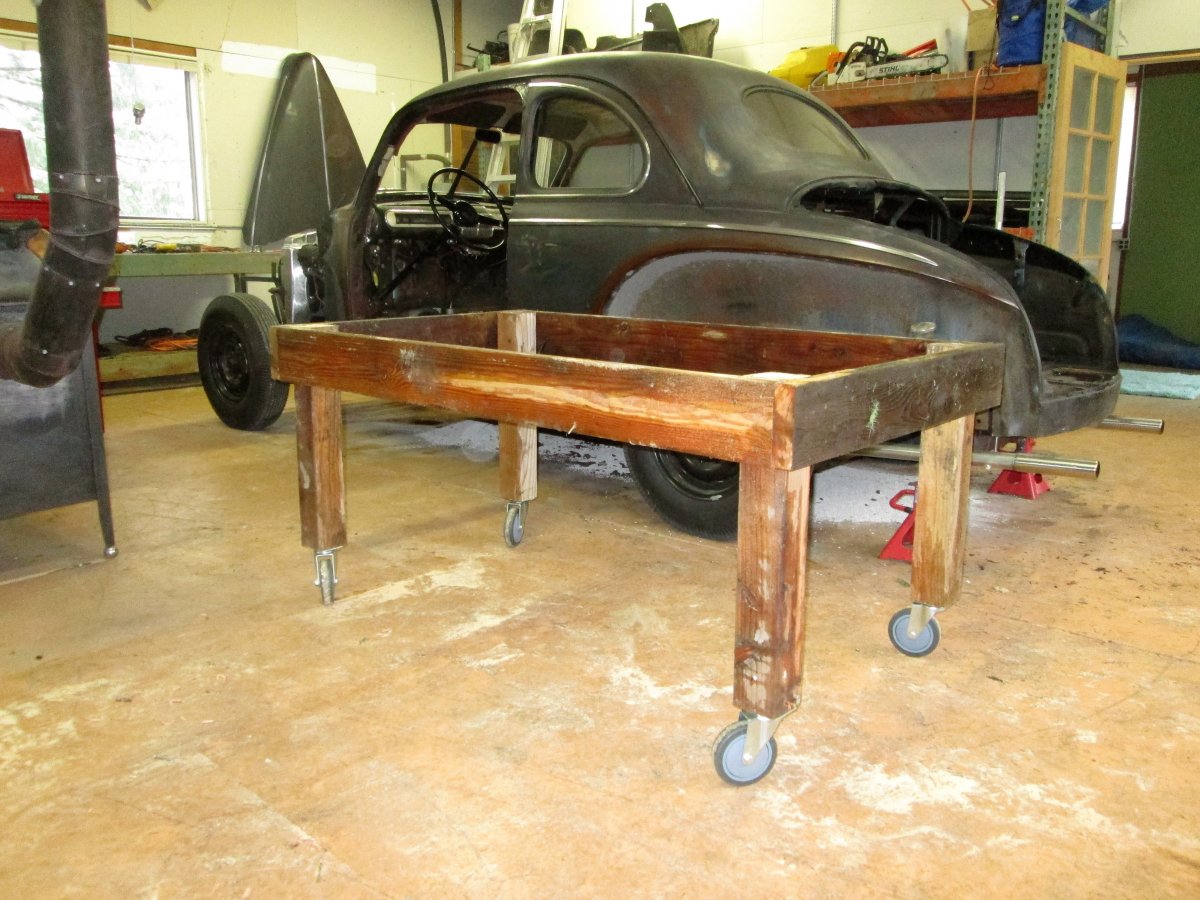

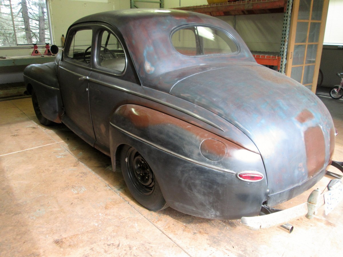

    IMG_1123.JPG IMG_1124.JPG IMG_1121.JPG IMG_1119.JPG Finish with the lift tmrw. Then put it on the body table I made. I did put a top and bolts and 2x4's along the bottom of the table.
    And I added a picture of last weeks 3rd load of logs. Didnt catch the first.
    Will pick up some 1/8"x1" boxed tubing that a guy has for sale. $250 for 45 pieces of 8' long. Good deal right? I think so. That will brace the car so i can cut.

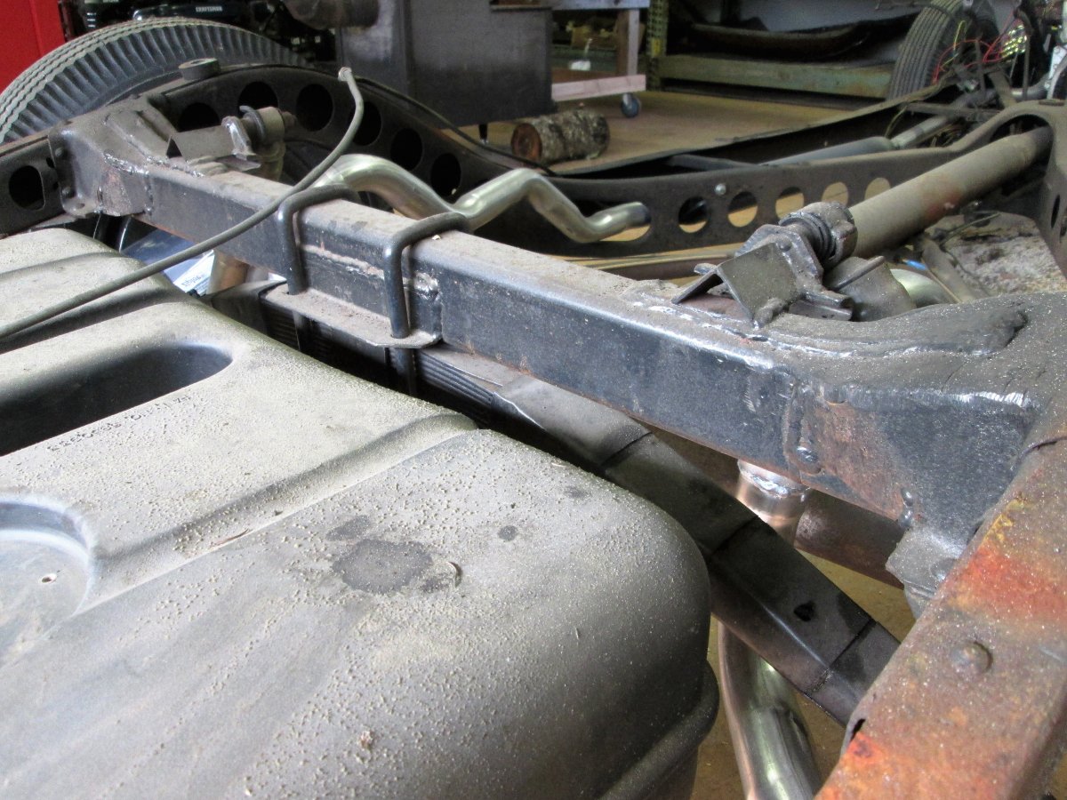

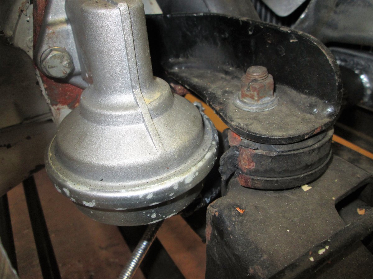

    Ready.
    Wondering if anyone can date the rear crossmember work. Should i keep it? :)
    And what's a better way to do the front r engine rubber mount so it wont be cut in half?
    Guess it wont matter if i swap engines. IMG_1125.JPG IMG_1126.JPG IMG_1127.JPG IMG_1128.JPG IMG_1131.JPG IMG_1133.JPG IMG_1132.JPG

    Cant date the rear crossmember, but I can tell you that is definitely not a 41 Merc crossmember. It appears that most of the original crossmember was hacked out and square stock welded into the portion that mounts to the frame. I'd revisit that crossmember and shock mounts if it was mine.]

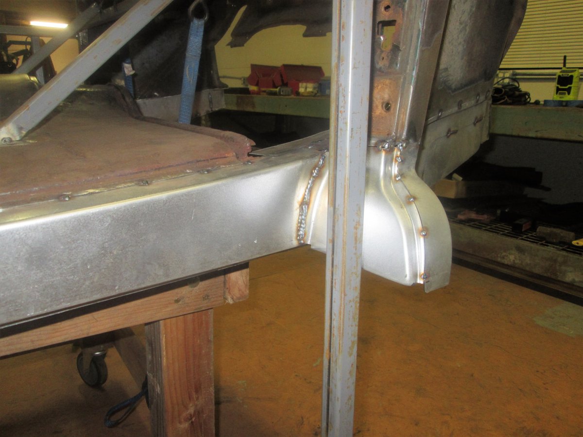

    Left side rocker is in.
    Had to do the wifes kitchen remodel and build the kids a play structure and mow the lawn BUT i'm back on the car! FINALLY. IMG_1165.JPG IMG_1167.JPG

    Right rocker is in. Moving right along now. Working at night after the kids go to sleep. Nice and quiet in the shop.
    Next are the rear lower body IMG_1175.JPG IMG_1176.JPG IMG_1177.JPG IMG_1178.JPG sections infront of the rear tires unless buttoning up the inside rear of the floor corners is better to do first.

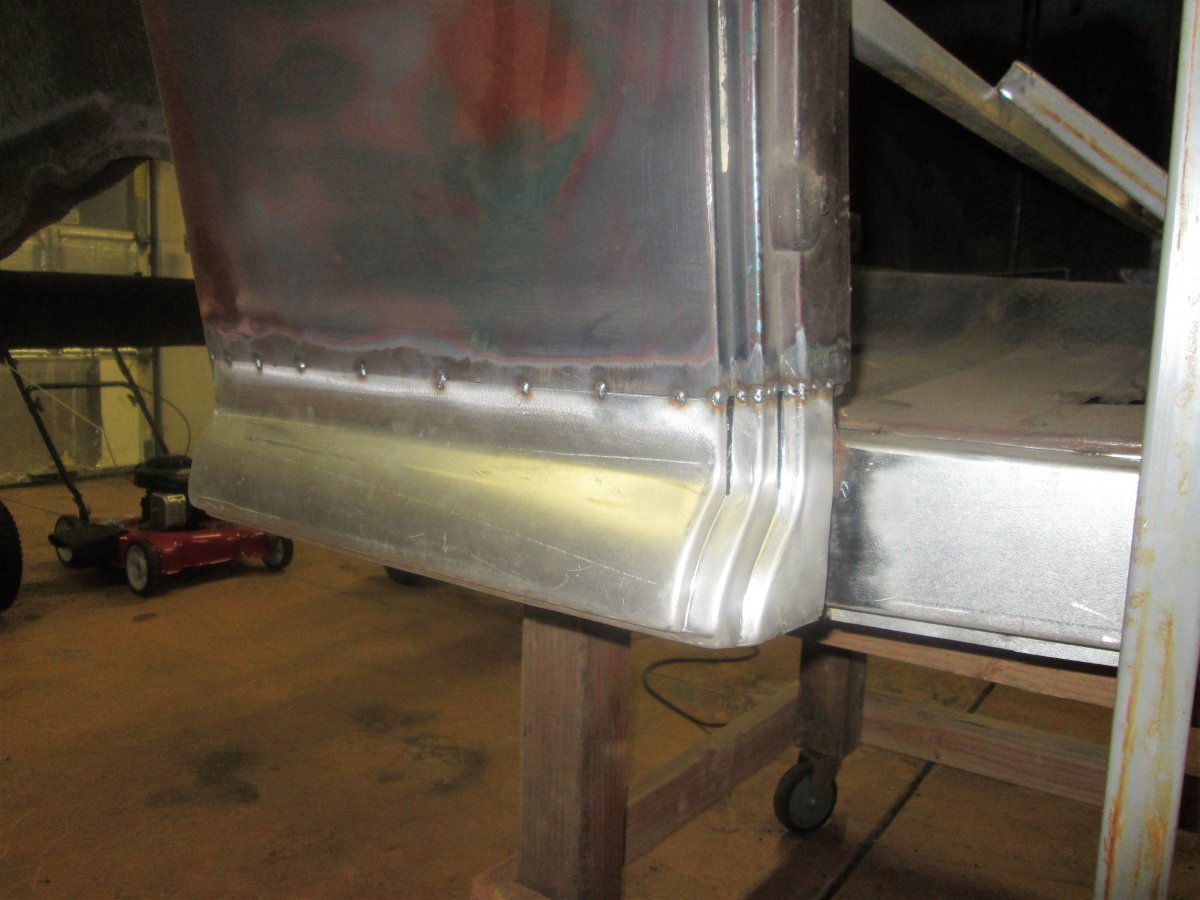

    Got the rear body lower sections on. Had to make them line up. Left was easier than right.
    IMG_1179.JPG IMG_1184.JPG IMG_1187.JPG IMG_1183.JPG IMG_1180.JPG IMG_1185.JPG IMG_1186.JPG

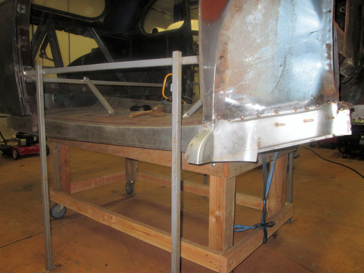

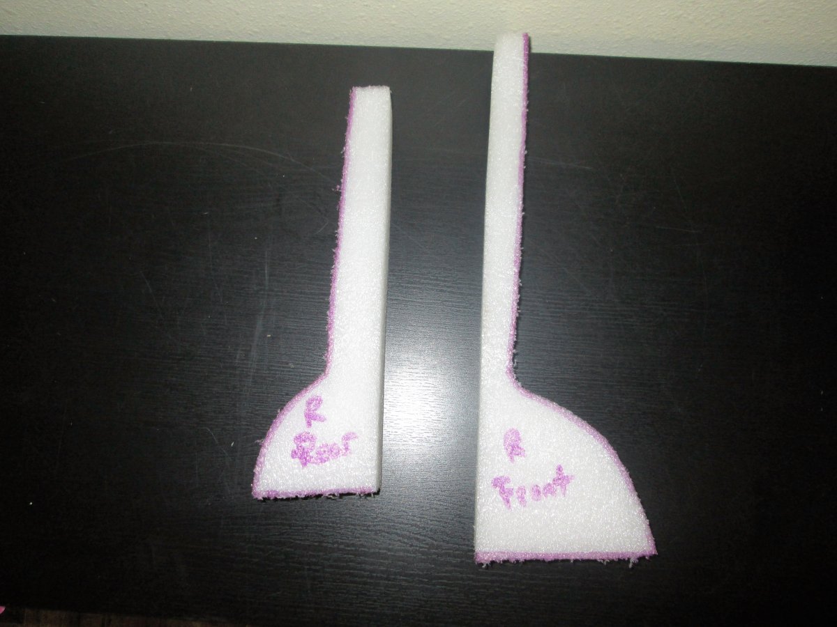

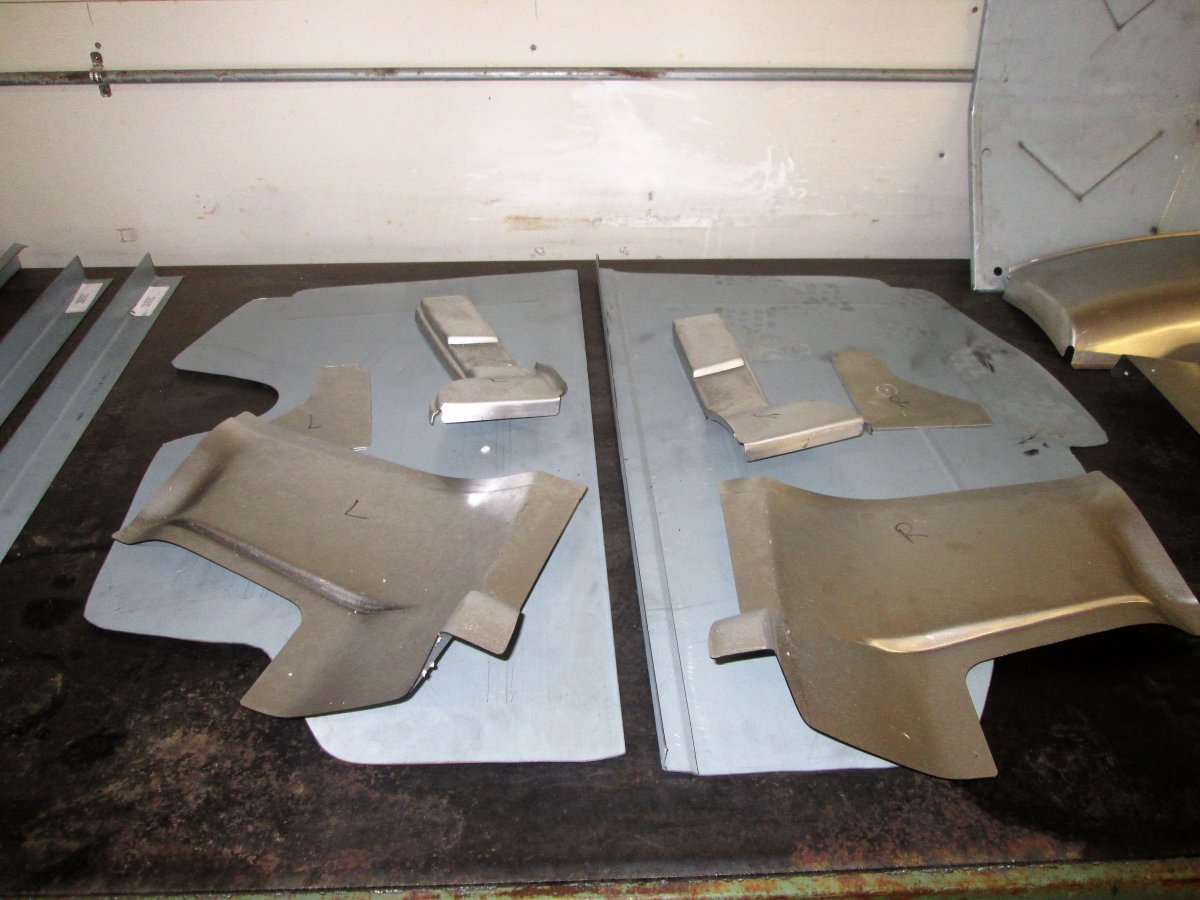

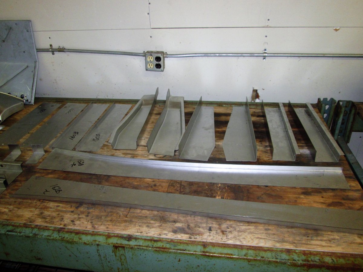

    Car is floating now so i can do the rest of the rust repair and sand blast it underneath.
    Front floor pan is next. Have to cleanup inside the red paint. The edge is were the pan sits.I flattened out the rolled edge of the front pan so it can be flush with the front floor. More cutting. I decided to weld it in and make a hole for the trans shifter. End up having a leather boot cover.

    Have you test fitted your doors lately? Bodies move around a lot when they aren't bolted down solid, and the door opening can change shape. Hate to see you make it all solid again with triangulated door openings.

    I know (alchemy)! Have been checking measurements ALOT as the pieces go on. The left side wanted to open up before i braced the door opening.
    Not going to finish weld the pieces until doors go back on. But the door opening is correct. I am more worried about the curves at the bottom being perfect. So i am making a template i can check on that and the door edges.
  24. Black Clover Custom
    Joined: Dec 20, 2014
    Posts: 501
    Black Clover Custom
    So i re-checked door measurements and door opening measurement and its all good. Just over 43 1/2 at the bottom. All looks to be correct.
    And i made some molds to check the lower contour. Fronts are good and rear was a bit off until i looked close at the door bottom and found that the bottom lip was actually bent in. From normal use i guess. Its now correct to the body.
    Alchemy from Iowa made me think twice so i had to check it all again :)

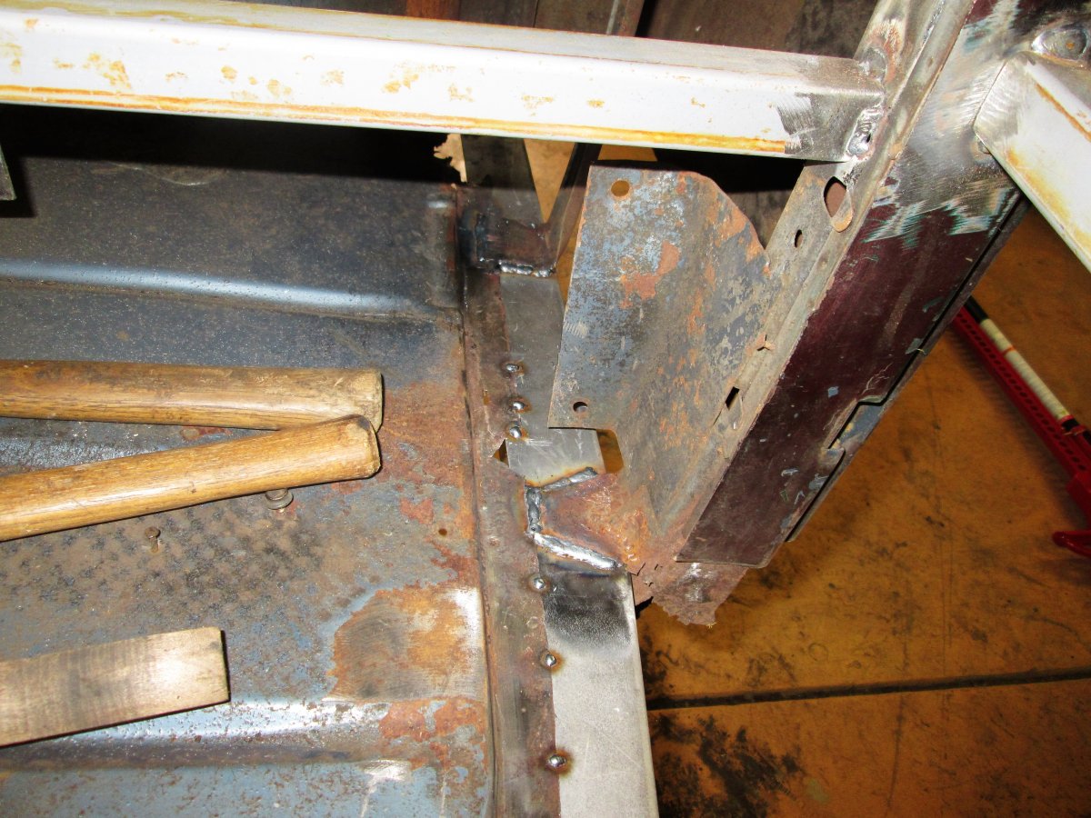

    So I was able to get the front floor section fitted and tacked in. Needs the edges filled and rolled a bit. Also put the rear inner fender/body patches on. Made those.
    Waiting for the original trunk floor i bought from the guy on here that is selling 41-48 floors and other pieces off of a couple of cars. Looked really solid and rust free. He said greyhound will ship it for 100. Dont really know if i trust that but we will see. Kind of excited to use that instead of the pieces that i bought from EMS. Not enough steel in the EMS kit. Especially on the sides and up the vertical part. Would be like putting a band aid on an amputated arm. My car needs more.
