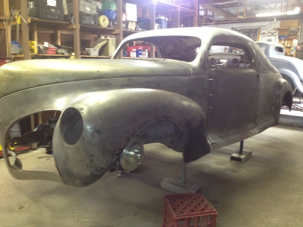

    Running v12 auto transmission
    Hogan heads triple manifold to go on
    Air bagged
    Bench seat column shift.

    post some more pics if you have some..How much did you cut the roof? a couple of inches?

    Off the front pillar was about 3-4 inches. The rest was done a bit at a time to get a nice flow. The rear window is in the same place. I've got an original untouched coupe here as well. ImageUploadedByH.A.M.B.1375300731.229545.jpg ImageUploadedByH.A.M.B.1375300748.486954.jpg ImageUploadedByH.A.M.B.1375300827.038121.jpg

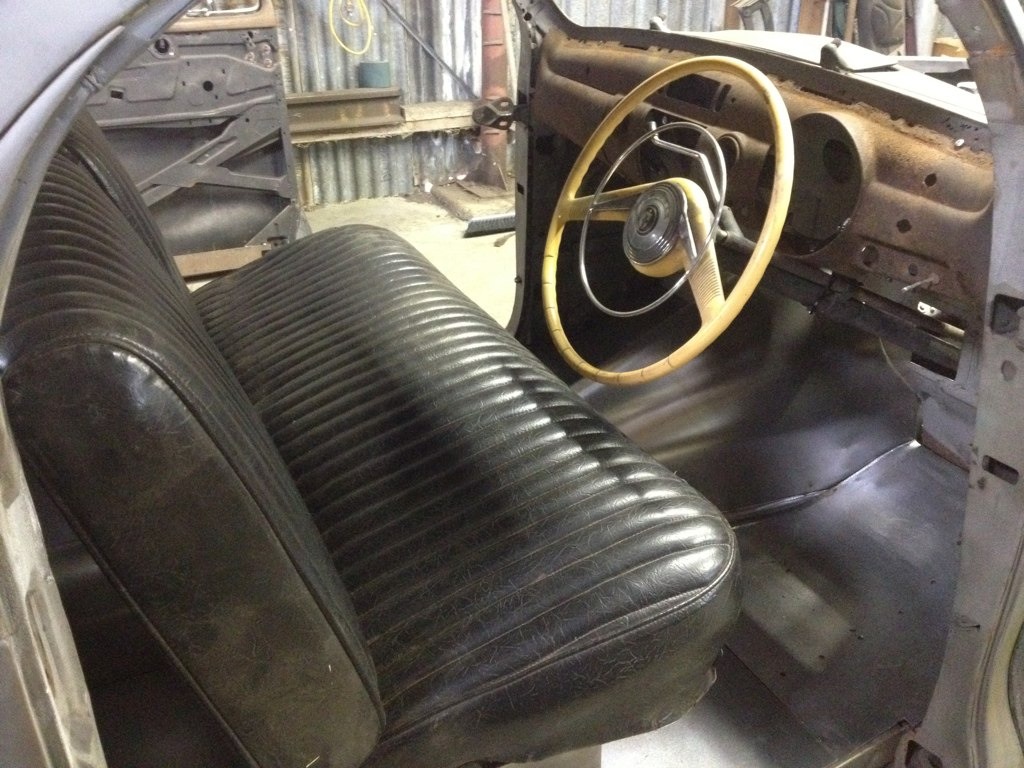

  11. Mate this is awesome! Will it finish with a traditional (Barris/Westergard) look or modern? Love the bench seat/column shift option. This car is a testament to why I can't look at modern "blob cars" it's just not necessary and how can anyone get excited?
  12. straya
    Joined: Jul 30, 2013
    Posts: 43
    straya
    Thanks for the replys. It'll be finished off traditionally. I'm working on the 1/4 vent windows at the moment . The car Was rusted out pretty bad when I got it. I'm building it for a client so it's his and my design.all new steel crossmembers and rear chassis . Will be a driver tho! ImageUploadedByH.A.M.B.1375313282.840707.jpg

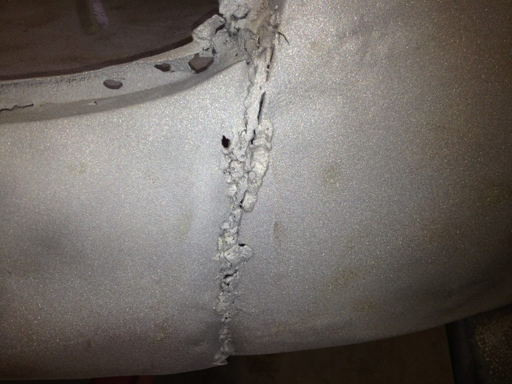

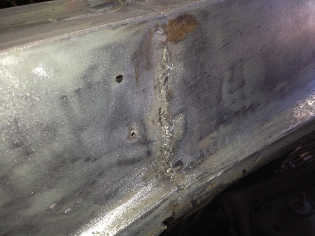

  22. straya
    Posts: 43
    straya
    ImageUploadedByH.A.M.B.1375374833.965725.jpg ImageUploadedByH.A.M.B.1375374855.574847.jpg ImageUploadedByH.A.M.B.1375374873.026565.jpg ImageUploadedByH.A.M.B.1375374914.117247.jpg ImageUploadedByH.A.M.B.1375374965.092519.jpg ImageUploadedByH.A.M.B.1375374993.510139.jpg ImageUploadedByH.A.M.B.1375375017.166546.jpg ImageUploadedByH.A.M.B.1375375041.282011.jpg ImageUploadedByH.A.M.B.1375375069.447278.jpg ImageUploadedByH.A.M.B.1375375105.059719.jpg ImageUploadedByH.A.M.B.1375375135.193711.jpg ImageUploadedByH.A.M.B.1375375155.148641.jpg ImageUploadedByH.A.M.B.1375375185.133389.jpg ImageUploadedByH.A.M.B.1375375204.381710.jpg ImageUploadedByH.A.M.B.1375375236.106671.jpg

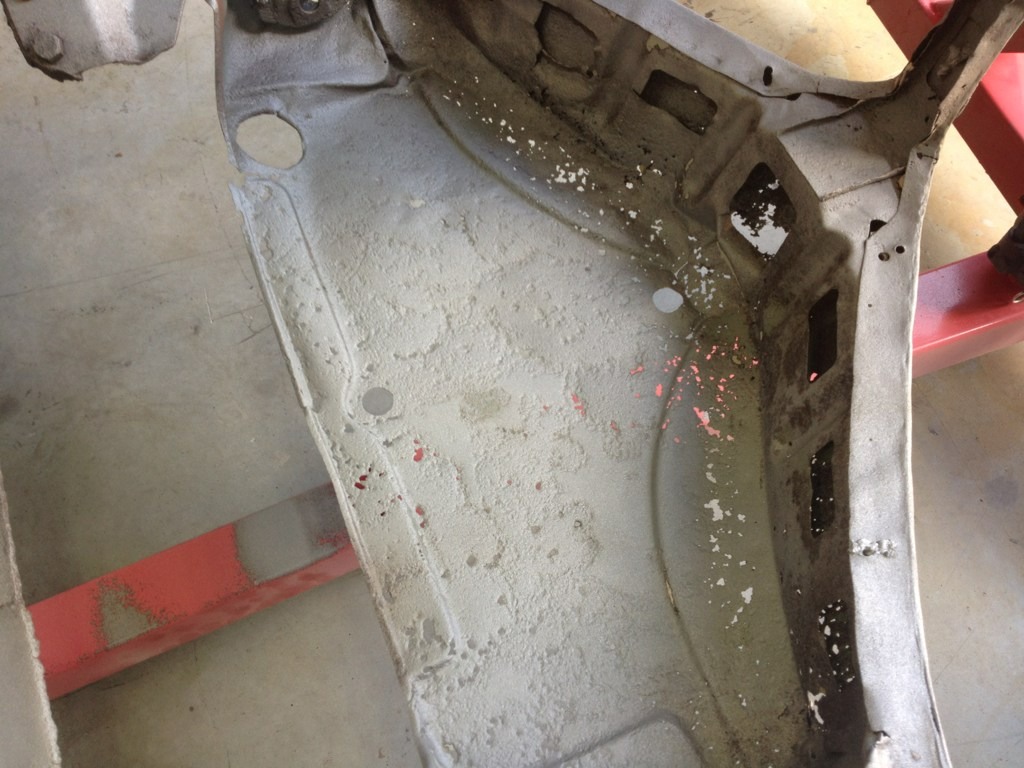

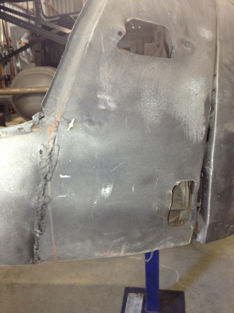

    These photos are from a year ago when it was first stripped . Can see all dodgy repairs.
    Okie Pete likes this.
  23. hooliganshotrods
    Joined: Dec 2, 2010
    Posts: 629
    hooliganshotrods
    It's amazing what shows up when you blast. I just went through the same findings of lousy fabrication when I blasted my next project, a 37 ford coupe.
    Love this car and really like what you have done so far, it's gonna be good and worth the efforts.

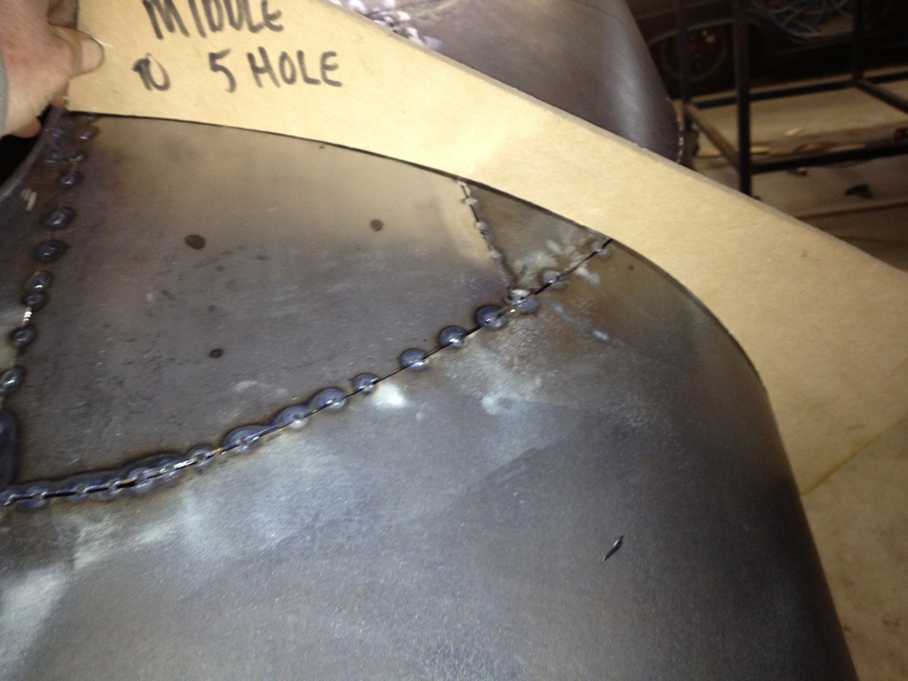

  25. Wensum Valley Rods
    Joined: Oct 13, 2008
    Posts: 289
    Wensum Valley Rods
    from England
    Getting closer to the end of my Zephyr build by the day, there's some familiar ground in your pics.
    It's amazing how some people will leave their bodywork and then just cover it in filler. Some very crude work on the roof chop. Good to see you are turning it around.
    Paul.

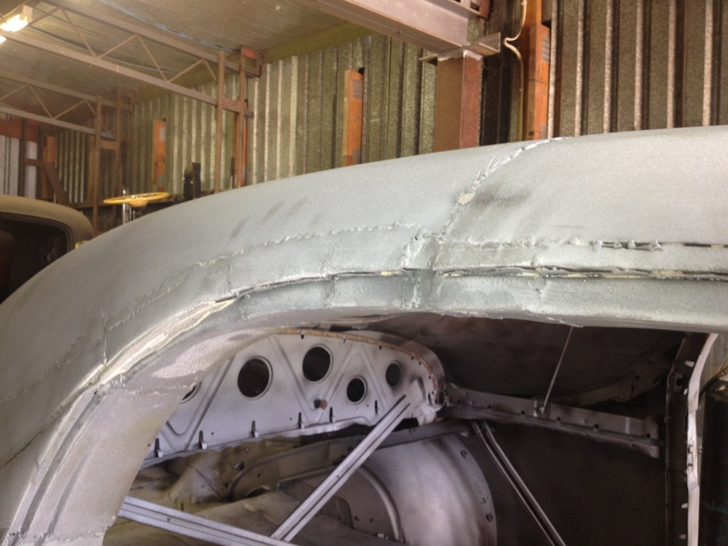

  26. Wensum Valley Rods
    Posts: 289
    Wensum Valley Rods
    from England
    Just looked at the pics again. I think some people shouldn't be allowed near a welder. There's some pretty dangerous stuff been done there, the engine mounts are really something, but I think strong probably isn't one of them.
    I reckon you have more work putting the bad right than you would have had doing the whole thing from scratch.
    Subscribed to the thread, I like to see somebody else with vision.
    Paul.

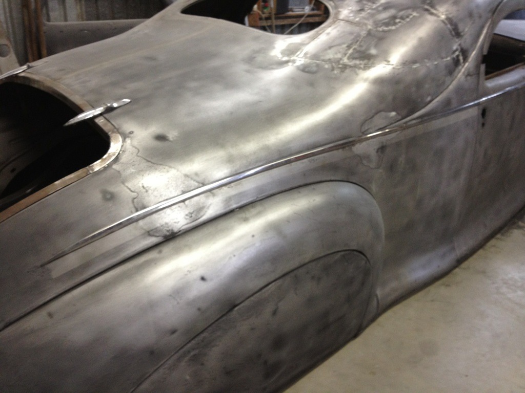

    Posts: 43
    straya
    ImageUploadedByH.A.M.B.1375465562.587497.jpg ImageUploadedByH.A.M.B.1375465638.370629.jpg ImageUploadedByH.A.M.B.1375465698.262963.jpg ImageUploadedByH.A.M.B.1375465729.942189.jpg ImageUploadedByH.A.M.B.1375465752.879905.jpg ImageUploadedByH.A.M.B.1375465783.289587.jpg ImageUploadedByH.A.M.B.1375465819.673473.jpg ImageUploadedByH.A.M.B.1375465962.518995.jpg ImageUploadedByH.A.M.B.1375465999.226570.jpg ImageUploadedByH.A.M.B.1375466031.809986.jpg ImageUploadedByH.A.M.B.1375466072.620350.jpg ImageUploadedByH.A.M.B.1375466129.623919.jpg ImageUploadedByH.A.M.B.1375466242.916750.jpg

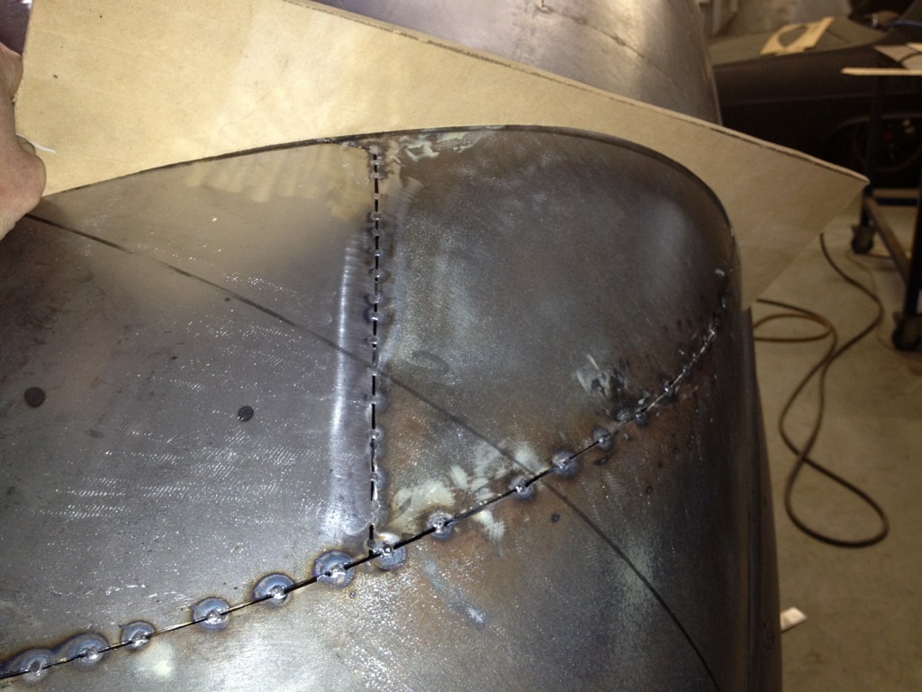

    Just sending some more photos of the zephyr coupe build. Had to redo a lot of the old work.i had to make a whole boot skin and frame as well the old one was rusted bad. More photos to come. Need some help chasing an original clock for it. Cj
    EVL401 and Okie Pete like this.
