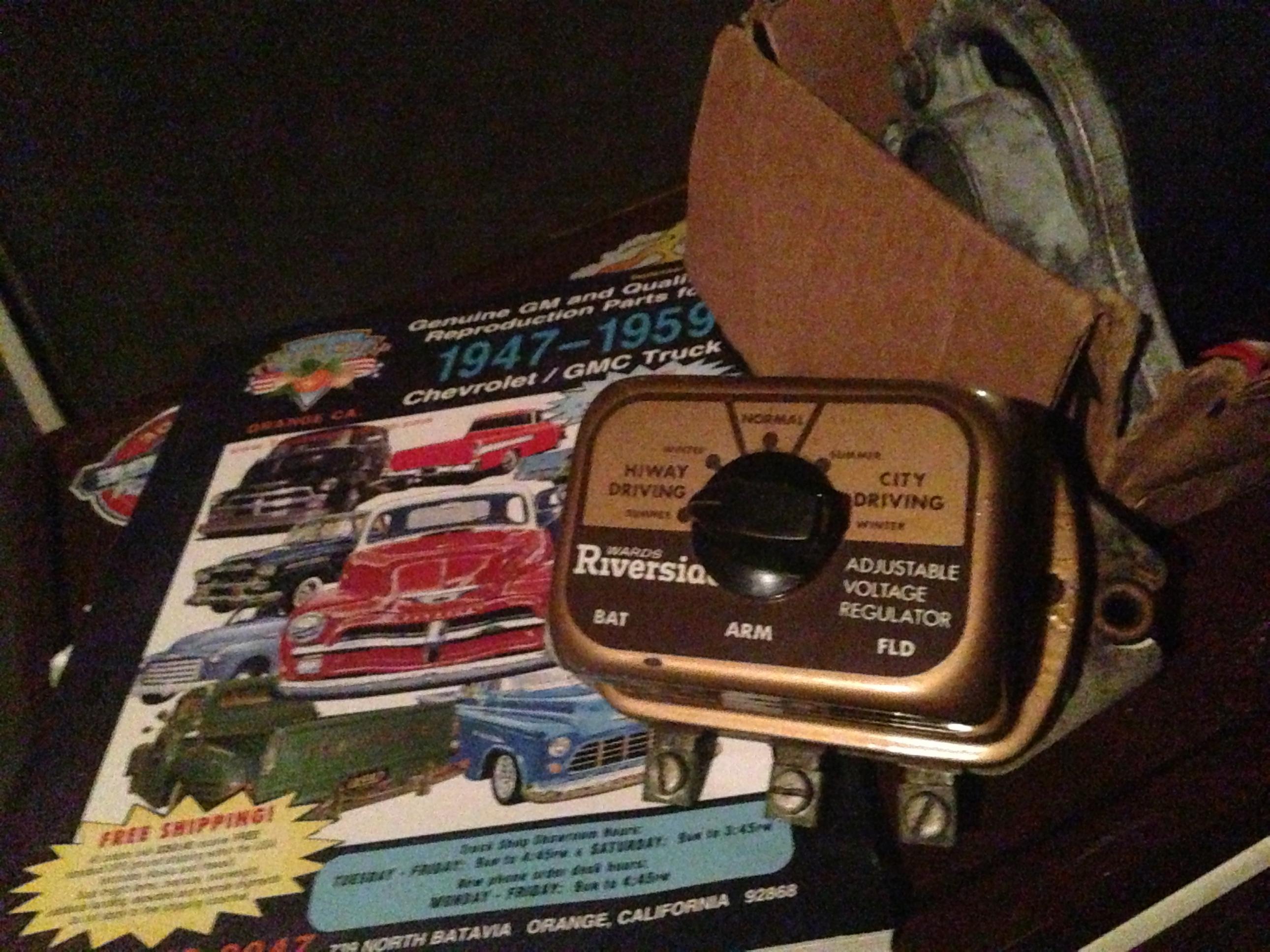

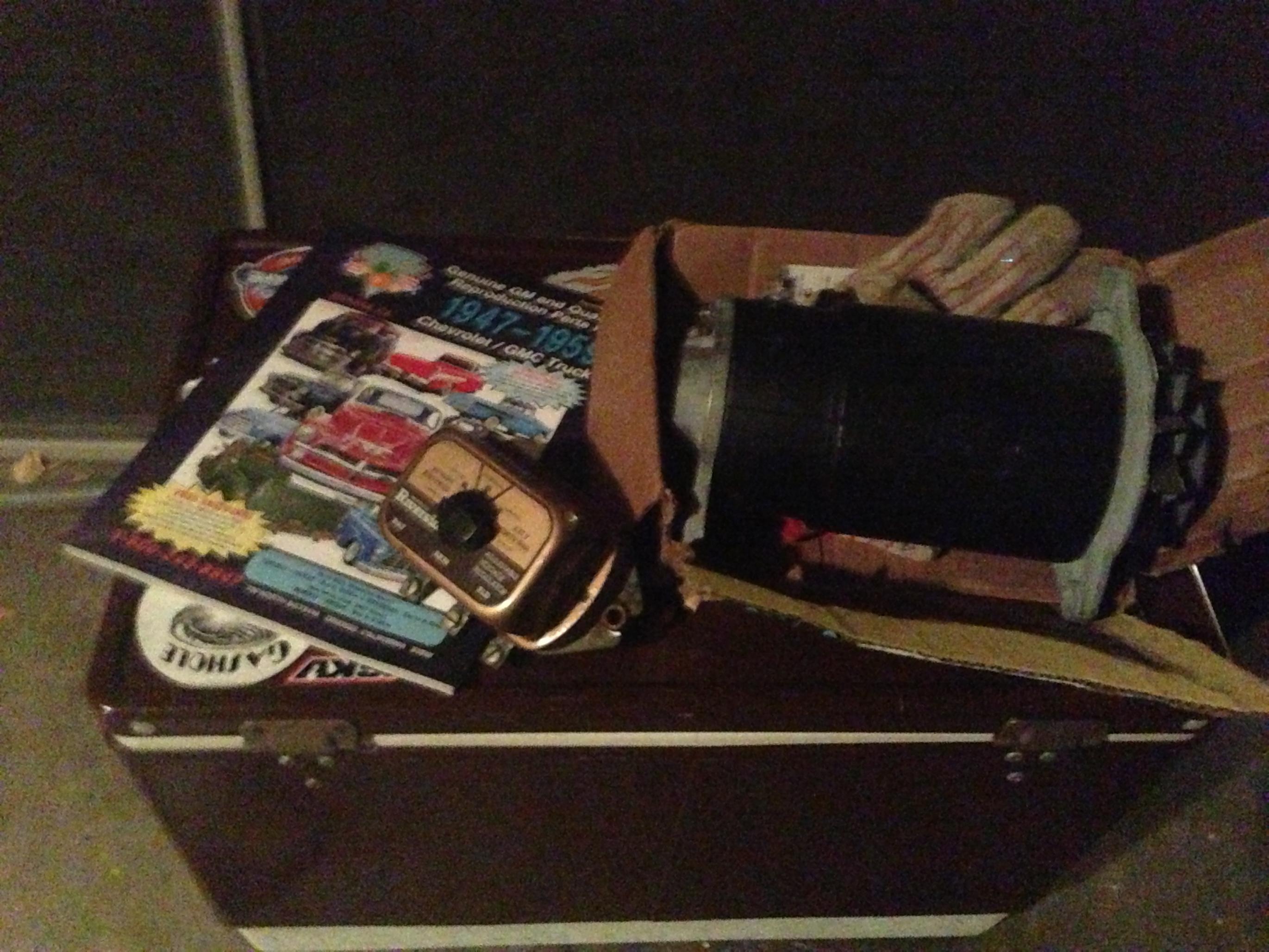

    Thanks everyone, I've been away with summer & my 2 boys running around causing havoc in the house! With that said I have jumped on the 41 again. I've been gathering the rear suspension parts for an open drive line setup. So far a 56 rear axle with 3.55 gears & the 3 speed OD tranny with a 60's bell housing! Now just for a shock upgrade! Meanwhile I've been slowly ramping up for the 12v upgrade rebuilt the 12v generator from the 261 & picked up a 12v regulator with season selector! Pretty rare & cool!

    Regulator

    That regulator is a nice "gizmo", definitely rare!

    the regulator is a really nice piece,never seen one like that before

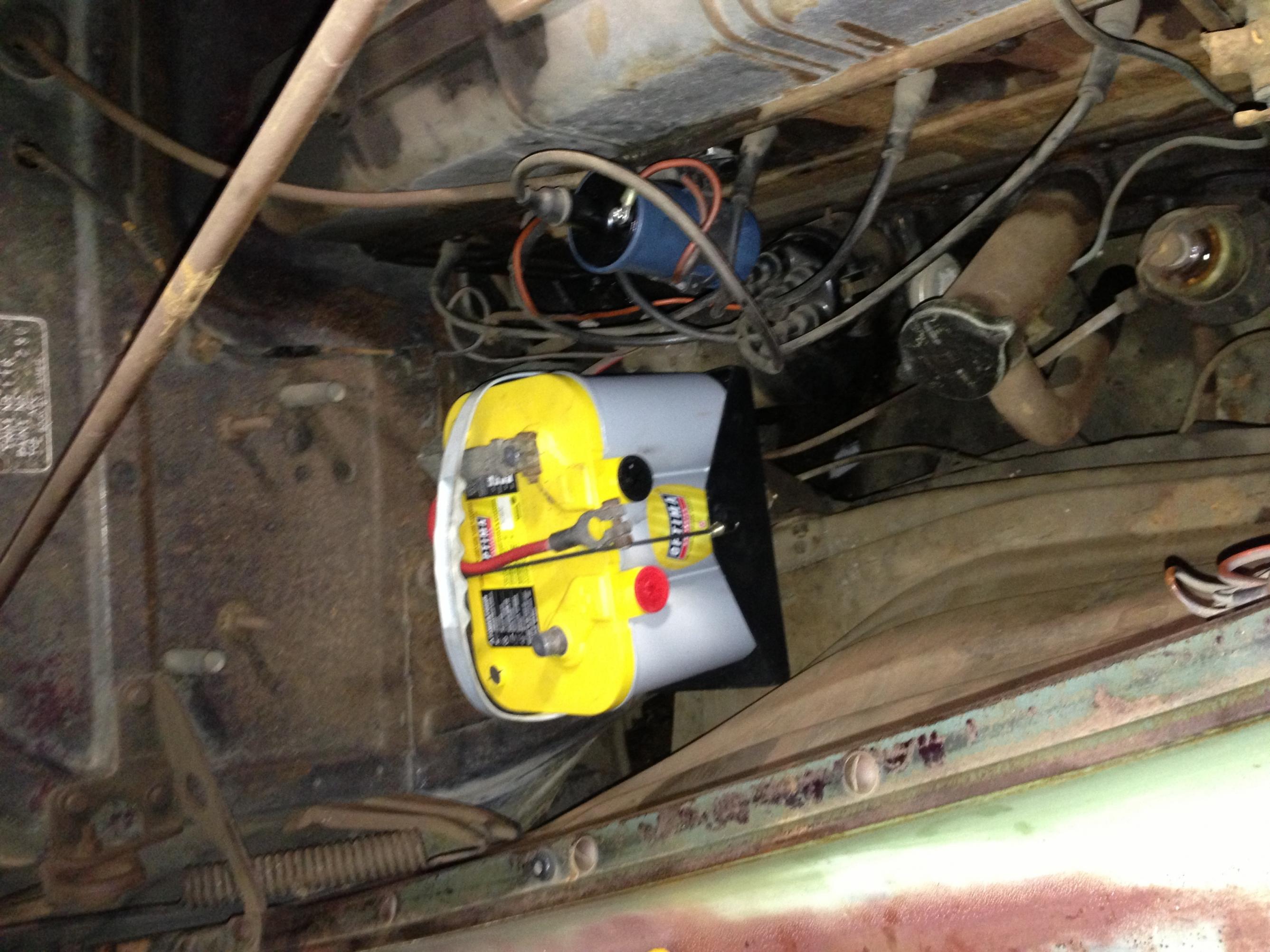

    We have 12v⚡!

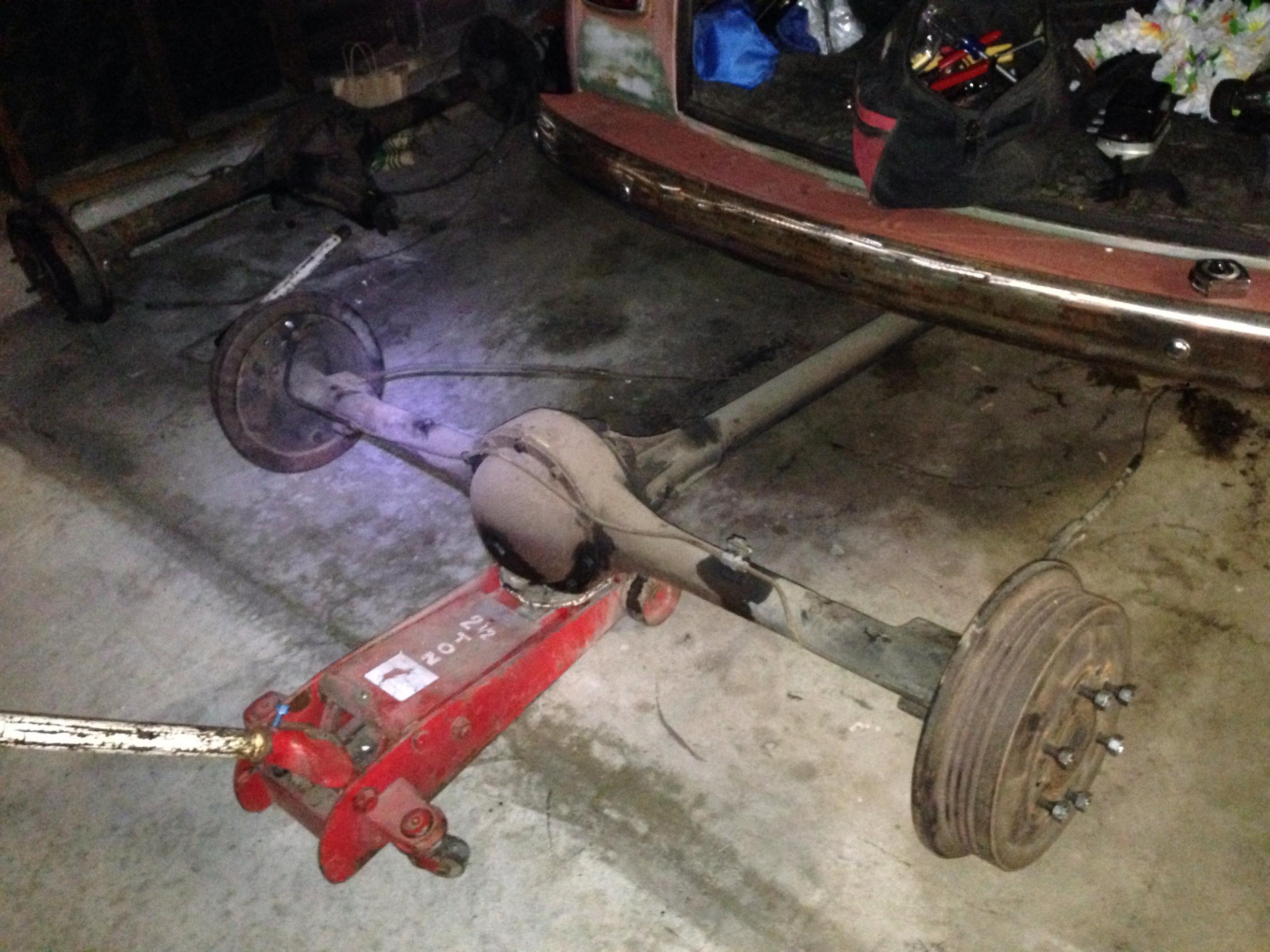

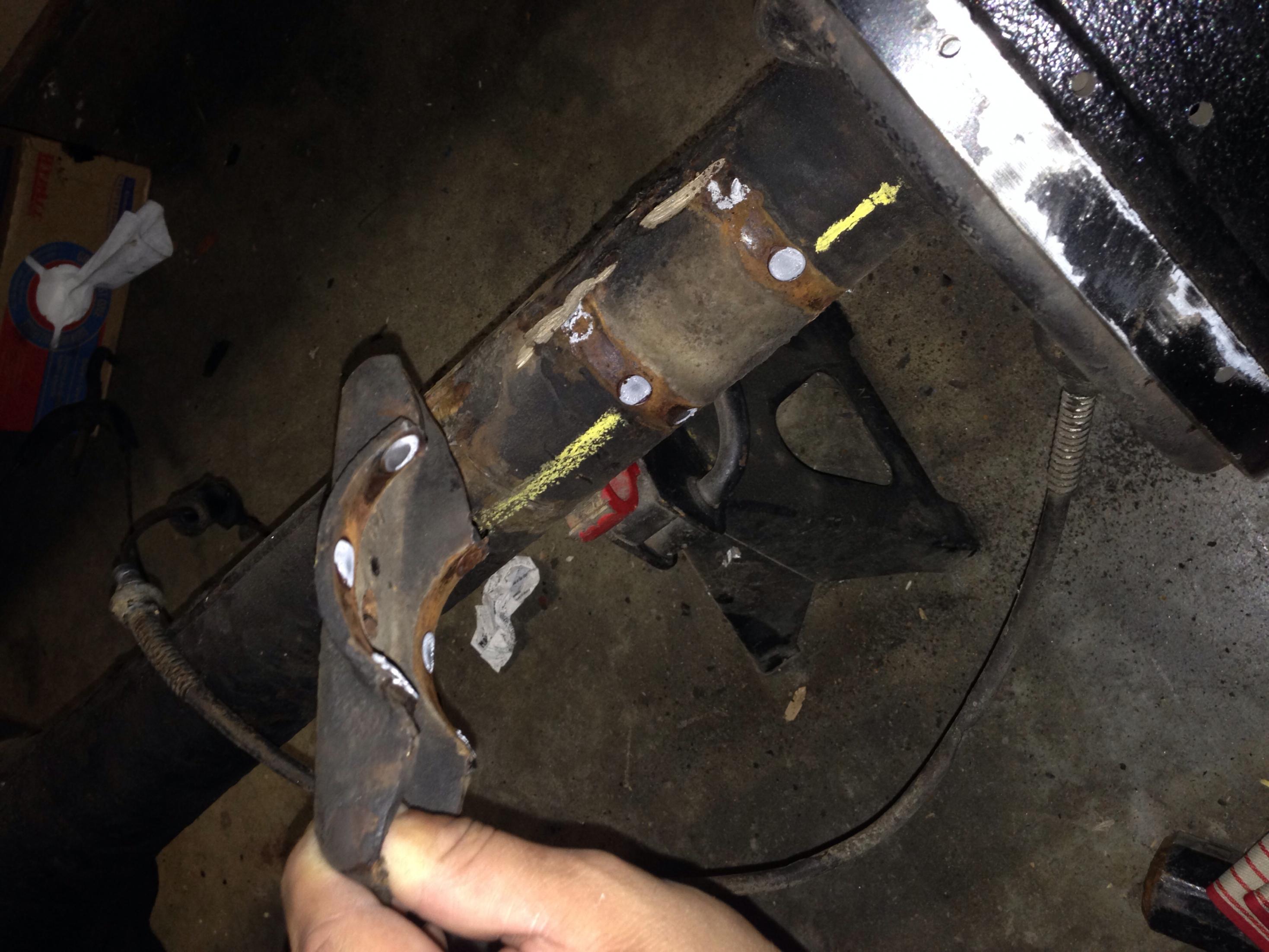

    Hey everyone, it's been a while but I have started doing the chassis after a lot of procrastinating on where to start! Found me a 57 bel air rear end instead using the 56 I had previously purchased. I pulled the original rear end out tonite. I'm gonna get the the spring pads relocated & should be able to fab up a new shock mounting bar where the old knee shocks were bolted up to. I should be done with major rear end work this weekend & will be retro fitting the new 3 speed OD & new drive line by Sunday (hopefully)👏lol.. Will keep posting pics of progress through out the weekend!

    57 Rear end with vented drums. All new hardware!!
  21. Ironclad

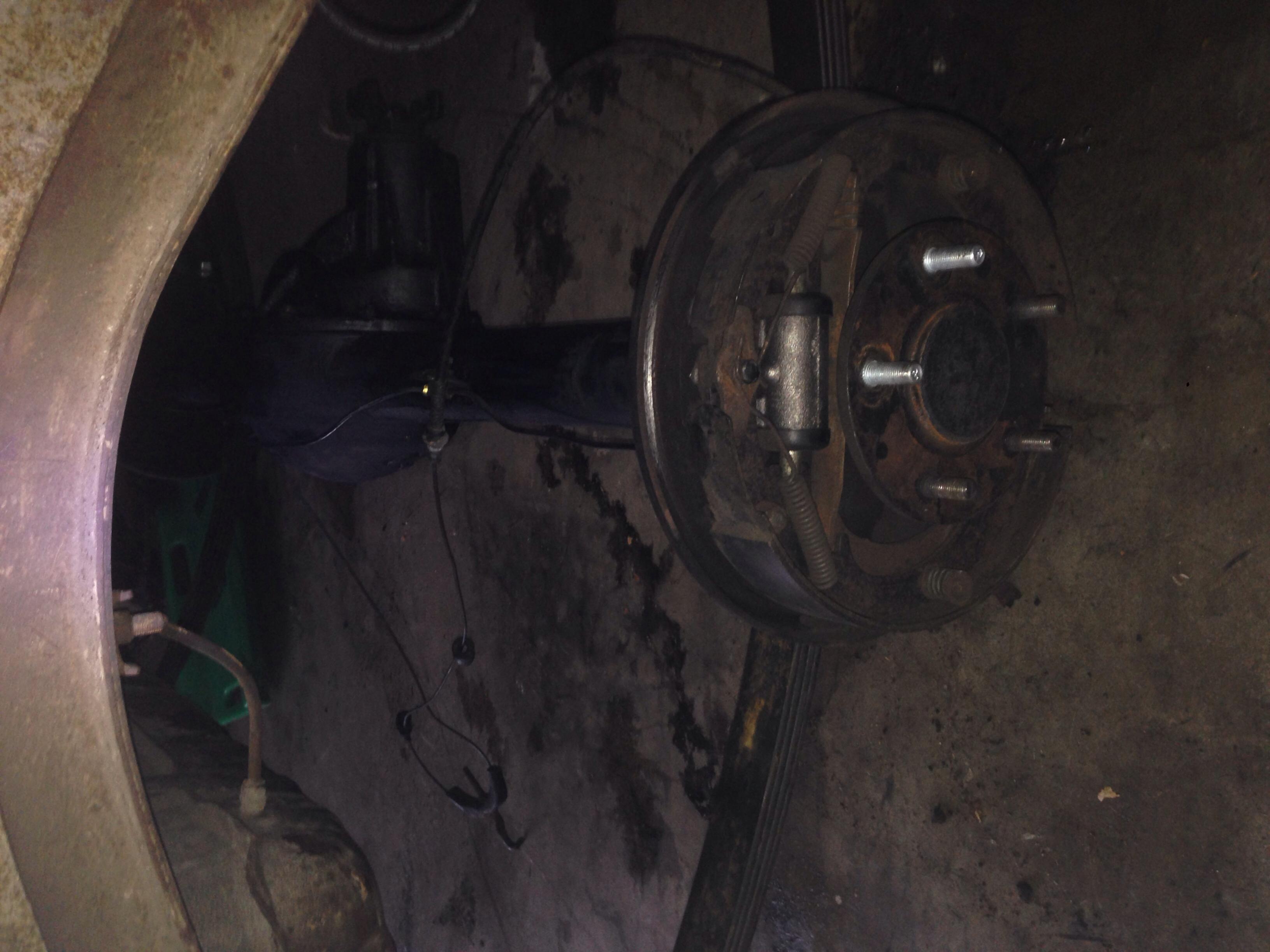

    from Covina
    Removed spring pads, now to relocate & place it back in!

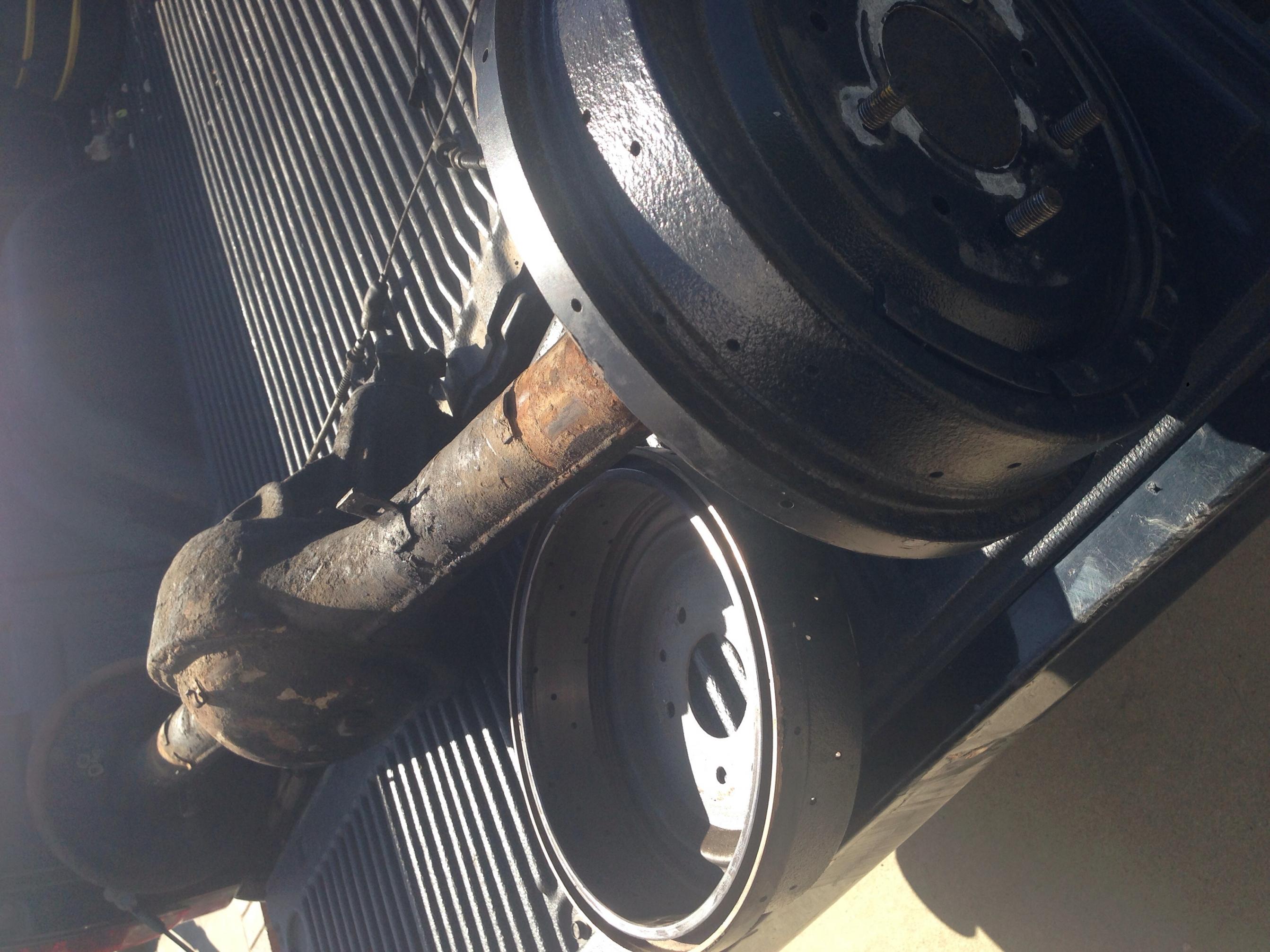

    Got the 57 rear end all back together, but still have to bring the stud back. I'm going to go with 2 1/2" first to center the wheels!

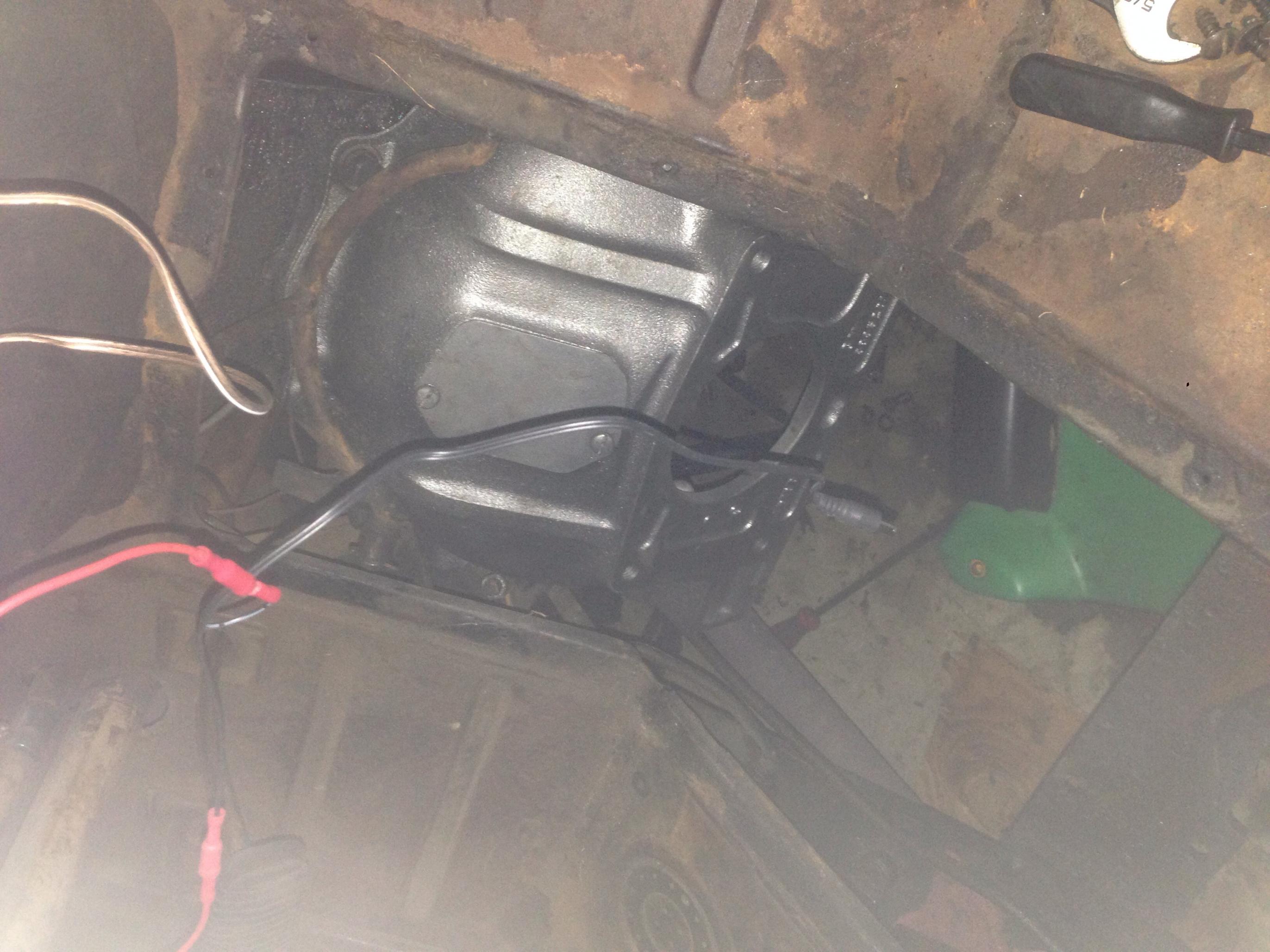

    Had time to remove the old bellhousing & install the 50's truck bell on. Now to modify the trans cross member to make room for the new 3 speed OD!

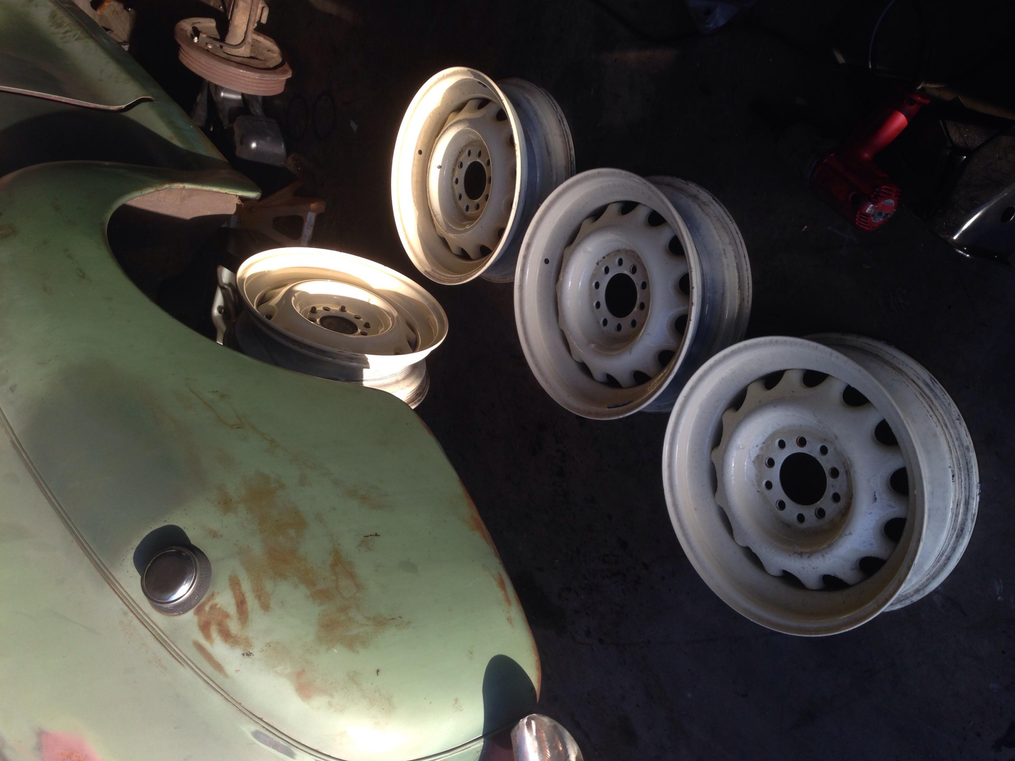

    One more for tonight, picked up a set of vintiques artilleries, these should be a good fit for what I'm looking for on the car!
