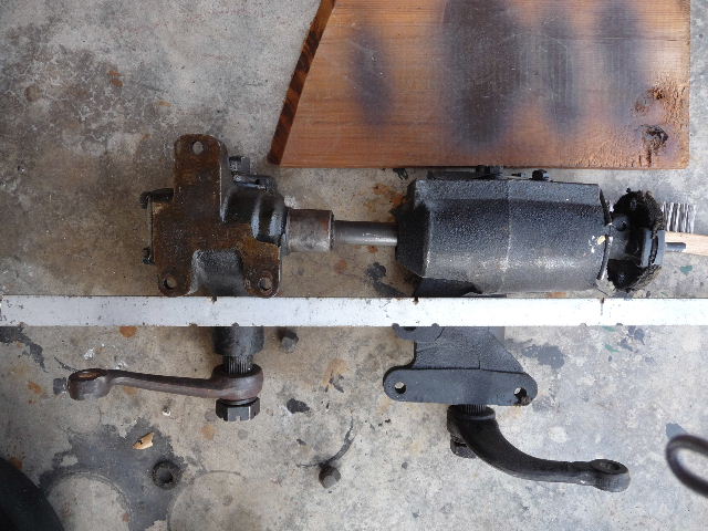

    Well I've worked up about 5 different mounts and nothing really works/looks right... So I'll put it to the group...
    I've got a steering box out of a 40 Ford... I wanted to run it because it's solid, I have it, and I like the fact that the arm will point up so that the draglink doesn't slope up... Also with the way my frame is set up, with the snout under the rail, it'd be almost completely hidden behind the Split wishbones...
    I also didn't want to run the sprint car steering because it's expensive, I don't have it, the ratios can be an issue, and I really am not crazy about having that long draglink running back to the cowl... Some days it looks ok to me... Somedays I don't like the look...
    So it should be pretty easy to flip the box sideways and fab up a pice of angle to mount to the stock steering box mounting holes right?...
    Not so much actually....
    Since I'm using the Spencer roadster as inspiration, and have pinched the frame rails... There isn't a whole lot of room to mess with. It's not as tight as say a 60 t-bird, but it's tight...
    Also the frame rails slope in pretty rapidly towards to the front, so the box has to be as far back as possible...
    Long story short... In order to keep the column centered between the 39 pedals and the mount on the 36 dash, the steering box would have to be cut in to the lower lip of the rail...
    So my choices are...
    Option A----Notch the lower lip of the rail a bit (Maybe .5") and mount the box with the snout under the rail and fab up the appropriate mounts.
    The problem with this one is I'm not sure what notching the rail would do to the strength...
    Option B----The other option I have is to trim all the stock 40 Ford mounts off the box, buy a flange from Tardel (0r have one made for me) and mount the box through the rail similar to the stock 32 mount... Only probably a bit lower in the rail.
    The problem with this is the steering arm will sit up pretty high and won't be as hidden as if the box were mounted under the rail....
    Suggestions... Here's some really crappy pics of what I'm talking about... My camera is dead right now...

    I have the same box setup on my '34 pickup like that. I'll see if I can dig up some pics when I get home today. Honestly, it's not a great solution and the way mine is done, the geometry is slightly less than desireable. It works, I've put about 12k miles on it, but I've been thinking of re-doing it with an f1 box...

    I cut the bottom, outward mount off the box last night and looked at it again...
    Still lots of issues but I think I can get it on there...
    How thick is the casting on these boxes? Do I have enough meat to grind a bit for clearance?
    Also, If I moved the box in .5" or so, would that make everything wonky behind the wheel? Do you think I'd even notice it?

    Would a Mustang box help with clearance? I have one somewhere. I could photo for you. I also have a junk 40 box housing you could cut up if wanted.

    I don't think the mustang box wouls help much with clearance... But if you don't need the 40 box that could help... You have a PM

    OK, I see where I wasn't clear...
    I modified your pic to show it better. (Thanks for the pic BTW. That's kind of how I pictured my mount. I needed the visual.)
    The red circle is the mount I had to cut off because it interfered with the bottom lip on the frame rail...
    The blue circle is the mount that is untouched but in order for the column to be ever remotely close to centered between the brake and clutch pedals, this mount actually sits inside the frame chanel.
    It's actually still about .5" off center between the pedals to the inside of the car. But I don't think that would be much of an issue... I might have to move the dash around a bit to get the gauges in the right place...
    With Guys like Zach, Bass and Iona etc on here... I find myself overthinking everything... I eventually come to terms with my Hack-ness and just weld shit up... But Sometimes it takes longer than other times... :D

    Compairison of Mustang,Maverick box and 40 box. It looks like it would gain you some room and not have any ears cut off. I got this last year at New Braunfels Swap for $20

    The Mustang box itself looks like it would provide a bit more room but I think all the bracketry on it might be in the way. Also it's a bit too new for the theme of this particular car... Thanks a bunch for showing the pic though...
    Ok... So I have the mount all templetted out now... Do you think 3/16" plate is thick enough with some judicously designed gussets... Kind of like what Kevin did? Or do I need to get some 1/4?
    In addition to the mount to the frame, I plan on fabbing something that mounts the snout to the bottom of the rail too...

    Ok, so here's what I came up with so far...
    It's just tacked in right now and needs to be moved around a little bit, but you get the idea. ;)
    the bracket extends all the way into the frame rail, will be completely welded when position correctly and will be 'captured' by the boxing plates...
    It will also have some gussets for strength/rigidity and the formentioned snout mount...
