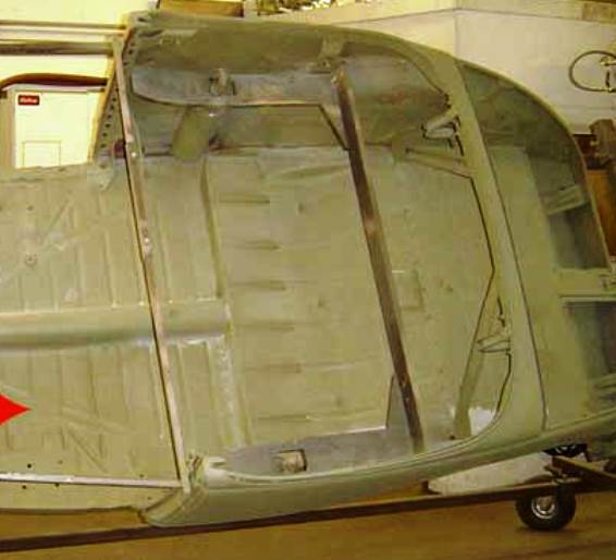

    hi could someone tell me or post a photo of were the air canisters are fixed at the bottom for the convertible roof my car was rotten all around the bottom so i have no idea thanks carl

    I have been collecting as many floor details as possible This is the best that I have that that shows the cylinder in relation to the step in floor. If you have a good photo program it is possible to zoom in closer. The picture was on a site with the arrow to illustrate the single floor repair a fairly the pristine body being restored.

    The ph0to was kind low resolution to work with but maybe this will help.Glenn do you have a higher resolution version of this floor?

    This is the best image that I have. I blew it up as much as I could and unfortunately it is not the best resolution. My convertible has the cylinders missing otherwise I could snap a picture for you. If you ask on the Fordbarn there may be someone

    Here is a parts drawing that may help make as well. Again click on the thumbnail it will expand then click on the arrow in the box and it will expand again then save that to your PC. I hope this makes adds some more clarity.

    I converted the parts drawing & photos to a letter size in a different format that you can print out. Its the best I can do with the quality of the photos pulled from the www. I have squirrelled a few photos on the floors that I will send your way tomorrow. I have to call it a night as it is 1:30am here.

    That is the type of drawing I spent an hour or two looking for last night Glenn. I am glad you had it on hand. I have always been curious about the 40 system. My 39 has a power system but it was disconnected when I bought the car and I have never tried to hook it up due to the way the interior and last top iron are configured. Carl should be able to figure out the placement with your help.
