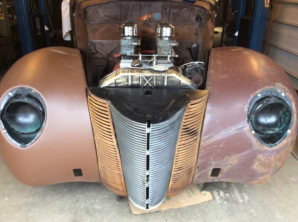

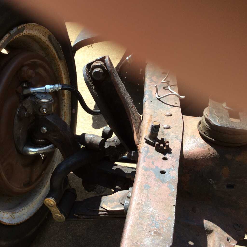

    so my knees r doin ok,, n im back on the 40,,new king pins, bushings, dropped steering arms, new drag link n tie rod w/all new rod ends, 56 ford f-1 front self energizing brakes , new rear brake shoes n hardware, rear drums turned,made a master cyl. adapter n installed a 70 javalim dual master cyl [whats neat bout the master cyl is it ports out to the outsie rail] less messin around w/tube bending,,more info to come,, plus some pics,,,,,,,,,,also forgot to mention new tires l78/15s n 560/15s

    Hope these pics load if so they r not in any order ImageUploadedByH.A.M.B.1408412075.423043.jpg ImageUploadedByH.A.M.B.1408412096.792378.jpg ImageUploadedByH.A.M.B.1408412131.209146.jpg ImageUploadedByH.A.M.B.1408412144.929212.jpg ImageUploadedByH.A.M.B.1408412156.460106.jpg ImageUploadedByH.A.M.B.1408412180.311335.jpg

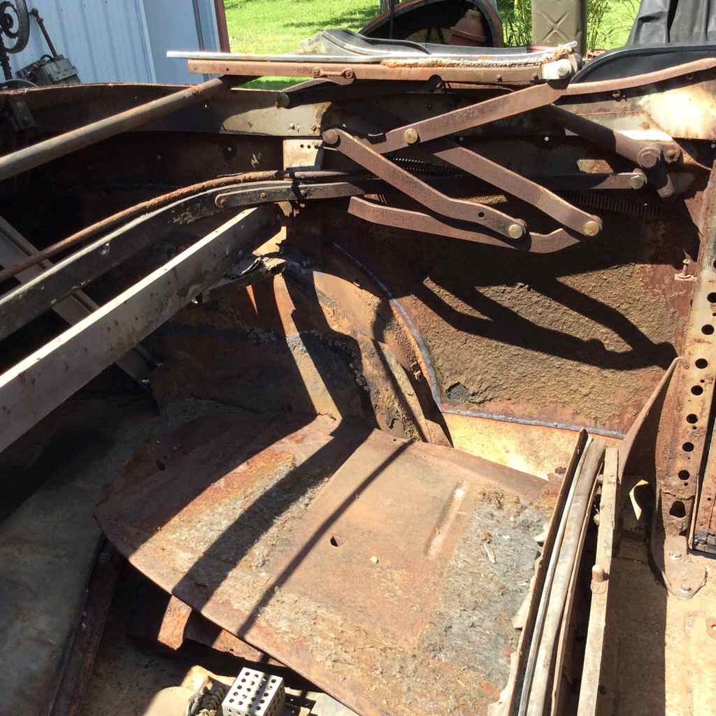

    well ive been floggin on this pos,,the brakes are juiced up n have a good pedal,, tonite i was on the trans mount,,i dont want to split the bones, so,, its a little tight in there for a mount, but i believe what we have goin will work, looks like ill have to use 39 pedal assy, in order to line up the rod from pedal to fork,, i may raise this clevis up approx. 2 in. i will post some pictures in a few days

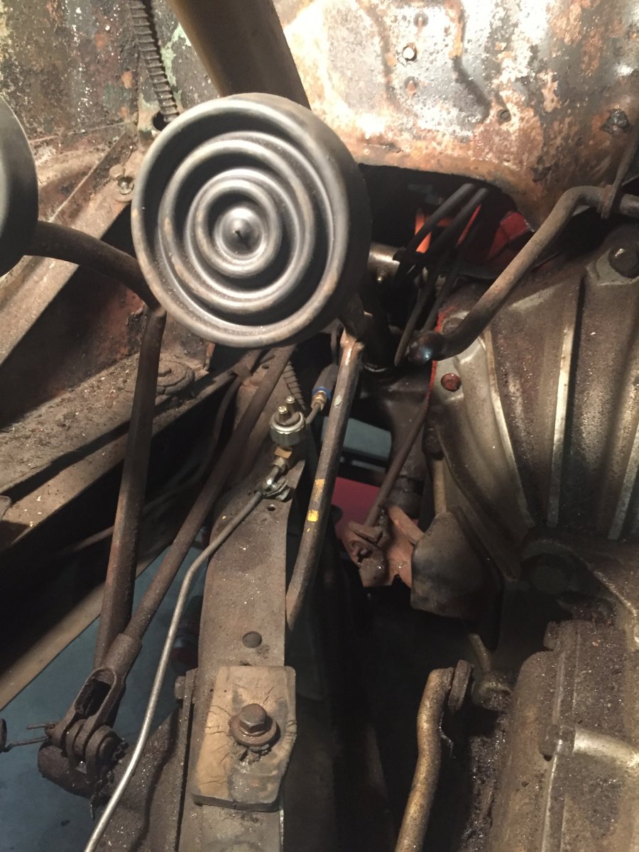

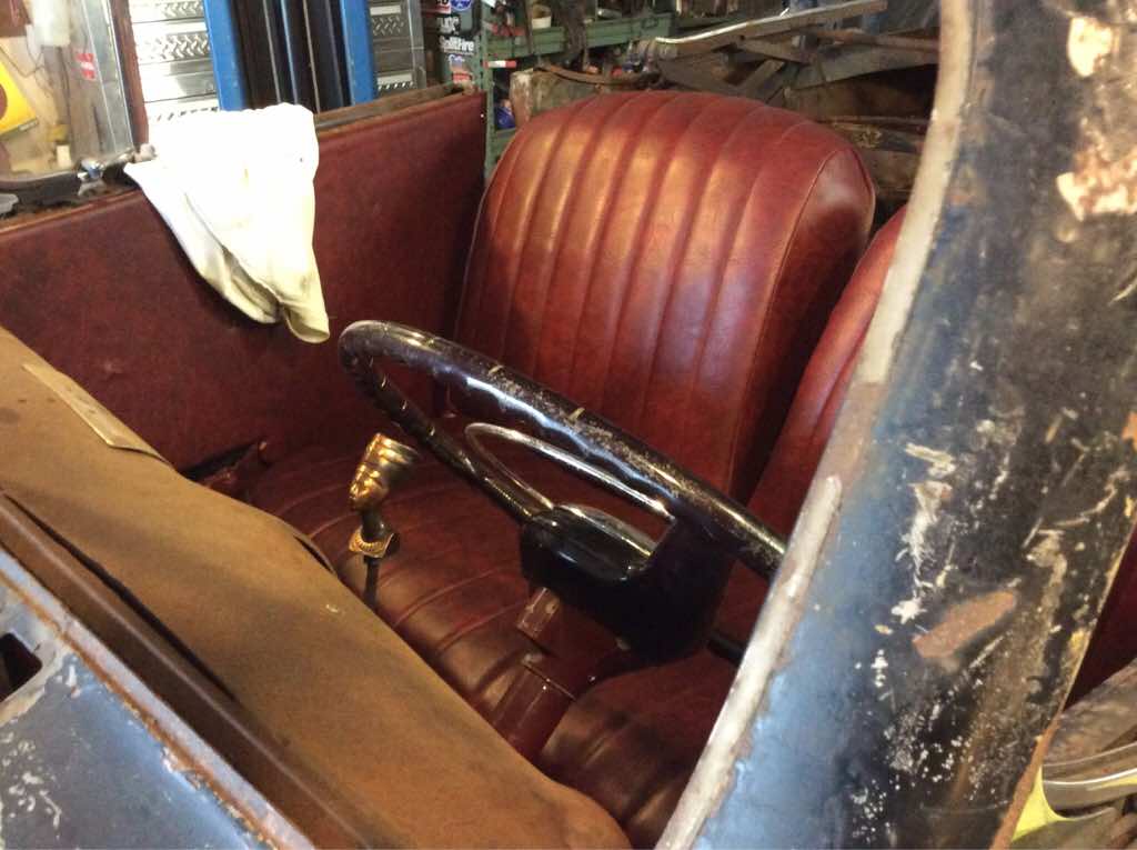

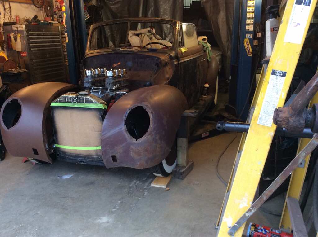

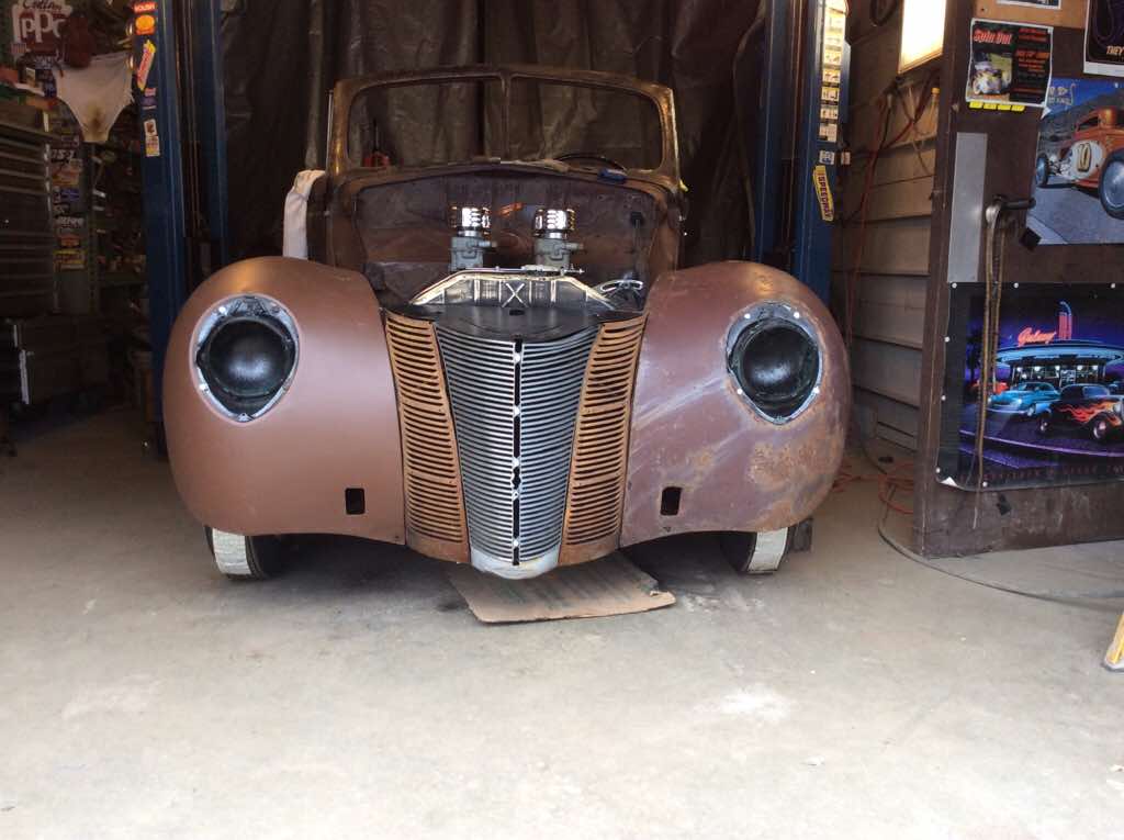

    It's been more than a couple of days,here's the latest, shocks mounted,trans mount done,radiator installed, clutch linkage done, will take picture n post, got a problem with brake pedal arm hitting clutch arm, door panels n seat r in front clip on, Dave is cutting driveshaft,vintage metalworks, little plug for him, I want to thank Tim, John, Dave, n my son Scott just to name a few, for their help, hope to have this jalopy on the road this summer, here r some pics not in order of assy. ImageUploadedByH.A.M.B.1418997456.757250.jpg ImageUploadedByH.A.M.B.1418997486.779329.jpg ImageUploadedByH.A.M.B.1418997518.311120.jpg ImageUploadedByH.A.M.B.1418997539.830445.jpg

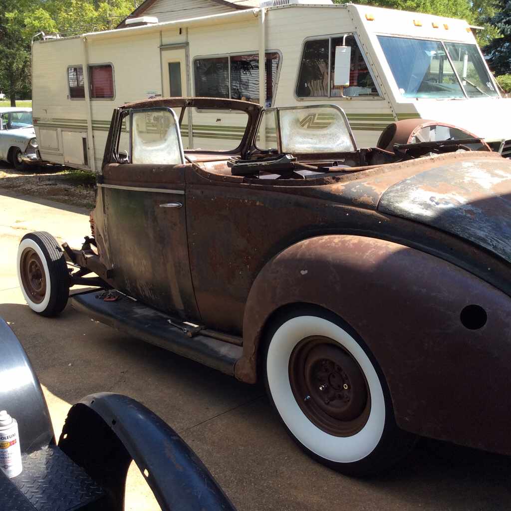

    Sorry I haven't kept updates,, the car is on the road, first shake down run was to the rust belt rival, Youngstown,, come home with road hounds pic. Thanks guys n gals

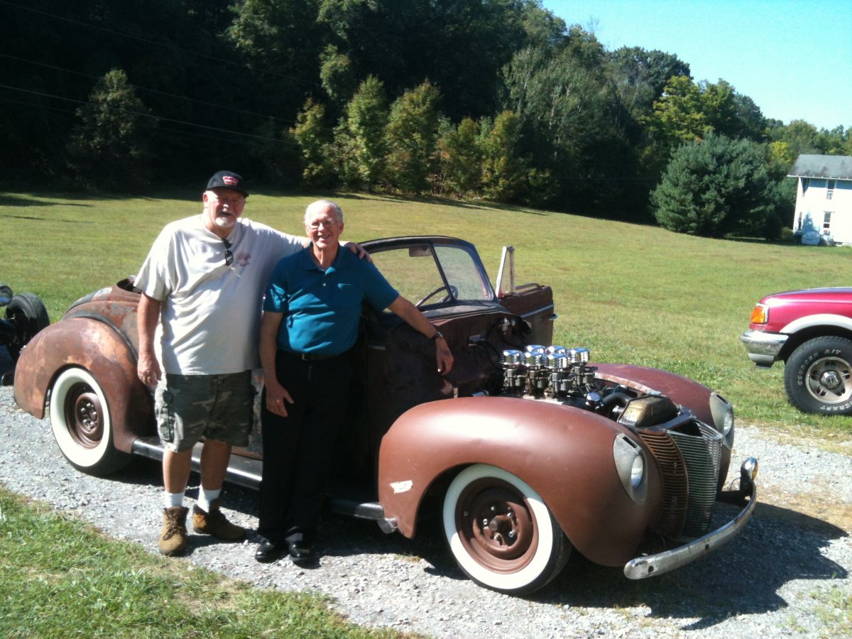

    F880493B-3F2A-495F-A653-E2A56C3CD57F.jpeg C6004F58-6B10-4F8E-8202-4465CFF8F8CA.jpeg 21E95115-AE08-45F0-B3D9-046E4A9F9625.jpeg Just looking over my old post 3 1/2 years ago, time flies, but I forgot to post some other pictures, mainly pictures of the gentleman that I bought the car from, I told him if I ever got this POS on the road that I would take him for a spin, and we did just that, couple of my buddies and I drove our hot rods up to his home north of Manaway Ohio when we got there I told him I wanted him to drive the car and he said that it was no longer his car and that he no longer owned it, so I took him for a drive about a mile away from his home turn the car around, shut it off got out of the car he said what are you doing, I said you’re either driving the car home, or were walking back, pictures will speak for their self, After we got back to his home we were a little emotional, not sure if he still with us this was 3 1/2 years ago and his health was not well

    love that story!!

    Your 40 turned out great but putting a smile on the former owners face is priceless.

    I would love to see the picture of the 1939 Ford clutch linkage. I am trying to revise my 1939 Ford Coupe - 327 and Muncie 4 speed. Has 1940 petals and z bar to clutch fork. I bought a repo 1939 petal set from Drake and want to revise. Great work on this project.

    Working on the same problem - need to change out my 1940 petals for 1939 ones I believe. 39 clutch MNS.jpg
