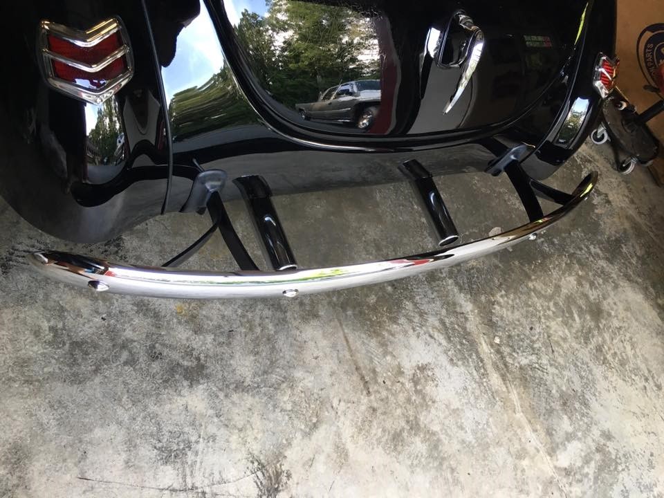

  18. After some research I was told that the sedan delivery rear bumper is different than the pick up bumper. I was also told that no one repop's the delivery bumper. I always assumed that the delivery bumper was flatter but at this point I really don't know. I ended up putting the 40 rear pick up bumper on the back of my 40 Deluxe coupe because I didn't want the large bow of the 40 Deluxe bumper. I used the 39 Deluxe brackets as they have the same hole spacing for the P/U bumper. After it is all said and done, I don't think anyone will notice the difference but me! :rolleyes::)
    Here is the pick up bumper on my coupe. Sorry I didn't take any reference pictures with the stock bumper for comparison.

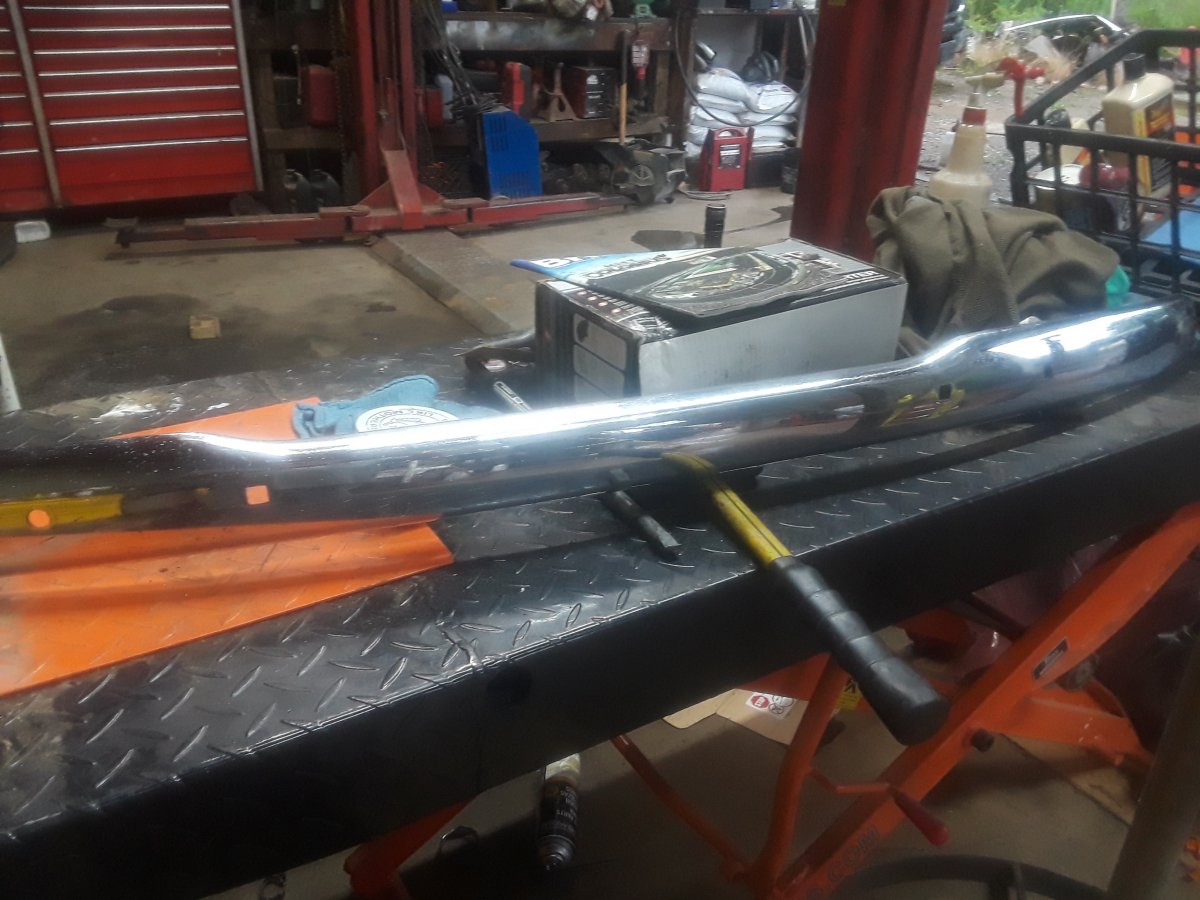

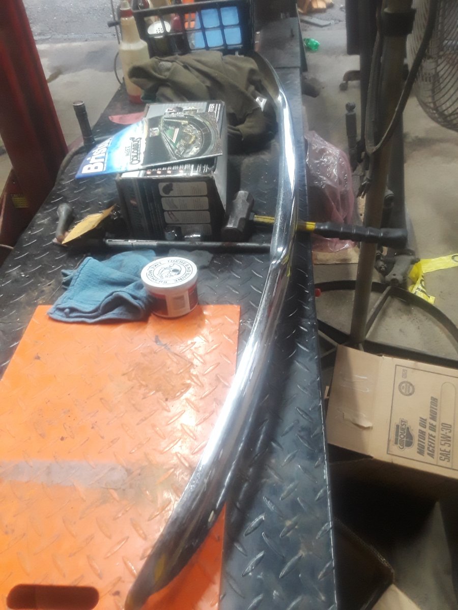

    Does this look like a 40 delivery bumper? 20180516_190134.jpg 20180516_190119.jpg 20180516_190107.jpg 20180516_190050.jpg

    '40 Merc with a couple of extra holes.
    Now that they are side by side, maybe not.
  21. WTF really
    Joined: Jul 9, 2017
    Posts: 710
    WTF really
    It looks like the merc is flatter. This one looks more cupped.
