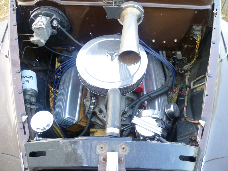

  13. Hello, from Norway.
    Here's some pics of my
    40 DeSoto Cpe. Owned her since 2008. Had a 350 egen i got her, replaced it with 360, but now she is getting a rebuild 57 341 Hemi. She's finally got the right heart.
    Lars.
    Sent from my ANE-LX1 using The H.A.M.B. mobile app
